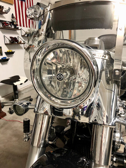

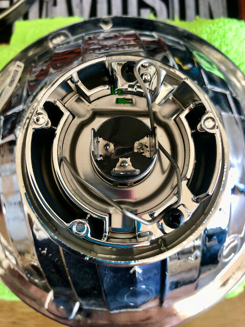

Installed the DK Custom LED Headlamp Bulb replacement (drop in H4) into the 17 FW this morning. A pretty simple install ... all the trim rings and the headlamp itself have tabs which are easily relined with cutouts in the bucket. Just pay attention to the retaining clip orientation when you remove it. Performance is literally Night & Day. Thanks to the guys and gals at DKIMG_0144.jpegIMG_0139.jpegIMG_9398.jpeg

You know that hasp holding the light in does not have to come all the way off, just unclip it and pull down
