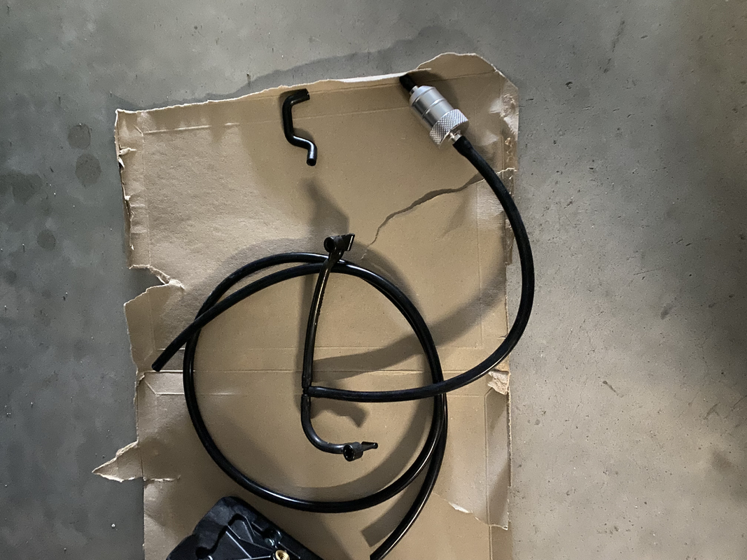

I did an external breather on my freewheeler last week . I drilled the back housing at the bottom and ran a hose to the ground in the front of the bike. I doubt most of the time there is enuff oil to even worry about a catch can. If winter ever leaves us we will see.

You might consider a small breather filter (very inexpensive) just for peace of mind that you’re not running down the highway spraying oil mist all over your bike

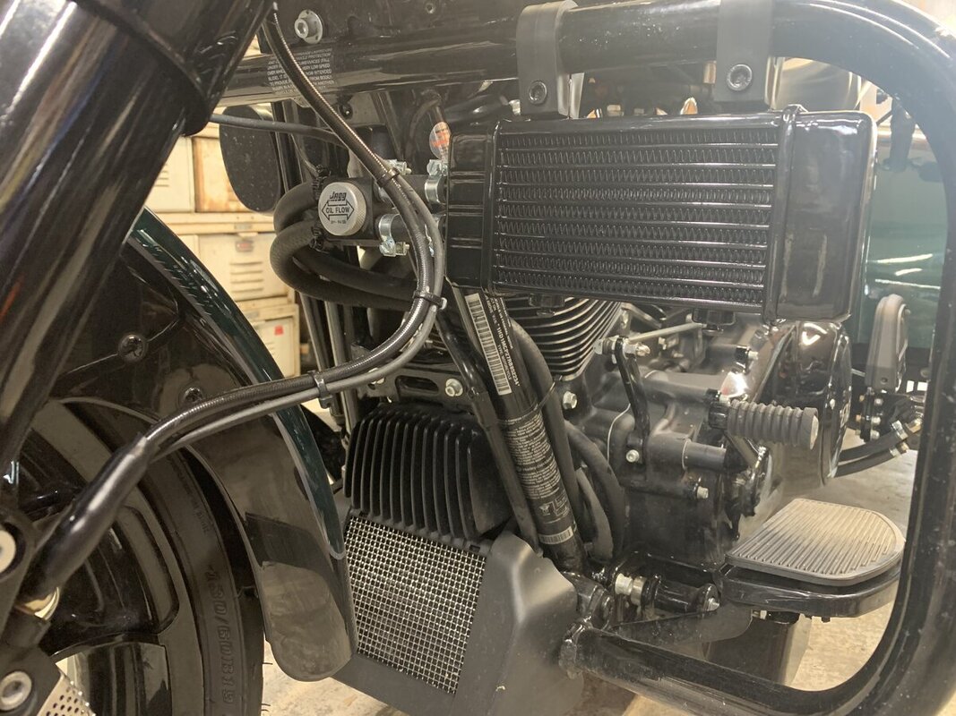

If you are out and about on Sunday, swing by Doc's after ~10:30. I am working on my trike with a tech (I know the store is closed, but we can work without interruption during their downtime). Fitting up the new front end and bars and laying out final hardpoints for plumbing, wire harness etc. and for the machinist to put the final touches on the trees. Here they are BTW

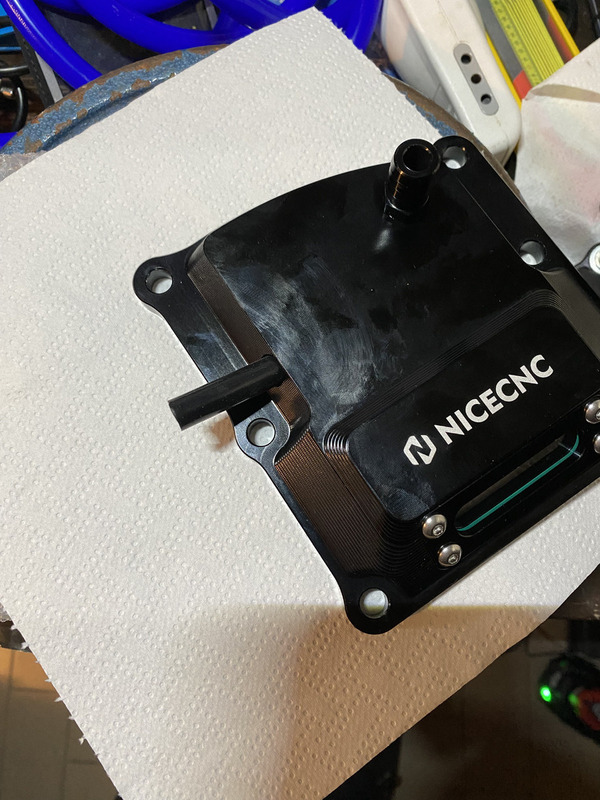

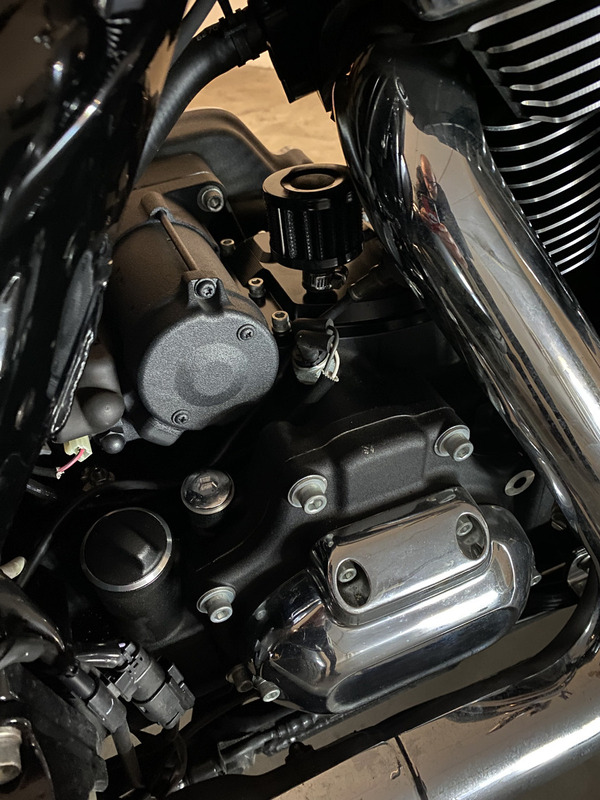

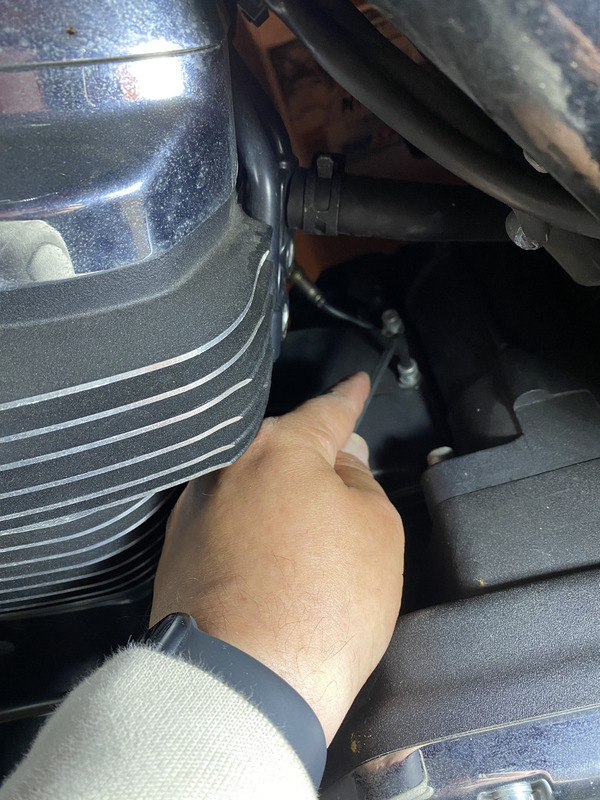

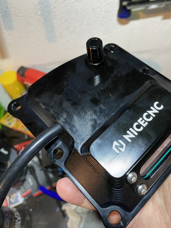

Sunday I did another mod: I replaced oem transmission top cover with a vented top cover from NICECNC. It was not too difficult, but a little boring cause of the tight spaces, I wasn't able to remove the vent pipe from the old top cover so I did it by myself with a piece of silicon hose. so far it seems to working well. Have a nice day you all.tempImagefHfTby.jpgtempImagebZOEnz.jpgtempImagetPJQ9w.jpgtempImagedFJnnF.jpgtempImageMNYI6R.jpgtempImagegpQGHV.jpg
Sunday I did another mod: I replaced oem transmission top cover with a vented top cover from NICECNC. It was not too difficult, but a little boring cause of the tight spaces, I wasn't able to remove the vent pipe from the old top cover so I did it by myself with a piece of silicon hose. so far it seems to working well. Have a nice day you all.View attachment 132733View attachment 132735View attachment 132736View attachment 132737View attachment 132738View attachment 132739
What does the vented cover do for the transmission ?

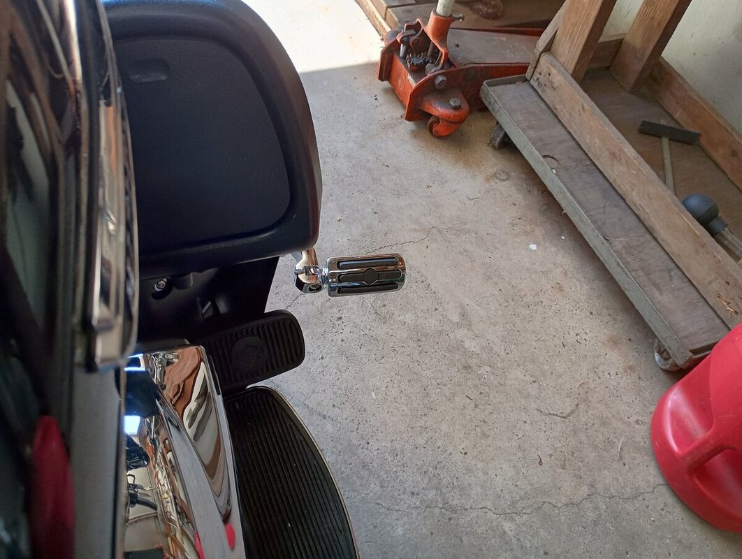

I finally got out to the garage today after coming down with the flu last Sunday . Let me tell ya this is an ass kicker ! Sweats ,Chills ,aches, pains 6 day headache etc.

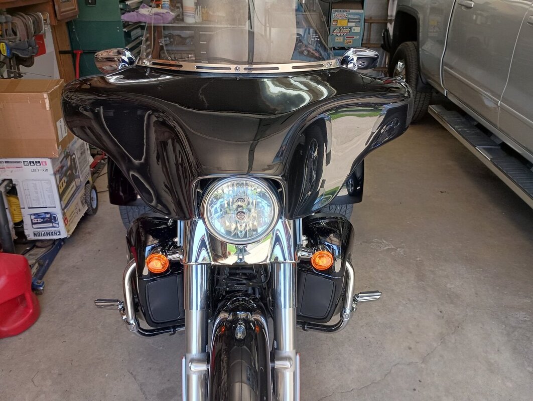

Wednesday about 4 am i woke up in a puddle of water . My hair was wet top to bottom and I have a pretty long pony tail ! Anyway I got the new short highway pegs mounted and looks like they will work. I bought a piece of windshield trim for the batwing and I am amazed that the trailer store actually drilled the windshield holes that far off from where they actually should be . Looks like the guy was drunk or stoned.
All good although I shouldn't have to I will fix it :) After all its just fiberglass and Ive build and painted 3 glass hot rods so I do know how ;) Supposedly tomorrow the 19 inch wrap front fender will be here so I need to get more better to play with that also since I am heading south the 14th.

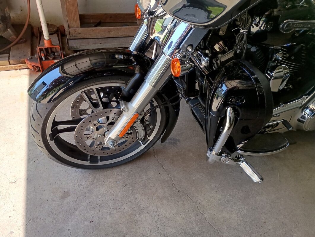

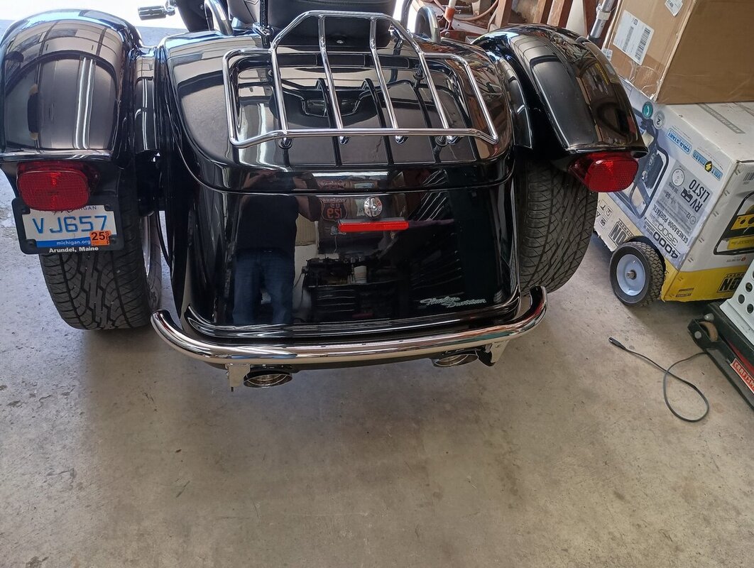

Yesterday. Saturday 5/10/25. Got the new wrap fender on and the stainless windshield trim and re drilled the holes for the windshield where they should be . The trailer store holes were better that 5/8 off side to side then also the height was wrong. I will fill and hide the old holes that show on the inside this winter. Here are a few new pics.
I may cut the front of the new wrap fender back a bit ? Still deciding on that . Its interesting as these sell for less that 40.00 to over 200 and its still the same abs fender.
Other than the mounting points could be thicker to reduce shake its not a bad fender and since my bike is black there is no paint work :) I can flex it around but it doesnt seem to shake when the bike is running so we shall see . I am going to change the bolts out to stainless with nylock nuts when I get to the store . I dont think there is anything else I need at the moment except the new 12 inch windshield. . Thats supposed to be here Tuesday .
