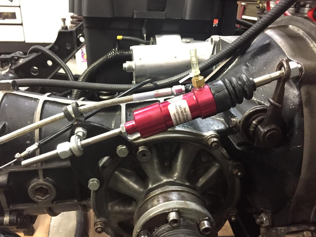

hello Trike Talk people... first of all, thank you for letting me join this forum, I hope I will be able to be of help from time to time.
~ I am currently building a VW powered monster of a trike, and I'm in the semifinals, but the conversion to a hydraulic clutch system is where i hit the wall. I will try to describe what is going on to the best of my ability. I have a C&C slave cylinder properly installed, a 3/4"master cylinder as it is recommended, my flywheel, pressure plate and clutch pad are the correct type for my type 1 VW transmission and are new and in perfect and working condition, all the torque values are correct... I bled the system 3 times, and made sure there was no air in the system and at first everything looked to be working fine... but ones I got the engine fired up, the clutch would not disengage...
after a very complete Inspection, I found that the slave cylinder would only actuate up to the place where the throw bearing engages the pressure plate fingers, and stop. no mater the adjustments on the slave cylinder, it would only go that far... I took all the slack out of the slave cyl. push rods and the pedal was unmovable. I can disengage the clutch i by using a pry bar on the tranny throw arm... I also had the company that sold me the slave cylinder, send me a new one... but it made no difference.
Thanks,Cesar.
,SlaveMasterSlave top view

I push the pedal.
the slave cyl puls the throw arm until it touches the P.P fingers.
the pedal also stops moving.
if i adjust the slave, and take it all the way, till it hits the finger , the pedal and slave won't move.
no mater how i adjust the slave... it will always go to the same point( the fingers)

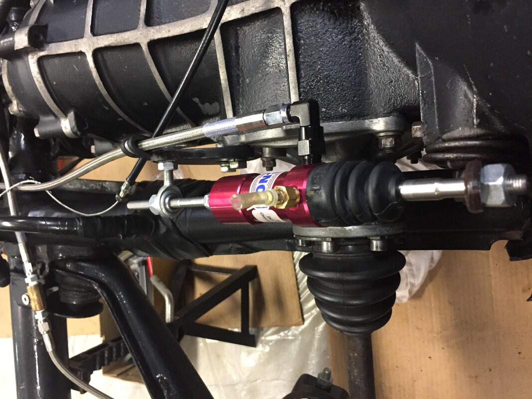

IMG_5990.JPGthe fIMG_5991.JPGirst pic is before pressing the pedal... if you can see the markings by the base of the throw arm .. the last dot is where it need to go, the dot before that, is where it touches the fingers ( all the slack out )
your mc looks to be exactly the one I am using....with 3/4 mc and 7/8 pull slave I have enough travel, but very little extra, not good to overtravel a pressure plate anyhow.
when you reach that point of contact , does the brake stop pedal rock hard, or does it slowly go to the floor?
I'm wondering if the mc is bypassing on the cup, or if the mc is jammed up inside ,or missassaembled?
I would take that mc apart and look....could even be wrong pushrod or piston length....then I would call willwood and ask them what parts and dimentions the parts should be. I'm sure they will be glad to help.....they have a reputation to protect.
