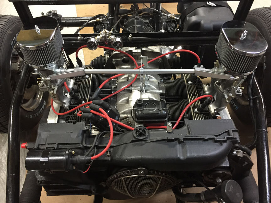

It did't have anything on it when I got it... including the fuel injection system, distributor or any wires at all, so I put dual carbs on it and, the wort part was that it did not have a mechanical fuel pump or a port to install one. and I don't think it was in a bus, but I think that if it could tell it's story, it would be a best seller-

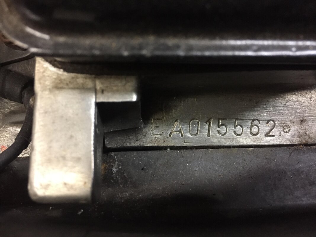

Post up the number by the case vent stand and let's see if we can identify it.
Of course you can mix and match stuff, but typically the type 4 stuff ain't done that way. They just did not wear out and get patchwork back together like the type 1 did.
What cooling are you going to use? The stock pancake housing or convert to upright?
I'm using the original shroud. and I don't have must of the tins, and they are hard to get. I'm counting on the open air flow, will work much like a motorcycle engine cooling system. and if I find that it runs too hot, I'll have to get one of those fancy 911 fan shrouds...

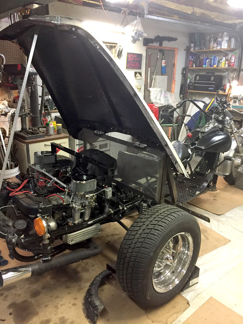

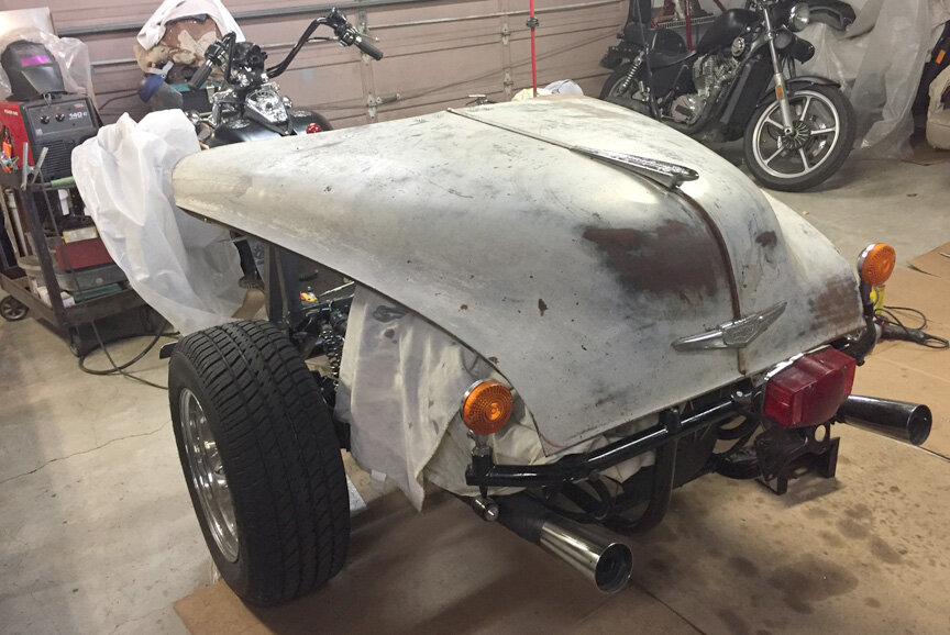

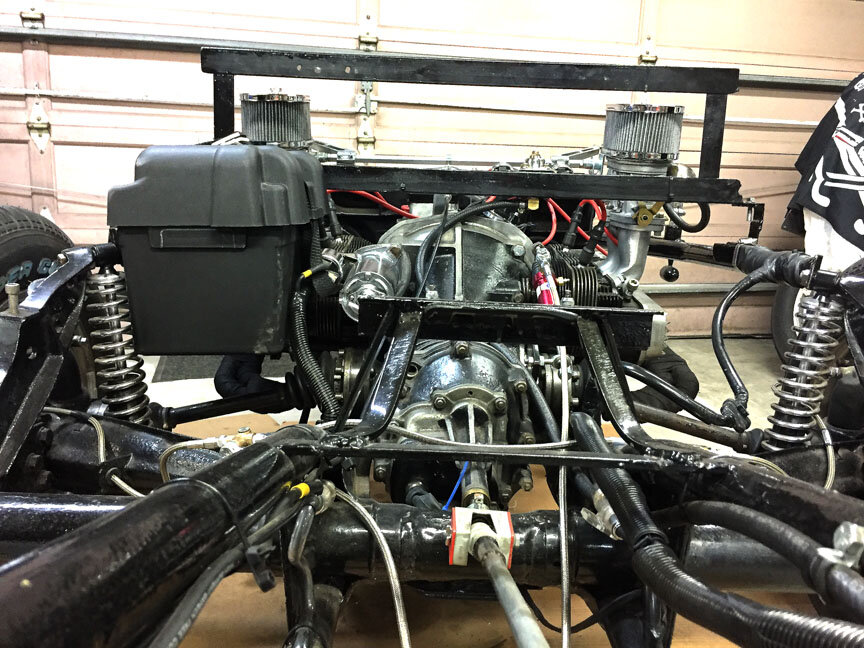

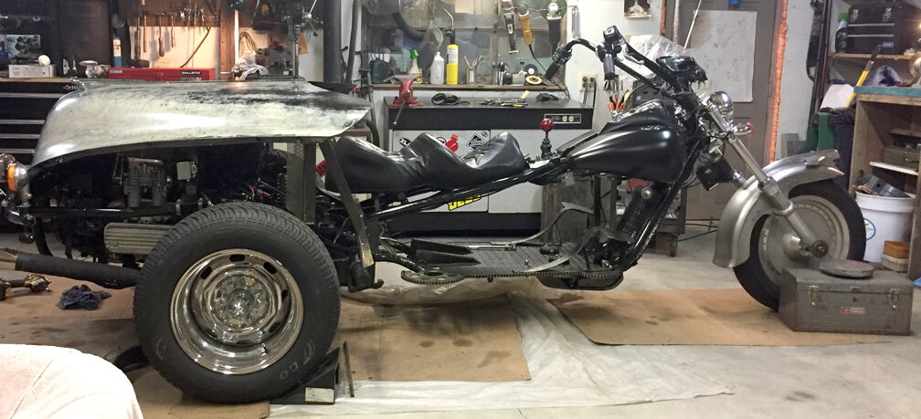

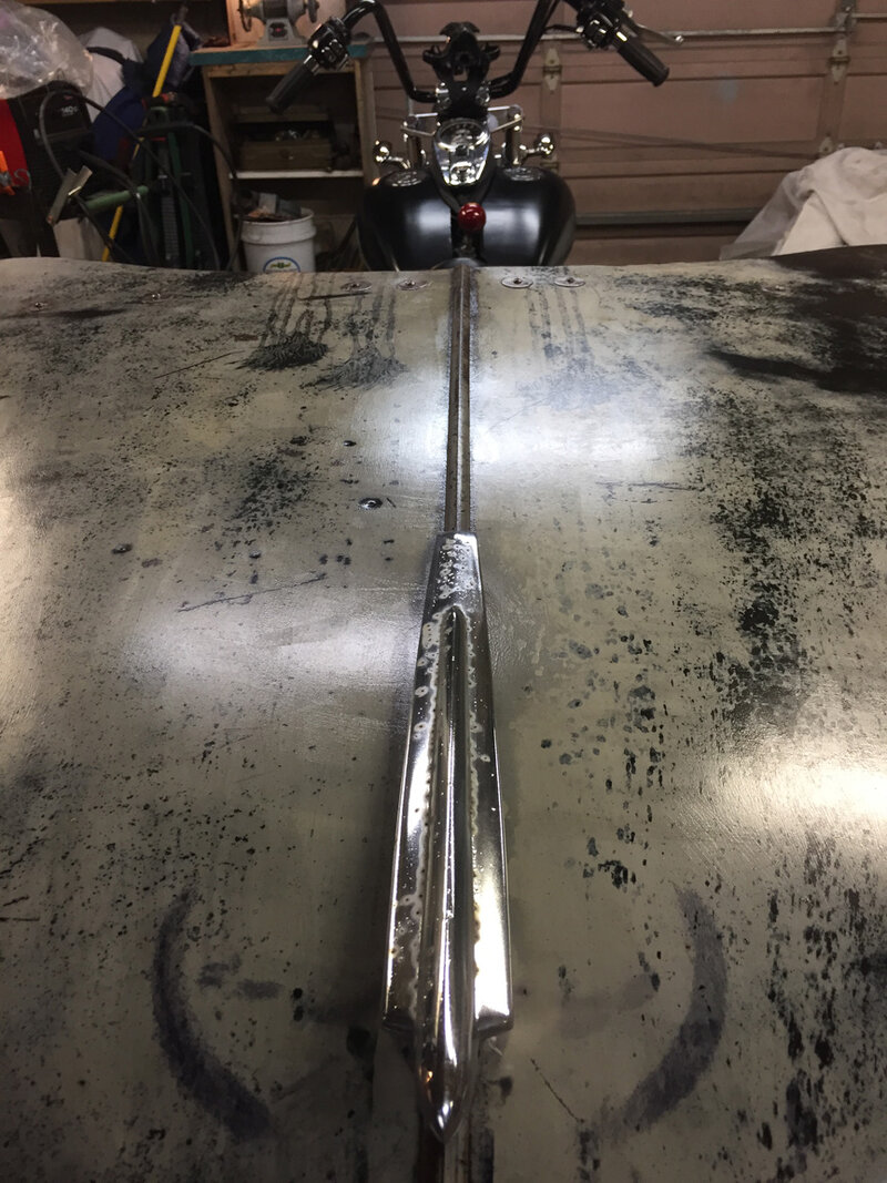

Here is what it looks like at the moment, I will be using the hood from a 1949 Chevy, so there will be a lot of space for air to flow,---
I know it's on the back of the trike...but it covers the engine... so it's a hood . Right? - I'll call it that-
So the hood will come right to the saddle, so behind the passenger spot- there will be a pebble guard, from the hood to the deck. this will allow air to flow pass the heads and the whole engine... I will also have a pebble guard under the engine, so basically making an engine compartment that allows plenty of air flow.
was also considering making a sort of shroud to channel the incoming air stream...

Ducted air flow can work. It is harder to do in the back.
Type 4 has a lot more fin area and can shed heat better than type 1.
The big drawback of ducted air is that you have to be moving for it to work. No city traffic, no parades, no stop lights......ect. Then you have trouble pulling a heavy load like a trailer. Normally you are so lightly load that you dont have have a lot of btu to shed. But demand more load means more btu to get rid of.
I would suggest finding the tins for your rear engine set up.

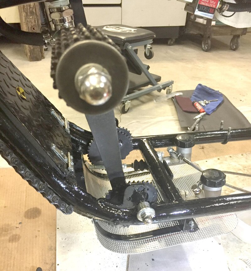

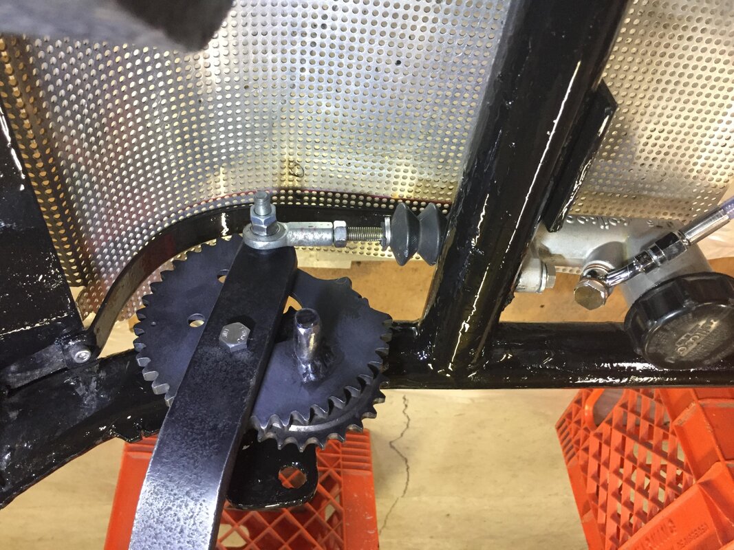

Awesome! thank you all for the info. I am in the process of re-building my pedals, I added a lot of length ( about 14"), hope that it will be sufficient, and I'm much happier with their over all mechanics ... i will get a copy of Fred Puhn's "Brake Handbook" ( it's in my ebay shopping cart), and if at the end of the day, I need to undo the whole pedal system and place the masters in a different location, I will...
I can't tell you all how awesome it feels to find other people that like building cool stuff, like trikes, who are kind and generous with the knowledge they have.:clapping:
Hey guys, thank you very much for all the help!

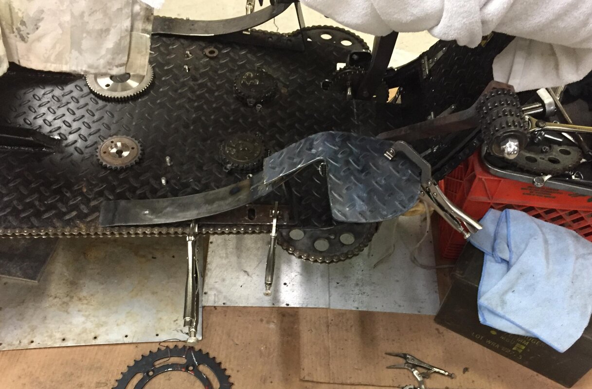

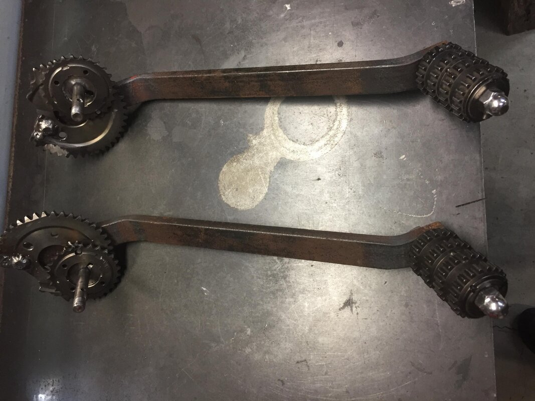

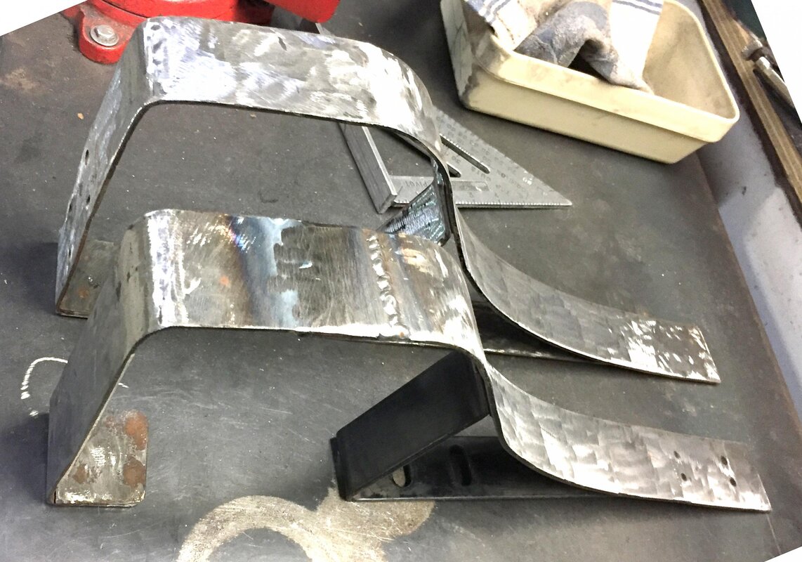

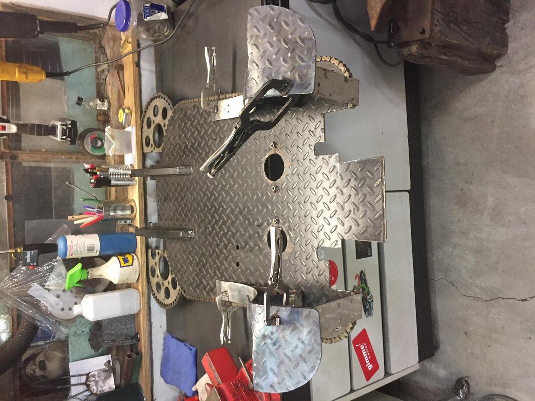

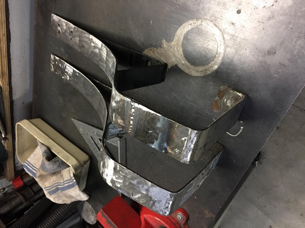

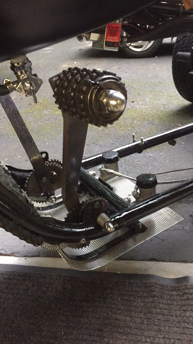

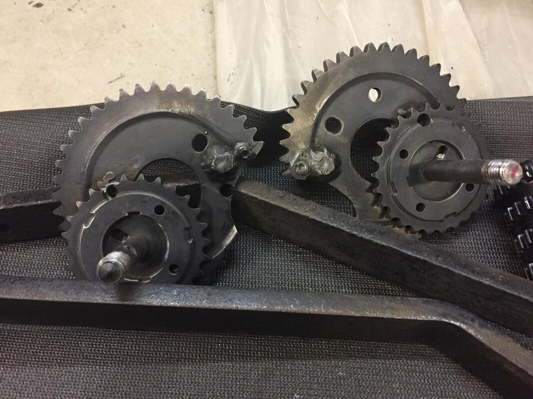

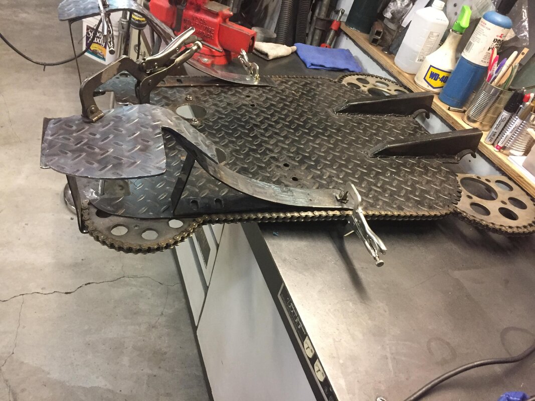

I finally got to do more work on the pedals... made them much longer, and of course, it took much more work than I anticipated. I decided to use much of the original parts and also some awesome scrap metal I found in the woods a few years ago. as soon as I got the pedals roughly done, I started it up and try the clutch... and bum! it worked ! I was able to get it in to gear with amazing ease, and so did the brakes. I could not get it in to reverse... but I need to finish the pedals, and make foot rests, because the pedals are much higher then before.
here are some pictures of the new pedals:

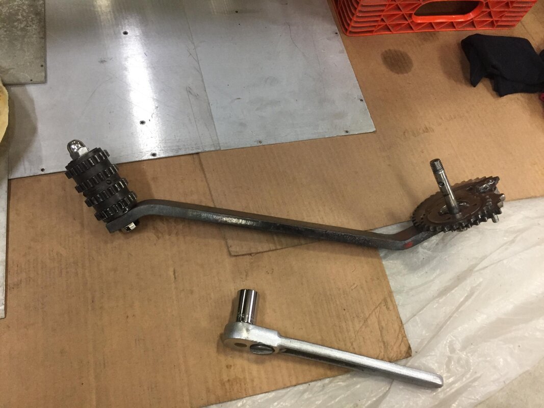

Got some more work done on y pedal, so here are some pics of the process... and I should be done with this job this Monday, so I will post more pictures then. I also ended up moving the battery box, so that it would not get in the way of the air flow to the right head. I looked at the tins that add for the tins that Rex recommended, and he does have the tins, but I can't afford it... he wants $650 - so I'm gonna use some cooling fans... but that will be ones I get the other stuff done.J- pedal ars.jpg J- pedal levers.jpgIMG_6239.jpgO- deck-n-rests 2.jpg

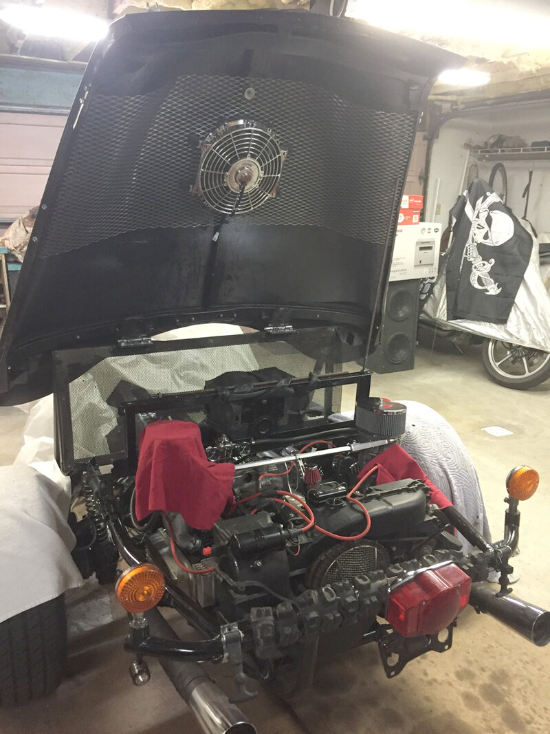

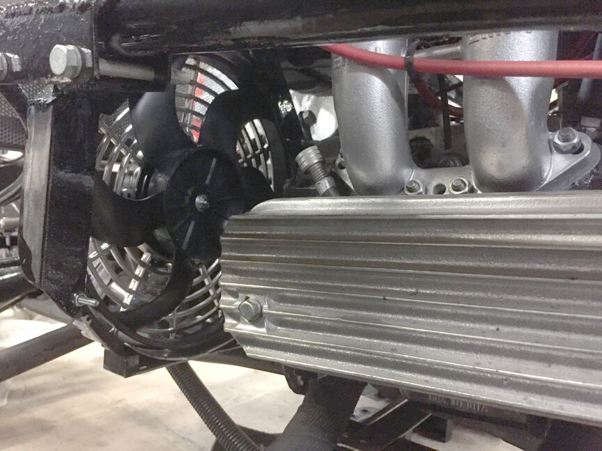

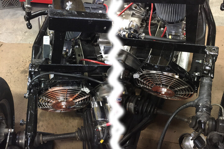

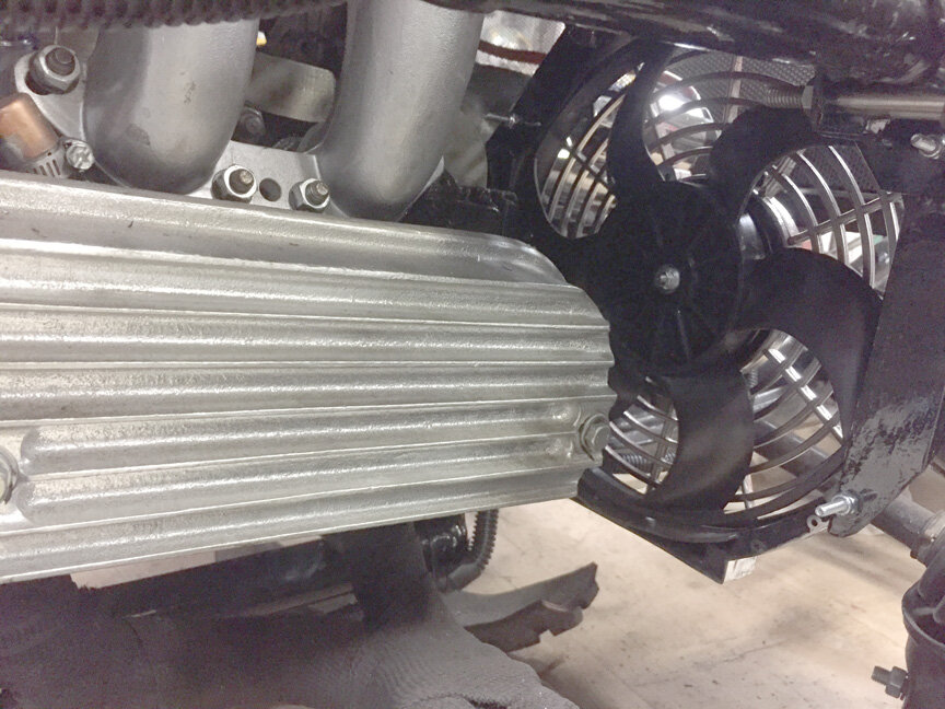

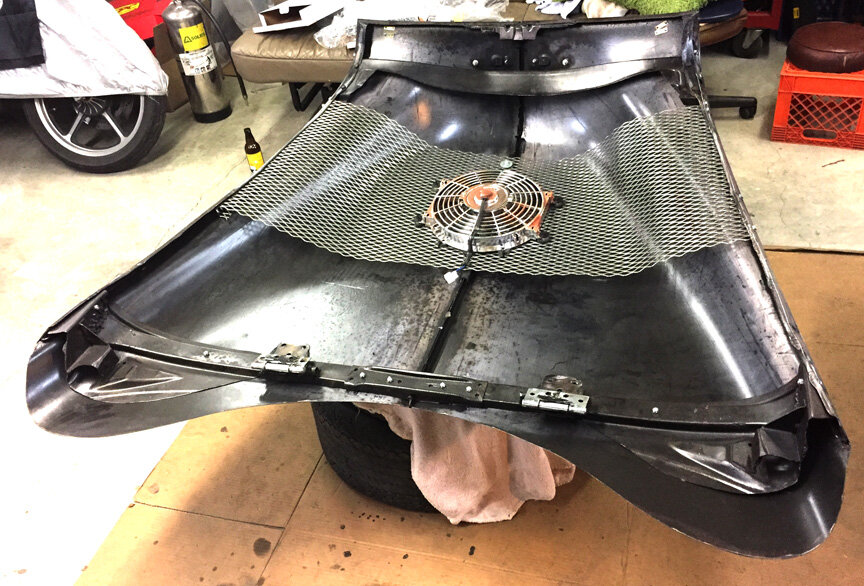

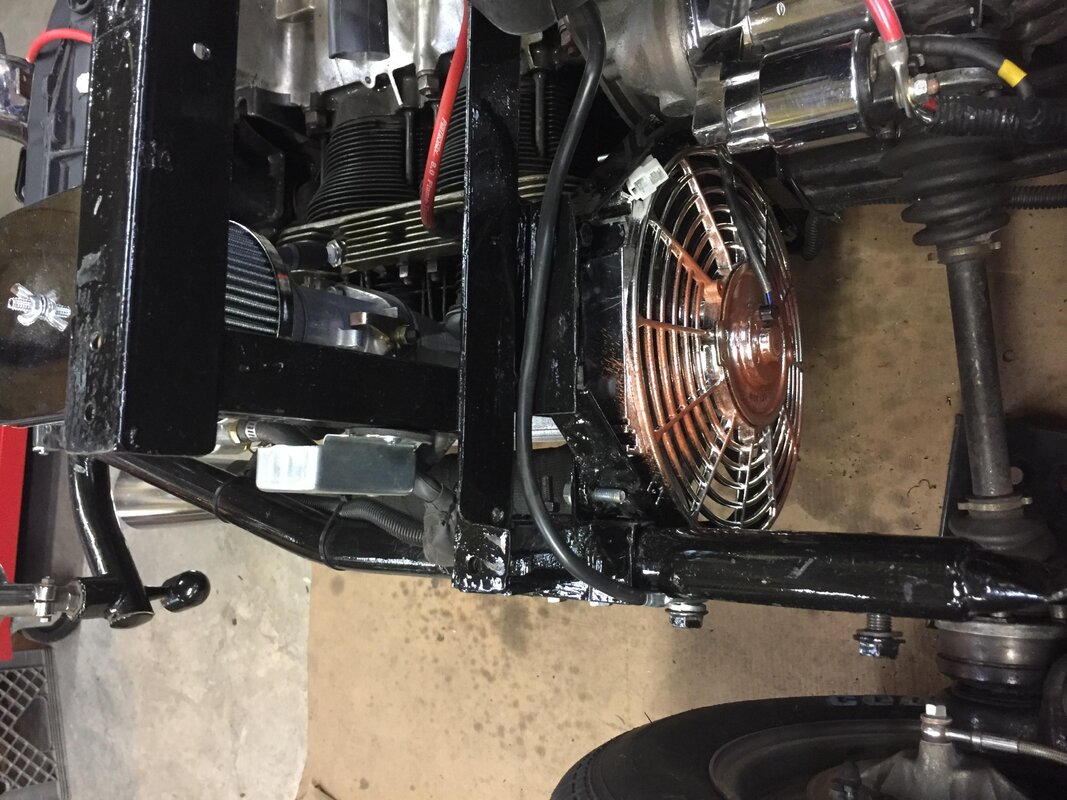

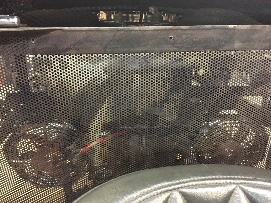

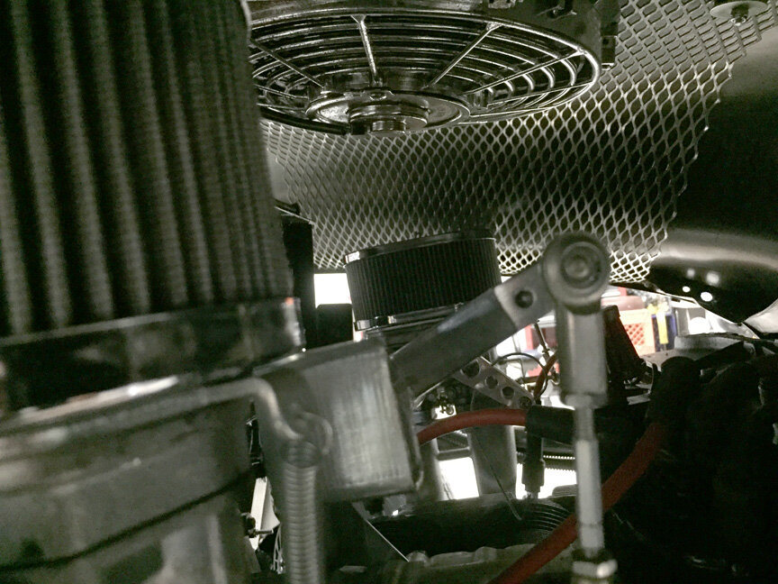

Hello trike folk, here I am again... after I got the pedals all done, I started to look in to the cooling system, and took a look at the add that Rex / deathbysnusnu -posted here for me, and the gentleman did have all the tins I need, but he is asking $600 for it, and I can't do that at the moment, so I decided to design a cooling system that would hold me over until I can spend the money on tins or an aftermarket Porsche cooling shroud, and as part of this new cooling system, I used a 1949 Chevy sedan hood, that I altered, so it would fit and house a nice fan. for now I think i will use a regular switch to turn the fans on when I'm not moving... If there is a way to get a temperature sensor or a thermostat that you guys know about, to activate the fans, I will do that, but for now I will be the thermostat.

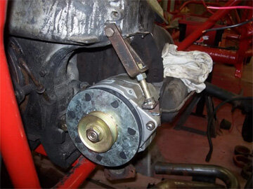

I do have a couple of questions for you guys... do you think that with this fans, I will need a more powerful alternator? the only one that I could find was a Porsche 914 alternator-
http://www.autoatlanta.com/Porsche-914-Alternator-Upgrade-srch.html
would I be able to use this in my 72... I saw a mention of a 120 amp alternator, but I can only find them for later models.
Also, should I get a pulley without a fan, to replace the one in my shroud... I'm thinking that the existing fan is not really doing anything other than create some resistance, and when people do those Upright fan conversions, the fan pulley is replaced with just a pulley. I also saw a conversion to a GM alternator that didn't look to hard to do.
