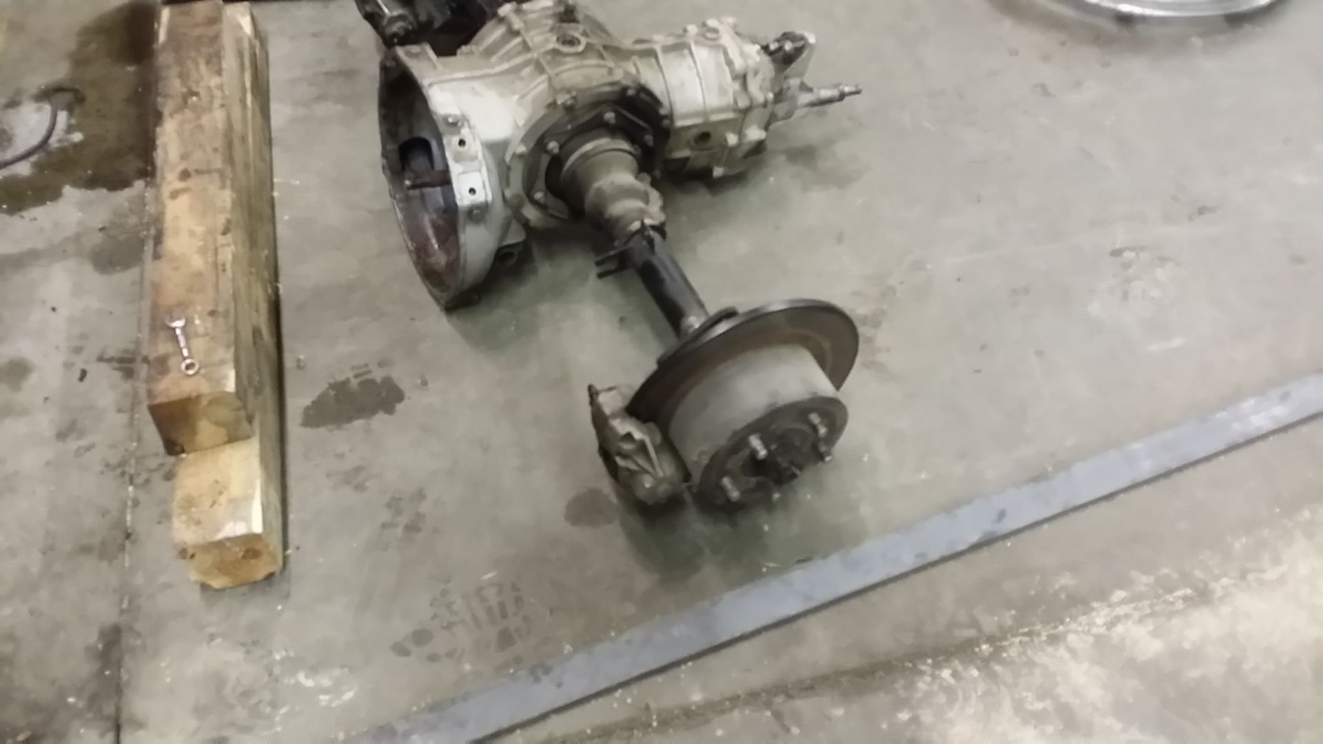

This is what peteg59 is talking about.
I got mine blank/no holes and put the bolt pattern on it to match the wheels I had.
Mine is a swing and i have a lot of offset to the inside.
