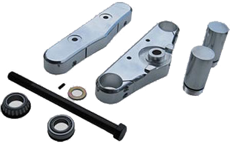

These extensions are made to work only with the VTX-TREME rake kit, as seen below, which has a completely different top triple tree design than the stock one, their's is enclosed. They are not made to work with the stock trees.

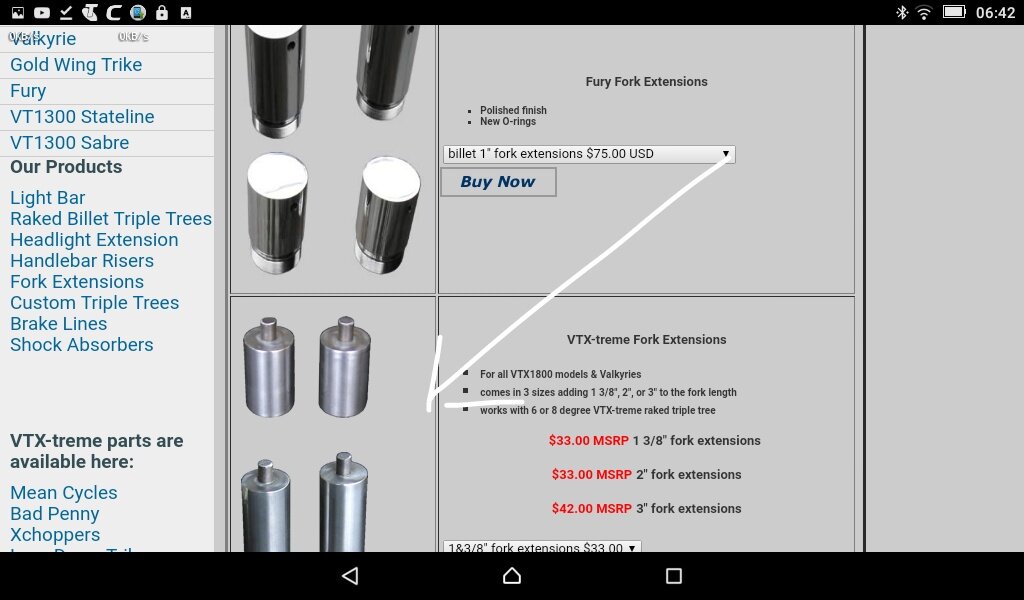

Sorry. "Secind from top meqnt ther actual second ones for sale. See attached.
Although I have to say, the 8 Deg Tripple Trees I am going to install are the blank topped VTX-Treme ones and I was concerned that only a special-topped cap or extension would work.
However, my question still remains. Does anyone know the ones I have arrowed in my attachment and if so, should there be more to what I have? How do those arrowed ones work? They have no way of screwing into the fork top, or actually extending the fork.

The Valkyrie and the VTX1800 have inverted forks. The extensions are installed internally on the top. They push the tube out further and hopefully you won't acquire a fork leak afterwards. I hope they included instructions.
Thanks for the reply. I think I will up for the tube type ones (the ones Papa Zook was referring to) which as I say was what I was imagining!
Can the tube be _pushed_ out further than with front wheel off the ground? I never did them up, just put one on an saw that something weird was about to happen AFAICS. Closed cap. Asked.
There are no instructions, but if you say the push out the fork even further then I think I have it right and I do not want them.

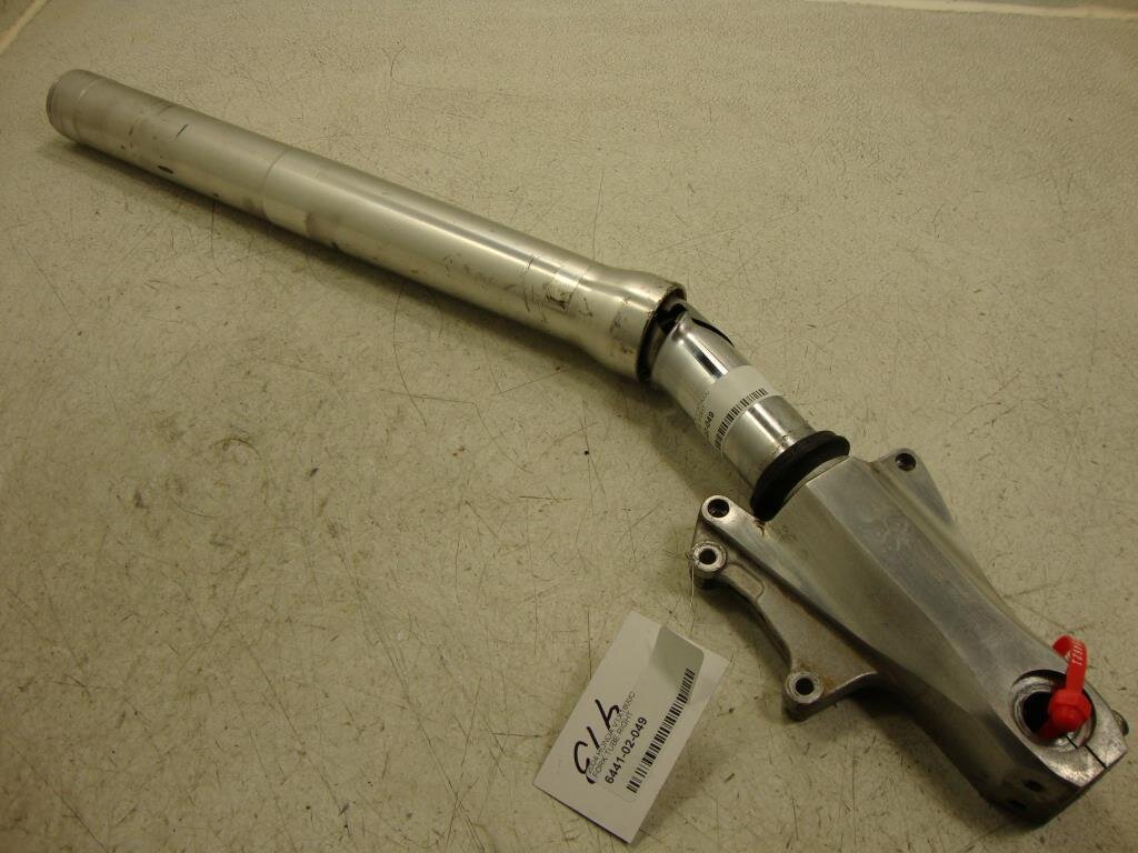

You might want to be careful, maybe think about a larger diameter wheel and relocate the fender. The fork bodies are designed to fit into the triple tree clamps in a certain position. There are two different diameters on the fork body. While doing a search I saw an awful lot of Valkyries with bent lower tubes. I don't know if they were caused by lengthening the tube or not. The VTX1800 has a similar setup.
hmmm...that's not bent that's broken. It looks to me as if the sort of extension that I have on approval shoves the fork out to its extreme and it disconnects. That is joint failure not bending.
hmmm...I can see the trouble if I actually THINK. The lower clamp, deals with a thicker fork...my immediate response is to shim the lower clamp to allow the fork to be lowered...but then the weak point in the fork is at the lower clamp, where all the force is...why on earth did Honda do this?
Is shoving the fork out to its max extent worae than weakening it at the lower clamp? Those photos of failed forks scared me. A trike will only make that worse....rake ans twist when turning.
