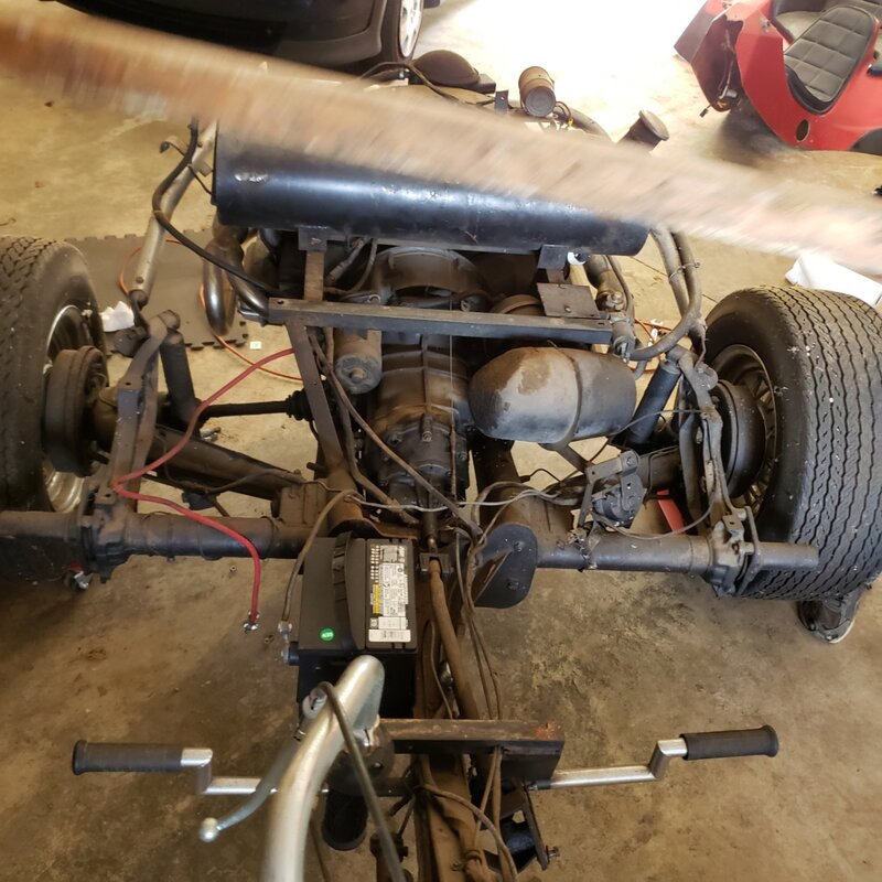

Wilmac body on VW trike, Springer front end. Not sure who built it. Both brake levers operate single master cylinder. Shifter sticks out hole in left side. Has a wire running up shifter handle, no sign of switch. Clutch arm attached to what looks like an air brake actuator, plumbed to air tank and electric valve and carb and manifold vacuum. What do I have here?
You have an automatic stick shift. The clutch should disengage as soon as you touch the shifter. Take your hand off after the shift and it reengages.
Thanks @SideCarBill! I didn't get many pictures, but was the vacuum tank also part of the semi-automatic or was it possibly added later? I tried to add a photo--we'll see if I succeeded.

Did a vacuum tank come with that set up or is the one I have custom? Will try to attach picture to next reply, thinking maybe attachment is killing my replies.

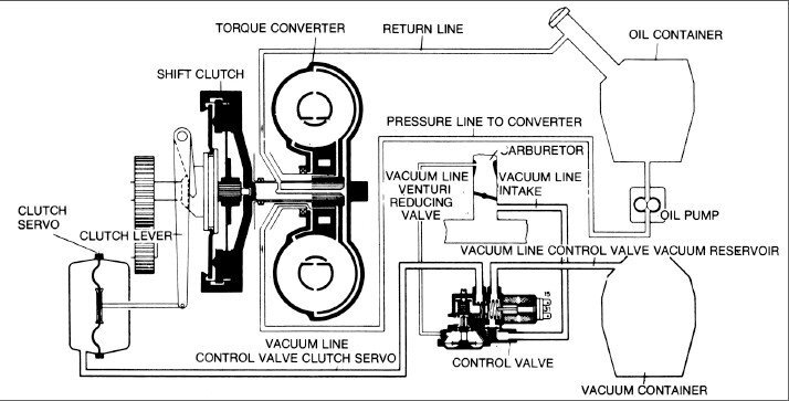

Vw called it an "Autostick"
The 3 speed box is a manual shift like any other vw.
There was never a full auto in a beetle.....this Autostick is as close as the beetle ever got.
Functionally it had NO clutch pedal.
The vacuum servo workes a small clutch for you. The vac servo is actuated by a switch on the stick shift lever. The switch is sensitive, just the weight of your hand on the stick will activate the clutch.
It will idle in gear at a stop light because it has a torque converter much like a full auto would.

How it works
The torque converter runs on auto trans fluid. It has its own tank and oil lines. The pressure pump for the hydraulics is piggy backed into to engine oil pump. It is a specialized pump on for the Autostick....and rare and hard to get
The clutch works on vacuum. Micro switch on shift lever turns on a solenoid valve. Which draws a diaphragm that is connected to the throw out lever. It also has its own vacuum reservoir tank and hoses.
