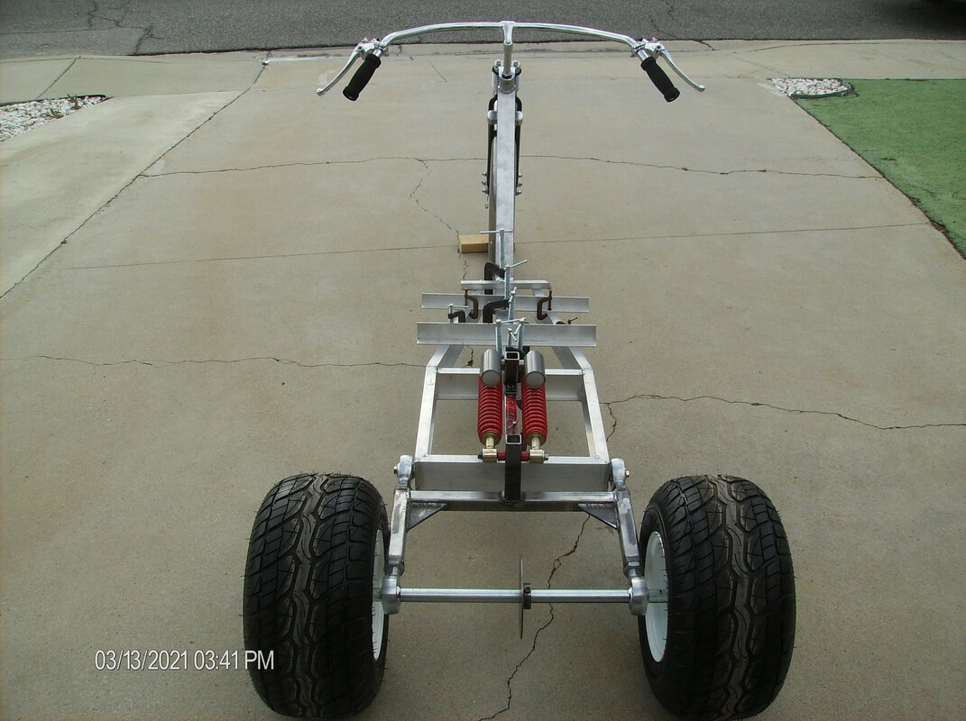

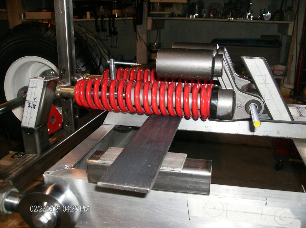

I’m not questioning your design,just curious about the layout of your shocks. In every application I’ve noticed it seems shocks were usually in the vertical position. On a few applications such as the IRS on the CSC Trike they incorporated a mono shock in a horizontal position above the rear differential with the left and right side upper A-Arms attachments to opposing ends of the shock. In my limited knowledge I don’t see the rear suspension benefiting from the design pictured. Again l’m NOT questioning your design, just curious. :wave4:

one thing is the height
another consideration is the fine tuning of a heavier shock/spring into a lighter one by laying it over at the angle that gives the right support and travel to the suspension.
2021-02-27-256 Shock mounts.JPGCan you see where I am going with these shock mounts? right one will be adjustable for ride attitude... Going to look pretty cool HUH!!!:clapping:

Hi David, thanks for stopping by, The reason I am leaning the shock is for looks, It will help give it the wow effect as will the bicycle springer up front, the batteries will go under the shocks and the seat above. I thank all you guys for your support on this build and the others... TrikeMan did you see my 1st trike in "Introductions"? Red fiberglass body sim to yours all hand made, yes it took a while, :clapping:EDIT: And don't be so hard on Tn. :D

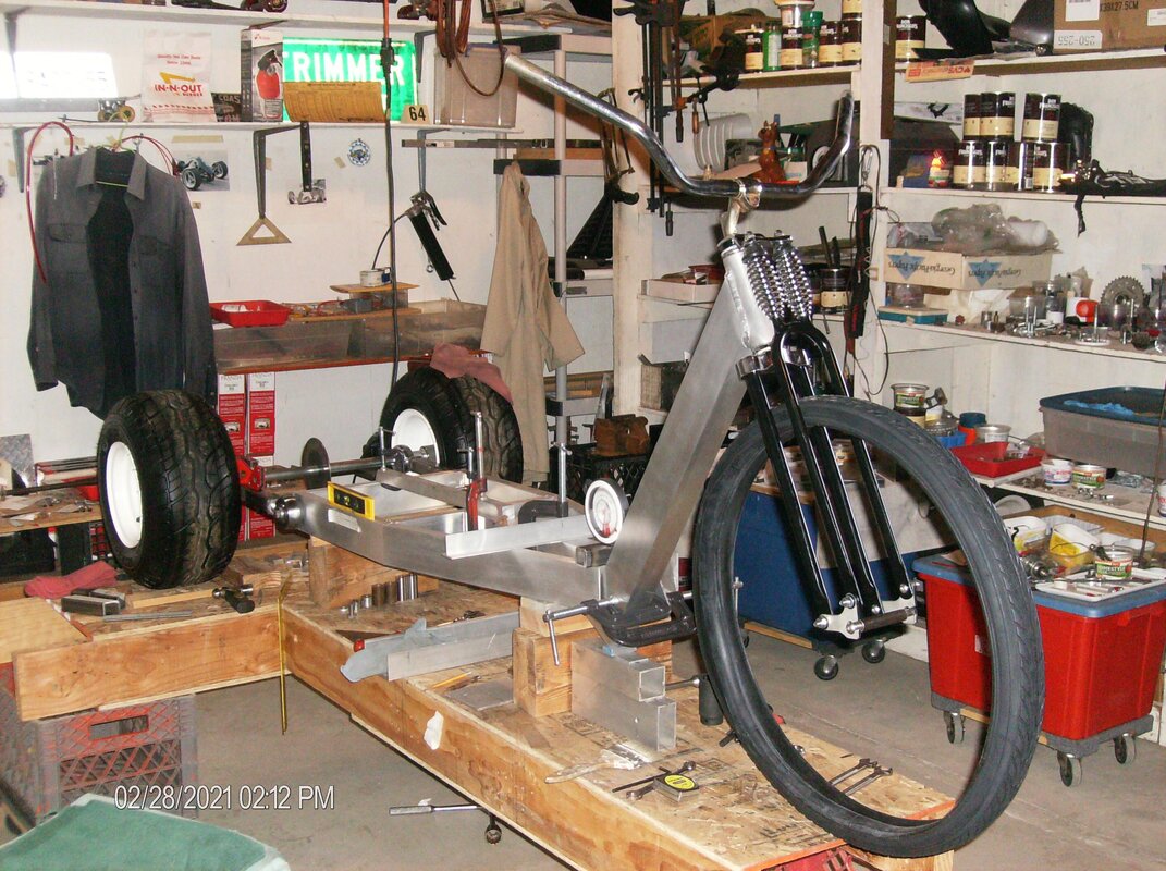

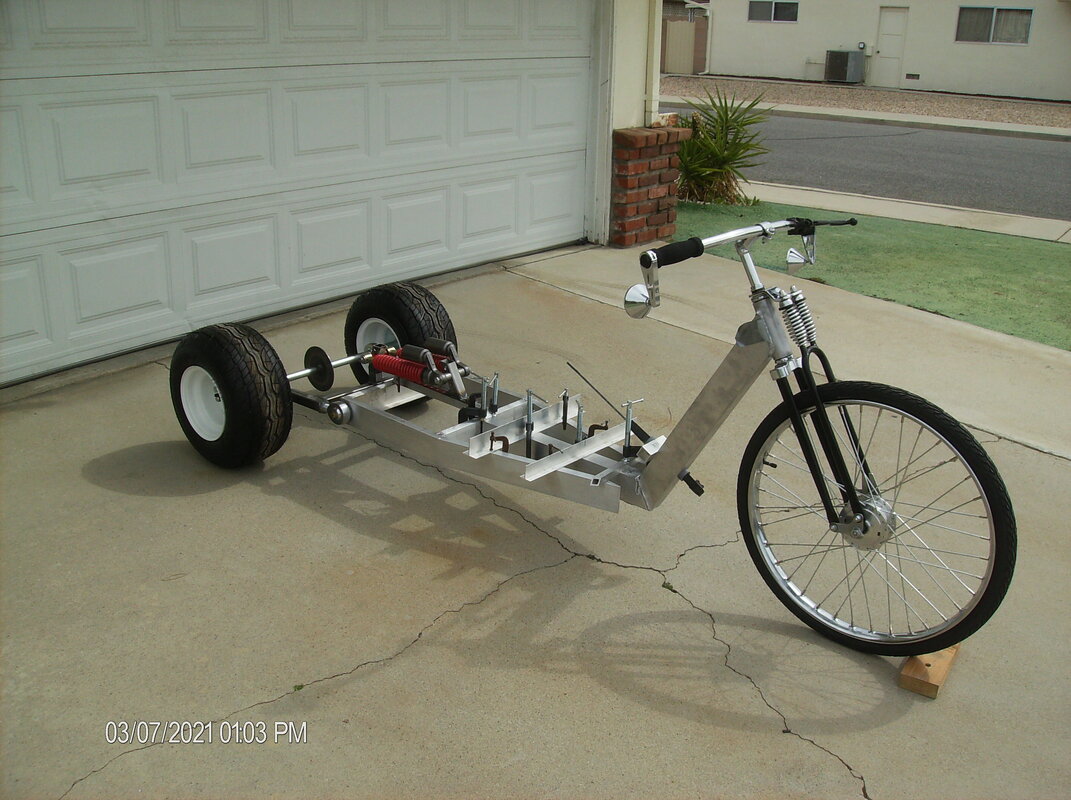

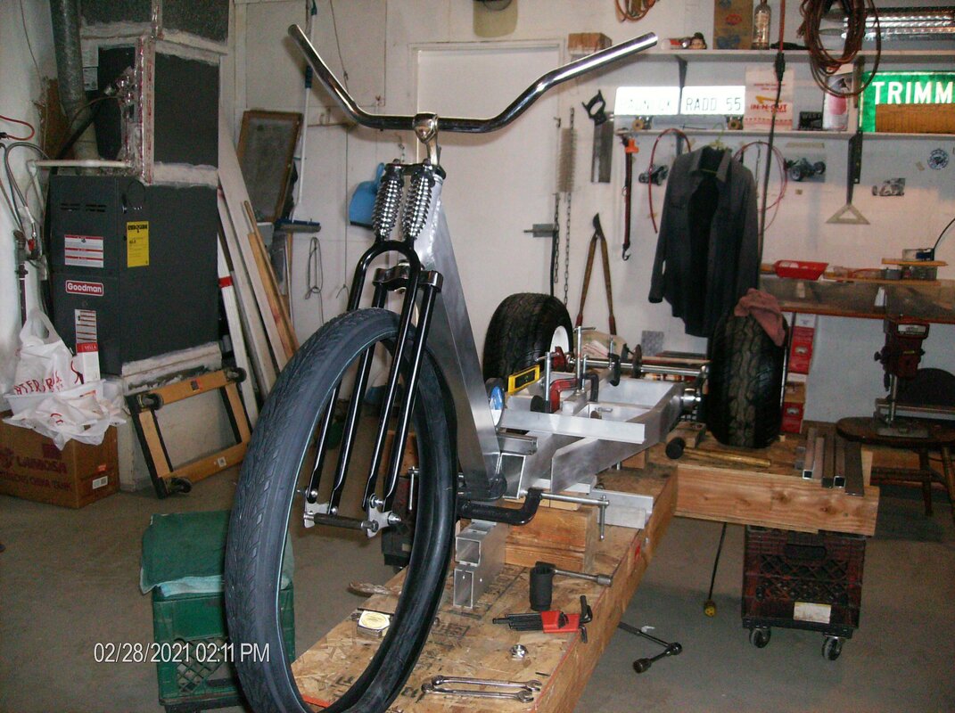

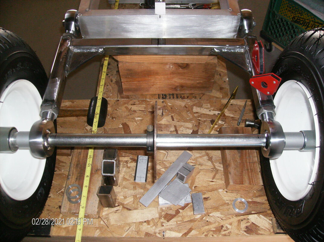

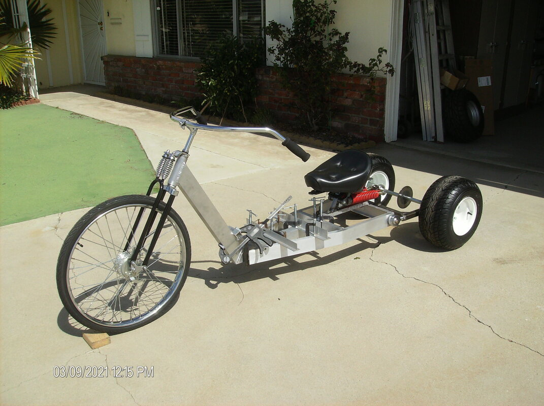

2021-02-28-261 SwingArm.JPGNow I can call it a swing arm, need to figure disc brake and sprocket soon,2021-02-28-261 Mock up Springer.jpg-2021-02-28-259.jpg Got in some serious mock up time in today, tomorrow machining and weld for shock mounts, AND near ready for Alum. weld for the head stock frame, then weld to frame and set up the frame gussets.:clapping:

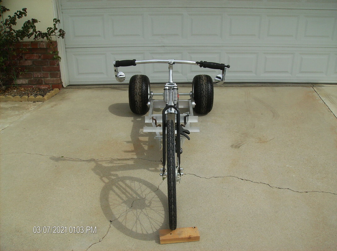

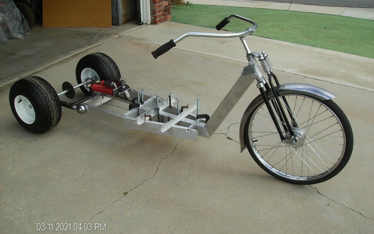

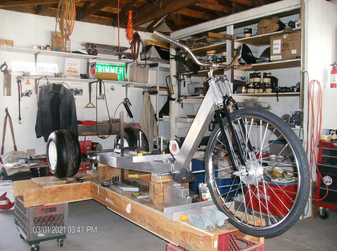

2021-03-01-263 Springer&Wheel.jpgOhhh Ya! Now this is the look I am after (BigWheel), Can't find a goose neck I really like? Then I'll set it up with drag bars or may be pull backs, Dropped off the brackets for the shocks at the welder then the alum mount and frame welding, HappyHour with a smile...:clapping:
What does it look like with the bars you have flipped over?
Hi Rallsqh, I am just using this neck and bars from my wife's 1956 Schwinn all beat up for looks, trying to find a heavy duty good looking 1" thread goose neck and start with straight bars and maybe pull backs?1Trikester.jpgThis is the "Trikester" I built many years ago with pull backs, looked and worked great, SO?

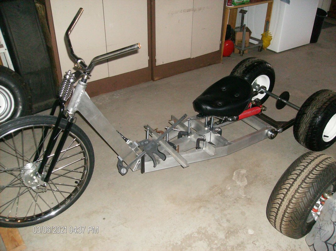

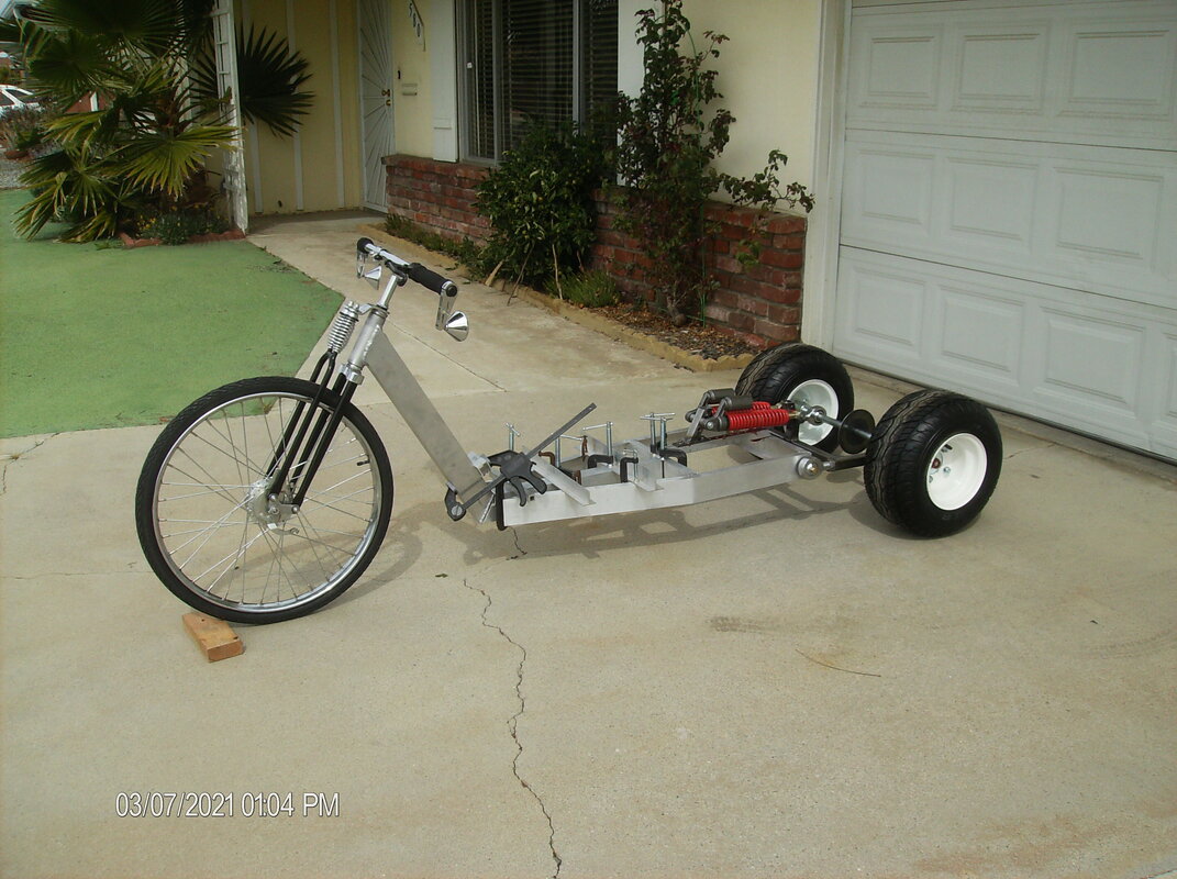

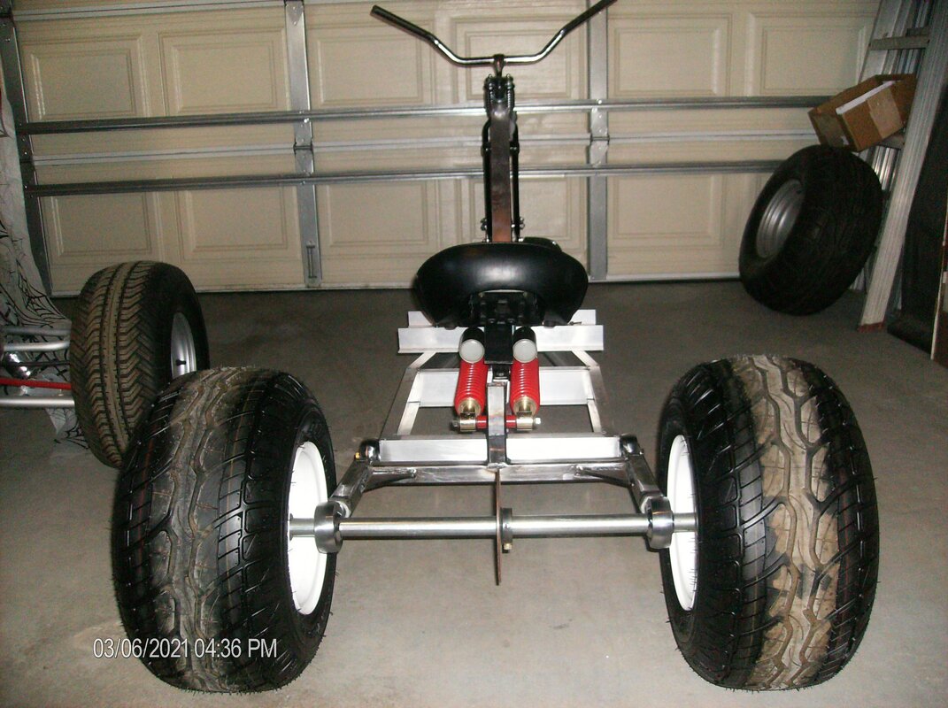

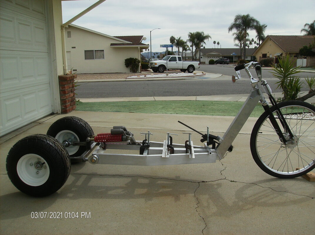

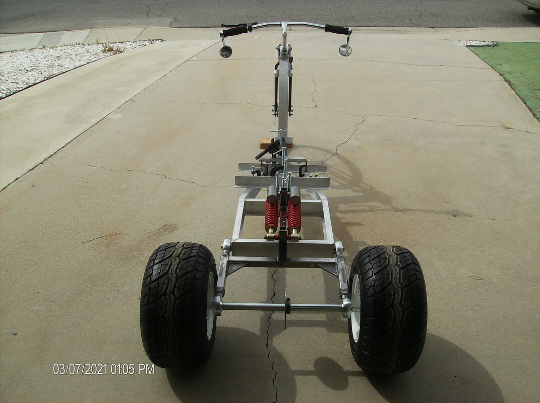

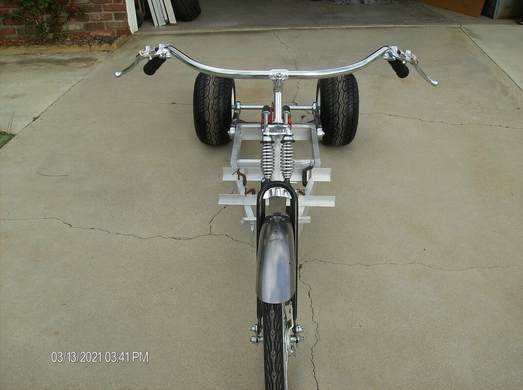

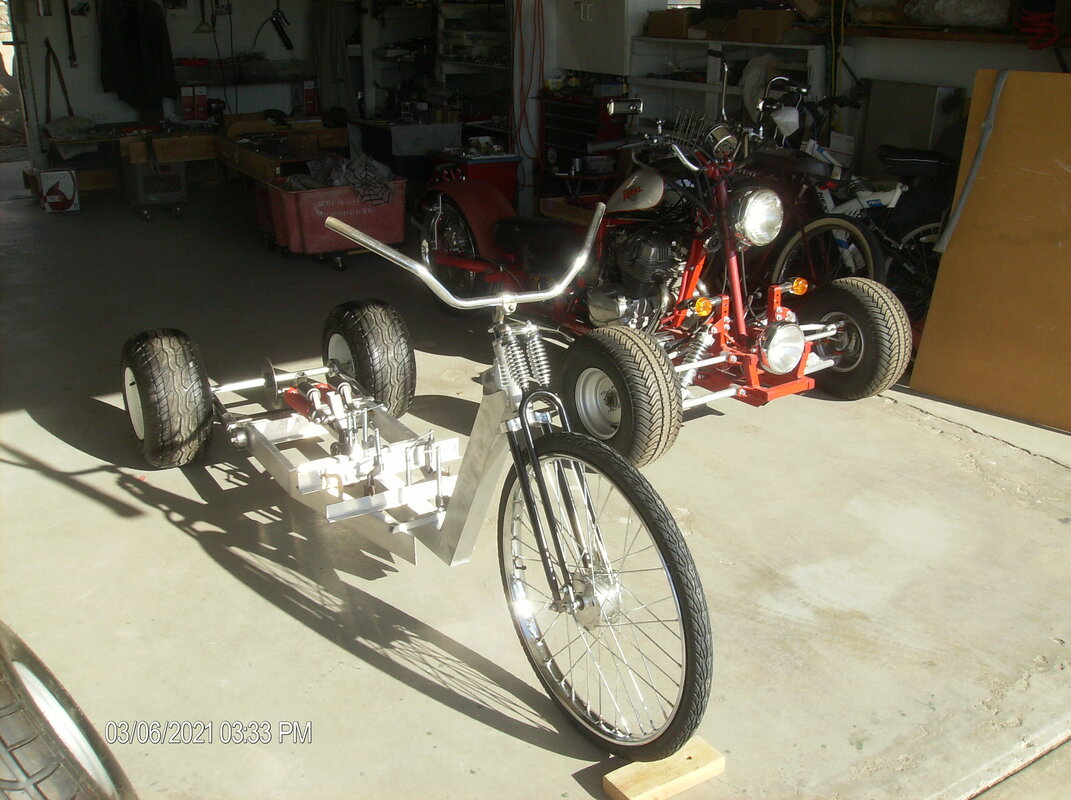

2021-03-06-272 Mock Up.JPG-2021-03-06-277 Rear.jpg-2021-03-06-278.jpg Now this is MOCK-UP, You can see where I am going with this, hope to get the goose neck and handlebars soon, Ride height? Wife say's more up...:D

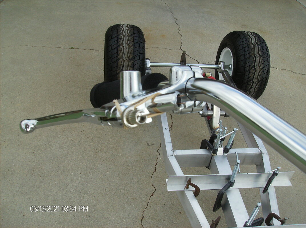

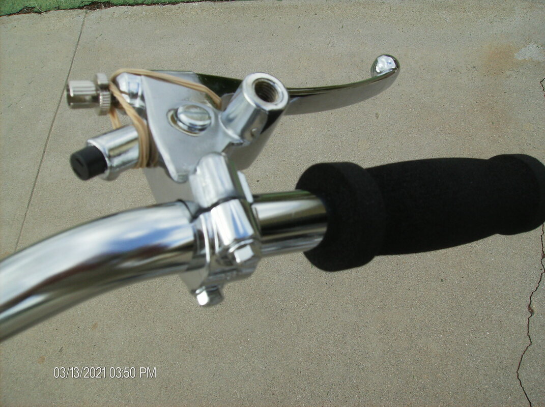

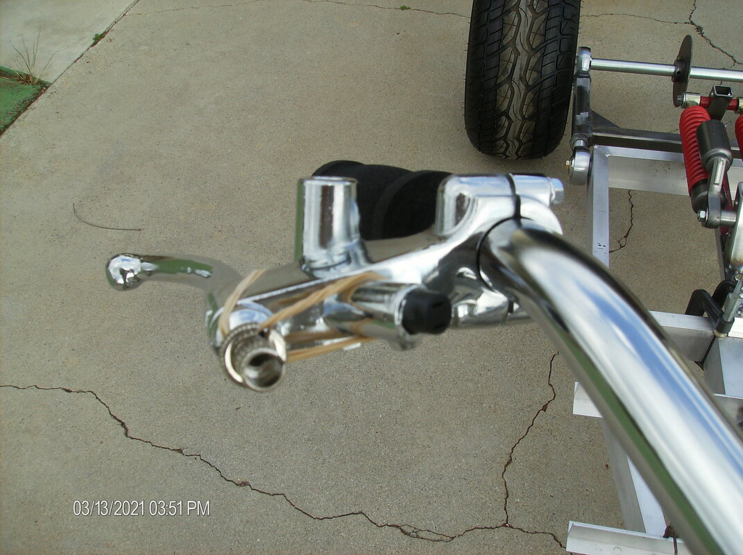

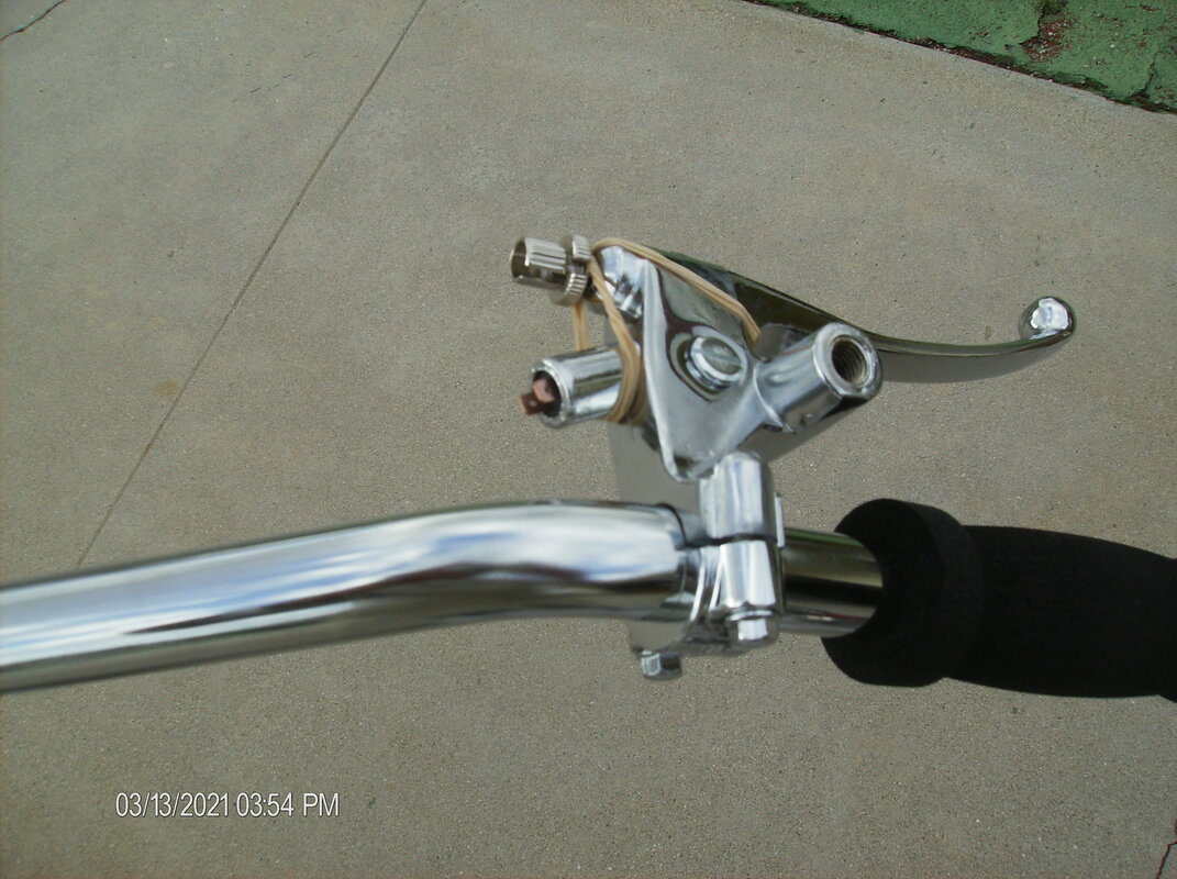

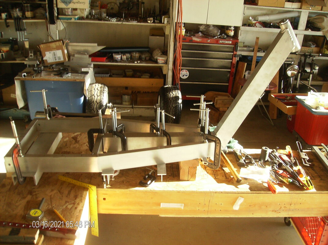

HPIM4307.JPGHPIM4308.JPGHPIM4309.JPGHPIM4310.JPGHPIM4311.JPGHPIM4312.JPGLevers are in and what a all day bitch trying to just what I wanted, plated, mirror mount and cable/electric brake both sides, I am hoping for brake lights and flashing running lights, NOW does anyone know of a connector and pig tail for these electric ends??? :gah:Tare down tomorrow for Alum. frame welding on Monday... :clapping:
Switches in the brake levers will not work, sooooo! return, Tare down time,HPIM4313.JPGHPIM4316.jpgAlign and weld. Now I can order the motor kit and start on the brackets for brakes and sprocket. Hope the check is in the mail tomorrow???:gah:

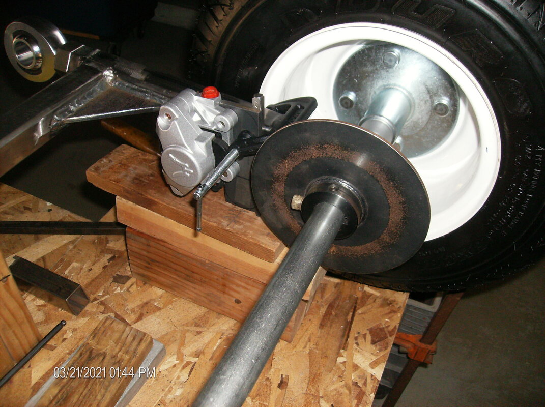

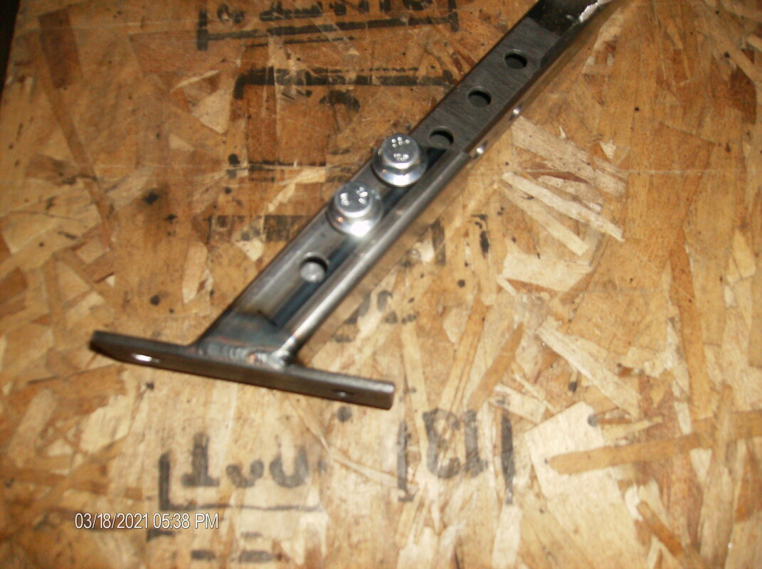

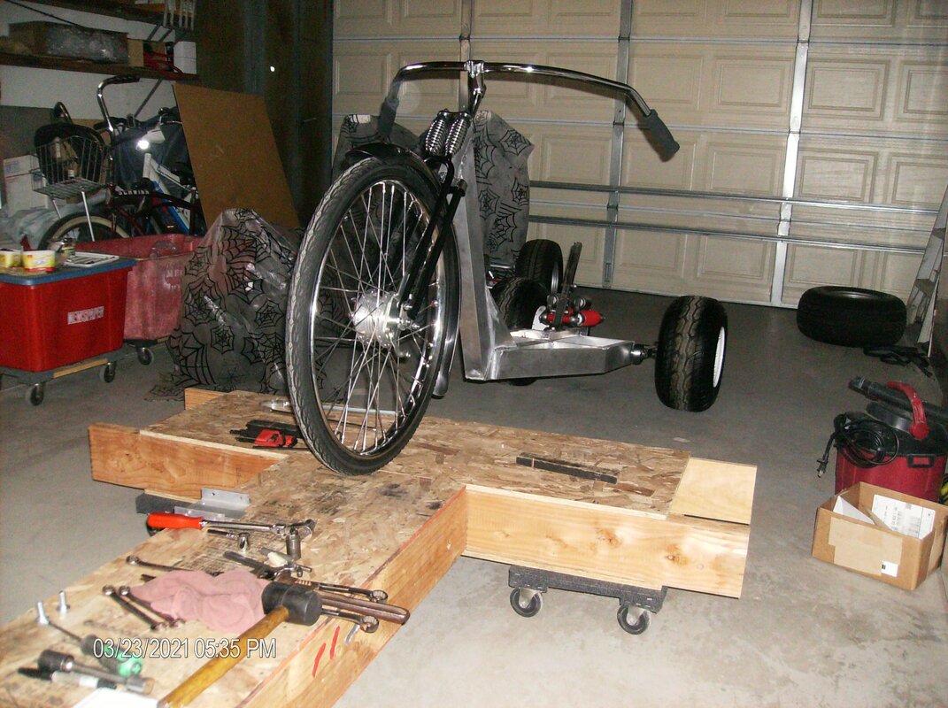

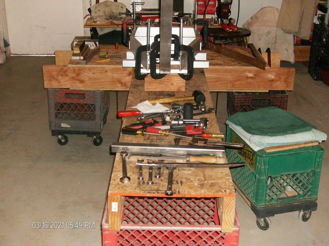

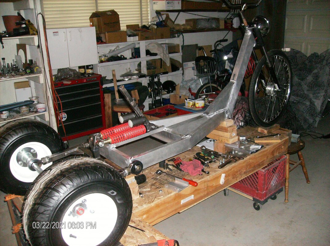

2021-03-22-325.jpg-2021-03-21-322.JPG-2021-03-18-317 Seat Post.JPG-Back from the Alum. welder, Trying the other forks first, Ordered a 10" Rotor because of the swing arm/HeimJoint offset and started alignment of the caliper. The seat post/forward shock mount is ready for measurements and cutting to size with the seat bracket. Still waiting to order the electric kit, $$$:wave4:
2021-03-23-326.jpg Garage Time:clapping: Waiting on the 3rd set of levers, The other 2 sets have broken switches, so I found a USA company that makes them for electric bikes that need shut off and/or brake lights. Fender brackets?

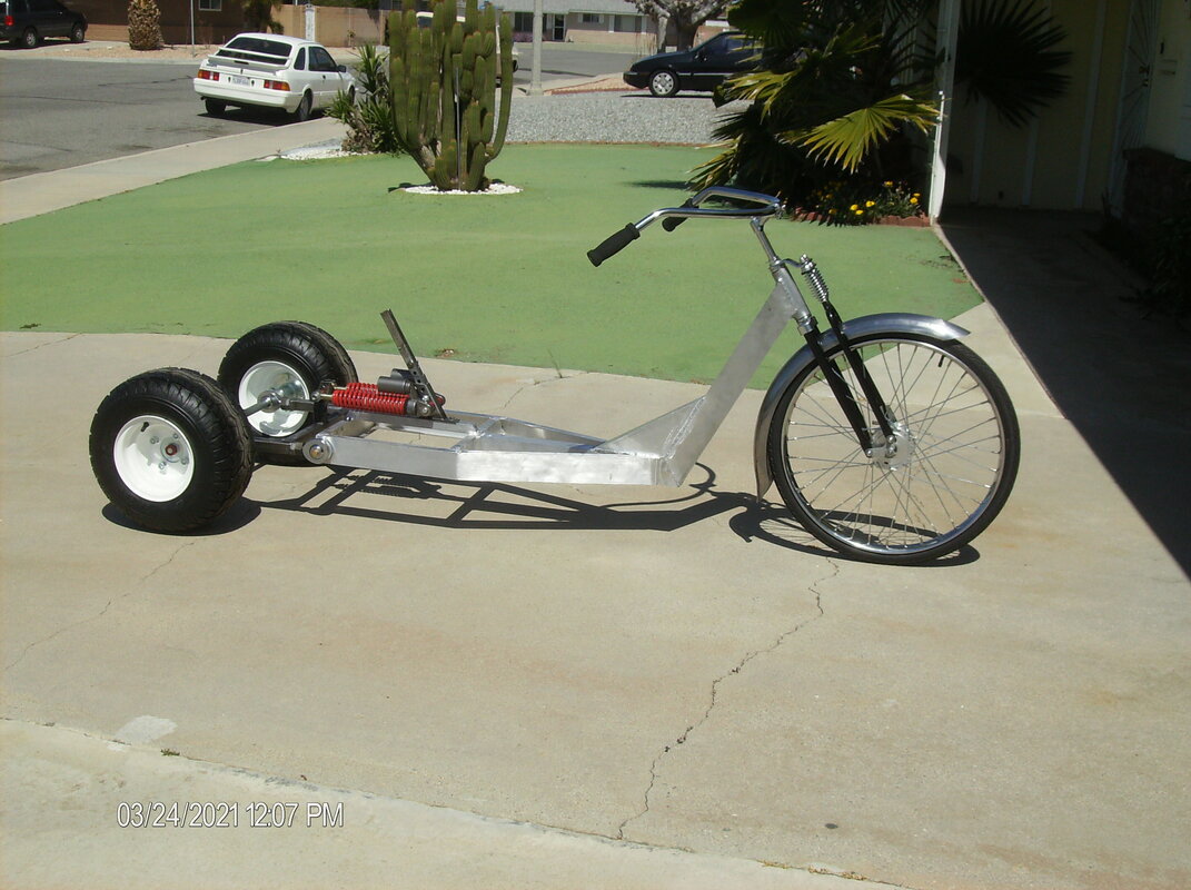

2021-03-24-327 Frame welded.JPGDid you notice the first gusset? I love the way it sits (attitude) Working on the seat post, Fender brackets, 3rd set of levers are in and look really professional, off today to pick up the caliper bracket that will be welded to the swing arm for trial then back for final weld, When the money comes in I'll order the EV kit and start placement of the Batteries and wires...:clapping:

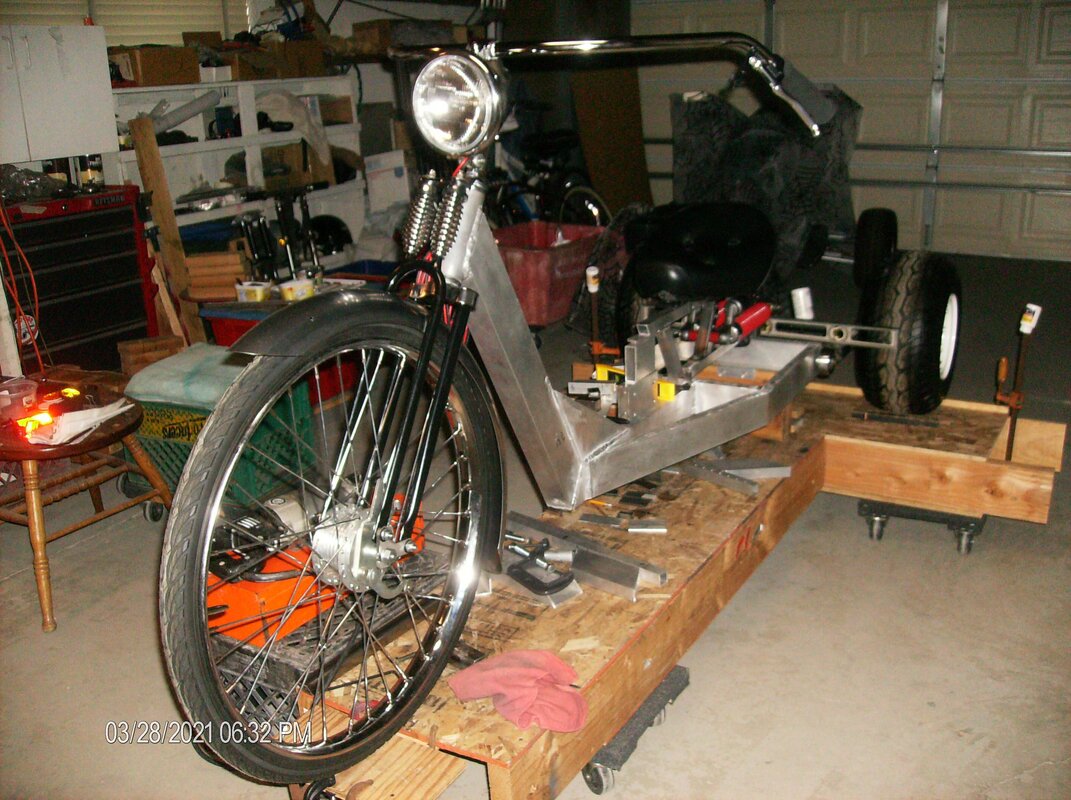

2021-03-28-342 Seat frame-H-light.jpgOK, Jack/Guy's I am thinking this style for the front end? Still working on the seat frame with what material I have laying around and the look of cool!:clapping:
This would look bad ass;)
