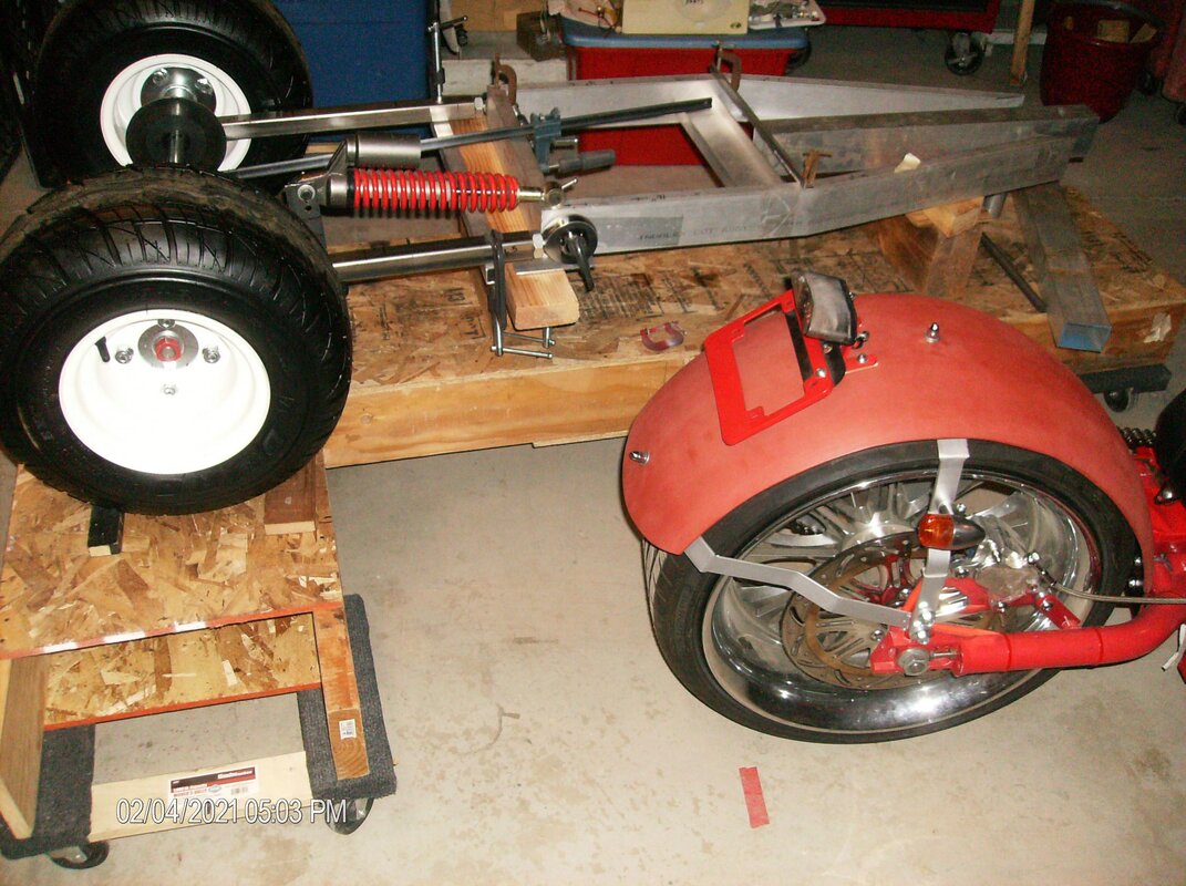

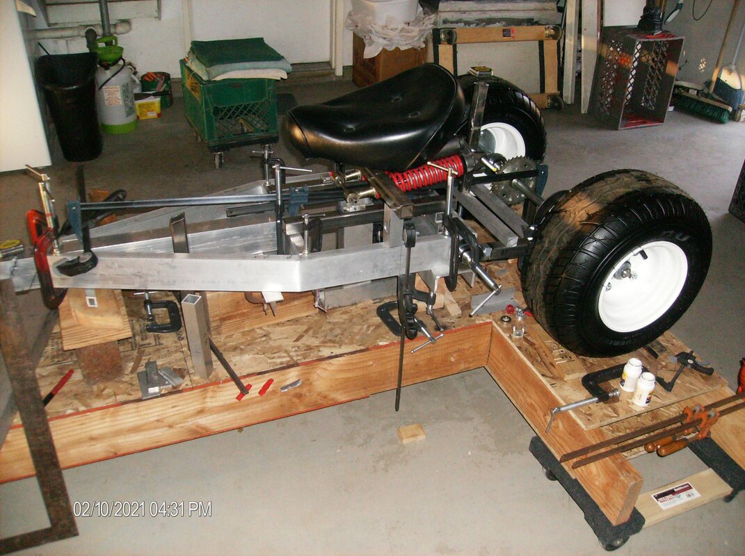

Aluma Trike, Since this is not a tricycle and will be powered by a front wheel electric motor or a Briggs and Stratten motor I am going to post this as a possible build. The frame material will be 6061-T6 aluminum (aerospace) the forks will be from a 1940s whizzer with 26" hub motor, the rear will have 16"x3" or 18"x 6" 8" rim dia. I want the rear to have a suspension so I am thinking wide 16" swing arm with coil over shocks and a motorcycle seat, This will be used for local travel (parts/beer chaser) 25 MPHish and bike lanes, This will also be Ca DMV compliant. The first photos will be of Tri Pod1 I built many years ago so this will follow the same build but different. This should also be a low budget fun thing that you can also drive on the streets...EDIT: 36V 350W 25MPH 20 miles of travel.
First build I was so proud, then the neck broke-

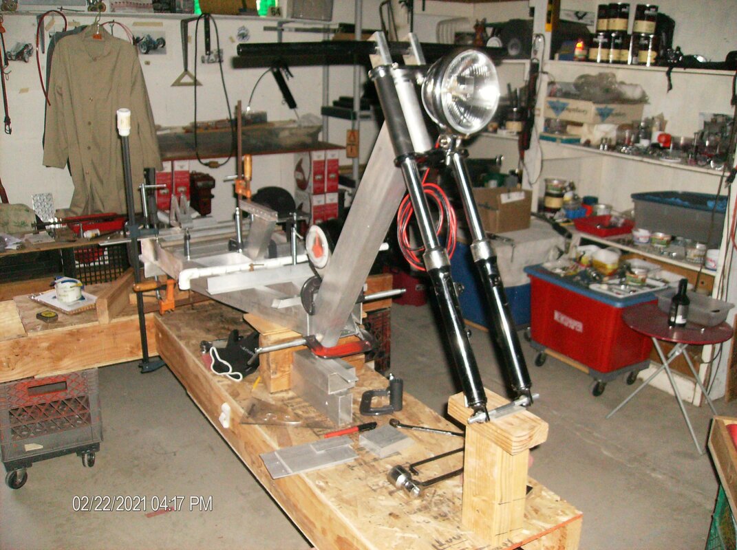

Big Wheel, Chopper style. PLEASE PLEASE PLEASE your opinions count, Shall I build TriPod2???

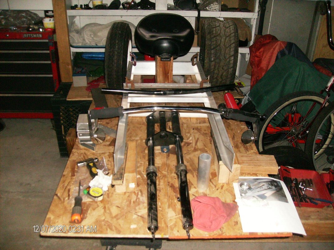

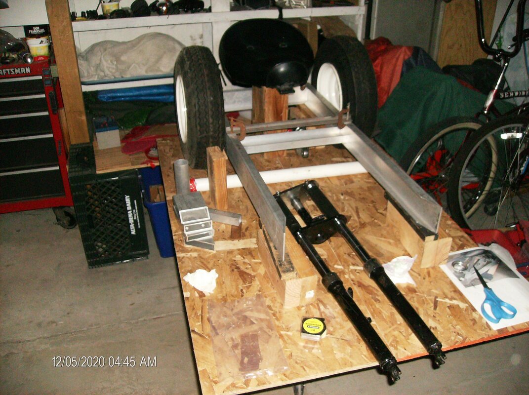

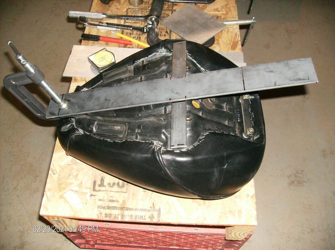

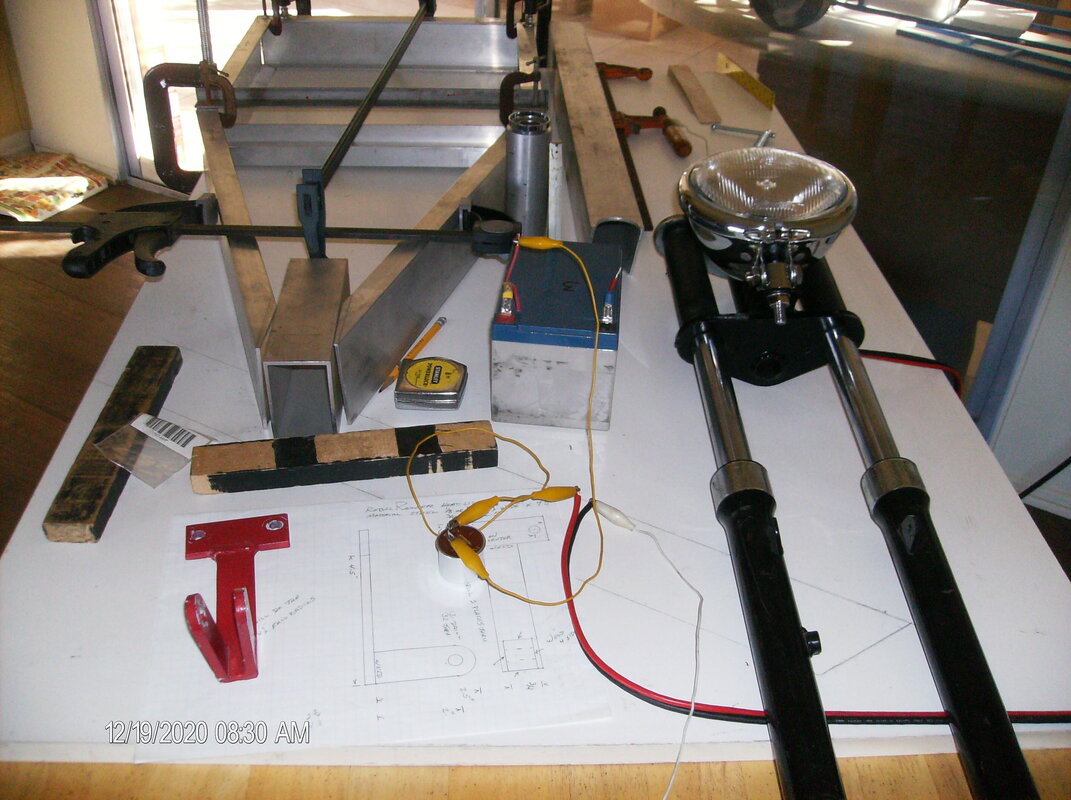

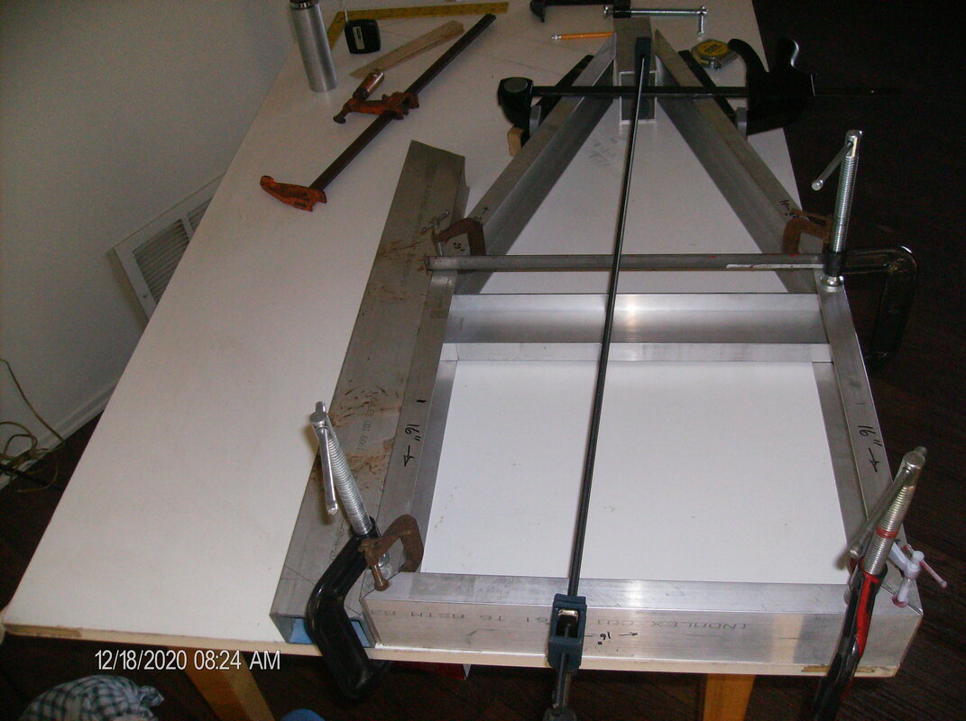

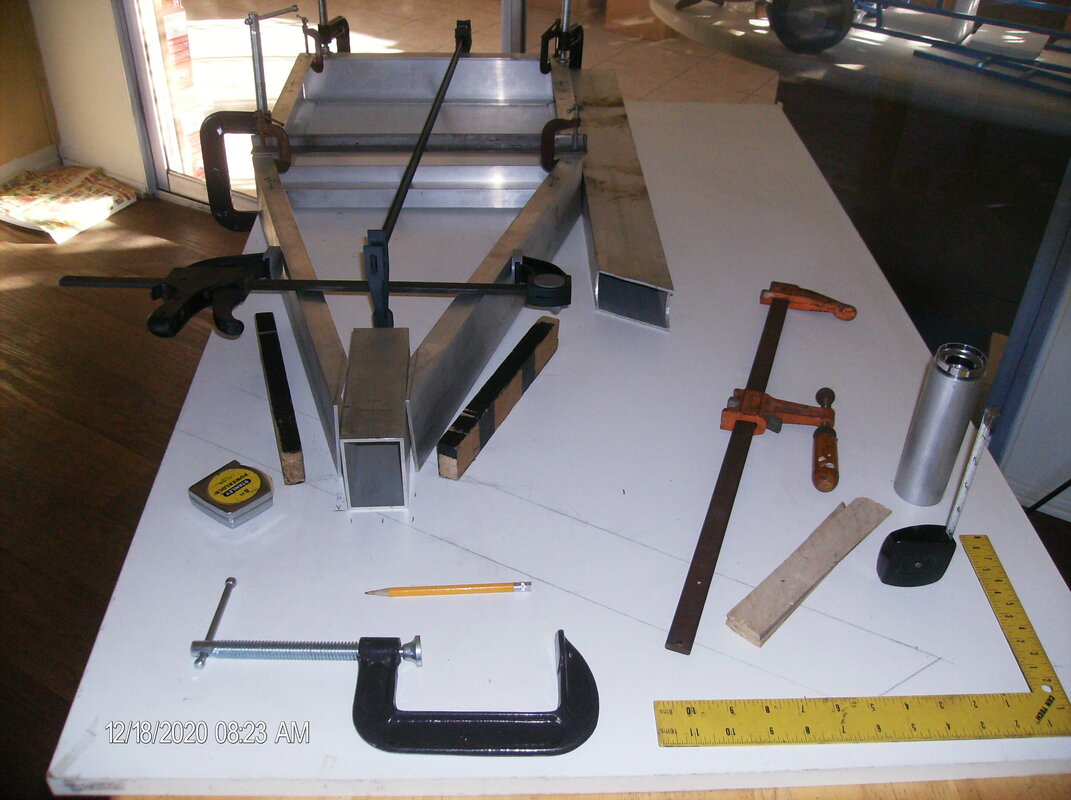

2020-12-17 TriPod front.JPG-2020-12-17 TriPod rear.JPG Aluminum frame is aerospace 6061-T6, 1"x3" channel, some boxing, Rear axle will be 1"x 30" go cart live and dead hubs 4x4 with 8" rims and 18" x 6" wide tires, M/C solo seat, If I do not hear from my neighbor it will be electric, 1K Watt x 48 Volts x 20Ah, lith ion Batts, I hope to hit 30 MPH. There will be no DMV necessary with this one...
TriPod-48V 1800W-bgt.jpg-Full Kit Brushless 48v 1800w Electric Motor Speed Controller eTrike. This is what I am thinking because everything is there even reverse, BUT! It should only be good for about 30-35 MPH? Not bad for local kick azz driving/riding... EDIT: And maybe???TriPod2-29in Front Forks Assembly Triple Clamp Rotor, 19in Wheel.jpg:clapping:

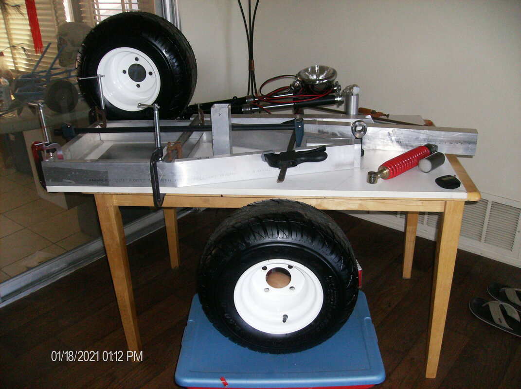

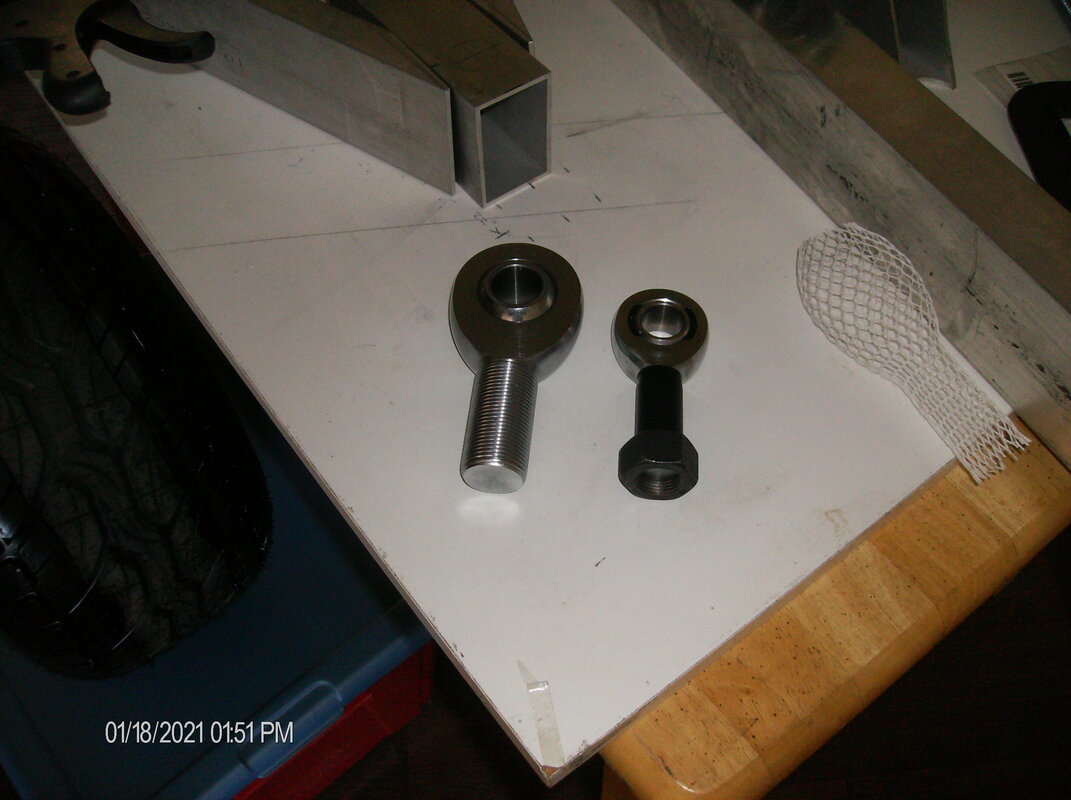

Tires got mounted and colored, 2021-01-18 Tires mount and color.JPG-AND, Damn the clevis people on eBay sent the wrong size OD threads, I ordered 1-12" threads and 1" ID for the size of the axle, DAMN! now I need to send them back also, DAMN SELLERS ON eBAY...2021-01-18 HeimJoints.JPGThe size on the right is 7/8 thread and ID...

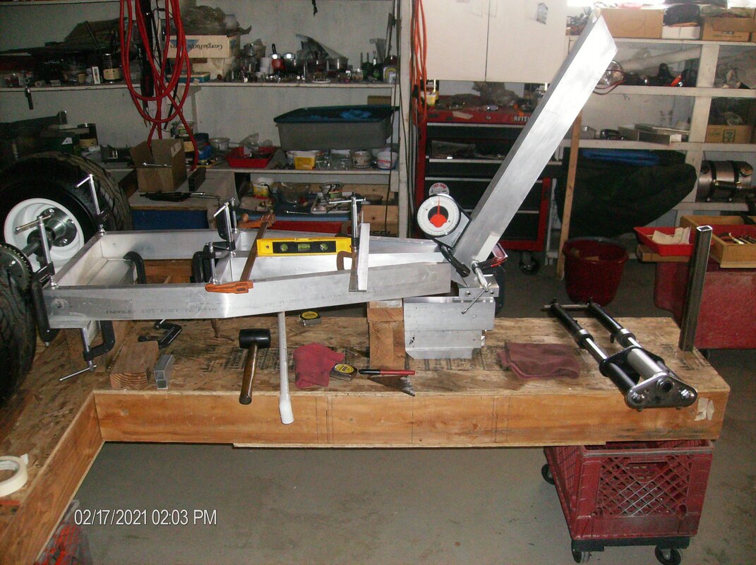

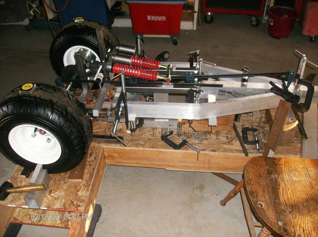

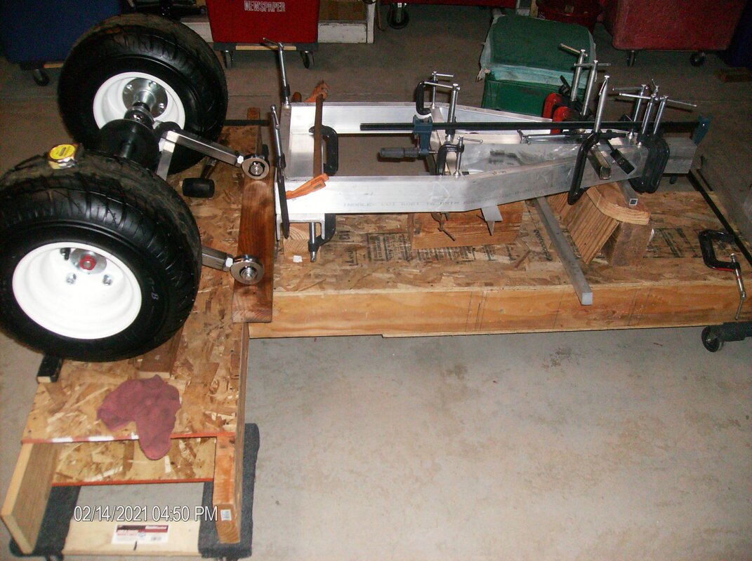

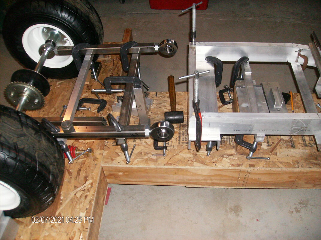

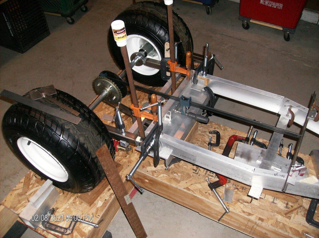

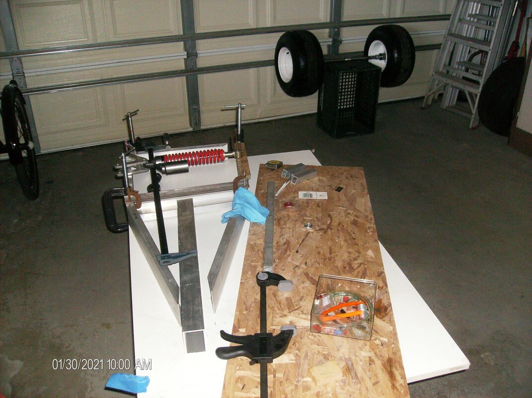

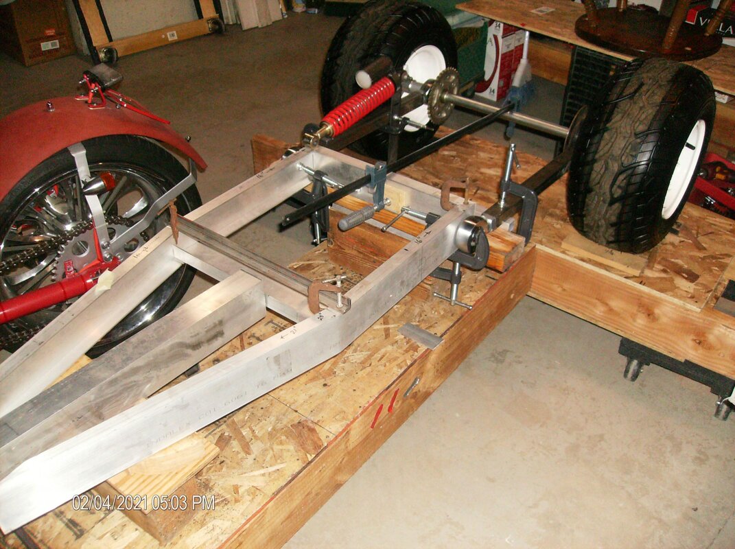

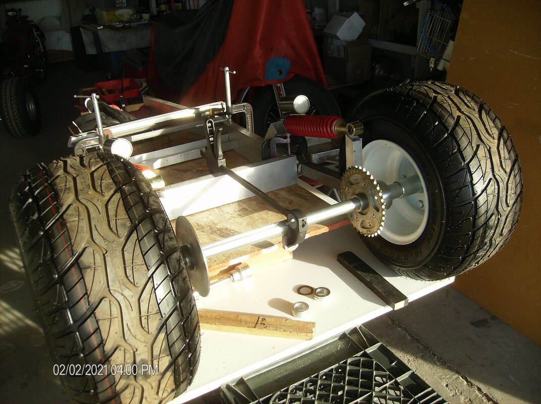

2021-01-30 TriPod.jpgMock up, Control arms, Frame to rear axle need to support the coil over shocks and a panard bar for side movement.

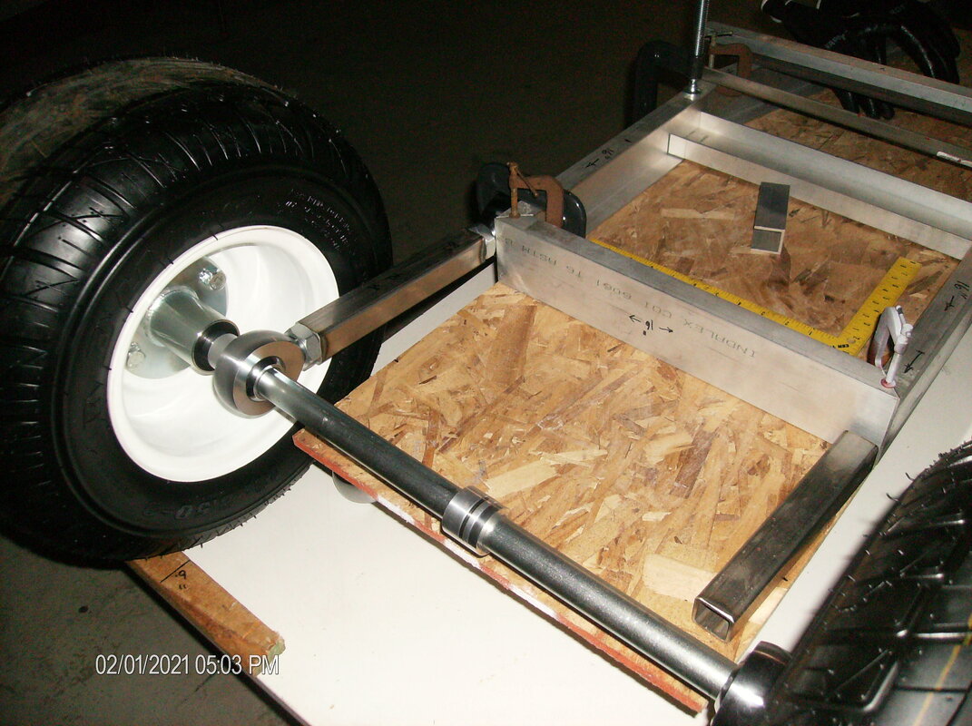

Swing Arm

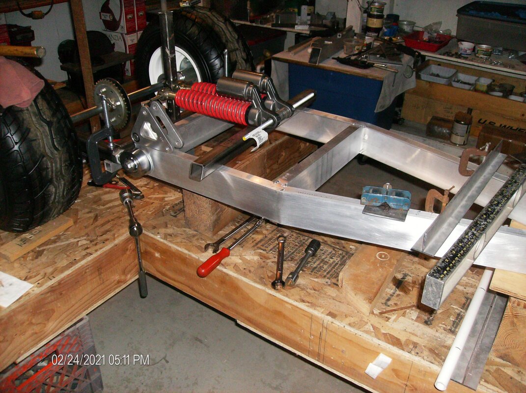

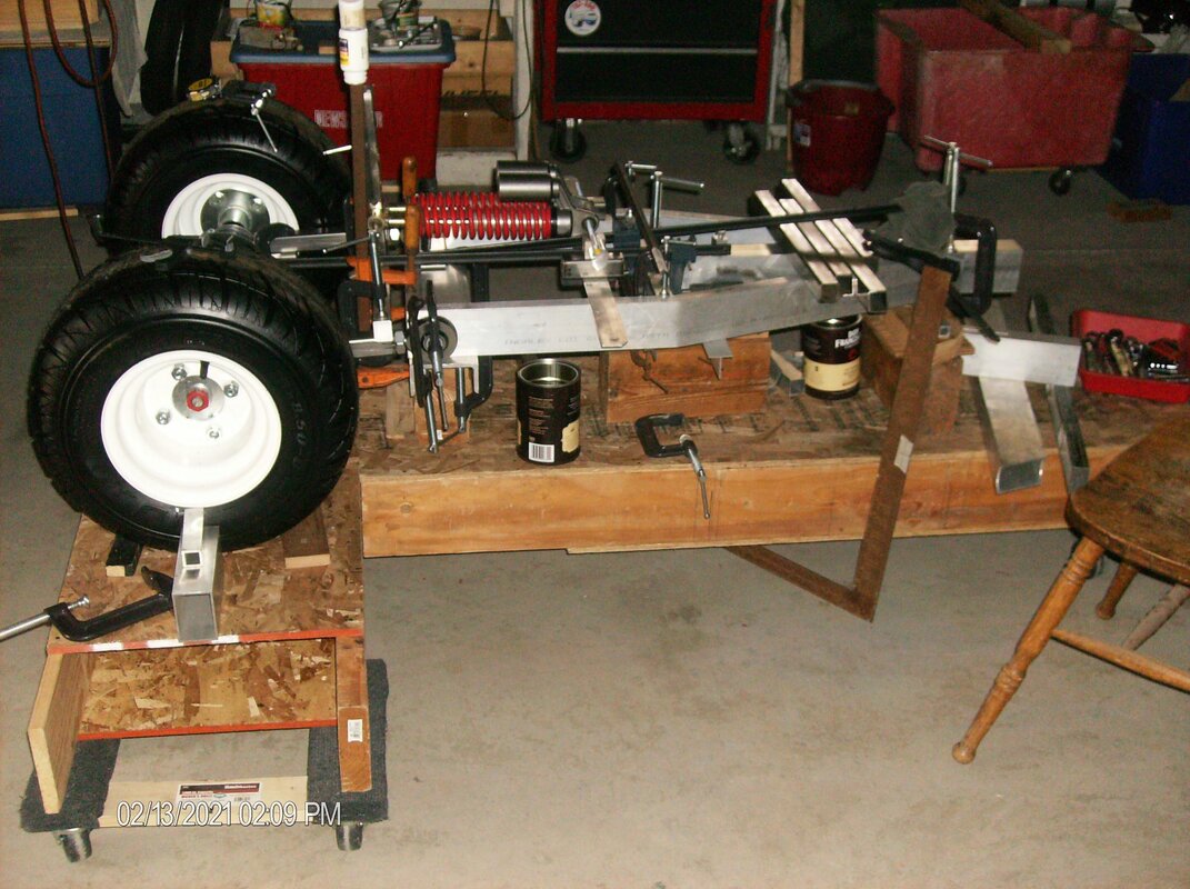

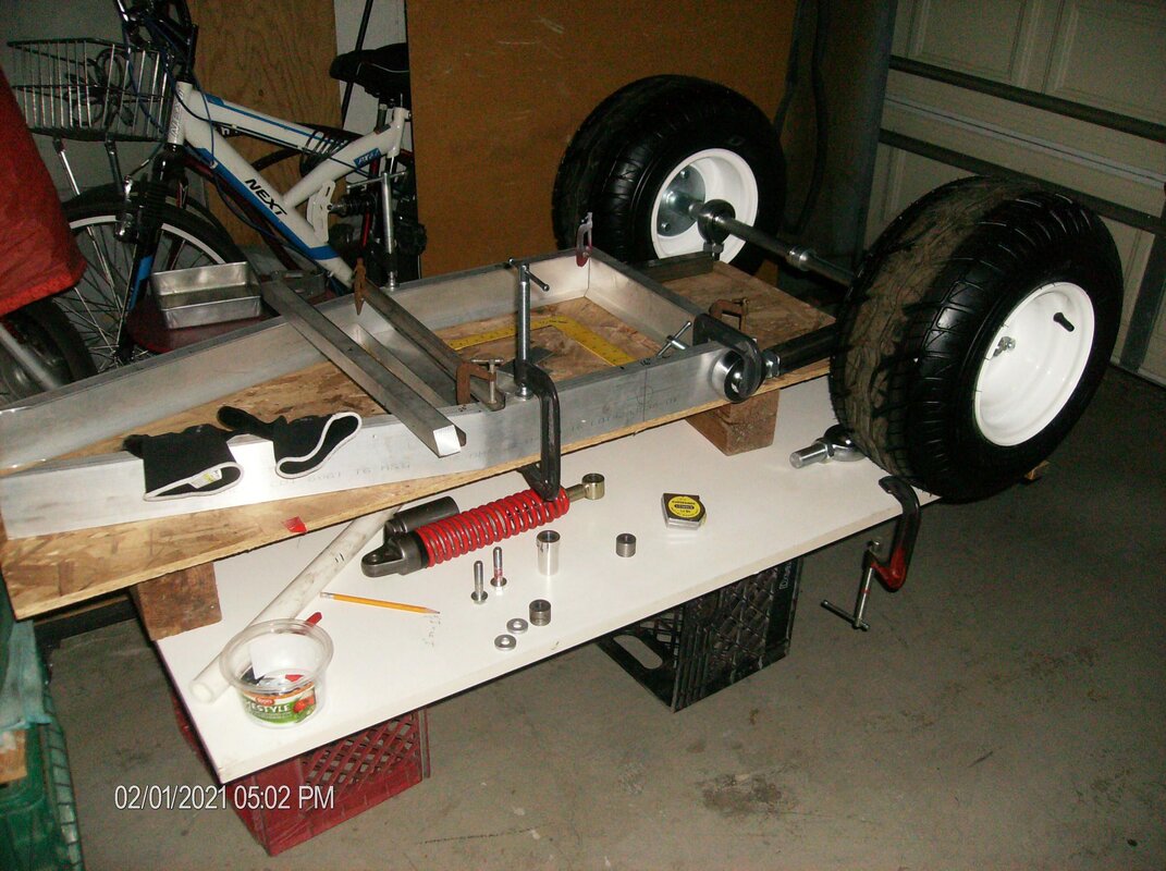

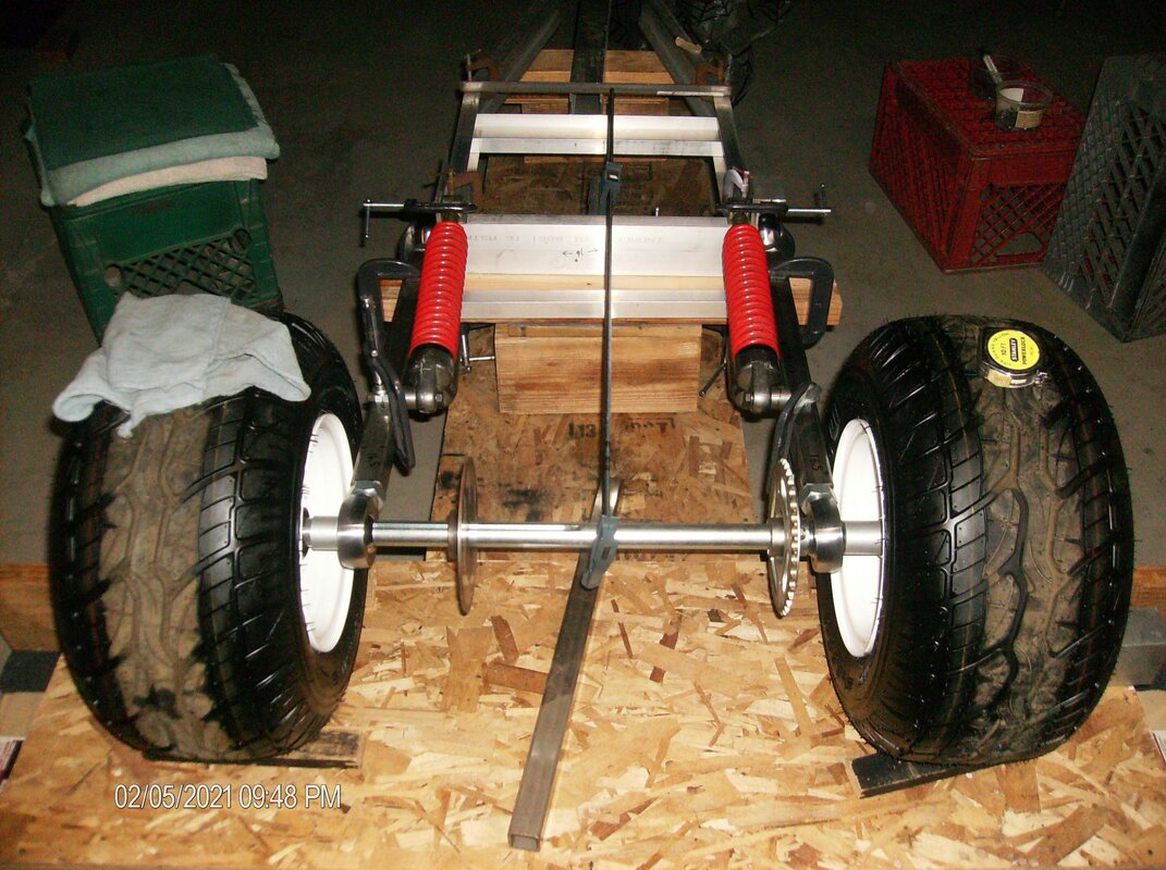

2021-02-01 Control arms moc.JPG-2021-02-01 mock up.jpg Swing arm mockup, The Wife say's this will also hold the basket? If I put a alum. diamond plate cover between the 2 arms it might work...:D

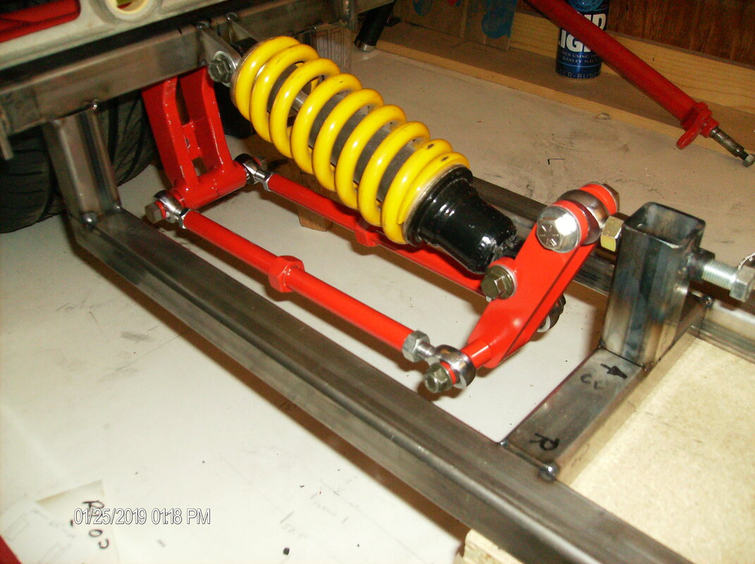

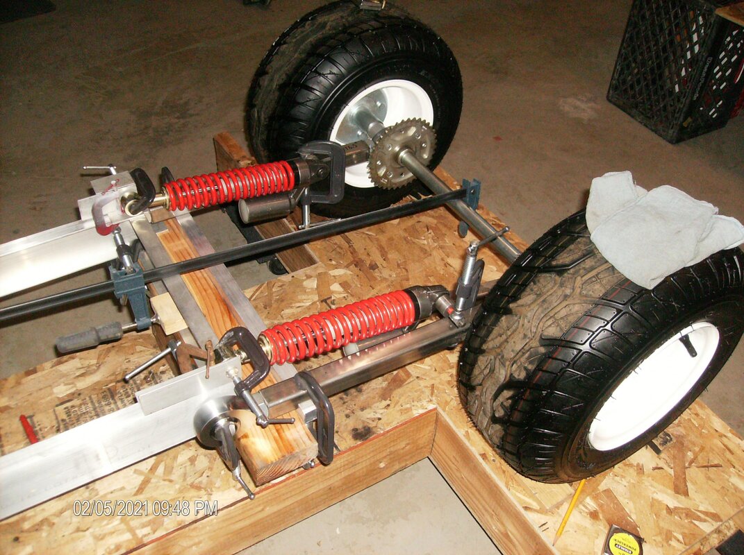

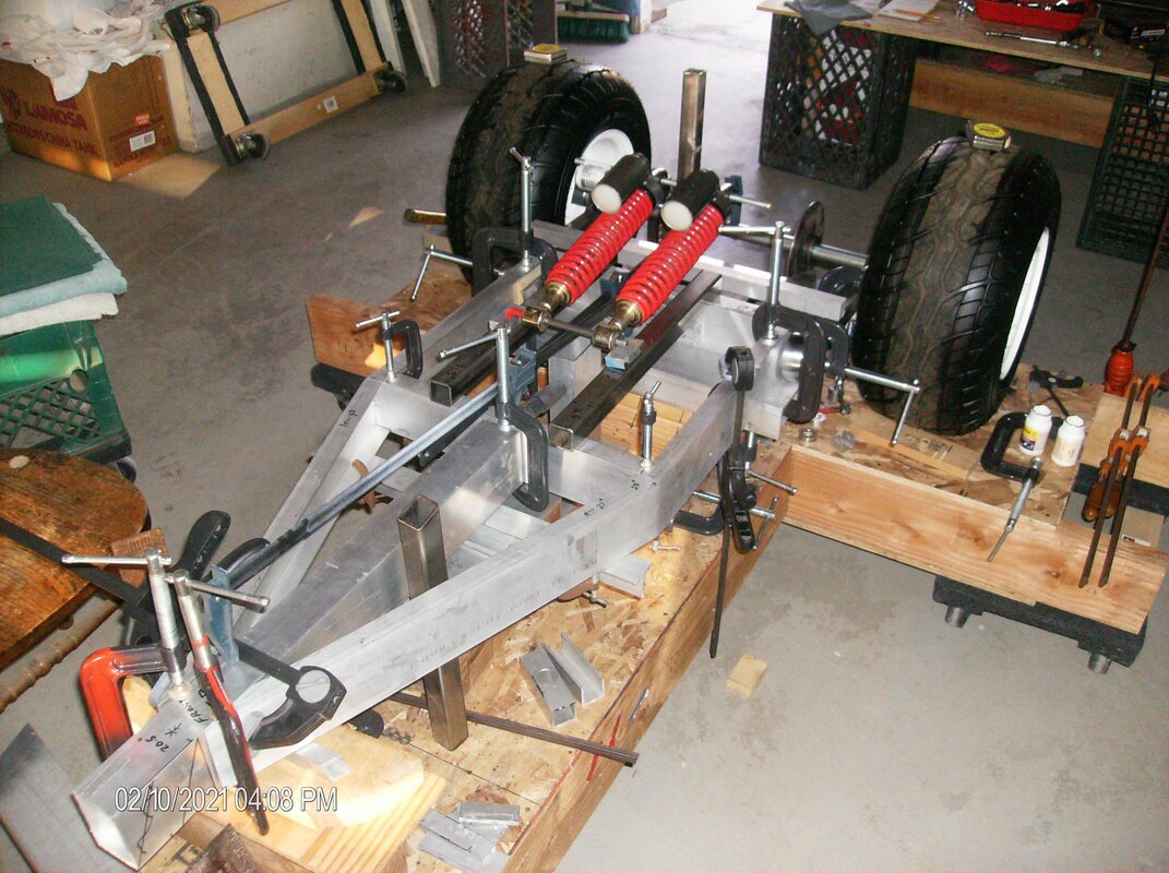

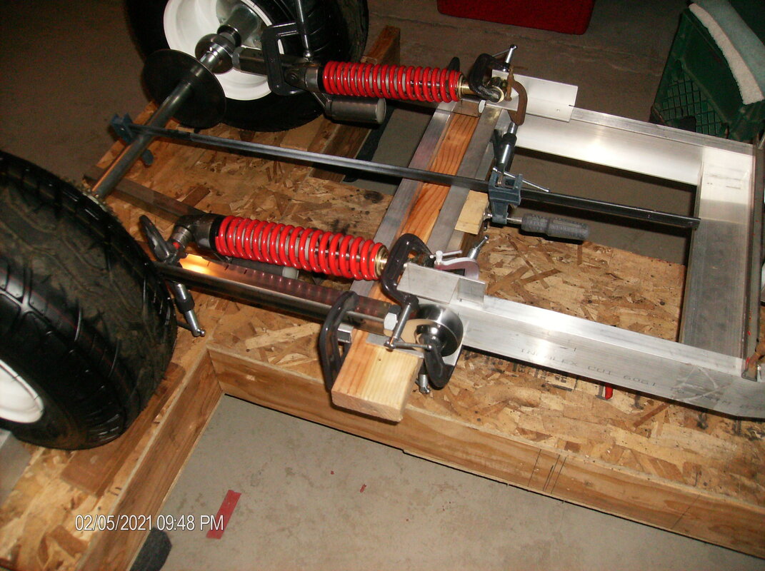

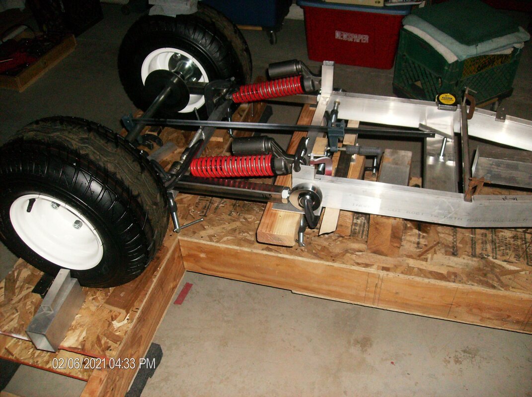

HPIM5079.jpgHPIM5080.JPGHPIM5081.jpgThese shocks are off a ATV front and they are soft, no adjustment, I was getting 4"+ travel on RebelRouser too much for speed bumps, Do you think this configuration will work better? I really do not want vertical...:gah:
View attachment 95464View attachment 95465View attachment 95466These shocks are off a ATV front and they are soft, no adjustment, I was getting 4"+ travel on RebelRouser too much for speed bumps, Do you think this configuration will work better? I really do not want vertical...:gah:
sorry but nope.. not if the are soft with the amount of leverage you have you need a wicked strong spring and very little travel.. to get an idea take the chocks out and measure the shock an the amount of travel... you will finw the wheel travel a lllooootttt you might put a bell crank in
