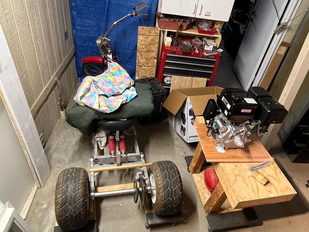

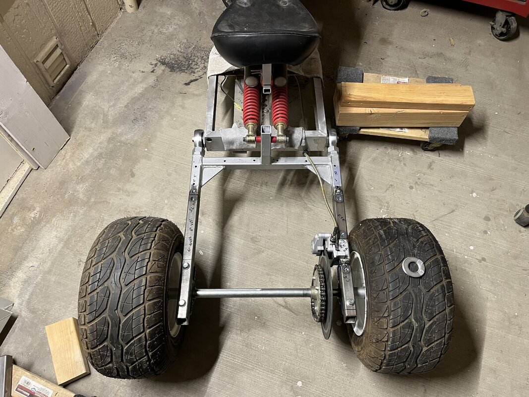

The swing arm will have to be re-designed for the gas engine and a cover to hide it. I want it to be street legal and the DMV laws, here are a few, Gas powered is called "Slow moving vehicle (SMV) all lights and equipment plus 25MPH tops (yeah right). If electric 25MPH no DMV rules or insurance, can call mobility scooter. BUT! I am also thinking hide the gas motor and electric motor on the front wheel.View attachment 126510

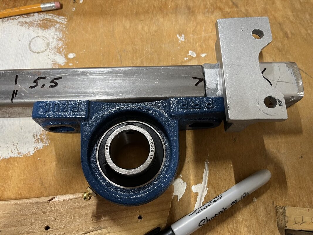

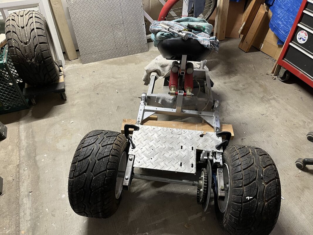

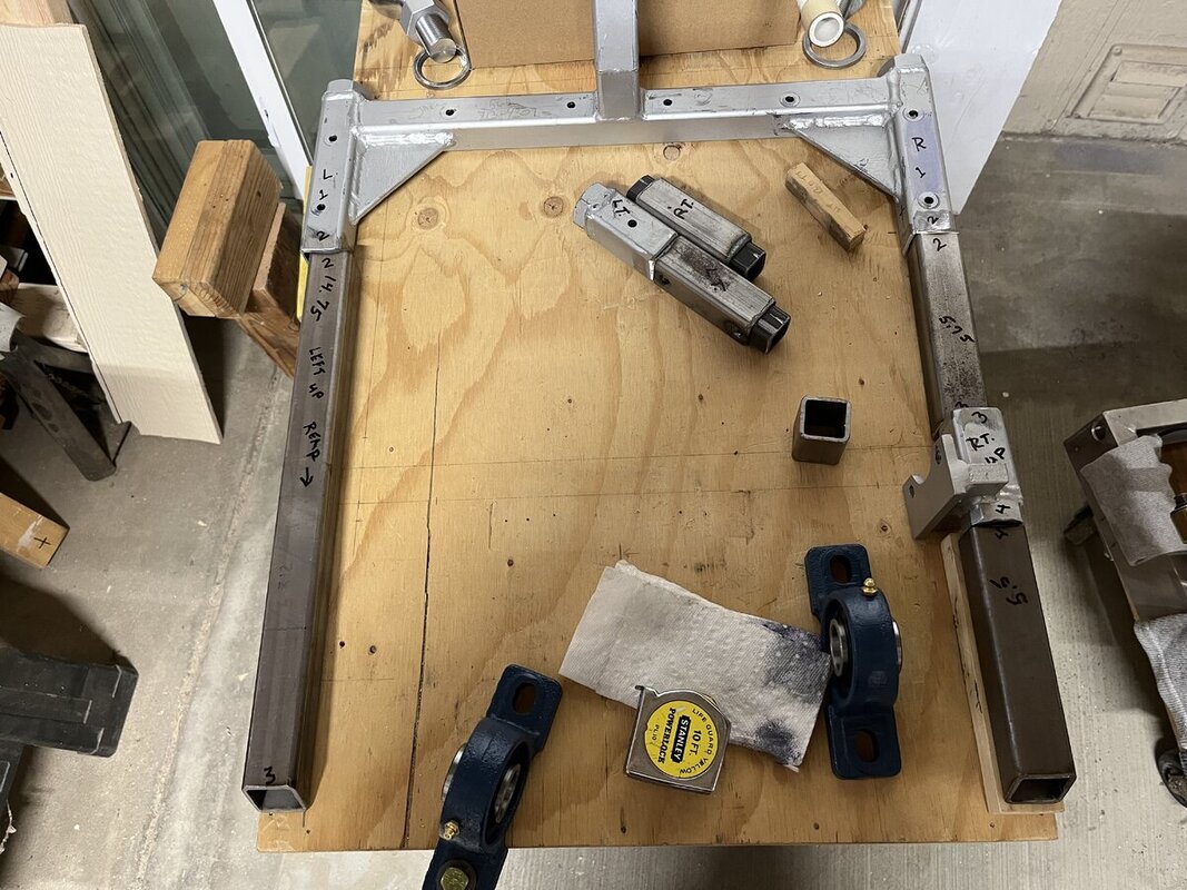

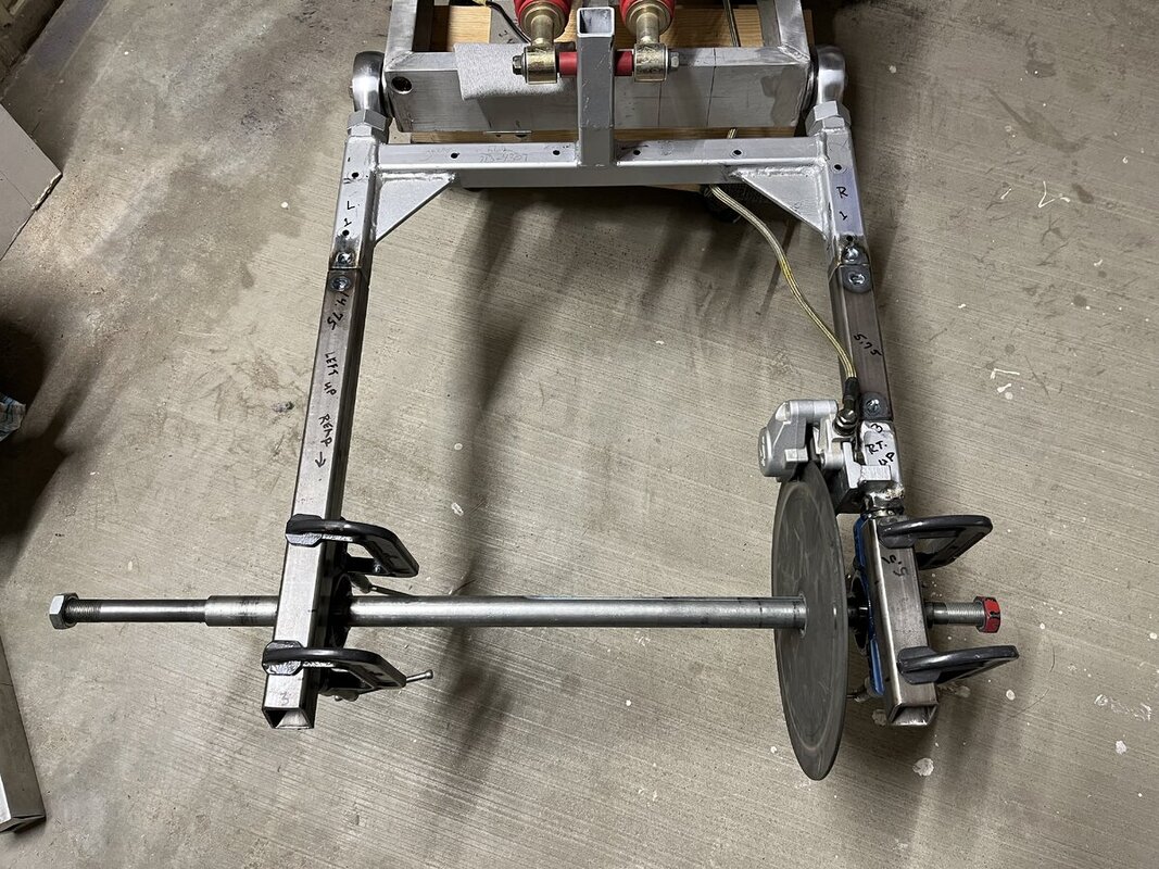

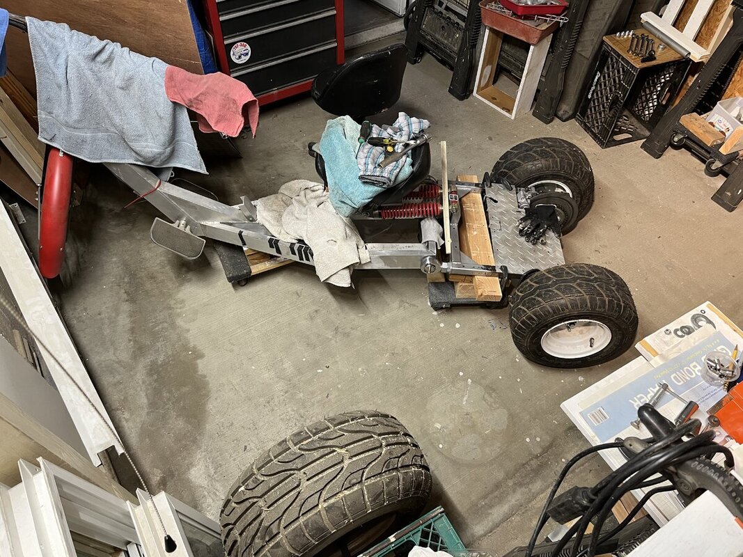

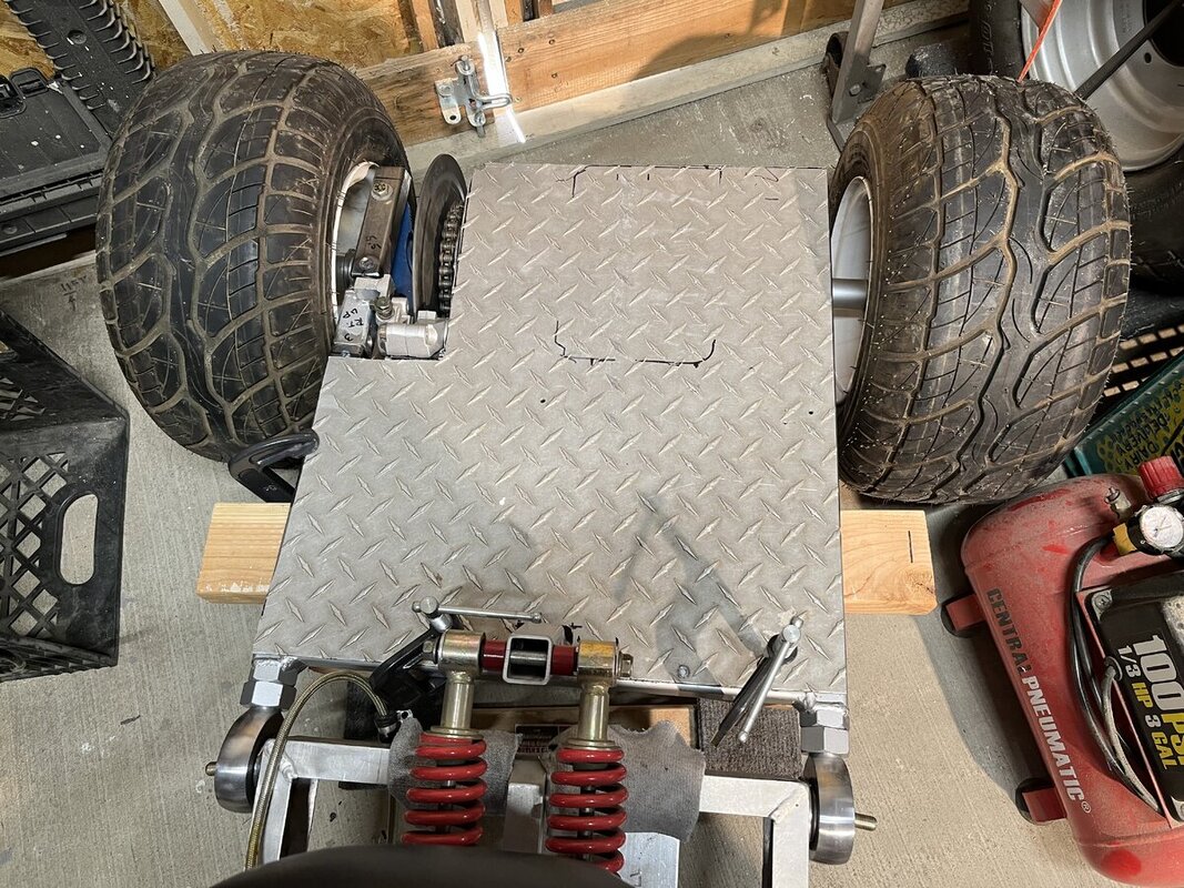

2025-03-26-0578 SwingArm10inX.JPGI needed the old mount plate to see if the engine was going to clear everything, when the chain lines up it should clear the left rear tire by 1/2" and the right rear should clear by 1/4". Chain will be too close to the Disc and Caliper.
