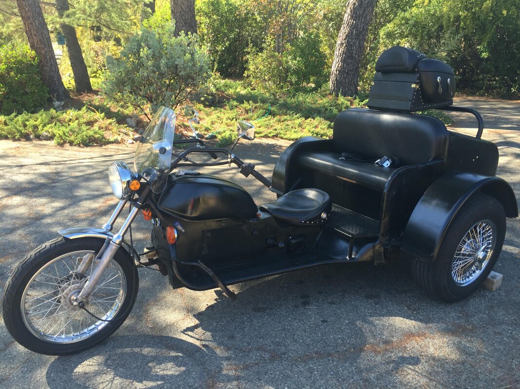

Looks like a 68 model 1600 single port and matching year long axle swing to me.
Aftermarket distributor.
Post the number at the base of generator stand.
Move the fuel filter away from engine and distributor. That is the number 1 cause of fires in a vw.

Thanx for the safety observation (I want to get a glass & chrome fuel filter and will relocate current one til then ) Any ideas on simple additions (Chrome dipstick) or other Items that are easily obtained & installed ???

Numbers (VW) HO4-4XXXX (With ZUNDFOLG 1-4-3-2) above
Ok.
An HO engine case is 67 model 1500cc single port.
It could be a late 66 model 1300.
It does not have the 67 only generator.
Either would be a long axle swing. Good average gearing, not to terribly low, can gear up with tire size.
Inspect the starter closely.
See the voltage stamping.

#2 cause of fires in VWs is friction fit with no clamp of fuel line into carb. Also check for loose fuel inlet brass tube into carb body casting.

The engines steadily evolved over the years.
Check your starter stamping and look for voltage.
1500 is nothing special.
It is related to the 1600 but it still has the smaller oil passages. Not a good prospect for a hot rod but fine for stock.
If you take the engine off the trans let us see the flywheel and clutch.
Of course at 50 yrs old it could be cobbled together out of a whole lot of different year model parts.
Cant get to Starter , 66 (Split Year or Late 1300cc ) or 67 1500cc ALL sound good to me I'm really into Retro (Have a 1966 BSA Victor GP Special ) and love those years (66-7) ,any other way to check Engine displacement ? (Its 12V and Carb is a VW Solex) Yes I like fairly Mild or Stock (With a little Bling/Chrome bits on Engine) I'm just relearning Retro VW and Originality was Paramount in my mind .
Pull the heads and measure the bore.
1300 1500 1600 all had same stroke.
If it is a 66 1300 then it has been converted to 12v.
Distributor coil generator. The 6v starter holds up well on 12v. Cranks a bit fast.
Originally a 66 1300 was 6v.
And a 67 1500 was 12v.
I'm ok either Way (Most Trikers prolly have 1600 heavily breathed on dual port Power Plants ) and I'll show up with a Vanilla Single Port . I like the Idea of a Vintage Trike kept simple and kinda old school set up . It Runs & Drives and I will no doubt be refining it with the help of all you fine folks here ,thanks again ...:clapping:
