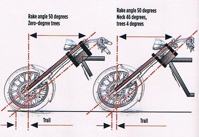

There is some critical errors in the design/geometry of your frame.
You have way too much trail.
The problems you describe are the classic symptoms.
Go check out the "tech tech tech" thread at the top of the page. Then go measure your trail.
To skip ahead to the end.....you have a couple options.
Live with it....possibly some kind of dampener to mask some of the symptoms and some arm exorcises to handle the stiffness.
Cut the neck and de-rake it to put the current fork into proper geometry.
Make a custom fork that has the right geometry.....such as a leading link....ect.
Cut the neck and de-rake some and add raked trees (yokes) to use the current fork. Be very careful with your geometry math when using raked trees.
A trike typically takes around 2 inches of trail. It depends on what type of fork used......such as the one on my trike is a drop pivot linked shocker and I have less than an inch of trail. Sugar bear does an extremely dropped pivot springer and has zero trail. A typical motorcycle has around 4 inches of trail.....and once you tilt it back to give it a "raked" look you will have 6 to 8 inches of trail.
