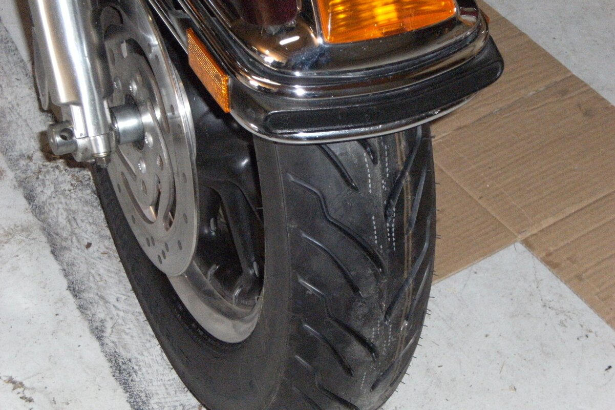

well ...... everyone is entitled to an opinion ..... a rear motorcycle tire on the front of a trike will last many times longer that a regular front ... if you ride interstate maybe a front will last, but there are much more sever lateral forces working on the front of a trike ..... check it out on line .... lots of trike riders use a rear tire on the front not to mention the entire group on the Dark Side LOL here's my Dunlop I looked a long time at the tread designs .... finial decision based on that and USA manufacturer.

I have a Dunlop American Elite Rear Tire, MT90B16, part #34AE92 just waiting for my front tire to wear a little more. Rated for a heavier load, deeper tread depth and it's one of the Multi Tread which has a center wear area is a longer lasting compound. :Coffee:

Good deal ... it looked like the best one for the price ... I mounted mine in the correct rotation according to the arrow ... I personally don't think the tread splice comes in to play on the new tires. I looked ----A LOT---- on the net found no real reason to reverse it...... good luck with it .... mines going to the Dragon in May .....:clapping:
I think I am definitely going to the American ELite when the tire wears out and probably run it in the correct rotation. With the Multitread it should get better mileage than the stock Dunlop.
