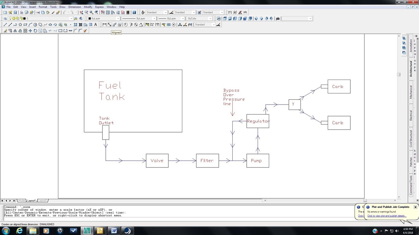

If you do not have a place for the bypass line to connect......it does not HAVE to go to the tank. It can loop back to the low side of the pump.
Works perfectly fine but does run a chance of heating up a pocket of gas if demand is real low and is bypassing right back into the pump a large amount. Potential vaper lock.

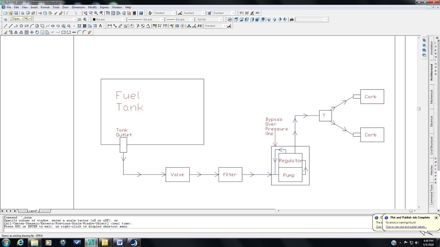

An internally regulated pump does the same loop back to low side just all inside the body of the pump instead of 2 separate pieces.
In addition.....
That first example the bypass line could also go to the low side of the pump like example 3 does.

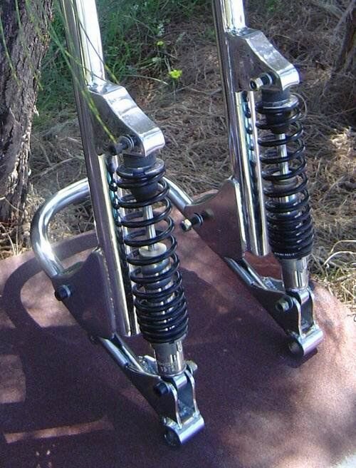

By a large amount the most common front suspension for a hand built trike is a hand built leading link. It also is one of the easiest to build in a hobby shop in the garage.
Do you know how stable this ride was ? I have searched for link arm distance, most short, and this one is much longer than 6". Rough est. is that I will have near 10 inch long trail from the fork tube pivot point, minus the 5 1/2" pivot distance on the monster link arms, leaves 4 1/2 inch's, but under load I will lose about 1/2 to 1 inch in trail, making it more near 5 to 5 1/2inch's of trail when I increase to a 18" front rim. If I do the rim increase than the rear and front axle height will be the same. If I only want to have near 2 inch's of trail, well than I need to extend the distance between the fork pivot point and the axle point. Does this effect how stable the front suspension is ????
Is there a need for a drop pivot design of the fork tube point with a leading link design ?
I read that there is more stableness and control of the front end with a drop pivot, weight of trike below axle level, less when both points are level, and it gets worse when fork tube pivot point is above the axle pivot point. :xzqxz:
Excuse me, did not mean to waste anyone's time, followed link on page 3, got some answers, still trying to read some links from it.
Typically leading links are ok being longer than a springer rocker......because they are connected around the back of the wheel.
I would not advise long individual rockers.
My front end has less than an inch of trail. The lower you can get that pivot then the less trail you have to have.
If you go with a flat or level pivot to axle then stay in the 2 to 3 inch range.

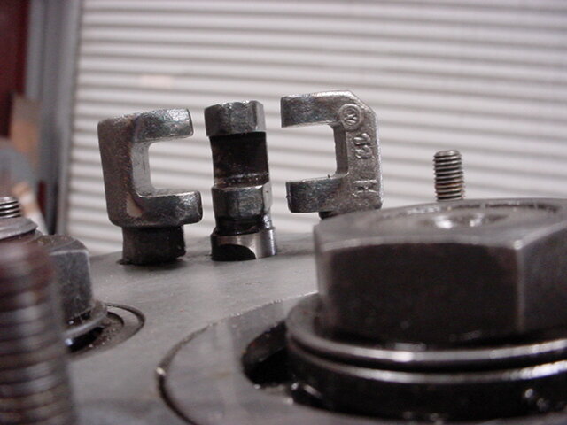

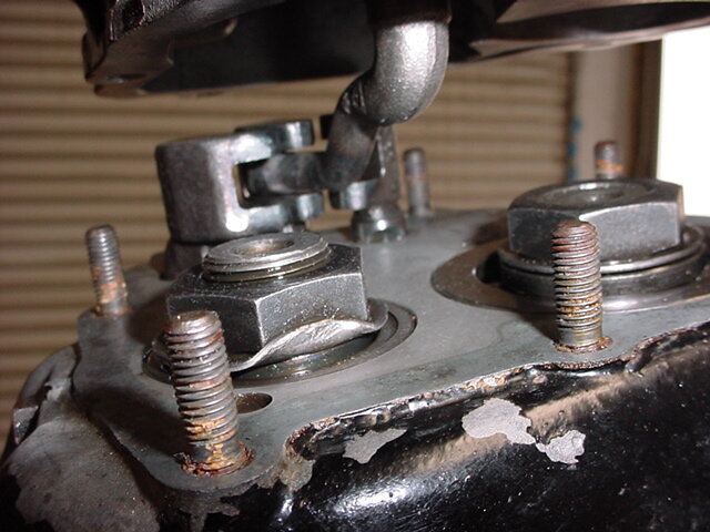

Let's explain what you are doing when you shift gears.
This is an example of the "hockey stock".
The end of this is what is sticking out of the trans.
This what the hockey stick engages in the trans.
These hooks are the shift rods into the fork and synchro. You are pulling these hooks in and out individually.
Here the hockey stick in the hooks.
The trickiest trick to it all is getting that rod to rotate the right amount and stop rotating it the right place to line up with the hook inside.

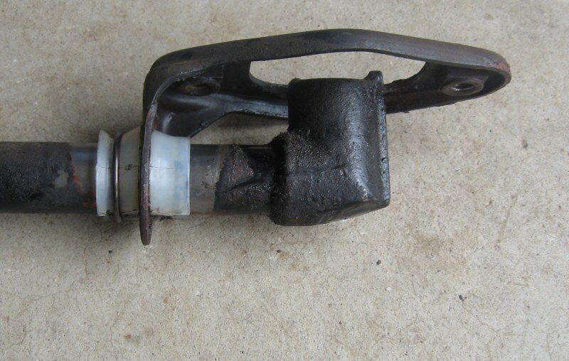

The number one thing stopping the linkage rod from being rotated enough is this bushing.
It must be there and reasonably snug to the shaft.

The main difference in a trike and the car is that that shift rod has been cut in two, shortened, and welded back together......and not particularly in correct or original rotational reference.
If you use/have a stock type shifter mount is is imperative that the rod goes square into the mount and centers up under the shifter.
You will be forever unhappy with the shifting and/or adjustment if that rod is not square.

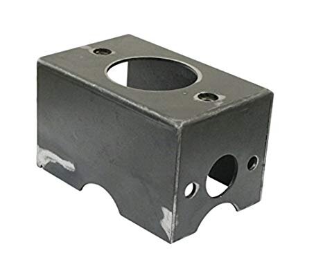

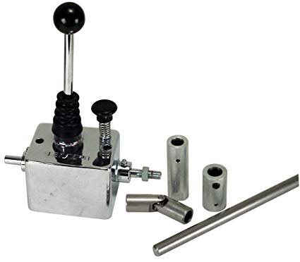

That self supporting buggy box above is for a stock type bolt down shifter. A shifter of the sort that would go into a car and bolt to the stock location.
Many of them use the stock reverse lock out plate. Then some have their own built into the handle lock out.
Then comes the buggy super shifter. It works just like that buggy base, but has it's own shift lever and a reverse lock out built in the base. It is a real good universal shifter at a reasonable cost
