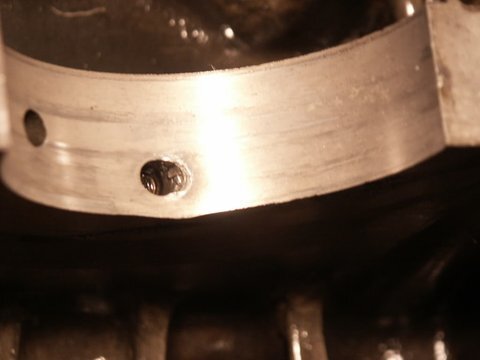

Check the main saddles.
Very common for them to be pounded out.
The original engines were not well balanced and were not intended to rev very high.
It is basically a big lawnmower engine. Just like a briggs is made to crank and run wide open at 3750 rpm all day long, so is the vw.
If there is any visable or feel able damage to the saddles it has to go to the machine shop.
It is called line boring (correct name align bore).
Resize all the saddles and get the bearings that fit.

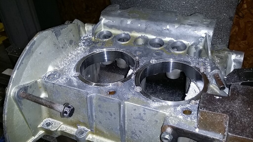

Same extra machine work as 94's

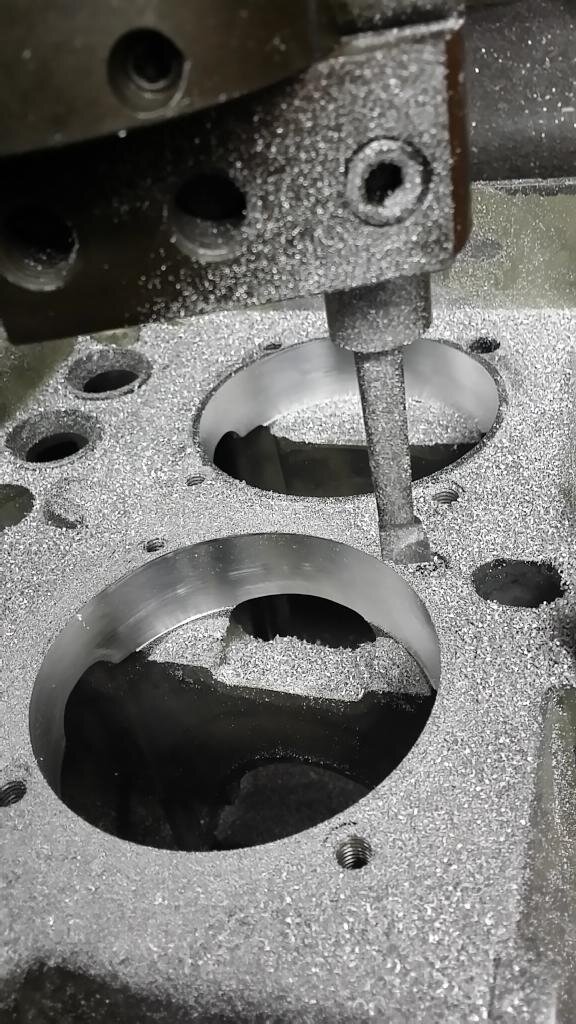

Case machined for 90.5 or thin 92's
Same raised lip for cyl to seat on.
Case machined for thick 92 or 94.
Little to no raised edge left so case decked to make new seat face.
The thick 92 and 94 cyls are longer to account for this.

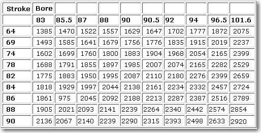

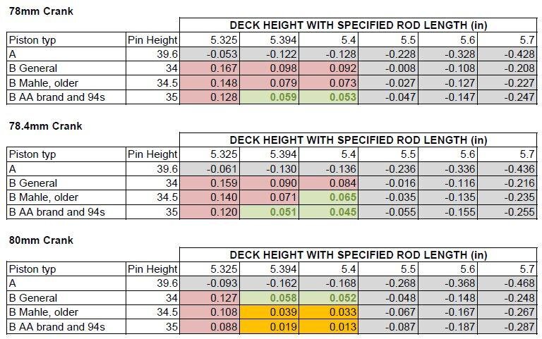

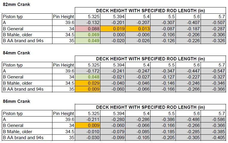

Repost of the bore and stroke sheet.
64 stroke is the 40hp and older engine.
Everything after the 40hp 1200 is related and parts interchange. Some shouldn't be interchanged.
The stroke from the 1300 to 1600 is the same stock 69mm.
Piston and cylinder kits come in 3 different pin heights. As in the wrist pin to the top of the piston dimension is defferent.
A stroke p&c kit is stock pin height.
B stroke p&c kit is the stroker pin height.
C stroke p&c kit is for extreme strokes 86 and larger.
You wont see a C kit listed very often unless you like to look around the super high dollar mega race sites where they sell the billet drop cam engine cases and want to run a set of super squishies.

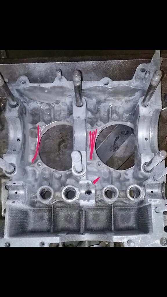

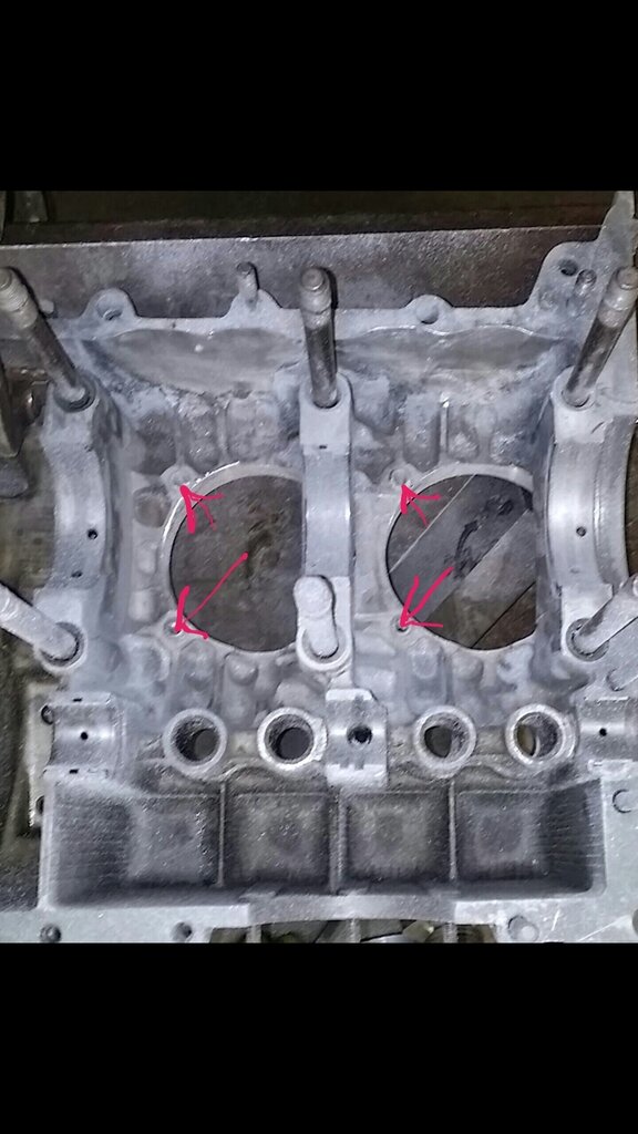

Getting a stroker crank into the case.
It is possible to hand fit a stroker crank by hand grinding. The smaller 74, 76, 78mm cranks you could probably do with a large dremel trial and error style. Lay the crank in the bearings on one case half and rotate and mark, remove and grind.
Bigger could be done the same way with a more aggressive tool like a die grinder. It takes a lot of time to do any of it like this by hand.
If your case needs other machine work just pick a shop that can clearance cut the inside.
Clearance cut areas.

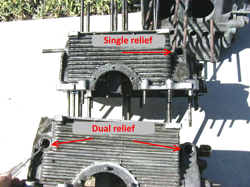

Of those you also want the dual relief.
This is the latest oil improvement vw did to these.
It seperates the oil cooler bypass and the oil pressure bypass.
A single relief can be made to work with more modifying.
The single type is more of a three way valve and it makes getting oil pressure and oil cooler flow to balance. You can "full flow" the case and run the cooler there and use the relief for pressure only.

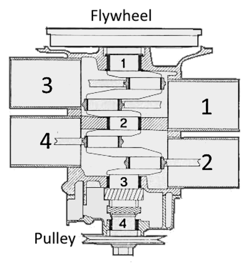

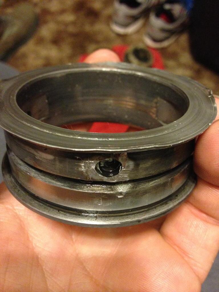

Inspect the main bearing saddles.
They take a beating, especially of you are hot rodding a non counter weighted crank.
