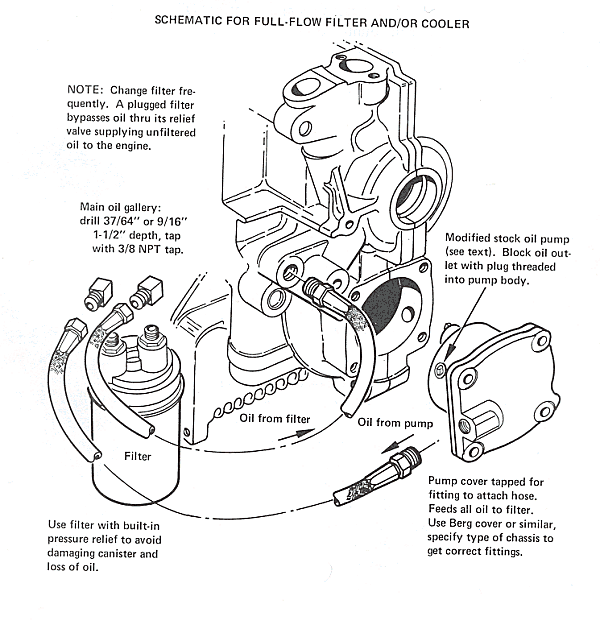

Here is a diagram showing what "full flowing" a vw means.
As you can see all of the flow from pump goes to the filter and/or cooler. All the flow all the time, hence the name full flow.

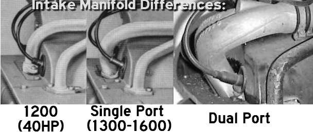

The very first thing to do is to upgrade to a later 1600 dual port engine.
Most all the aftermarket parts are based on modifying this engine.
Any of the other vw engines are very limited on how much you can do, but are a fine stock engine.
Just the upgrade to the late 1600 may be plenty for your needs.

best place for oil pressure sensor ?
Of those you also want the dual relief.
This is the latest oil improvement vw did to these.
It seperates the oil cooler bypass and the oil pressure bypass.
A single relief can be made to work with more modifying.
The single type is more of a three way valve and it makes getting oil pressure and oil cooler flow to balance. You can "full flow" the case and run the cooler there and use the relief for pressure only.

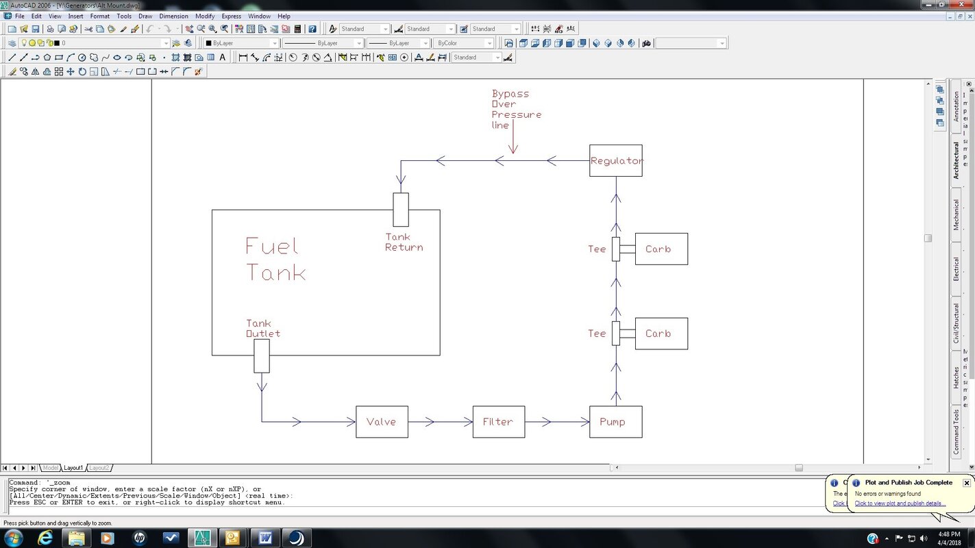

Fuel pump
About vw fuel pumps.
The original vw pumps were an excellent piece. Very capable and dependable. You can even run dual carbs with a correctly functioning stock pump.
But there is the rub....correctly functioning.....the vast majority of today's replacement pumps are far from correct. The durometer of the diaphragm and all the spring rates must be right and they no longer are with today's material......and mostly Chinese. So most are overly high pressure. You can look over in the throat of a running carb and see it is steadily dripping. It will run and seem somewhat ok, but low gas mileage all the way up to gas smelling oil.
So here comes electric pumps and regulators.
You could put a regulator on a stock type pump just like you can with an electric. Most with an electric pump and a regulator combo though.
Most electric pumps are made for v8's and/or Holley type carbs with big floats. In the 7 to 9 psi range. So get something else more aligned to our 4 cyl engines. Carter makes some good smaller stuff. Shoot for 2 psi with some adjustable up and down from there.
Making the circuit.
This one is my personal favorite and is what I use to this day.
A 2 port over pressure regulator.
The valve could be a motorcycle tank and its petcock......a manual hand valve.....or an electric valve.
Such as.
Fuel filter non specific on the brand but prefer NOT plastic.
A small electric pump.
Adjustable regulator. And that round dial top unit empi sells is not a true regulator.....it is more of a restrictor. It can somewhat work configured like this.
Next in line.

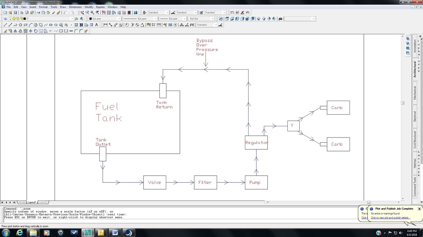

Remember this is the world according to Rex......not the end all be all of human existence. This is just some data points for you to consider.
A 3 port regulator.
In.....out.....and bypass line.
