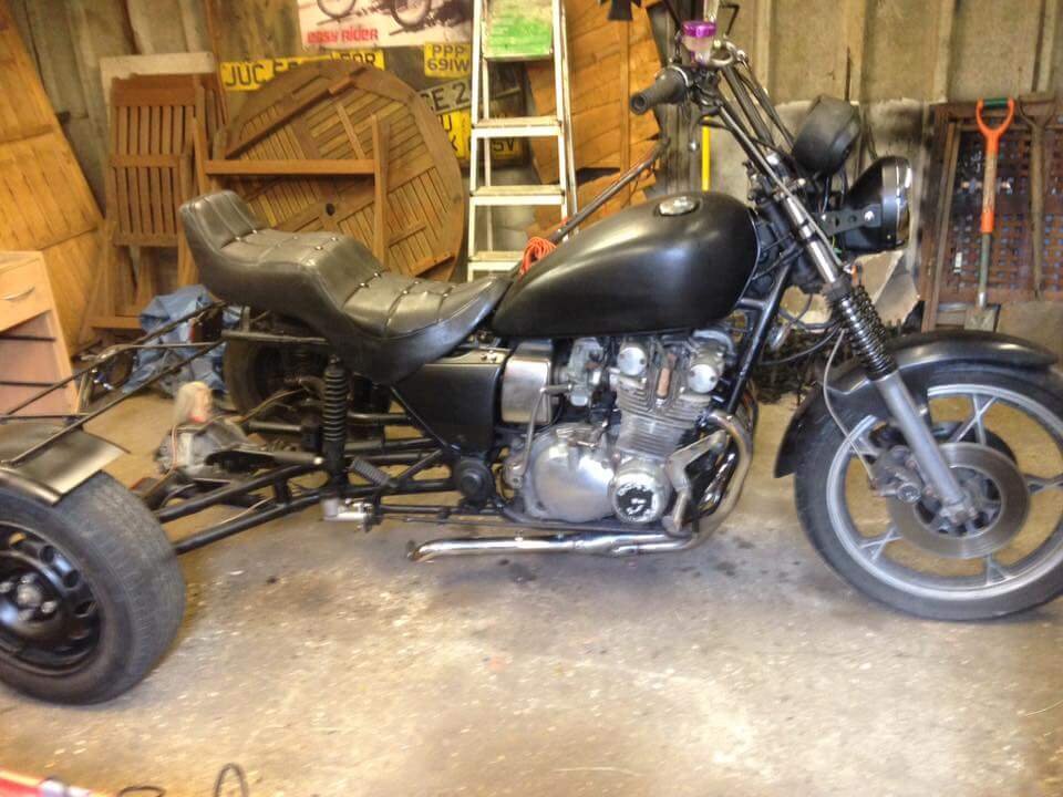

You could even take that back half of the 2 wheeler you cut up and graft it into the front legs.
As long as the axle is in the right place it wont know that that is a rear swing arm and shock that used to be the rear end of a bike.

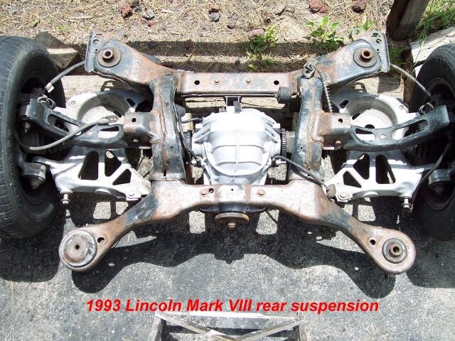

Ford in particular has a lot of independent rear suspension units in a bolt on package. Then there are misc others that could be used.

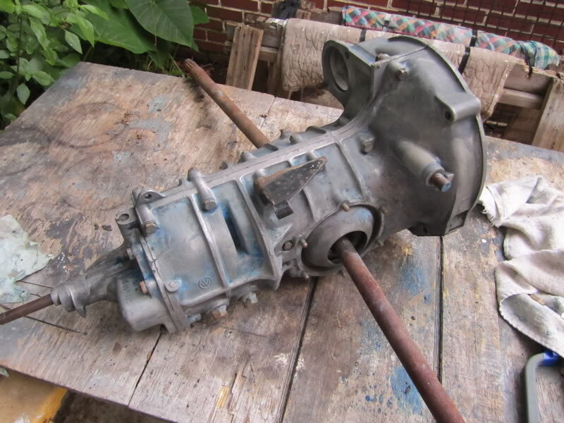

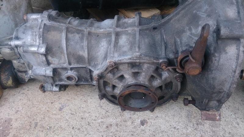

Pre 61 had a split case with no side covers.
No syncro first.

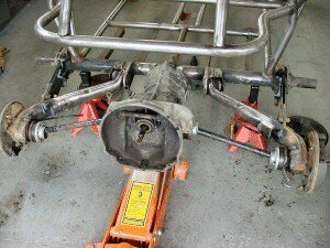

Swing axle.
Made for 25 to 36 hp cars.
Low geared and too weak.
You do not want it for a trike build.
Then in 61 came the tunnel style.
Swing axle.
No split seam.
Two side covers on the differential.
This is the basic design vw used until the end.
But there were multiple changes through the years that can not be seen from the outside.
From 61 unitll mid 66 the trans was still low geared to go with the 40hp engine.
Was fairly strong.
But with the low gearing is not desirable for a highway ride.

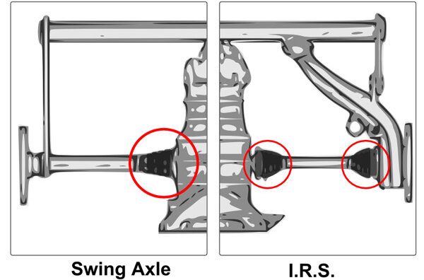

Mid 66 until 68 was the long axle swing.
Has taller gearing to go with the larger engines.
Different width syncros that down shift better.
And an 8 bolt heavier ring and carrier.
This would be the most desirable of the swing axles.

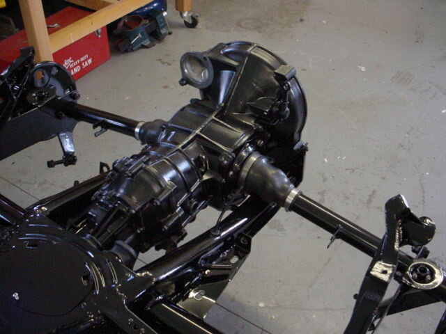

Then came the irs rear suspension.
It is a massive improvement on the rear geometry.
Handles better.
Has longer more progressive springs.
Same 2 sided case and the same gear ratios. (some other ratios available for ghia and thing)
Then the latter years of the beetle was the single side cover.
Internal parts still somewhat interchangable.
Gear ratios changed to a bigger ring and pinion and a lower 4th.
The later 1600 dual ports could pull more gear but still needed the highway rpm for the cooling fan.
This one would probably be the best road performer for a trike.
If I were to build another VW powered trike from scratch, IRS would be the only option I would consider.
Although I've never personally ridden one, the swing axle seems like there would always be handling issues due to camber setup. This in turn leads to potential safety issues, in my opinion.
I suppose there are ways to compensate for that, but IRS trikes look so much more "refined" than their swing predecessors in the finished product.

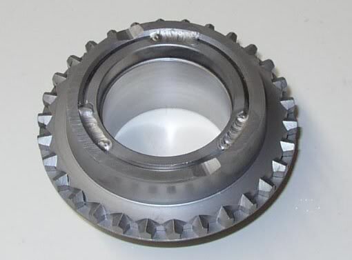

At this point it will start shearing drive keys on the straight shafts. Spinning the press on syncro rings. And case flex will chew up ring and pinions.
Billet side covers, hardened keys and welding the syncros on will help keep it together to approaching 200hp (no slicks and drag racing).

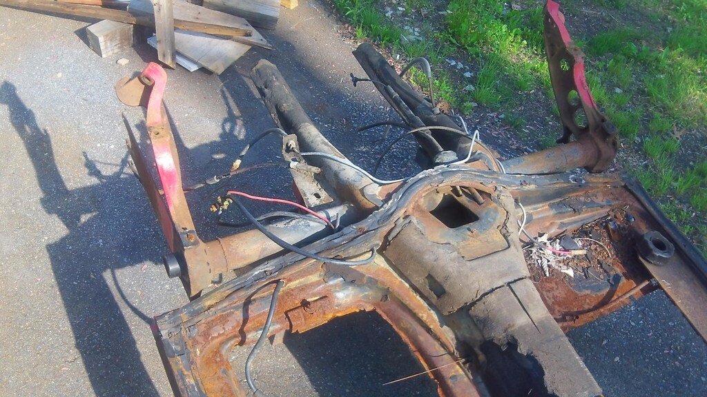

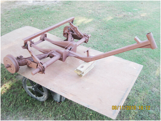

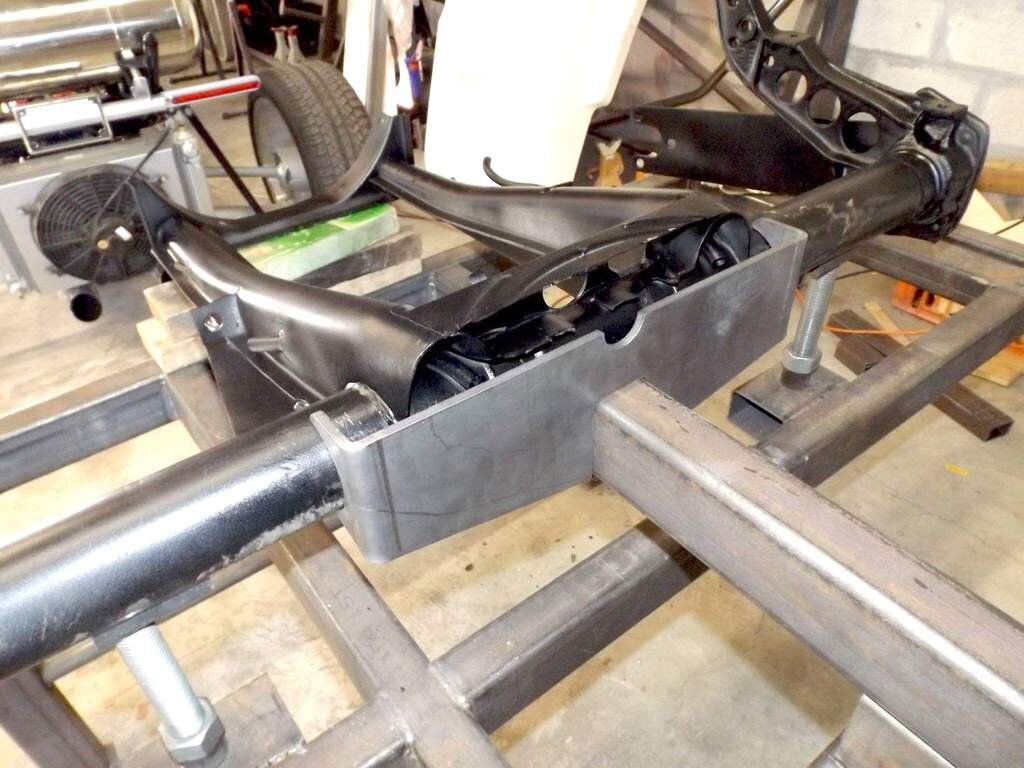

So you find an old beetle and strip it down.
Then cut the back end off.
This gives you all the suspension and the engine/trans mounting. All the major mechanical in one peice. All you have to do is start building off of this.
All you have to do is weld it in square and with the neck centered and correct trail planned out.
And....you have a trike.

Frame is a single large beam.

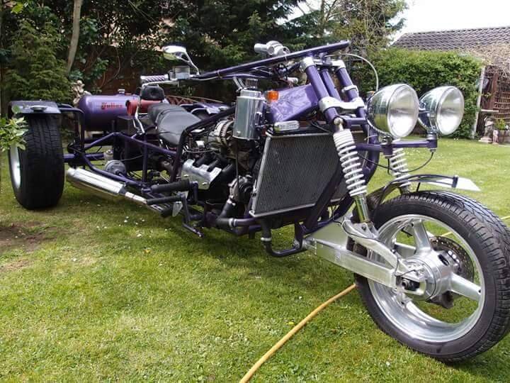

How about a tube frame and no body.
I know of at least one place that makes frame kits or complete welded units.
Ok....checked with admin, so I am gonnna name drop.
Steve at Wild Man Trikes makes some knock down kits and full weld frames.
Back in the day there were several vw trike makers, but not anymore. Steve "cut his teeth" on the VW, but now a days he does a lot of exotic stuff. But he does still make the vw stuff and has some new repop stuff out too.
Such as single beam styers style necks and tie ins.

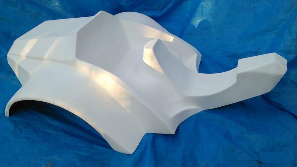

And the repop body to go with it.
He also does a no body frame a lot like the pic above out of tubing. Also does a mid engine frame (not swedish style)
Yall look Steve up.

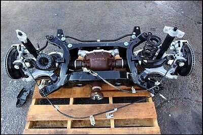

So unless you fancy yourself as a vw guy or just want a retro trike....there are other choices at the local junk yard. None will be as easy to frame up and all will have more stuff to make fit. Radiator and electrical to name a couple. Most any front wheel drive car would be a good donor.
