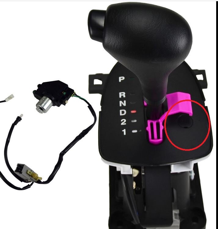

#2 - On the Stallion (along with multiple other automobiles) have a shift interlock bypass (most commonly used in vehicle repairs), see image below. Use your key (or screwdriver) & remove the cover plate that covers the interlock bypass, you can then use a key, screwdriver, etc to push down the bypass switch to to disengage the interlock solenoid to take the vehicle out of park. You will have to manually do this each time you want to take out of park.
