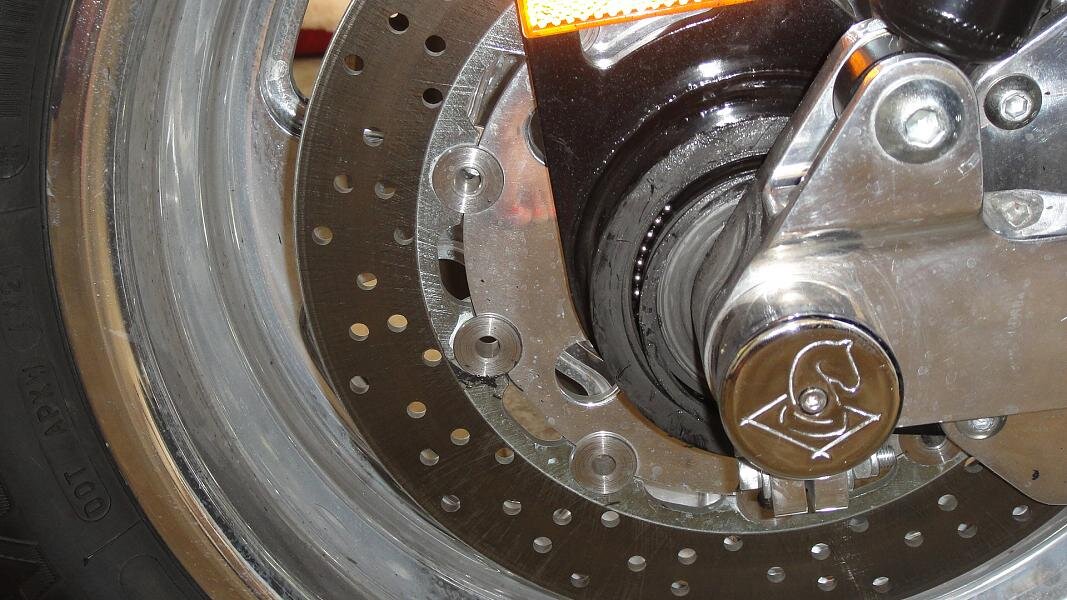

Everyone needs to check the brake bearings on the front wheel of your Stallion. Mine only had 1600 miles on it when they went out. I know of 4 other people that have Stallions that the same thing has happened. One of them was in Nova Scotia and it took 9 days to get fixed!!! I bought my Stallion from Thomas and Gail Riley in Mebane, NC. I called Thomas and told him what happened. He ordered me new bearings and they came in on Friday July 2. He stayed and put them on and we picked it up Friday night so I could have it on the Holiday Weekend. Need to give Thomas a great big Shout Out... THANKS THOMAS!!!!!!!!!!

My question is going to be what is causing this to happen? Did they get a bad patch of bearings? We have 10k on our current Stallion and 13K on the previous one. Neither had wheel bearing problems. Be nice to know the why. Just replacing the bearing with the same ones doesn't fix the issue unless there was just a bad patch.

cupcake is not talking about the wheel bearings, which is tapered bearings covered in grease from Chevron.
cupcake is talking about the black piece on both sides of the the wheel that the brakes are mounted to, those are sealed bearings. if you see bearings as in her pic's you need them replaced NOW. you should not see the ball bearings at all.

Thanks Silverdevil. I has thinking it was the wheel bearing we were looking at. But given that this is the brake mount bearing my questions still. My question still is why are they failing? Maybe they are spraying to much cleaner and water on them? If not that then is it something TBMS has a fix for other than the same bearings?

Hi, My Stallion is a 2010. When the bearings went bad it pushed the seal out where you could see the bearings. We were told that the new bearings they sent to replace these are suppose to be better quality. I don't know if they got a bad batch of bearings or what.
Thomas at Riley's told me that he has had to replace several and so far the new bearings have not gone bad. If one side is replaced you need to have both sides replaced. The seal would move back and forward after they went bad. So if you check yours, be sure to touch the seal and make sure that it is stable...

Thanks cupcake GREAT info. It's sounding more like they got a bad patch of bearings.
The front bearings were a weak point on the fiberglass Stallions. They used a lesser quality bearing. Mine were shot when I picked it up after only 1-4 miles of riding. I was told by my dealer that that was how the stallions rode, and vibrations on your Stallion over 70mph were not a problem because you should not be riding over the speed limit!!!!
After pushing for months I was one of the first to recieve the new bearings and forks b/c the bearings are so hard to remove most of them cannot be removed so they repace the forks. The new bearings are also larger so the hole needs to be reemed out before replacing them. You can tell your bearings are going when you get front end vibrations at high speeds, and they they totally go, watch out, you will know.
This is not someting to worry about, as you will have plenty of notice if they start to go, and plenty of time to get it fixed under warranty. This is not a saftey concern due to the amount of notice you will have.
