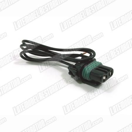

New issue:
Left fog lamp burned out today. Is there a bulb in there that can be replaced? Nothing in the owners manual. I read a post in another thread from back in June and someone said you need to remove the whole assembly and solder in a bulb!!?? Really?
Re: Stallion Repairs & Trouble Shooting
Yes really or replace the whole assembly. Actually you can replace the bulb and cut and connect new feed wires. Find someone that has some wiring ability and it should not be a problem to fix.

New issue:
If this Grandma can do it you can too. Go to your local Auto Zone or equivalent and bring the parts with you. They'll help you find the new connector and give you the right bulb. Bat your eyes and ask him to go through the steps with you. After you get it replaced you'll feel like a million bucks and know you are now able to conquer the WORLD! Go for it, deb!
The pigtail connector looks like this, deb54
