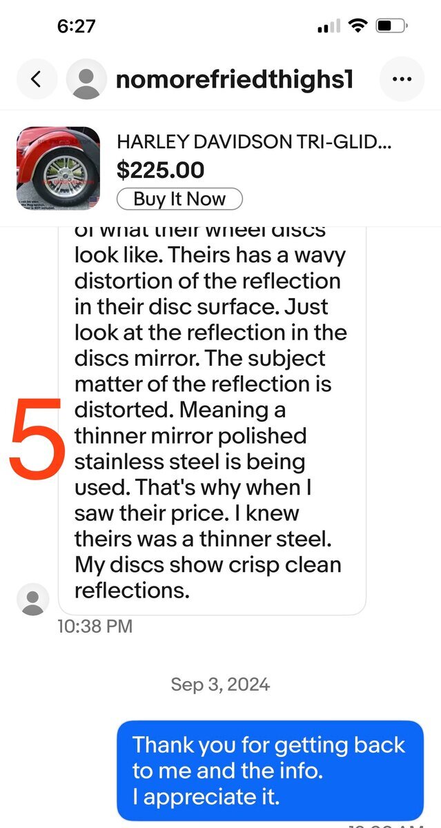

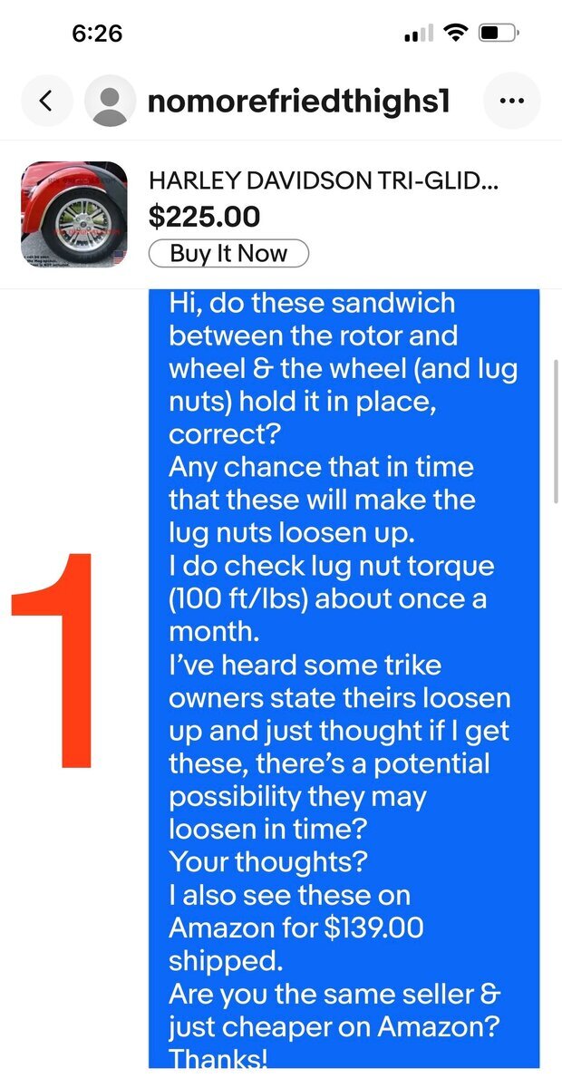

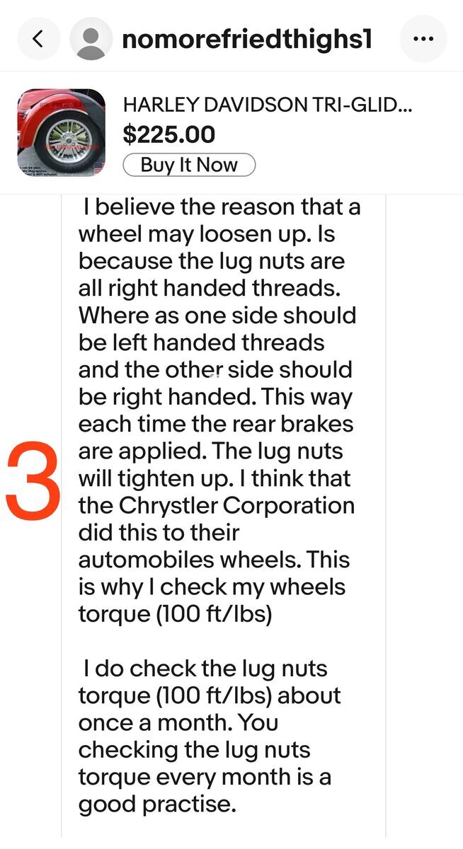

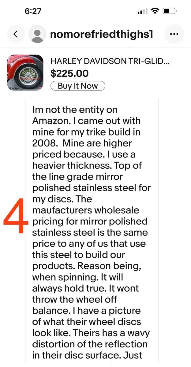

I actually reached out to RJS just this past September (on eBay since he lists them there too) and asked him a few questions.
(I’ve been eyeing these up as well, but never pulled the trigger on any of them yet).
(The pics are numbers in case the pics get posted out of order of our conversation).
Im still 1/2 tempted to try the cheaper ones… 🤷🏻‍♂️
Hope this info helps!
I had these SS Disc on my 2016 Tri Glide and now on my 2020 Tri Glide. With a total mileage 70+ miles since installation. I have never had a wheel loosen up or feel that the wheels are out of balance. I bought them from RJS Orginals.

I have had RJS disc on two different trikes, currently have 35,000 on this trike and have had zero issues with balance. The weight of these discs is minimal compared to the mass of the wheels and rims. And being a Tool and Die maker for 46 years with the last 20 working for GE Aerospace I am very well aware of how rotating mass can affect balance.
Some of them are not mirror polished, so be careful what you buy. I would only buy from RJS, you pay cheap you get cheap.
Totally agree on quality parts.
I think this comes back to the original question that the OP (Trampas) has (along with a few others) … that some listings also claim “mirror polished”.
I know that RJS has a reputation of a good product…. The question is now other sellers also claim mirror polished for a lot cheaper.
For what they are, and where they go… is there really going to be any truly noticeable difference? $140 vs $225 is quite a bit of $$ difference.
Good parts aren’t cheap…. Cheap parts aren’t good. I also believe that, but depending what and where the part is and where it goes… in this case, (polished stainless wheel rear wheel disks)…. Is this a aftermarket part that is really going to be noticeable?
I think that is the main question that the OP has, and others curiousity as well.

The thickness is what you have to be careful of, to thin and they will rattle, like every thing else. Pay your money and take your chances.
If you pull a big travel trailer with alloy wheels, you’ll quickly learn about the phenomenon of the lug nuts loosening up.
It has nothing to do with RJS’s discs or being right handed threads on an opposite axle. I don’t know the exact mechanism why it happens, but aluminum is softer and I suspect it has something to do with the softer ductility of the material compressing as they are tightened, then heat cycling from braking heat. It’s seems worse with new rims being mounted for the first time.
I always carry a torque wrench in my truck when I’m pulling a trailer. After I’ve had a wheel off, I initially torque it. Then after driving 100 miles, pull over and check them and almost always one or two will be a bit loose. I’ll check them again when I get fuel, then again the next morning when they are cool. After about the 3rd time of checking, they are good and I don’t have check them anymore.
With steel wheels, I never have them loosen up.

Thanks for all the replies, if I pull the trigger on these I will go with the RJS ones, as he said in the post with 14TG his is thicker, maybe the others are good also, don't no, but RJS has been doing this for many years and I should have bought from him many years ago when they was cheaper and he was the only one selling these at the time.
