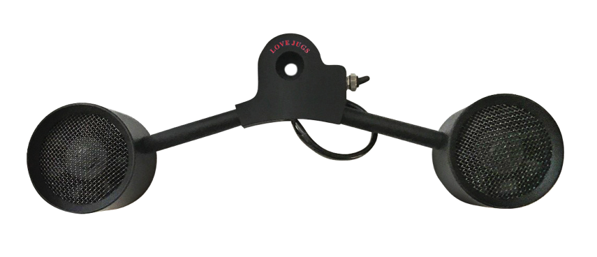

Floorboard extenders and Mighty Might fan
Randy sells the fan

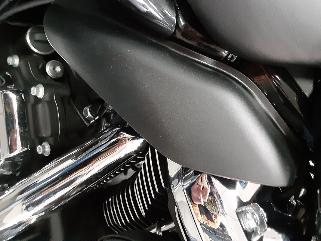

If you do not want to mess with the cat (or you can do this in addition to removing the cat), wrap the hottest part of the exhaust with this TAPE. It will greatly reduce the amount of heat radiating out to her right leg.
Here's a vid of that tape....on your Freewheeler, you can put the tape behind the shields and it will not be readily visible.

If she still has the OEM air cleaner...that is something we call a Hot Box. See video below. If not, then it is just the heat radiating from the engine, and cooling it down should help her leg.
