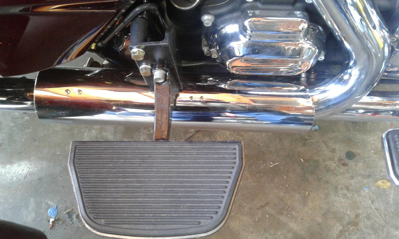

Leg Heat
I had the same problem on mine - I made a 3/4 round heat shield out of a car / truck echo tip - left it long enough to run all the way back to the rear body - Big change - You can also add another smaller one on the vertical part - I also made 1- 1/2 rear spacer plates for the rear floor board to help the heat off the passenger foot an ankle 20180825_170837.jpg
