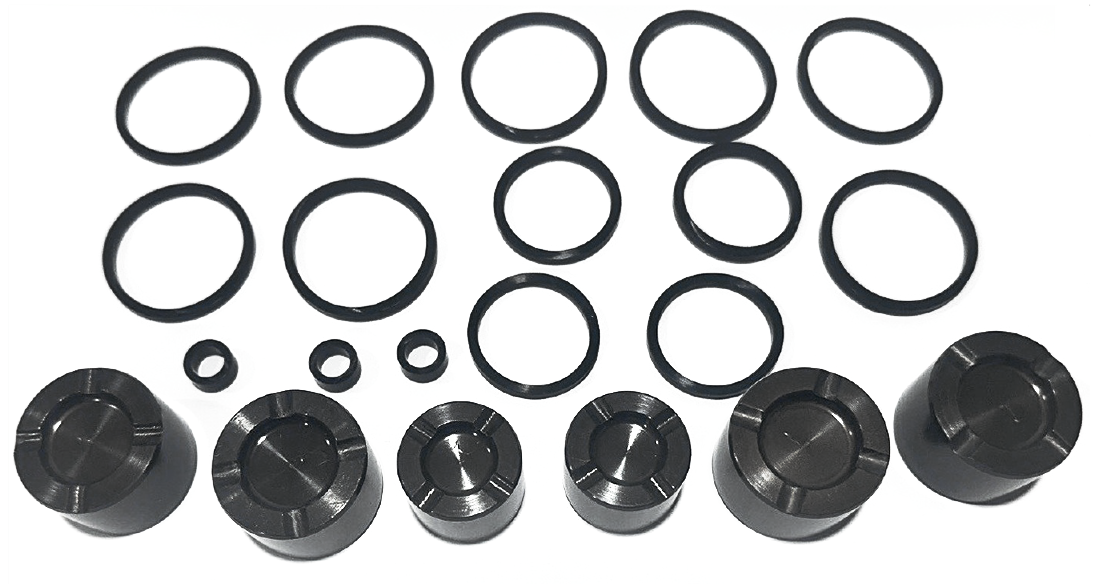

Hi,my front right brake rotor is heating up badly.Tried everything I can think of,new pads,have taken calipers apart ,cleaned and inspected ,ok,inspected o rings,they were plyable and no damage,pistons look good.Put it back together,same problem with the heat on right rotor,left is fine.Bled complete brake system with new Dot 4.So thinking it has to be the o rings,they are the original ones so maybe they have swelled or maybe the original brake fluid did something to them.Figured not a big deal,get a caliper rebuild kit from Harley maybe a hundred bucks or so,well you guessed it,Harley doesn’t have a rebuild kit for it.They want you to buy a 650 dollar,( Canadian)brake caliper.My question is can anyone send me a link for a company that sells a rebuild kit.The calipers are six pistons.Thanks
If you can find a good parts guy at an auto parts store he may be able to match up the caliper O rings and dust boots for you
Older Napa parts catalogs had specs on the hard parts for many calipers and wheel cylinders

My 17 Ti Glide has linked brakes and both front calipers have a small piston for the rear brake pedal. I have been fighting this issue with the brakes for some time now and the only solution I have come up with is to make the front and rear brakes separate units, and I'm still not sure this will fix the issue. I have a set of 4 piston calipers so I will be installing them this winter then blocking off the line from the rear master cly that runs to the front. Sinc there is no ABS on my bike I am hoping I will have no codes.

No not yet, in my case it is the front calipers that stick. I have the calipers and the rebuild kits for them, I just haven't gotten around to replacing them yet.
