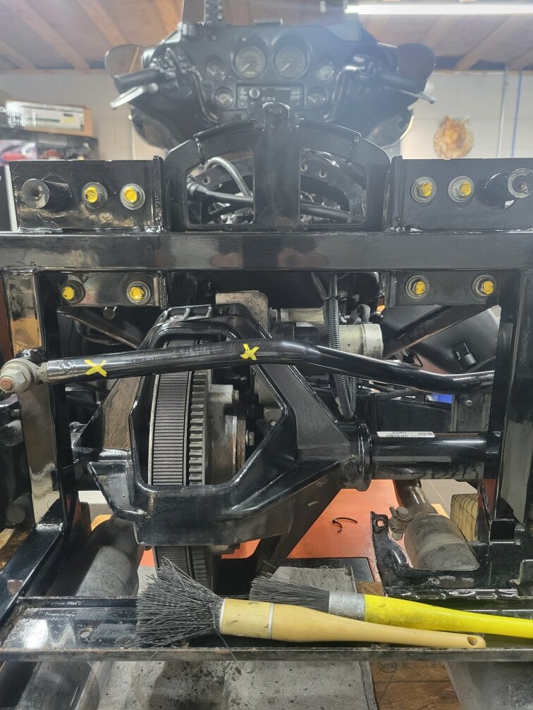

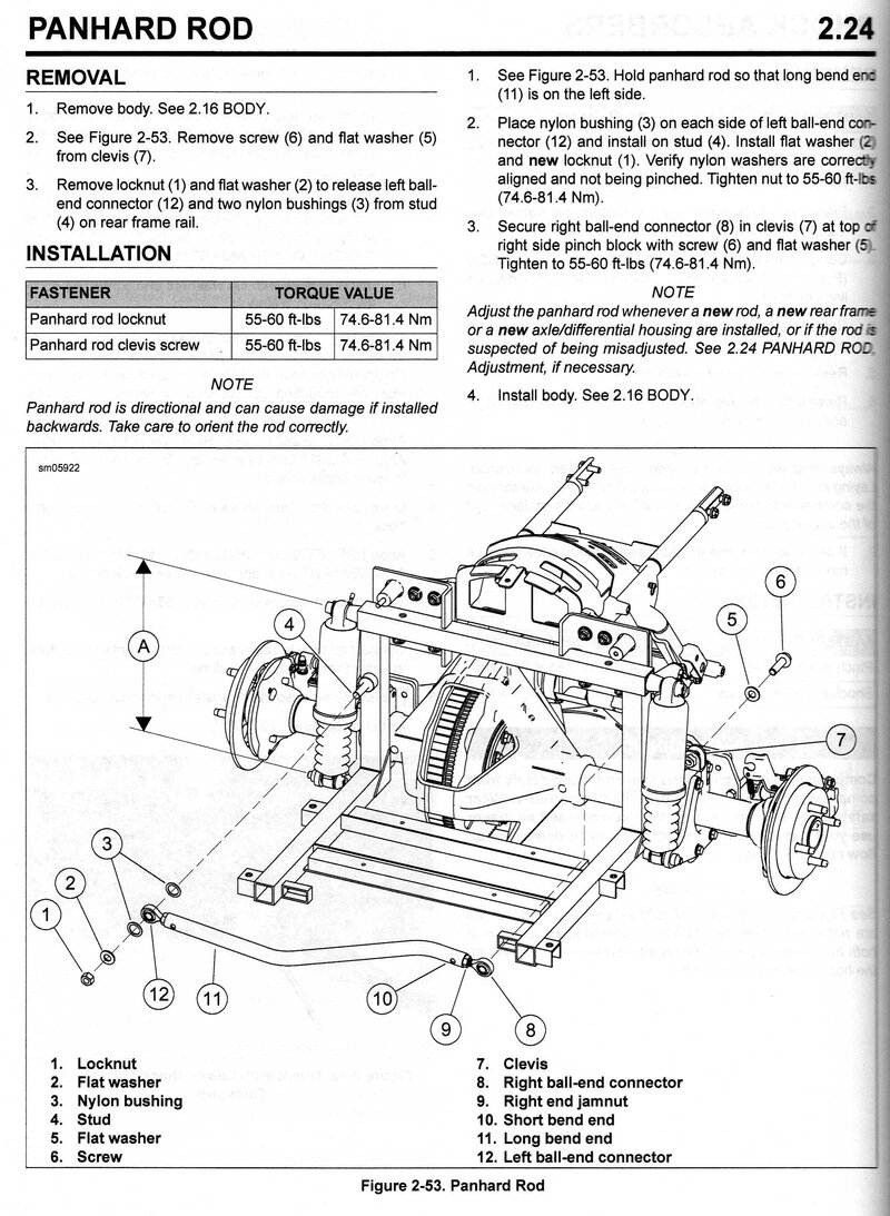

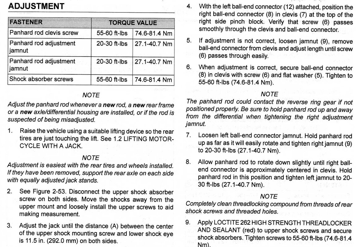

Thank you, Papa Zook, for the bump! The rear frame and intermediate frame were out of adjustment. I loosened the 8 bolts in and leveled the rear frame and adjusted the Panhard Rod (X) 1/2 turn. Its dead nuts level now! Thank you, sir!
