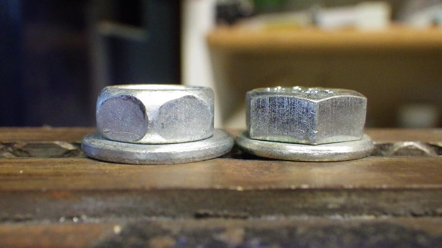

And I know what you mean about being exactly square on their bolts. It is probably due to the fact that Harley bolts (on left) are rounded on the top edge. Don't know why, but it does make it a chore to remove or install accessories, especially in the many tight spots that are on a Tri-Glide.
