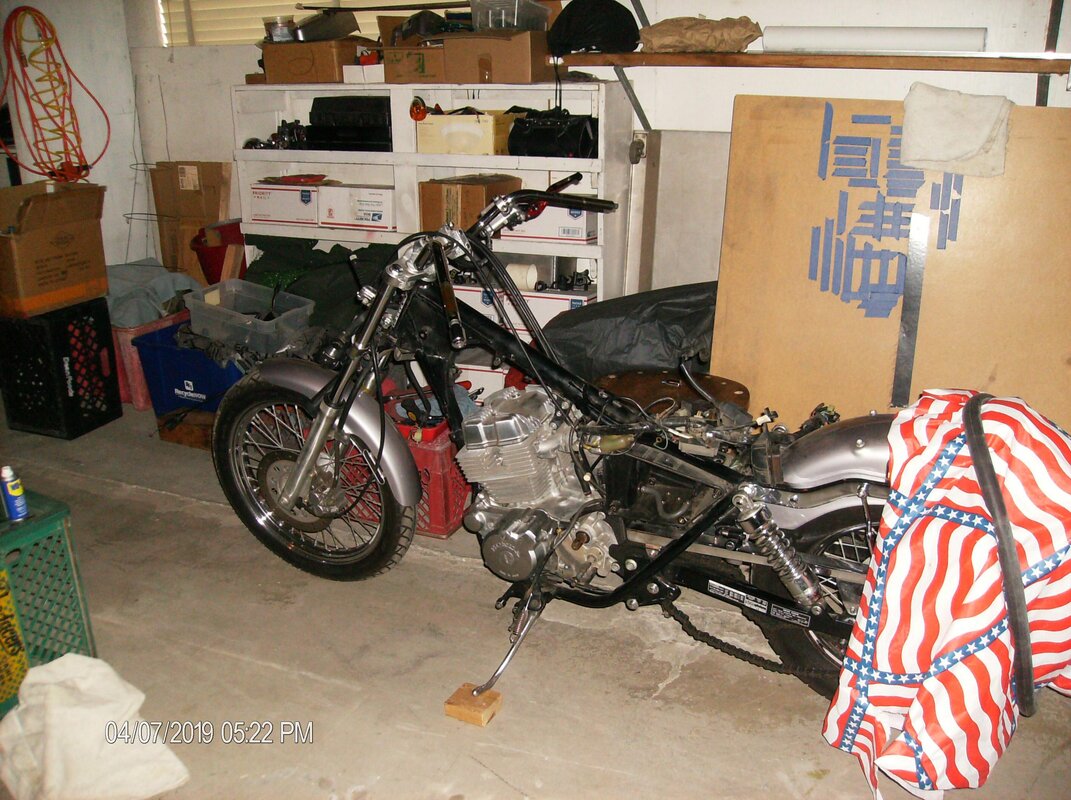

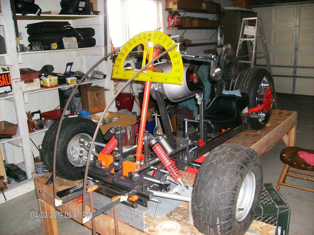

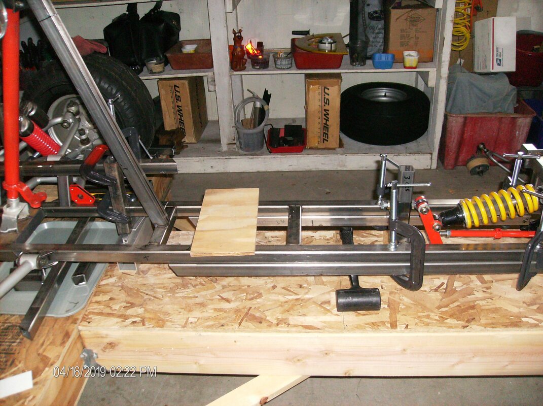

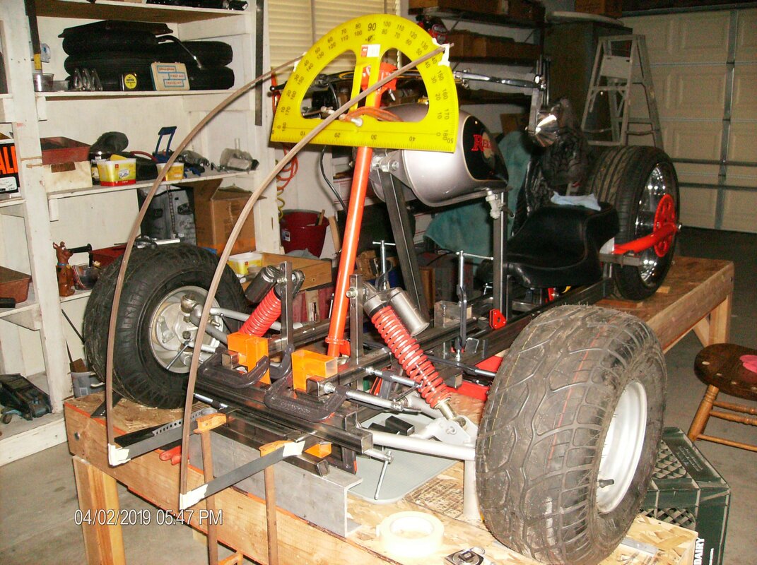

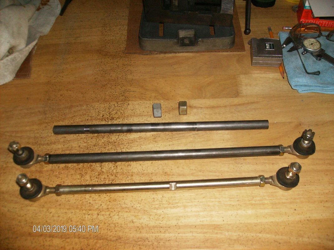

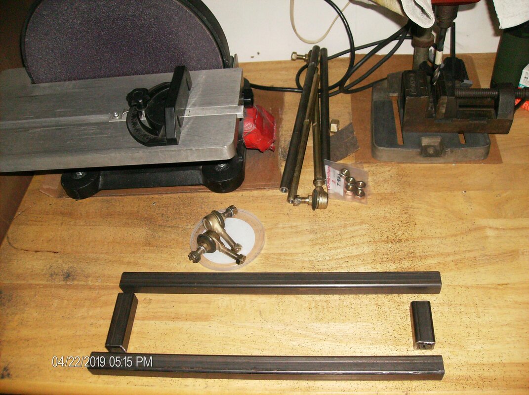

HPIM3409.JPGHPIM3410.JPGNeed to widen the steering arms and re-thinking the seat height :xzqxz:
True that, being to low to the ground does have disadvantages on the road way's.
I thought it was just to low for a comfortable ride position, but I am a small person, so it kinda looked good for a larger person, just what I seen. Not a lot of fiberglass work for me, but I have done some, and very interested in watching you work and how it can be done. Maybe I will learn more about this area.
Thanks for sharing this project with the site.

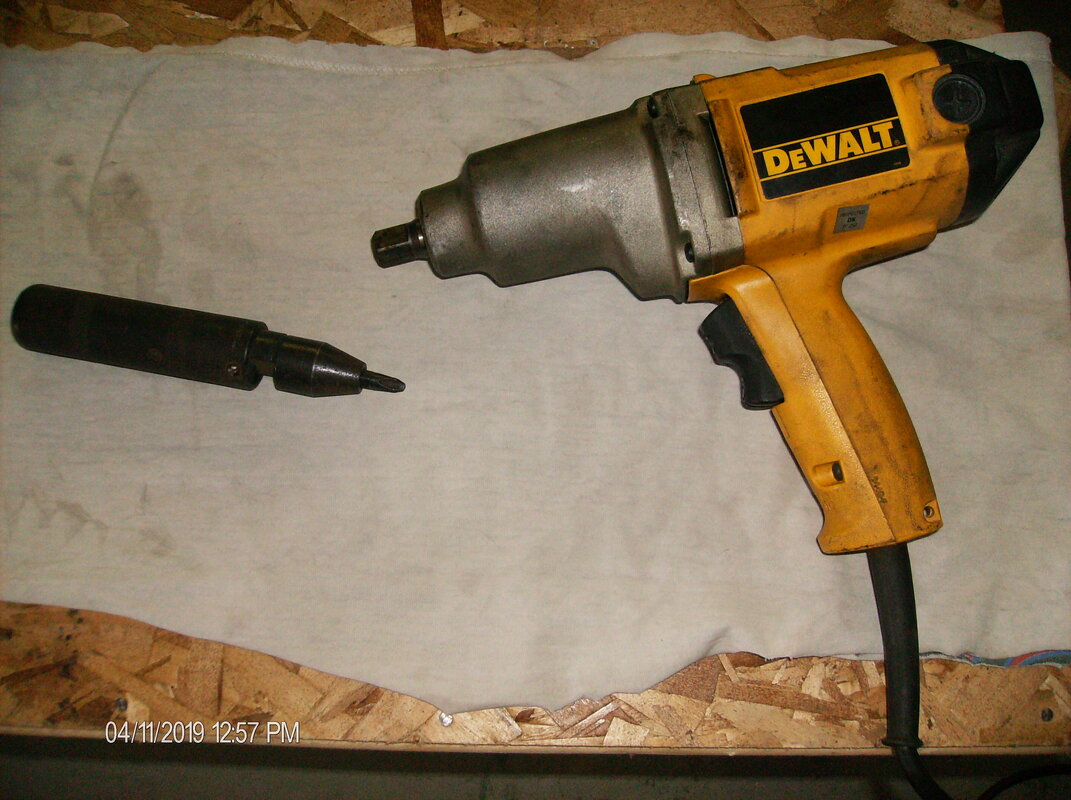

Thank you guy's, you are so right, I went from building hot rods to muscle car rebuilding and they both priced me out and the tools were not metric so here I go with Harbor Freight 12 point impact sockets (20% off heeheehee). I have the DeWalt impact wrench I used on independent suspensions and a hand held (smack it with a hammer) Allen head bits with cross point bit.HPIM3420.JPG

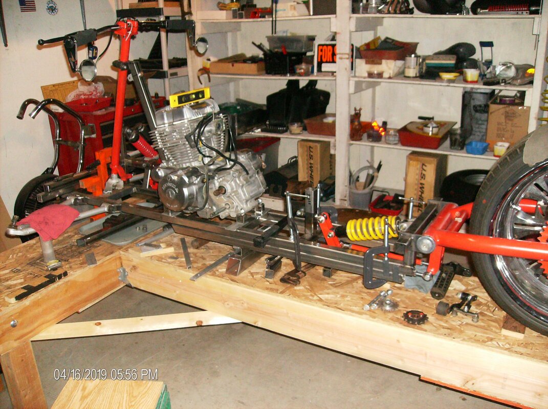

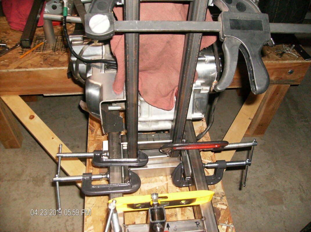

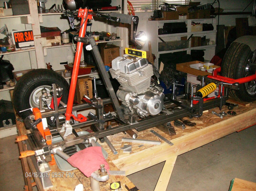

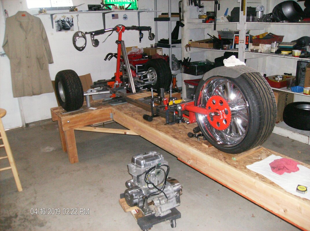

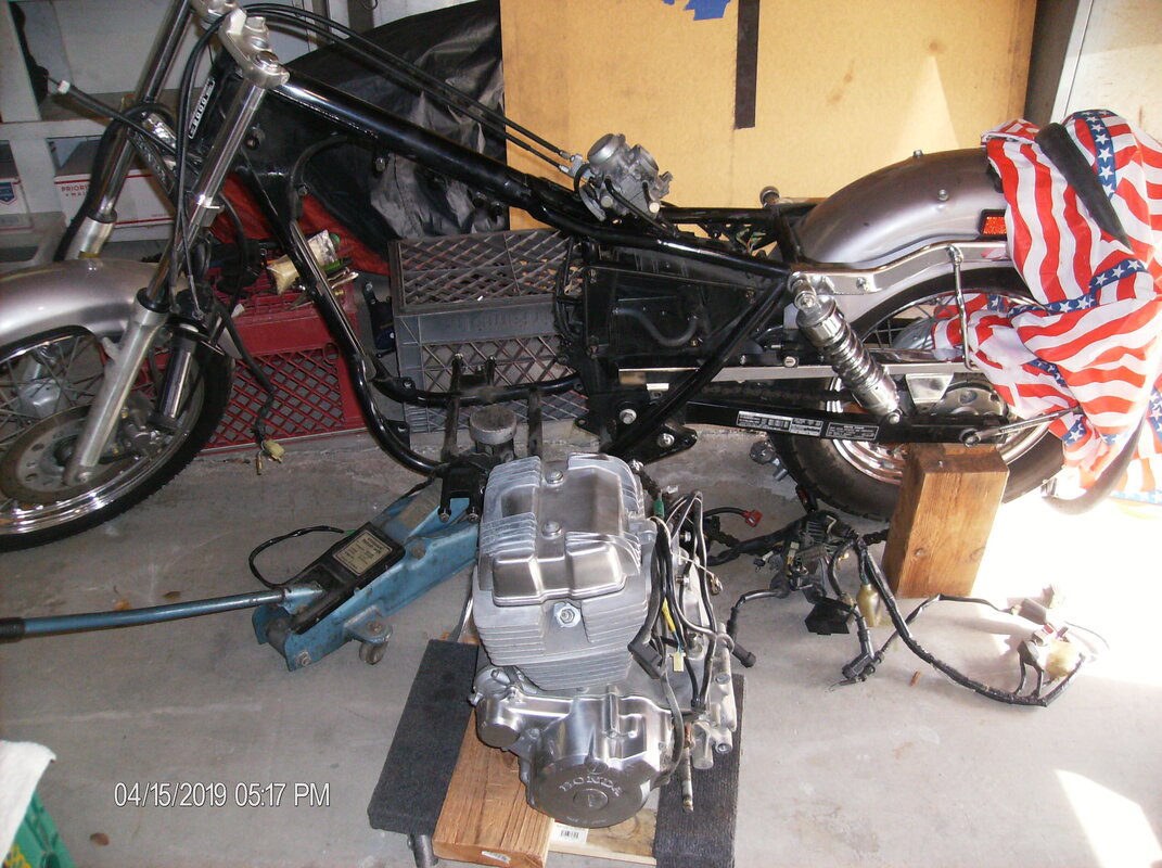

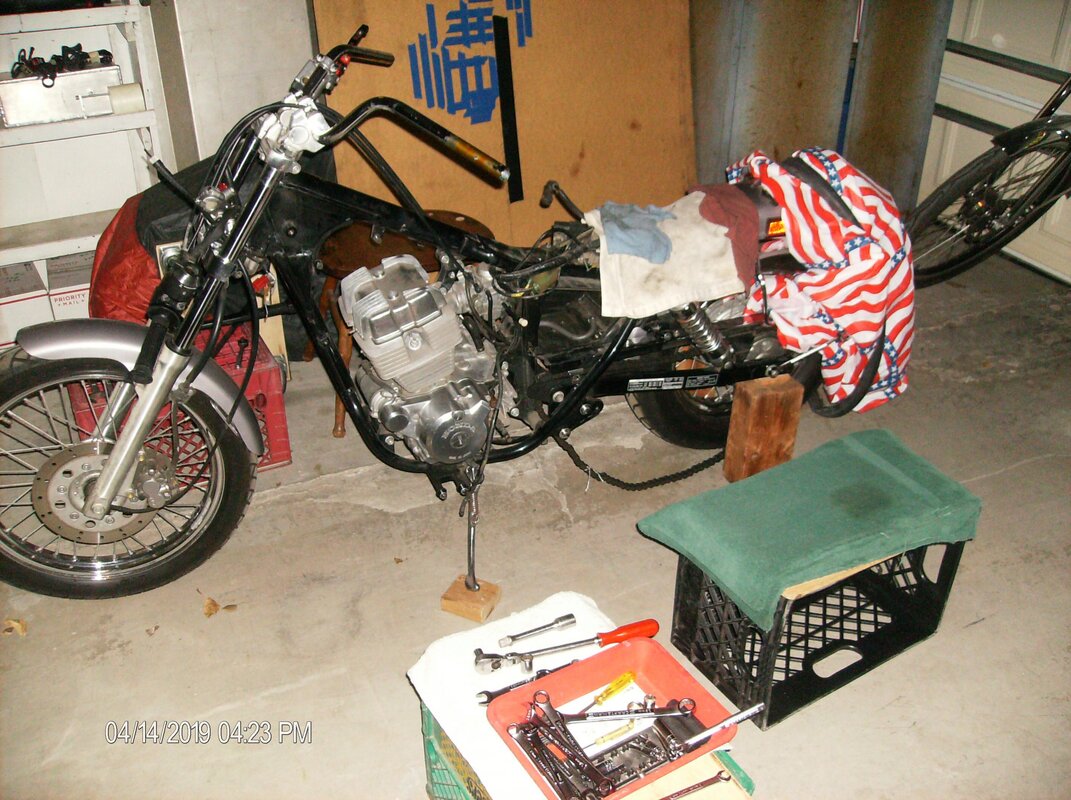

HPIM3423.jpgHPIM3424.jpgHPIM3425.jpgHPIM3426.jpgTook 5 minutes to put the engine in place and all day to level it out and measure for engine mounts, :gah:

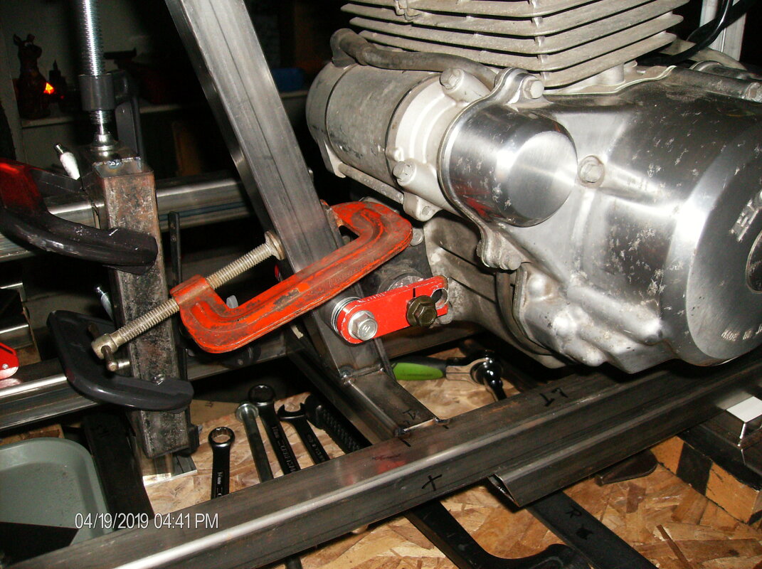

HPIM3427.JPGHPIM3430.jpgMotor mounts front and lower rear, single vertical rear frame is out because carb air cleaner will be in the way so duals will maybe work? Or maybe 45 degrees to side? AND maybe test fit exhaust??? HAPPY EASTER, Rabbit Sex.jpgheeheehee!!!

HPIM3438.jpgThis 1'sq x 1/8 should work, I wanted a one piece but the carb air cleaner would not work, sooooo!!!
Did something shift during the move ? Bummer if the vertical frame is off and if it can not be corrected, I am with "can't you joggle the mount brackets so they hide the vertical offset ? It is your project and I am sure you already have an idea on how to correct it all. Hope it does not set you back to far on your progress.

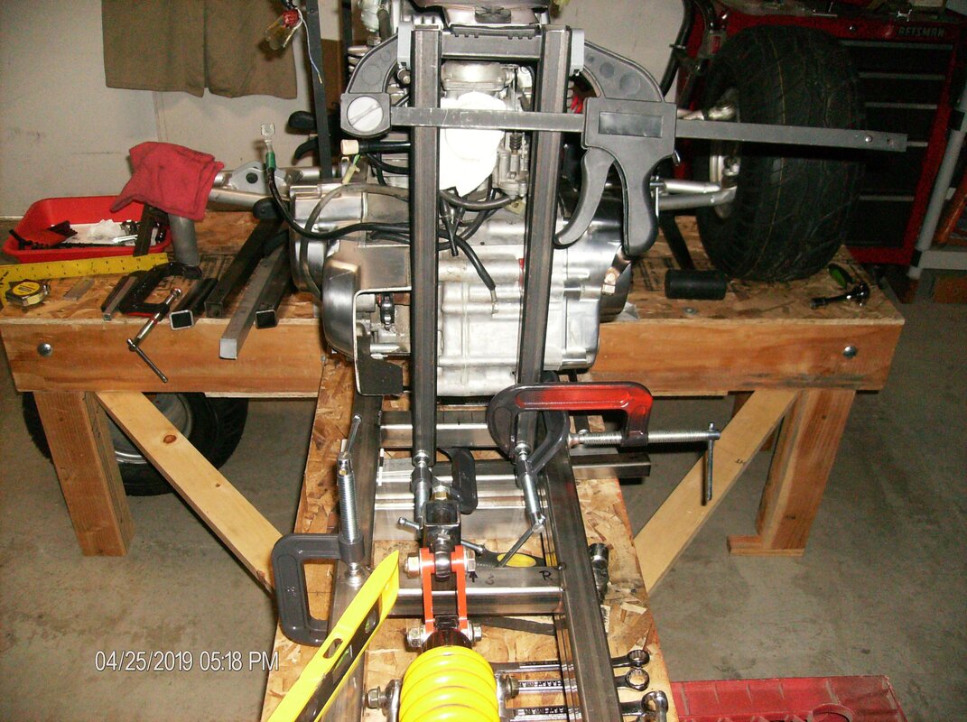

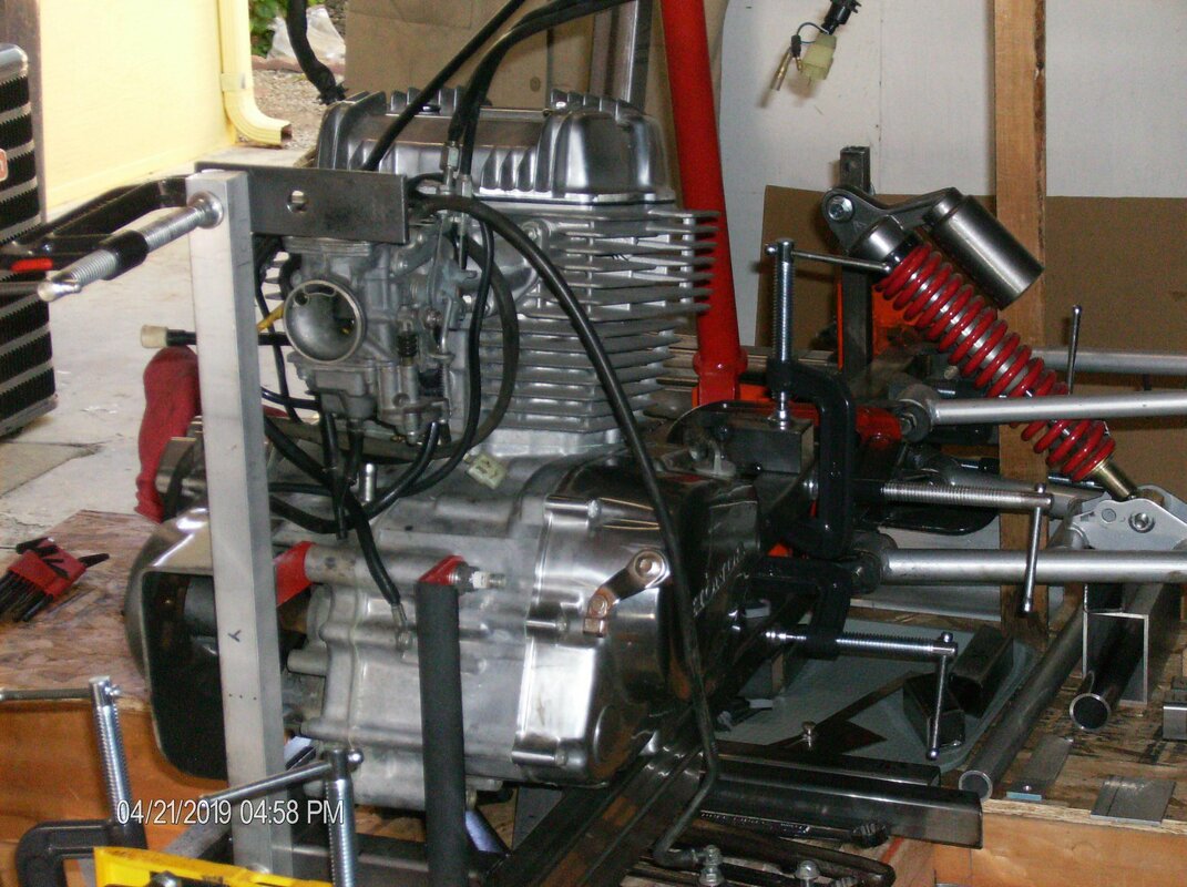

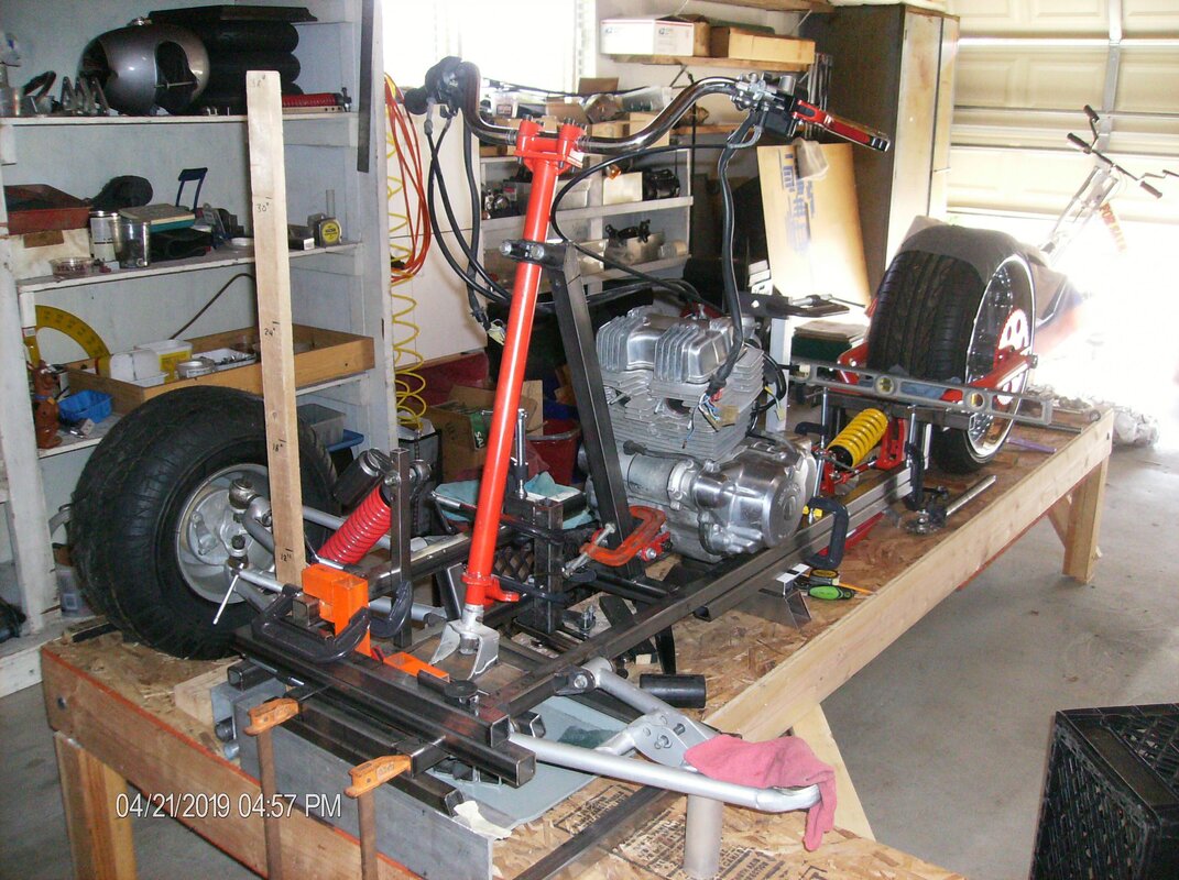

Carb is centeredHPIM3450.jpgso the 1" steel frame is centered to the carb but not to the lower frame it is about 1/4" off, so now the air cleaner with offset is a little to close on the inside, and the left side is almost touching the side engine cover, maybe 3/4" steel sq. tubing or??? More measurements coming...
RebelRouser

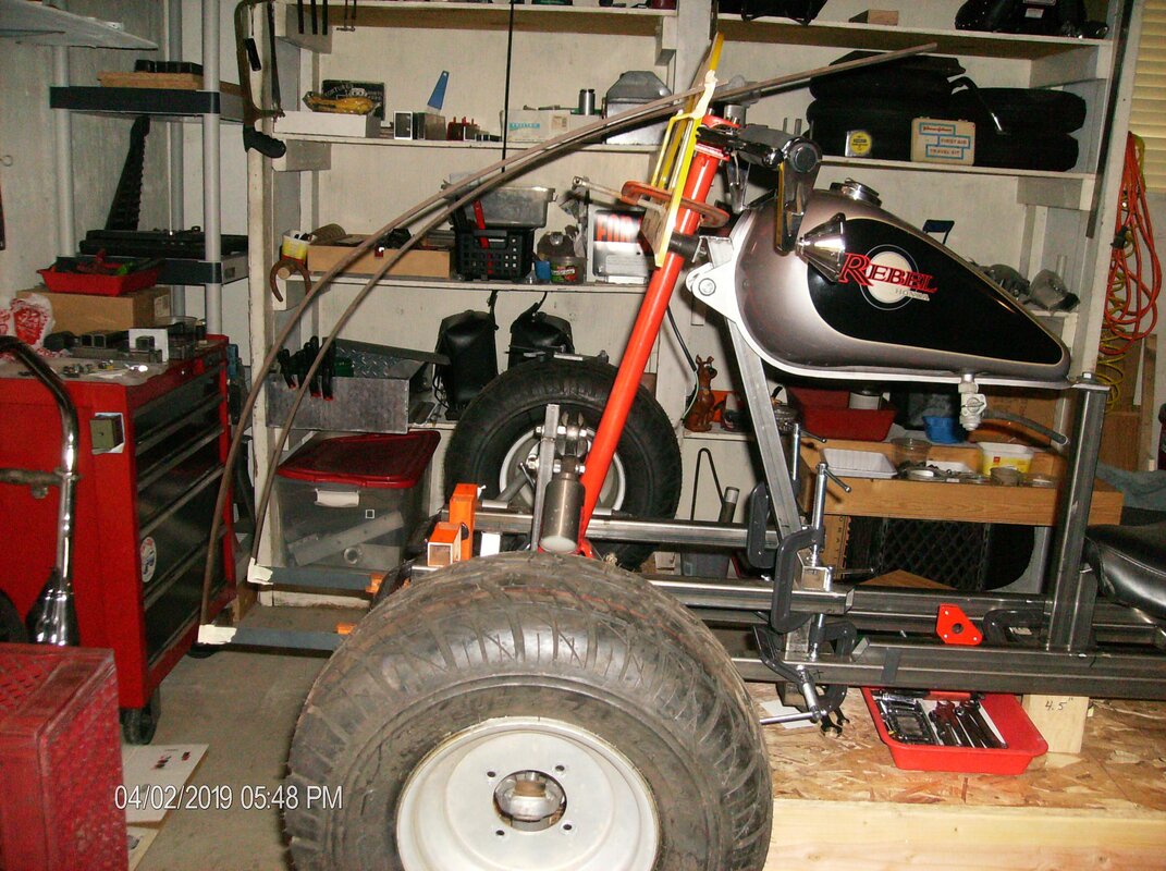

OK! HELP, I'm thinking the frame (Vert.) between the lower and upper should be one piece and not two, I will make a circle of 3/4 solid steel around the carb/air cleaner to the upper piece, should I run a straight out air cleaner or 90 degrees? I would like all viewers to weigh in please??? HPIM3456.jpgHPIM3457.JPGHPIM3458.JPGHPIM3459.JPG And the PVC elbo will be red...EDIT: I need as much room with the lower vert. frame for the seat attachment and to clear the rear fender/tire.
OK! HELP, I'm thinking the frame (Vert.) between the lower and upper should be one piece and not two, I will make a circle of 3/4 solid steel around the carb/air cleaner to the upper piece, should I run a straight out air cleaner or 90 degrees? I would like all viewers to weigh in please??? View attachment 71182View attachment 71183View attachment 71184View attachment 71185 And the PVC elbo will be red...
think i would build the frame around the back of the filter and use the upright as shown
i think it would tough to fit the square tube to the 3/4 round to make it look presentable and strong
i think it would b easier to cut 2 ovals then a band to make the inside an 1 for the outside... like making an oval from tubing
sketch i hope is self explanatory..
It does look good TommyJ, nut cracker it is, or a chest opener.
I would choose the air breather design that allow's access the easiest. Bring it out and down seems to take more distance and brings it closer to the rider, or is it my eye's ?
The look of the breather attached directly to the intake looked the shortest to me, and it does put it up to be a chest crusher. So this is a designer's call to me, it is what you are after that counts.
That vertical and motor mount tab is a nut buster for sure and makes me week between the knee's.
Top bad we could not flare the seat at that end and bring it up over that area, just enough so it would not allow the rider to slide, slam, up against that vertical bar.
This may require a custom seat to make all look right and function at it's best. Do you still have chain clearance under the seat ?

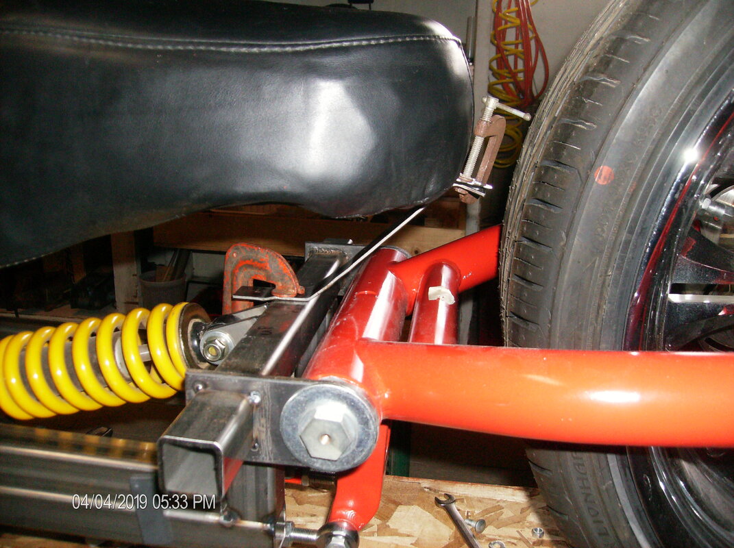

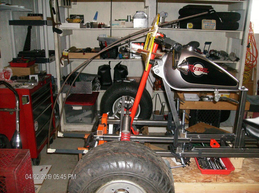

Thanks GPS, HPIM3473.jpgStraight edge for the top of the chain, now what is that going to do with the carb and seat?HPIM3477.jpgHPIM3478.jpgHPIM3479.jpgFor every action there is a reaction...:gah: EDIT: Did you notice the new welder 220/110 stick, Home Depot, I/4" plate, we will see...
That is so true.
You can raise the seat higher, but that might interfer with the center of gravity in cornering, unless you as the rider like to shift your own body weight from side to side. Oh crap, did I ever wonder on my bike years ago. I am small and it took alot of work sometimes to keep in the corner, and yes I over shot a few of them and survived it.
So if you want to keep seat as low as possible, than one would have to make the base from steel or something strong. You can use what you have and just modify the areas needed to create the prototype, I like the look of it, but rider size matters. Me a thin long seat works, a Fat Boy seat swallows me up.
My mind says make the seat wider and deeper so it sits over the chain and covers it up like the "old chain guards" on our pedal bikes. Maybe have it tube like over the chain on the left side and attach to the lower support beams.
