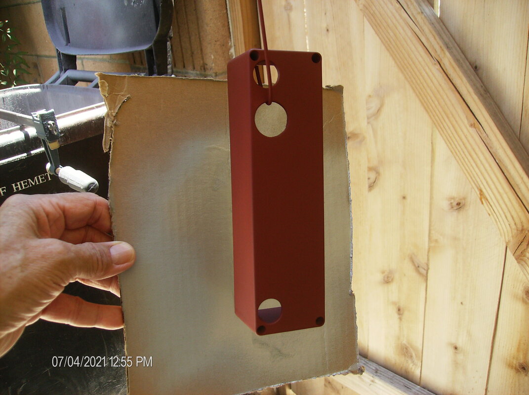

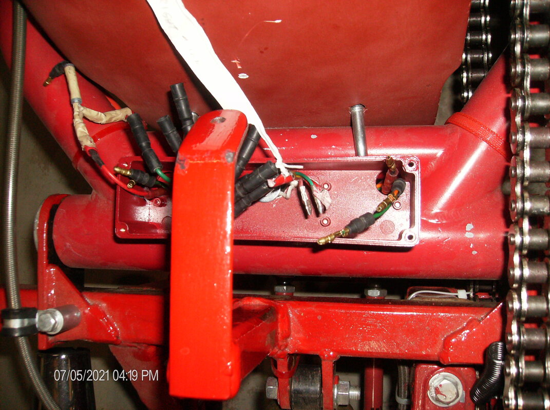

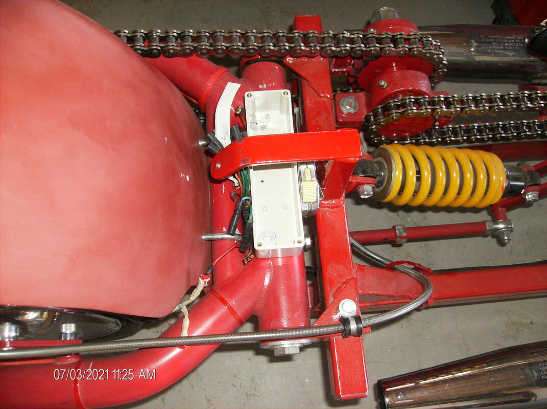

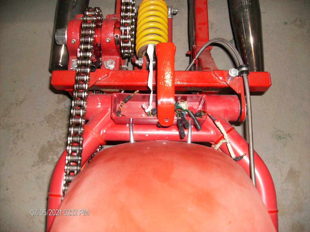

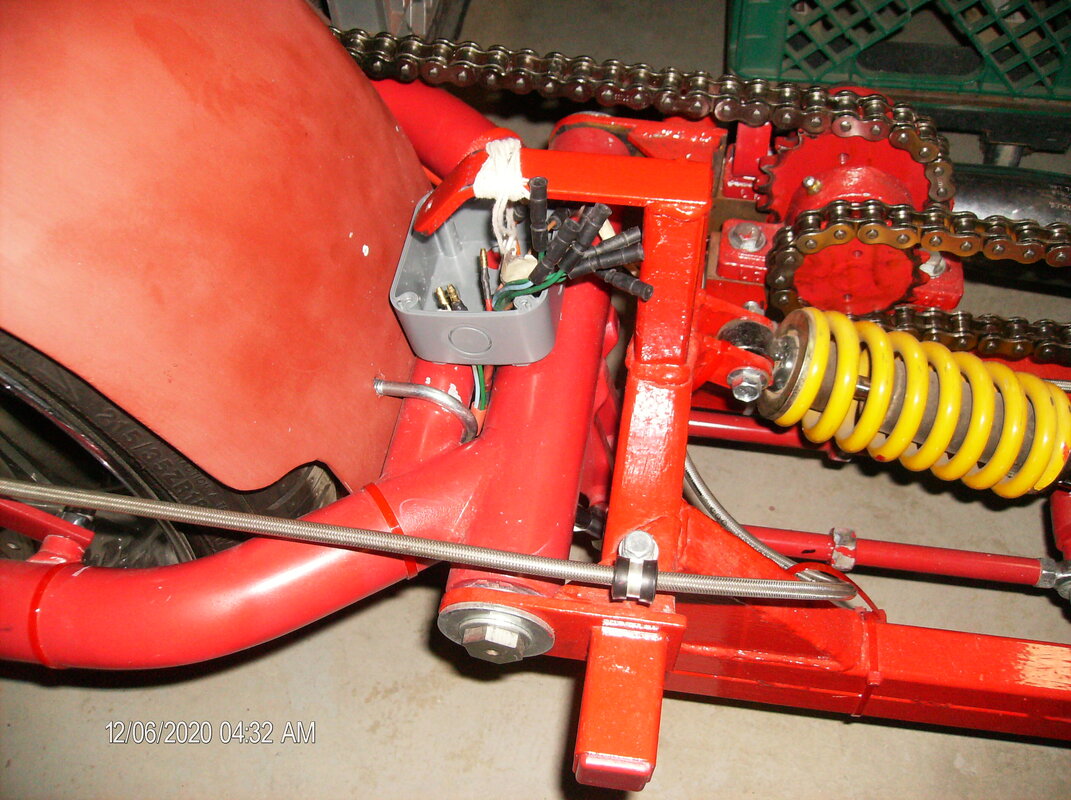

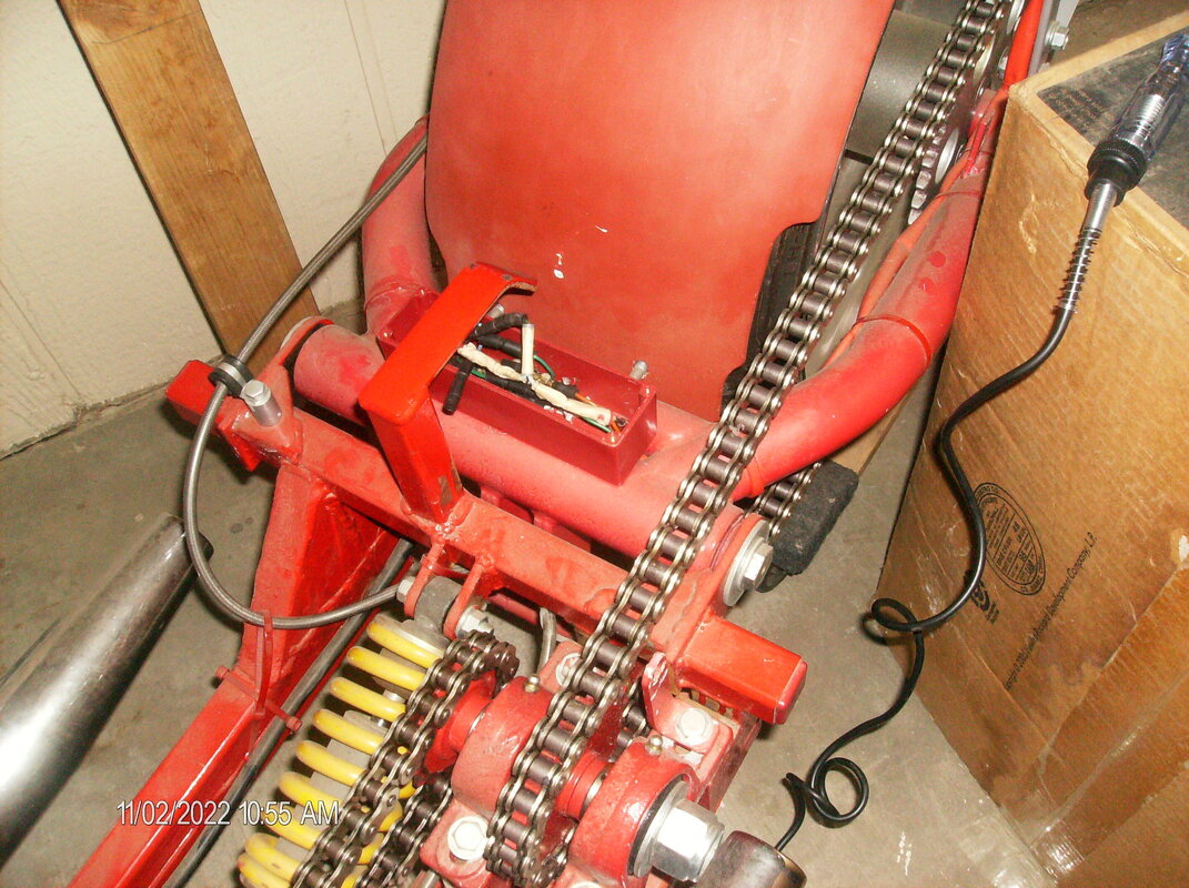

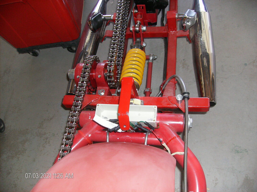

This Junction Box is my problem (besides me) I cut the wires too short, So the tail wires are on the left side and the harness wires to them are on the right side, so I need a long skinny 8"ish x 2.5 x 2.5 max so it will not get hit from coilover movement, I do not want to start all over with the wiring so this the last ditch save, DAMN could only find one on the eBay, In China only one month deliver and now back order sooooo.....:gah:
junction box
look for a trailer light junction box...they are plastic and longer than what you have...like NAPA or a trailer supply company....junction box.png

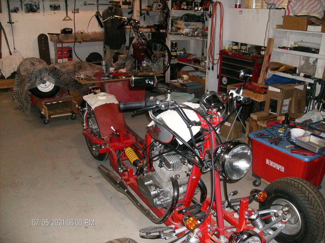

Still house hunting, Prices are so crazy high right now, should have done it much sooner, Damn me... Have not rode RebelRouser yet and it's getting to me... PROBLEM, The engine starts and stay's running in idle, as soon as I give the gas it dies or starts to, sprayed carb and manifold for Vacuum leak with WD-40 when running and nothing, short of a carb rebuild what else could the problem be ??? Remember all is stock engine and wiring harness, Honda 2000 Rebel 250CC.:gah:
Wires
Would you believe? there are "2" white 6 pin connecters and I mixed them up, BUT! 1 was up front of the engine and the other at the rear so how can this happen, (damn beginner-me) engine runs and idles great. Should make a deal on a house this week, I changed escrow people twice and realtors 5 times, WHY! Lazy and NOT thinking outside the box for my needs (hot rod and Trike working areas)...
