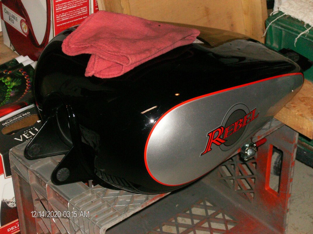

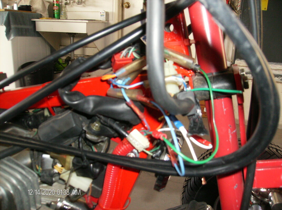

2020-12-14 wiring.JPG-Ohhhhh! Do I hate wiring, :gah:-Maybe this new tank will make up for it today, checking for petcock leaks, ready to install after the F****** wiring, Wife's got me on "HONEY DO" this week because of Xmas...2020-12-14 new gas tank petcock.jpg-Damn it's getting cold in the "ManCave"

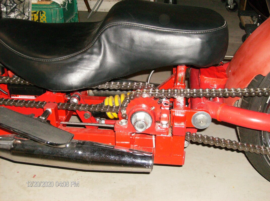

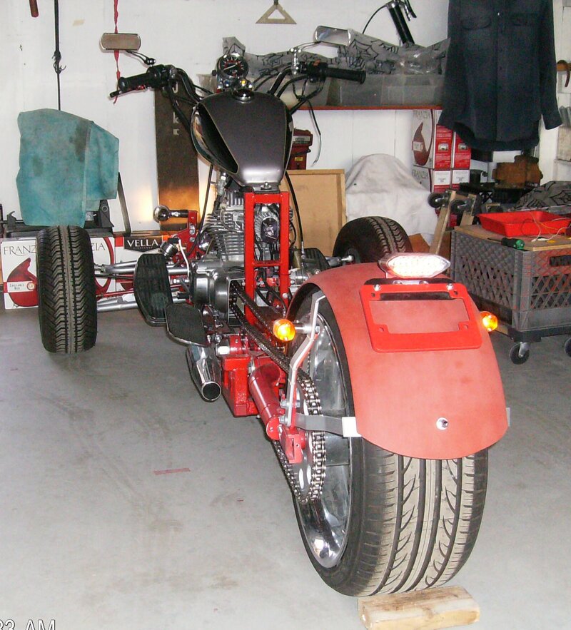

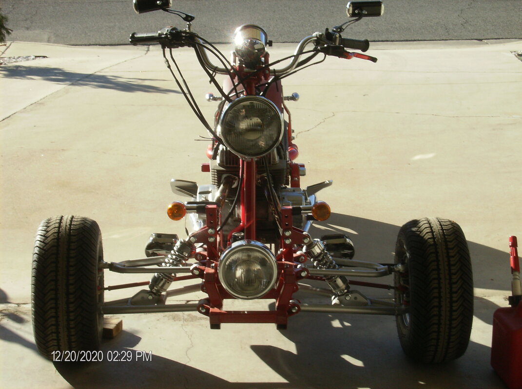

2020-12-20 Seat and Box.jpg-2020-12-20 Headlight on.JPGWow these 7" headlights look a lot better than the 5" one on top, now to wire it up and then the gas tank and fill bleed the rear master cylinder and brake caliper, THEN, THEN, let the good times roll, I will be the "REBELROUSER"... :clapping:

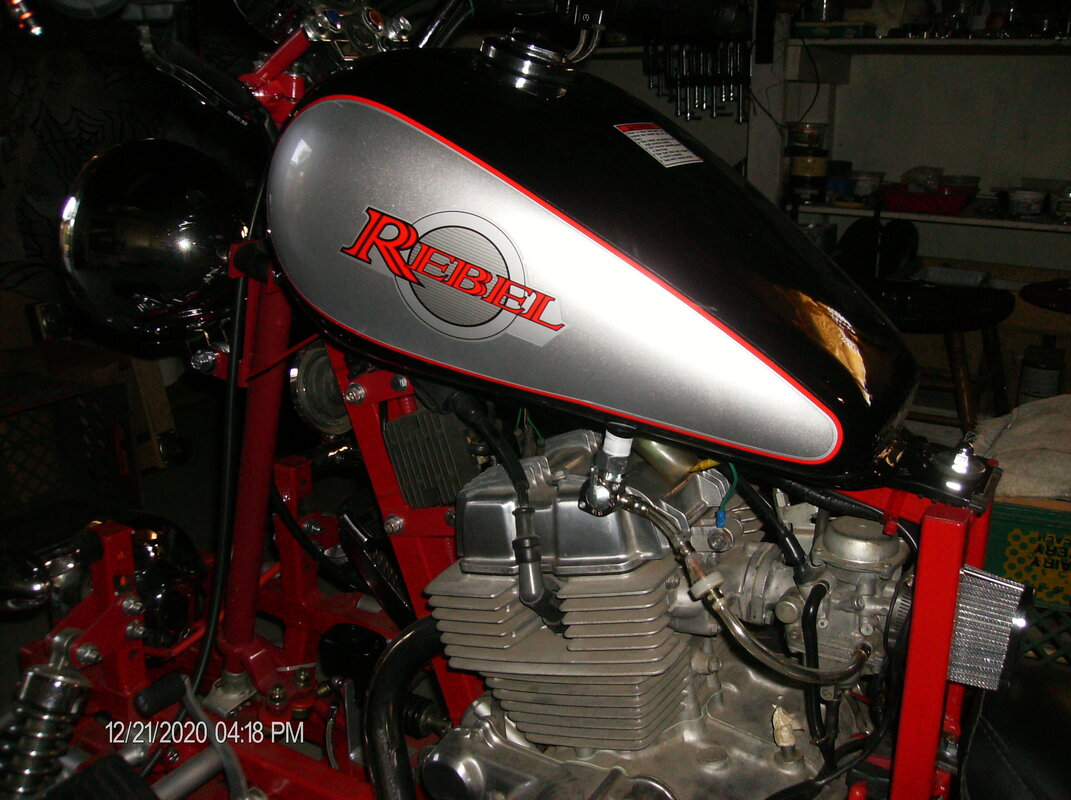

2020-12-21wires gas tank ft brake.JPGNew tank installed and wires tucked under it, foot brake master cylinder filled and bled, NOW of all times there is a problem with the signals, my 2000 bike does not have LED lights, BUT I did put on new signal lights LED and they do not flash because of LED, used jumpers on old lights and they flash. HELP! What do I have to do to get them to flash???
View attachment 94241New tank installed and wires tucked under it, foot brake master cylinder filled and bled, NOW of all times there is a problem with the signals, my 2000 bike does not have LED lights, BUT I did put on new signal lights LED and they do not flash because of LED, used jumpers on old lights and they flash. HELP! What do I have to do to get them to flash???
Led lights use low voltage. You will need a load equalizer to make them work.
Look here https://www.amazon.com/SYLVANIA-Equ...er+for+led+turn+signals&qid=1608609126&sr=8-3

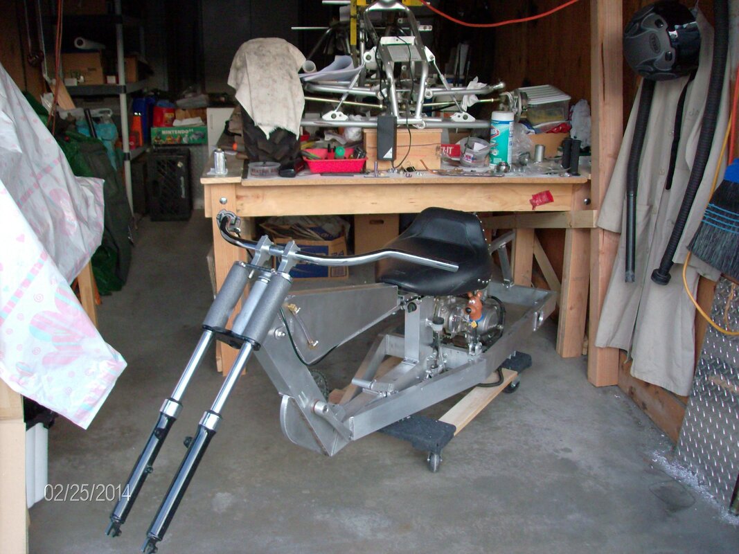

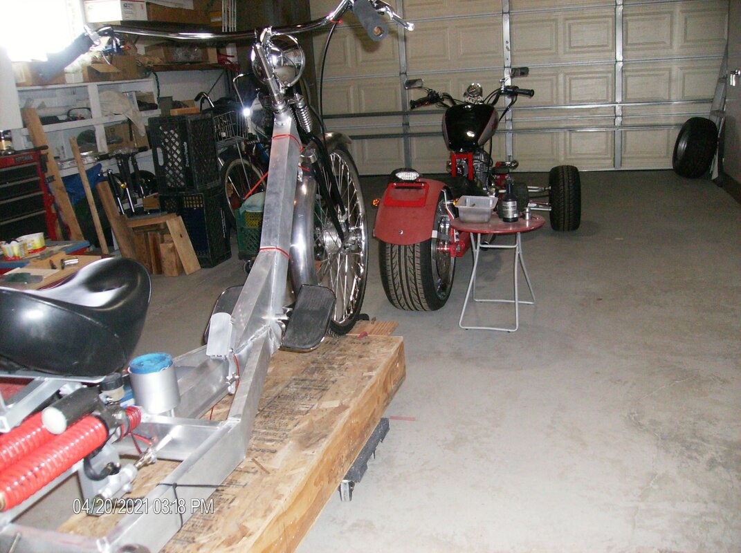

2014 Garage.jpgThis was my garage before the move of 2018, Finishing up on the "Trikester" and much mock up on the "RebelRouser"... "HAPPY NEW YEAR EVERYONE"...

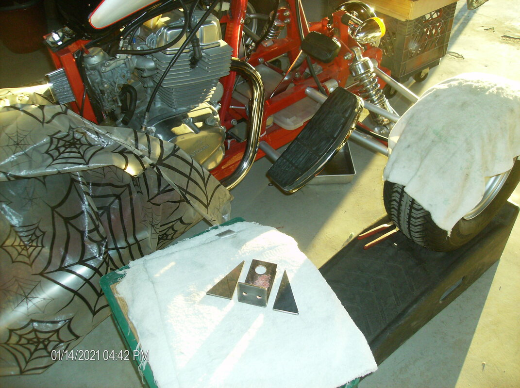

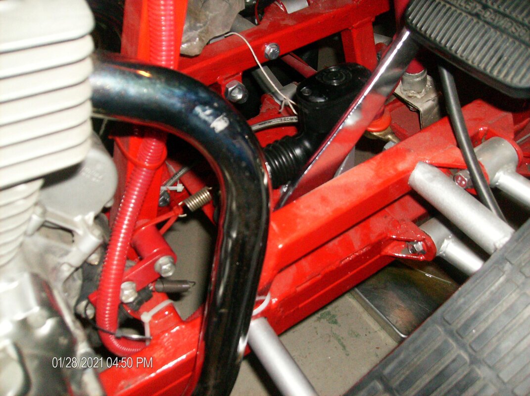

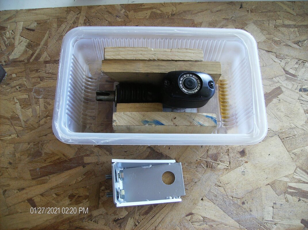

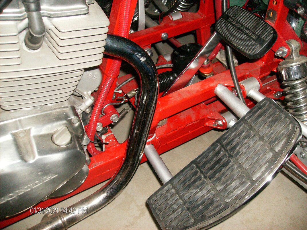

Damn I love to hear this engine running,:clapping:BUTTTTT! 2021-01-14 MC Brake Bracket.JPGNeed to finish the brakes before a ride can happen so I need to tighten the front brakes through cable adjustment and if not I'll need to get into the shoe drum adjusters and tighten, but the rear brake master cylinder bracket will flex (1/8 wall) when I push on the foot brake so I made some side braces for the bracket (3/16) welding soon, then back to the wiring for the lights...
