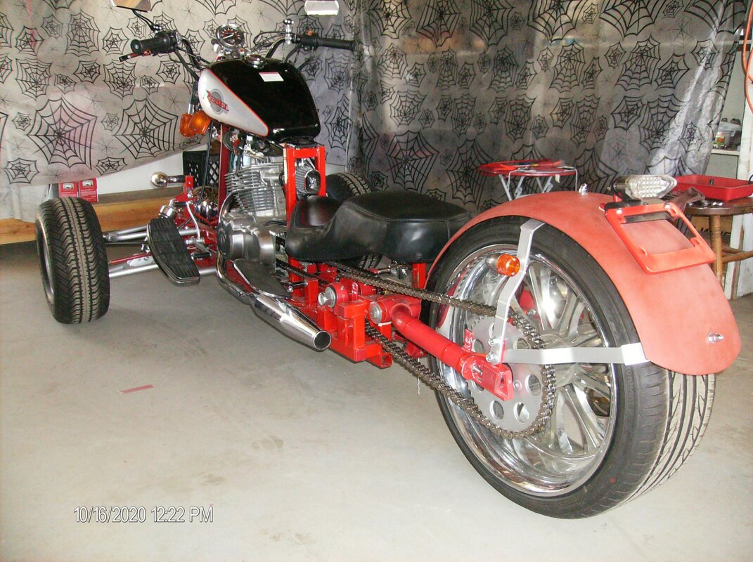

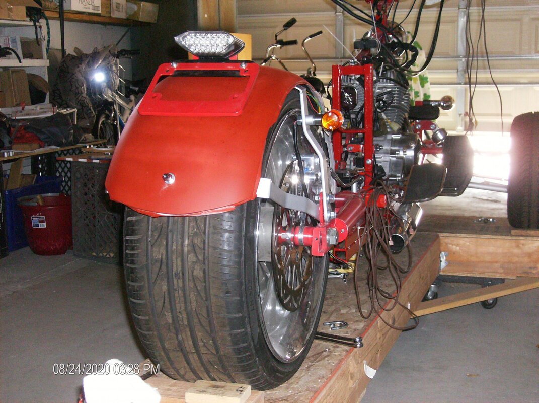

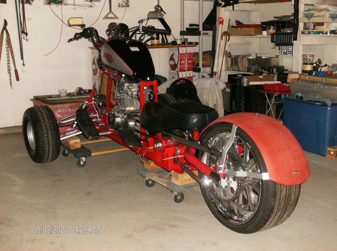

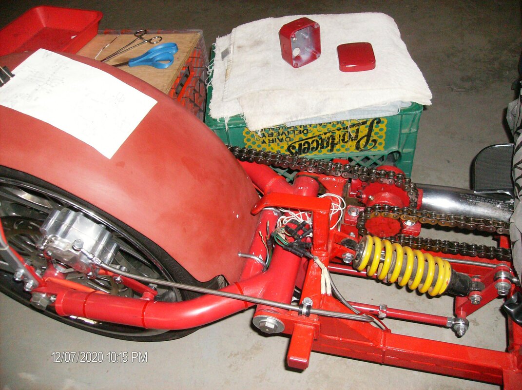

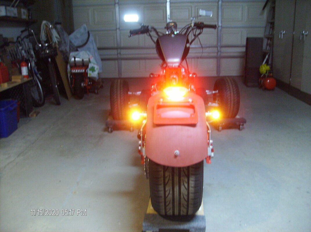

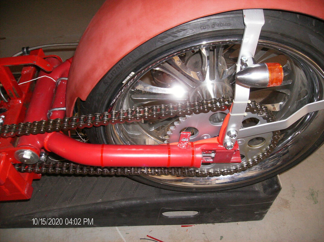

Floored and on dollies.jpgFloored again on furniture movers, front breaks static check, and the chains lock up, AGAIN, last time took the jack shaft apart and everything works fine, can rotate the wheel in reverse all day long BUT forward will make 1/2 to 3/4 turn then sudden lock up??? AND... the engine shift lever is hitting the exhaust 1/4" BUT on the bright side I'm getting closer. I know I'm thinking a little ahead of myself BUT will a short video be down loaded of it running around the block? Does anyone know???
Looking good. On the chains locking up, are you turning the rear wheel forward by hand and pushing all the slack to the top ? Could it be causing it to bunch up in front of a sprocket? Turning with engine power would put the slack on the bottom and not cause a problem.
RebelRouser

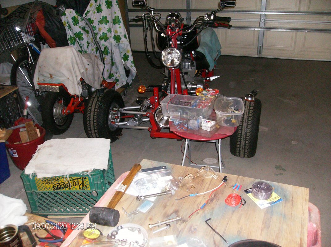

Floored chains OK.JPG-Chain Gard was the problem, Now back to the engine shift lever and the wiring, Oh! Fuel lines and FUEL... EDIT: Thank you fuzzman you are so right, I made the POOR quality video and it will not download here, MAYBE PINTEREST?(NOT) But it did work in FB under, Reverse Trike owners and builders...

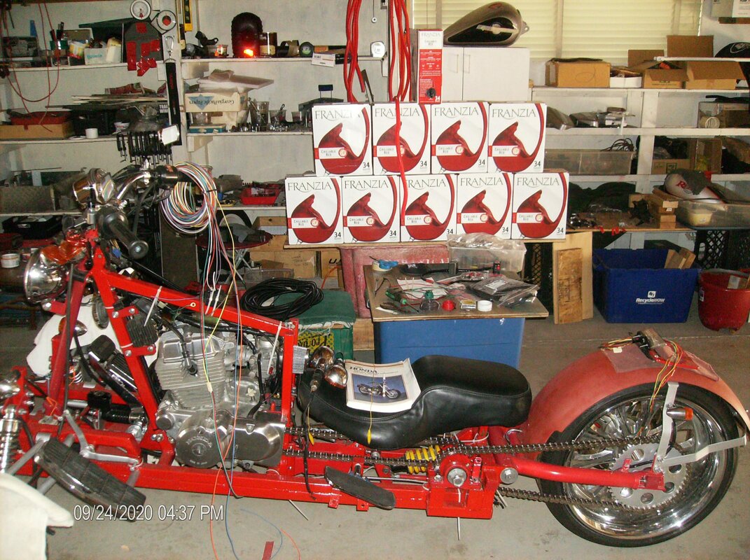

View attachment 91710Support group make things a little easier, one wire a day and early "HAPPY HOUR"? or is it, "One wire at a time"? :clapping:
Wiring is a big pain, take your time and get it right the first time. Are you making your own schematics as you go along for future reference?

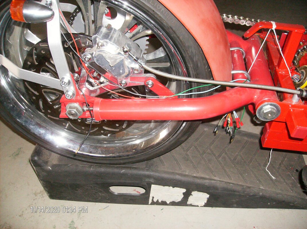

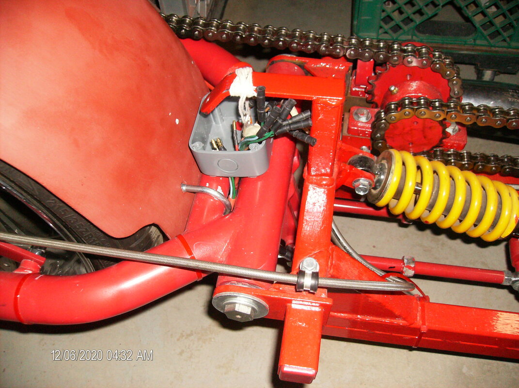

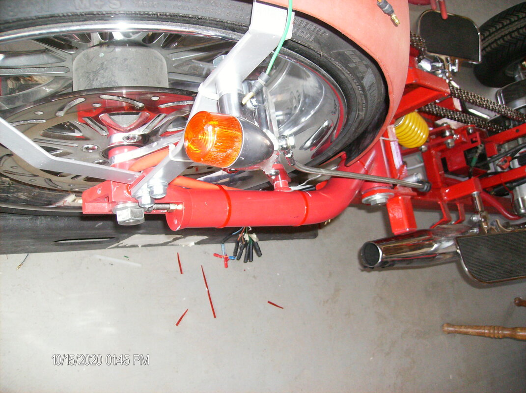

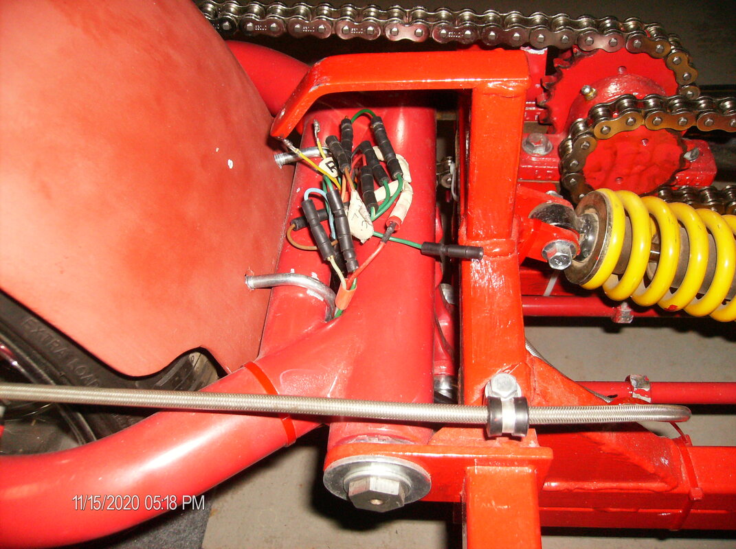

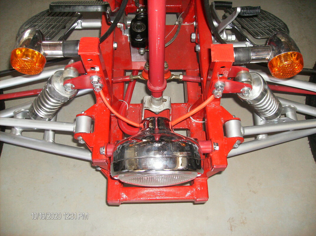

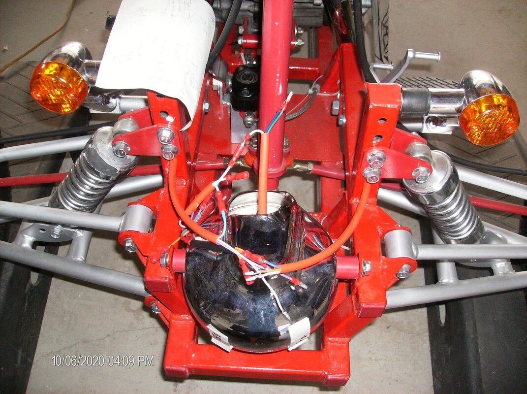

Hi Jack, :Dorag:, or is it High Jack, :xzqxz:, Thank you for stopping by, I have to extend the front and rear lights harness (diff colors) and the plugs go from one color to another according to the Honda book.
Wiring front lights

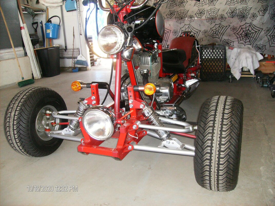

Front end wiring.jpg-HPIM4780.JPG-HPIM4781.jpg-Front wires are wired together and routed to the harness, but not connected yet, I will double check my ignition wires first and see if I can get it to turn over and start, :clapping: OMG! I'll need extra strength toilet paper (Charmin extra strong, boy that will clog you crapper for sure, :D) for this one because you gunna know I'll sheet my pants when it starts, video for sure...
Always super alert when putting power and fuel to a new creation....most times safety switches etc. not connected, so double check neutral on the tranny. Be ready to disconnect the battery and have a fire extinguisher handy....then time to light up! Good luck!

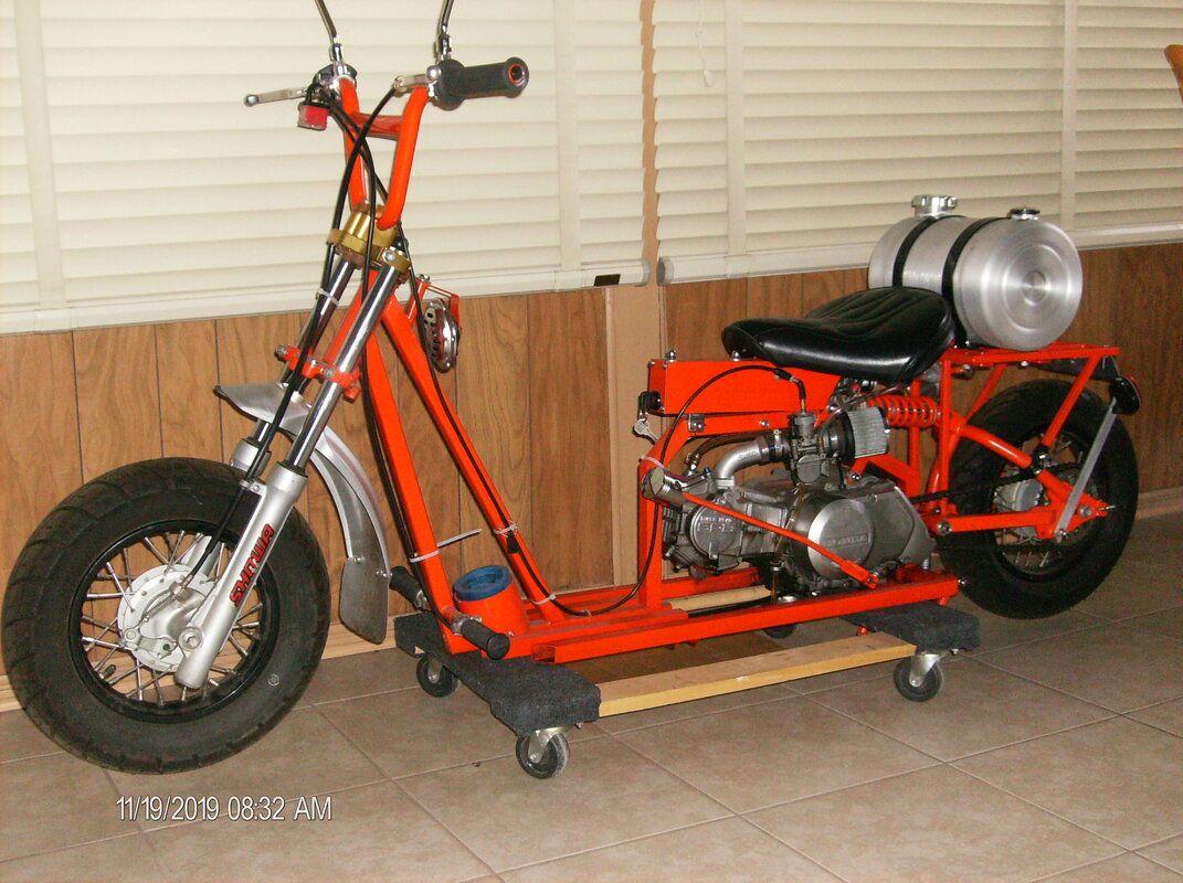

gScooter
1-gScooter Lside.JPGNeed to fix the fuel problem with this than sell, 50MPH, Motorized Scooter (platform)according to the DMV, legal. Back to the Trike wiring...

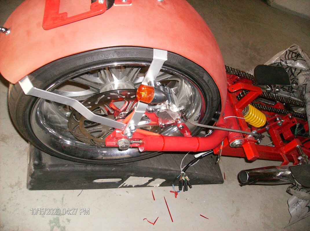

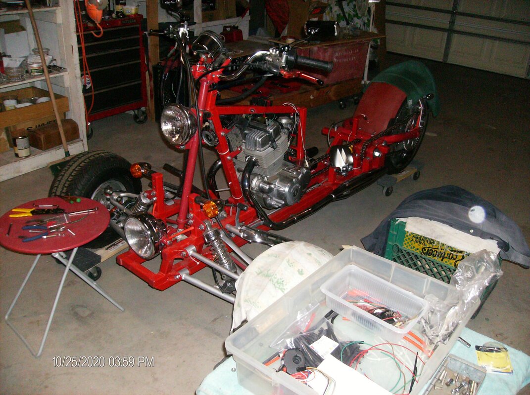

One thing this Trike wiring has taught me is IF you are not in the mood, do something else because you'll F-up...Wiring Nest.JPG-Running lights.JPG Rear running lights and foot brake light all dialed in, :clapping: Please remember this building a reverse trike from scratch is all new to me so bare with me when I enjoy simple pleasures, AND wow I made it work!!! That's NOT what I tell my wife, speaking of her she would not drive the eScooter to speed again 25mph, she just wants a one speed bicycle and she's happy! SOOOOO! I ordered a 24" Tricycle 7 speed (she will not shift it" and soon a eBike kit for 48V 20Ah 1K Watts li ion Batts, I'll be hoping to put it together and sell to the local senior citizens, I know we can all use a little extra income...

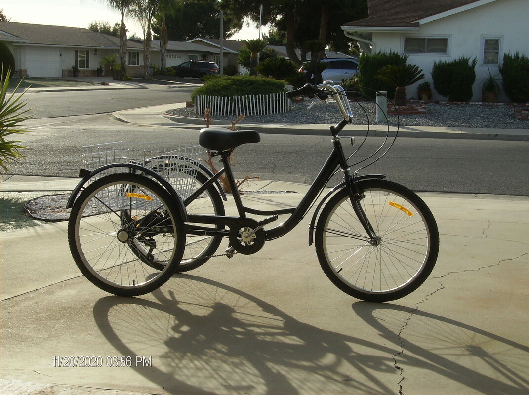

Tricycle.JPGStill waiting for wiring parts for the RT so here's another side job for the wife.-[FONT=&quot]Here's the foundation for the 24" eTricycle. eBay and it comes 75% assembled, I think the hardest part was the Shimano 7 speed detailer and the chain, they did supply the chain breaker (aka installer) AND Don't ever forget the pedals are left and right hand threads. So we will be test riding it to make sure nothing goes wrong then order the front wheel eBike kit and the battery's. 1K Watt motor, 48 Volts, 20Ah Lithium Ion batteries, Ohhh Yeaaa!!! [/FONT]:clapping:
