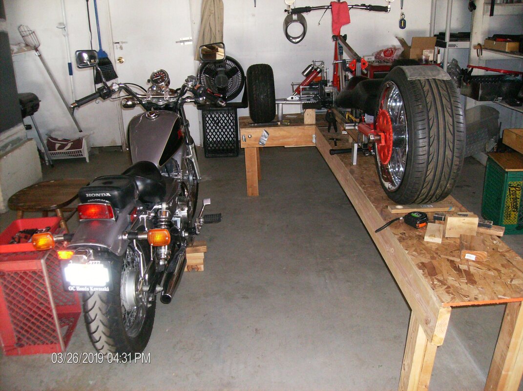

Three long plank's will work for ramps, or most motorheads have ramps or friends with them. You have the brain to figure it out so all rolls back off the table and out the garage door. It would be awesome to get some ride time on a race track with that beast, just to push the limits with out worrying about other drivers.
FuzzMan I am so aware of this and I need room for the car and this way I can put the bike on the right side along the shelves. Now I will be working on the upper frame rails (upper control arms) and seat, steering and gas tank areas, I cannot do welding here yet so it will have to be broke down and moved with my car (no truck or trailer) I am working on that also. Don't you just love many little serious problems, :xzqxz:
RebelRouser

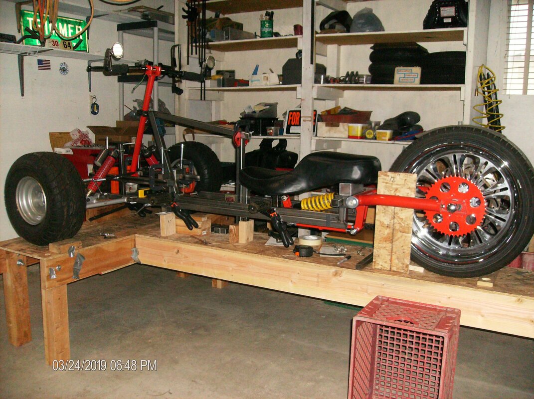

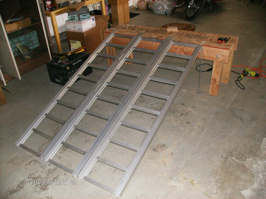

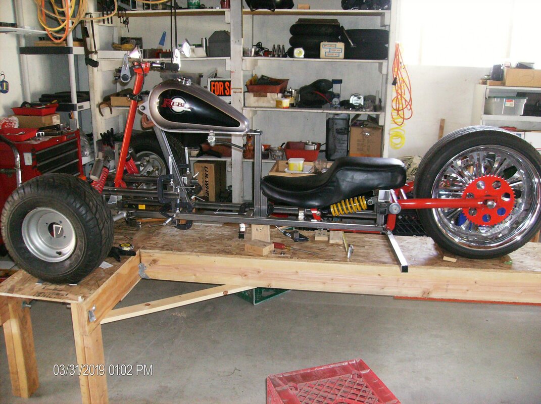

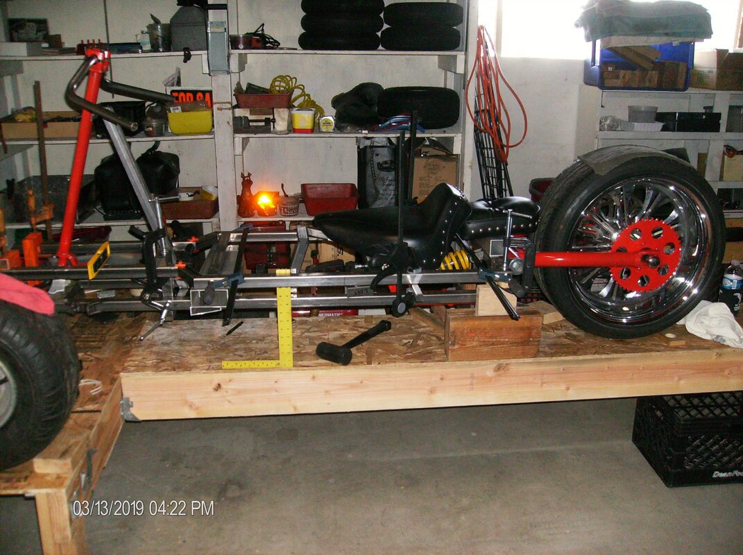

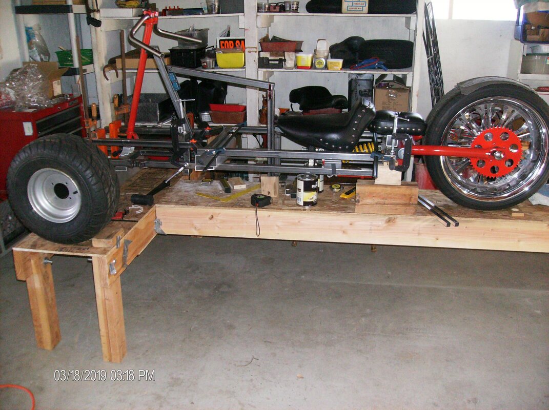

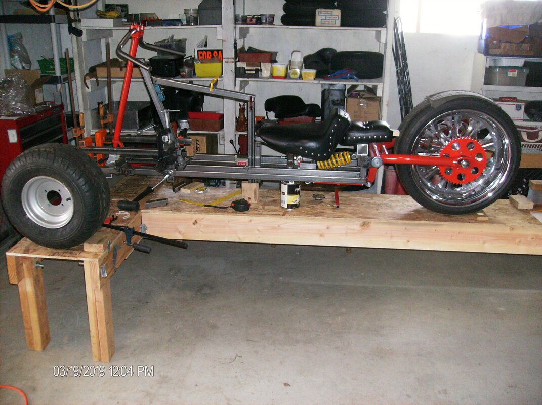

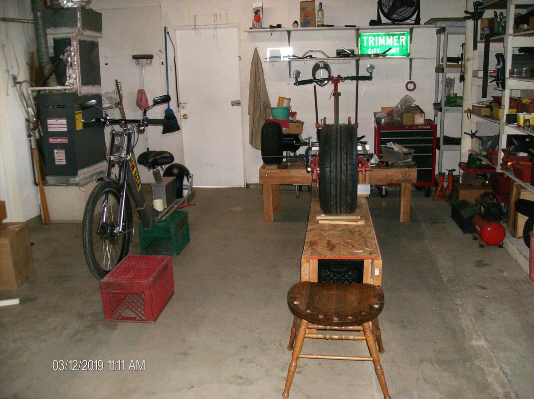

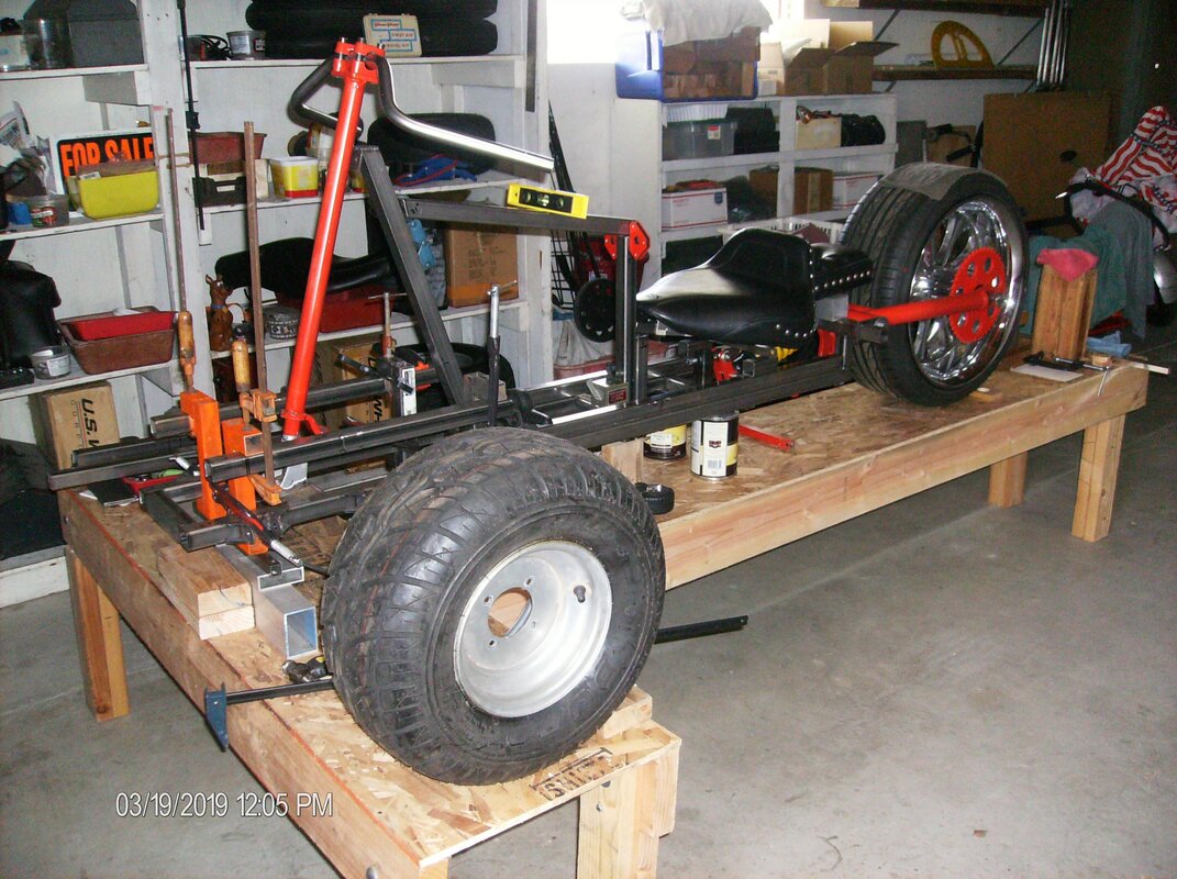

HPIM3316.jpgThis is the ramp I will be using to get the RT off the table when it is closer to finish and yes I know the table will be turned around later, I hope it's wide enough... :clapping:
RebelRouser

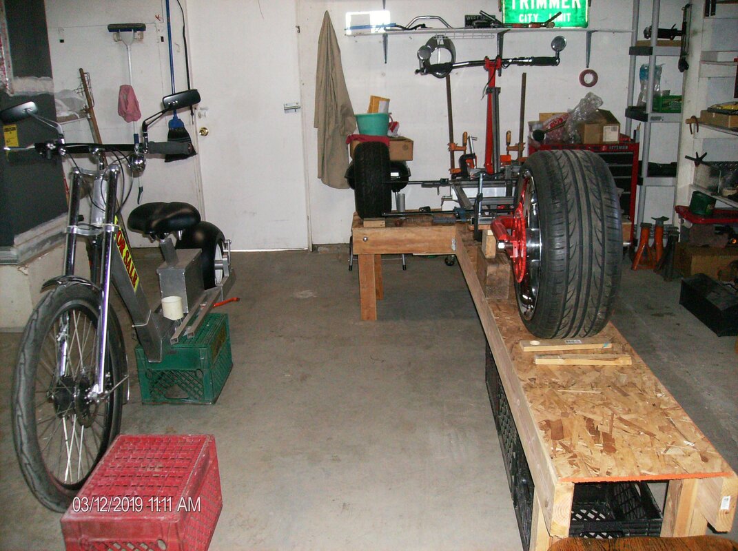

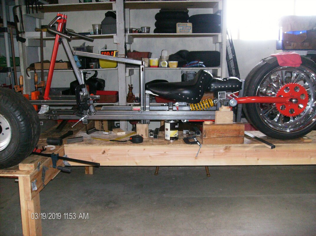

OK guy's does this tell you one of the ways to roll the RT off the table? One of the best pieces of advice from my father was, "Where there's a will, There's a way"...Just take the front wheels off and YES I have 2 of them...

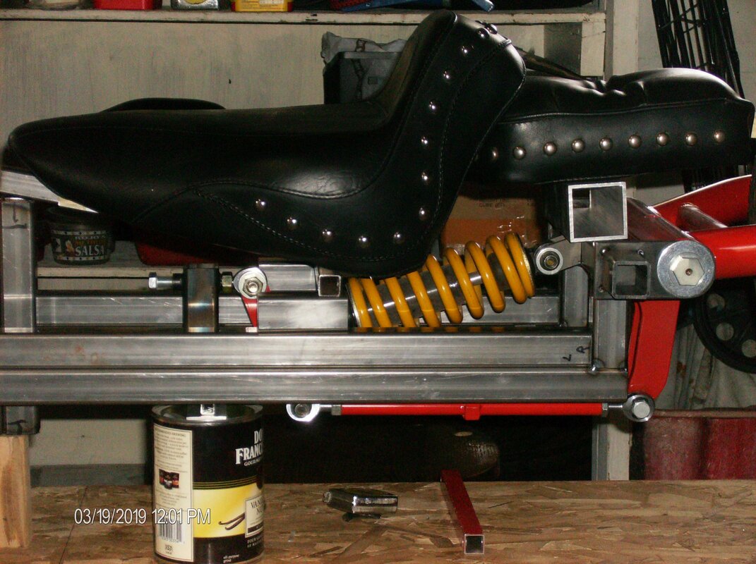

my wheels center line is 12.5 inchs of the ground and the seat is 1.5 to 2 inch's above that, so me the rider should be sitting at 13.5 to 14 inch's off the ground and a inch or two above wheel center line. Ed Roth designed trike. Interesting

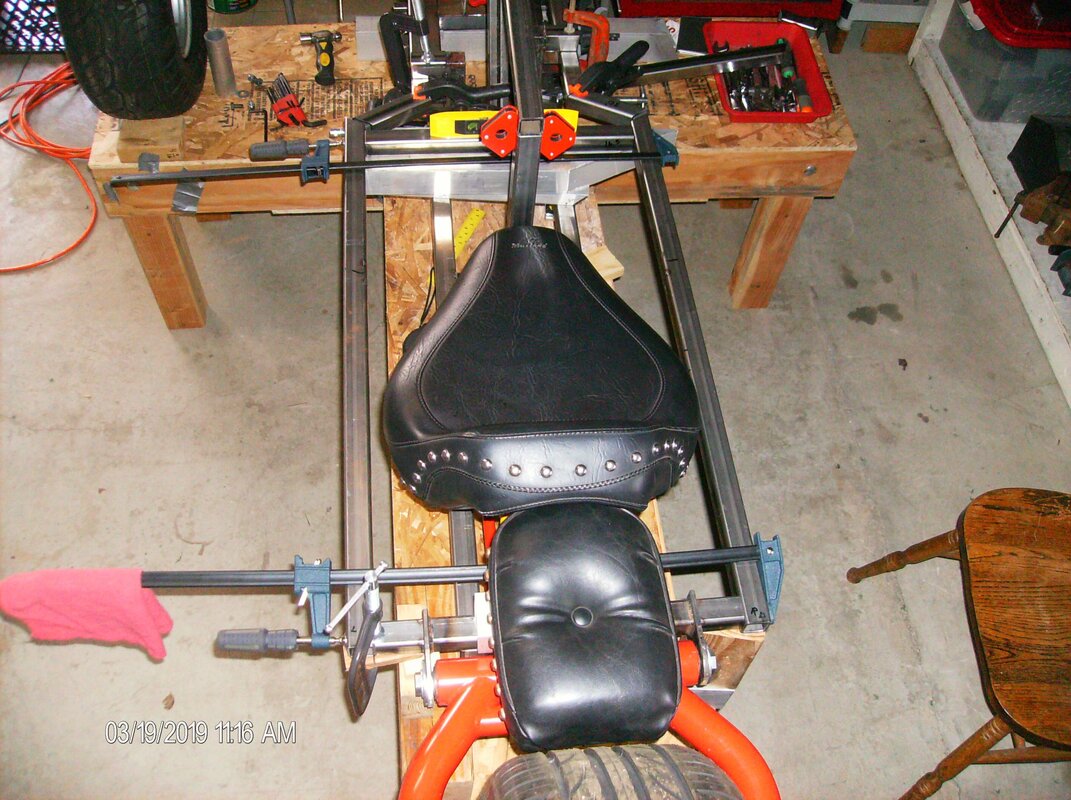

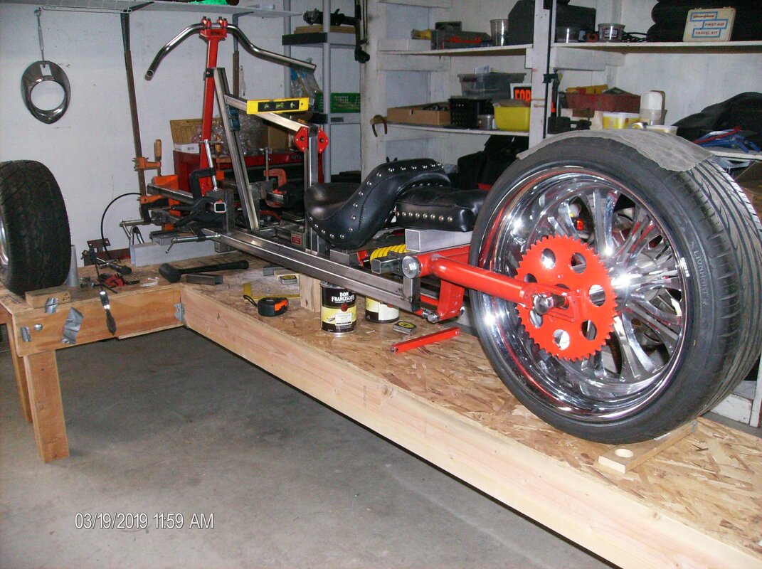

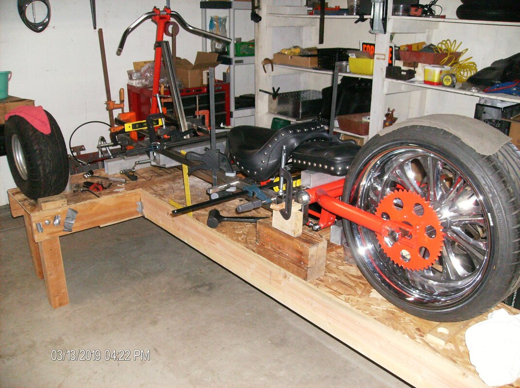

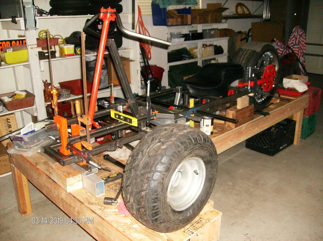

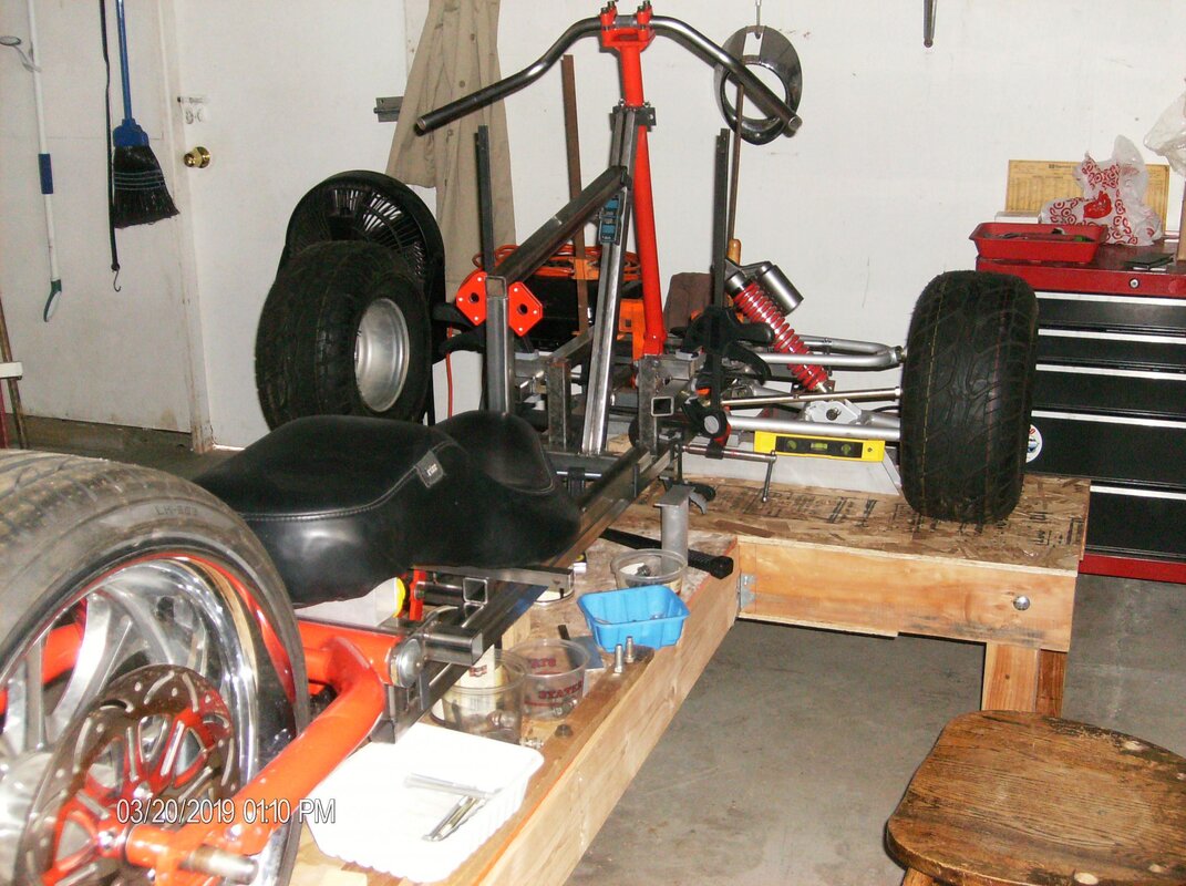

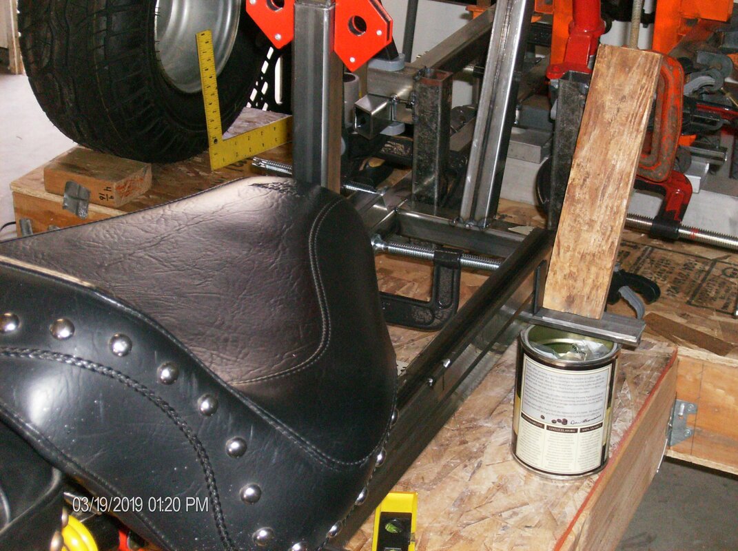

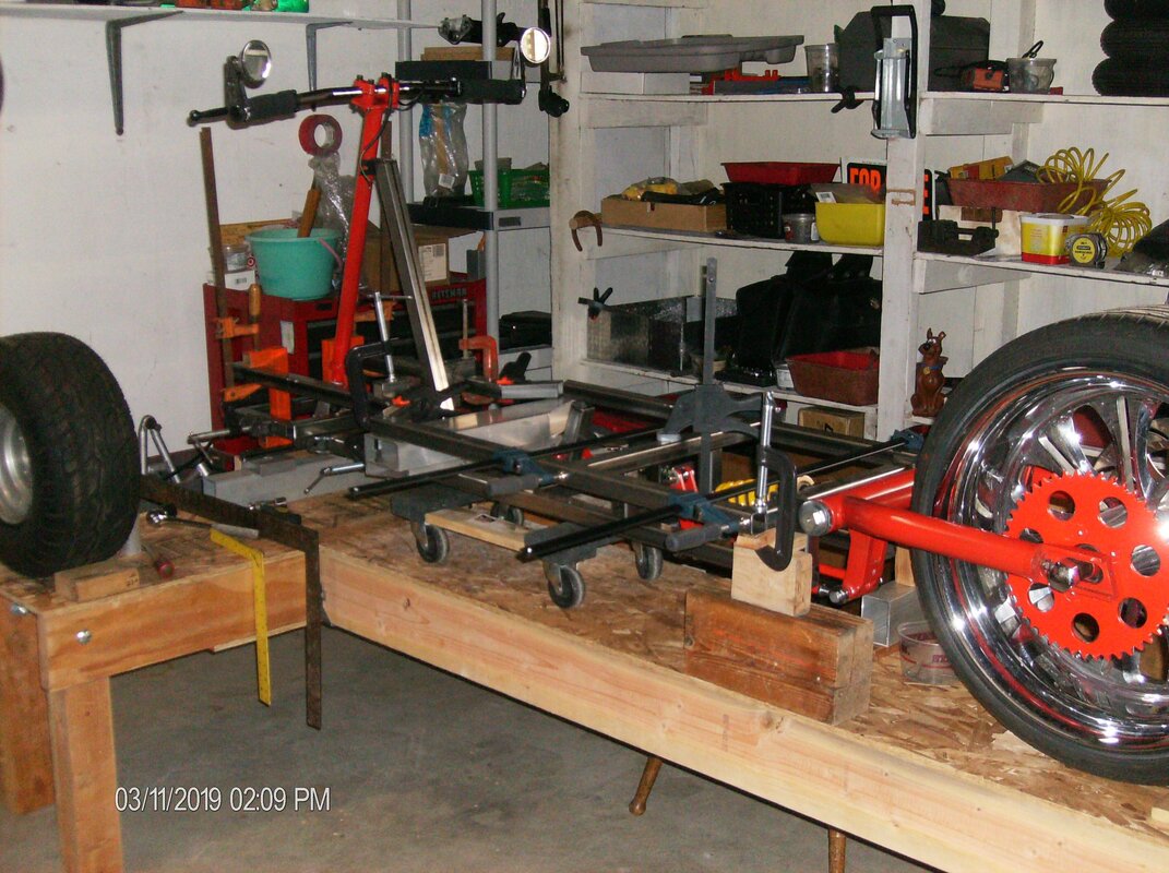

I am not happy with the upper frame rails being 19" wide and the seat less? floor boards? But the engine is 16.5" wide? SOOOOO!!! I think it's time to set the engine and do a work around after the front control arm upper rails are finished, I should take a upper photo of seat and rails. Mocked up the gas tank brace and tie end for the rear engine mount and seat...
RebelRouser

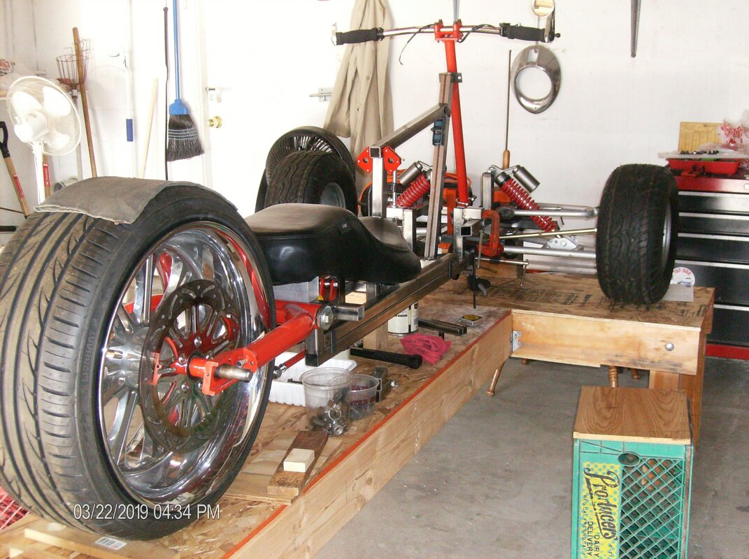

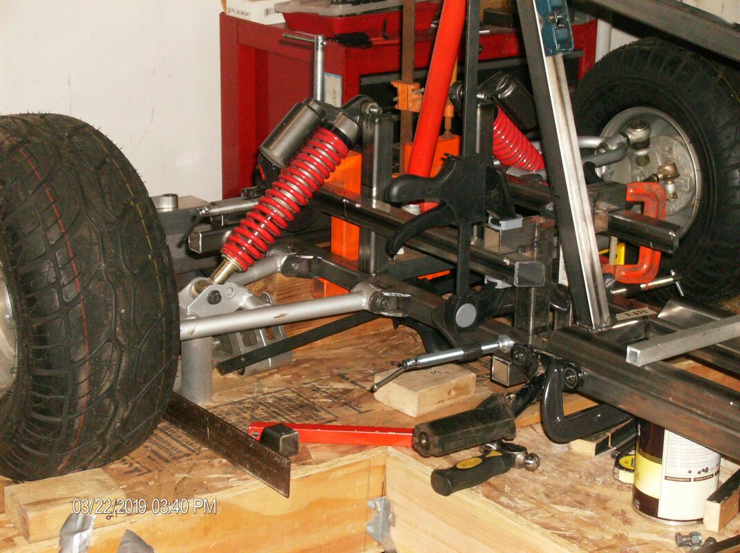

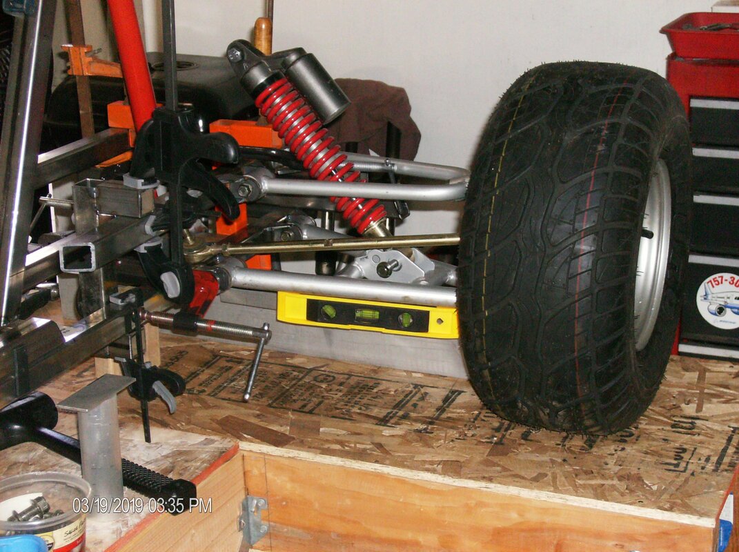

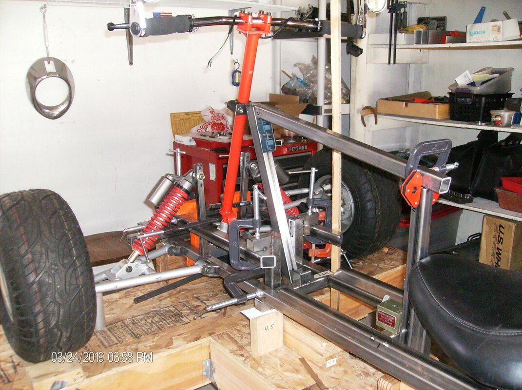

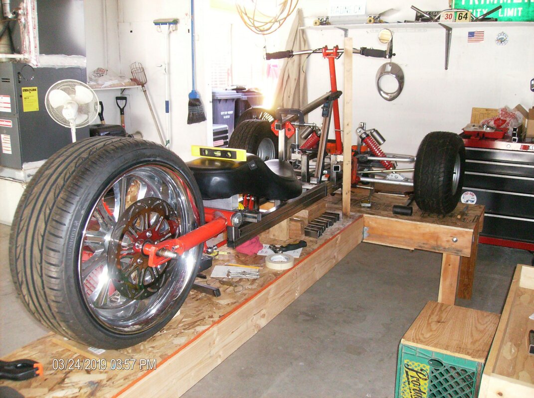

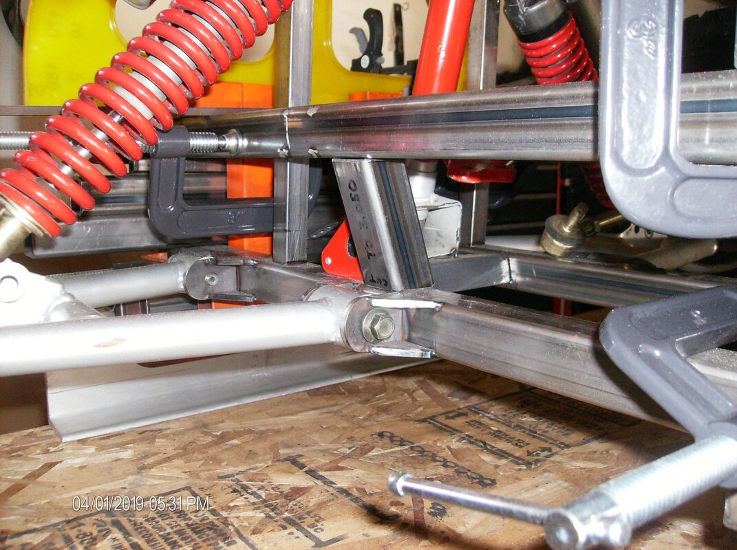

HPIM3352.jpgHPIM3354.jpg Wife likes this seat better (wider) Lowered the ride height .5 to see the change in toe in-out and brackets for the front coil overs, I need them to be adjustable, the shocks are not, so maybe inboard?
if the brace has to stay because of the engine, well why not bring back the steering bracket back on angle with the handle bar design ?I thought it looked upright to much to me, but I have not designed such a project, so I just watch and learn as I can. I could be wrong, but should we finish out the enegine and all that in the mock up so you can see it all, than look at the handle bar design. Your game, just a fan in the stands, LOL.

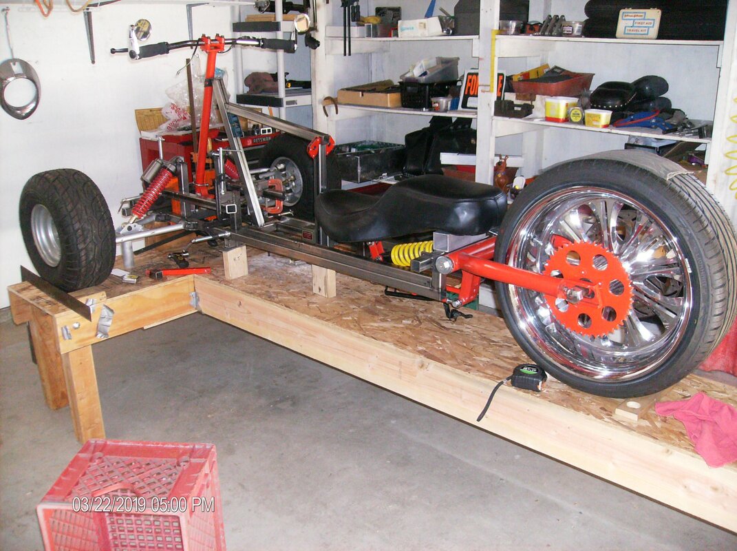

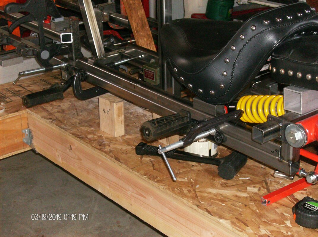

HPIM3365.JPGHPIM3369.jpgHPIM3368.jpgHPIM3370.jpgAdjustable shock mounts and lowered the steering mount to meet the gas tank cross brace, will tilt it back later for G.T. height...
2nd what Andy said, but I see now that you will tilt the bars back.....am I seeing foot pegs on the side shown? first glance I thought feet would be ahead of the shocks...lol that tank will give a nice touch! good progress.

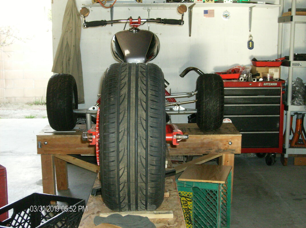

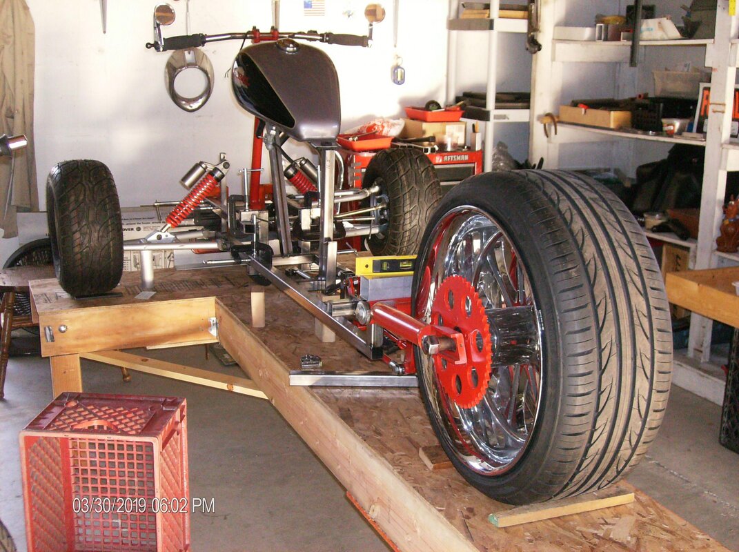

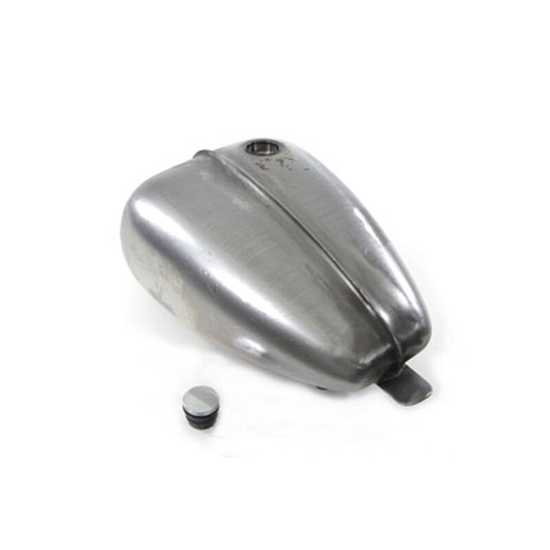

HPIM3391.jpgLowered the tank 1" to clear the handlebars in turns, but still in mock up and fitment seems to be working ok, I have the doner bike for measurements...HPIM3397.JPGHPIM3396.jpg Tomorrow I will on the uprights for the control arms, 20 degrees. Nice azz huh?

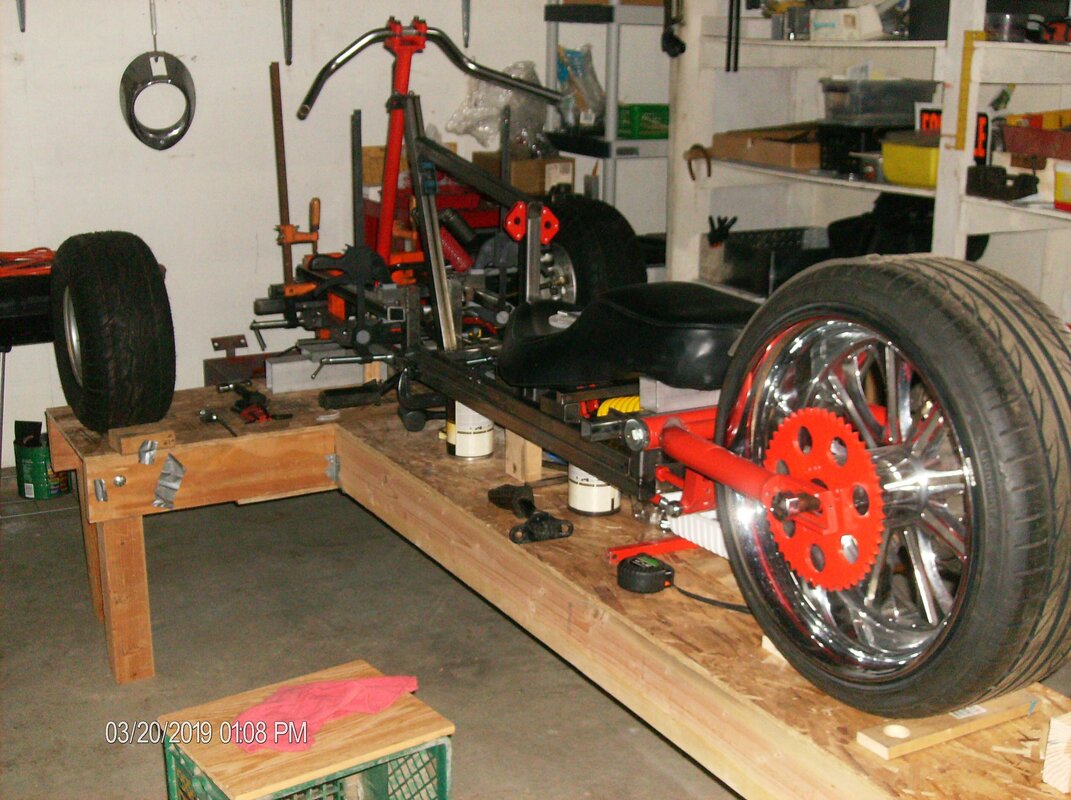

HPIM3402.JPGHPIM3404.jpgI think the angle will look better and hold control arm dimensions, Then I started playing with a possible nose piece? HPIM3401.jpg I still like this one? 1-RT Nose front 24hx30Lx12+w.jpgMaybe I'll try some cardboard patterns???
