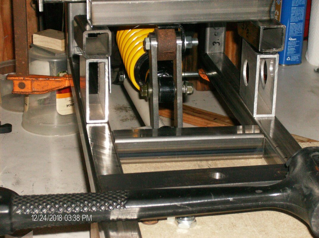

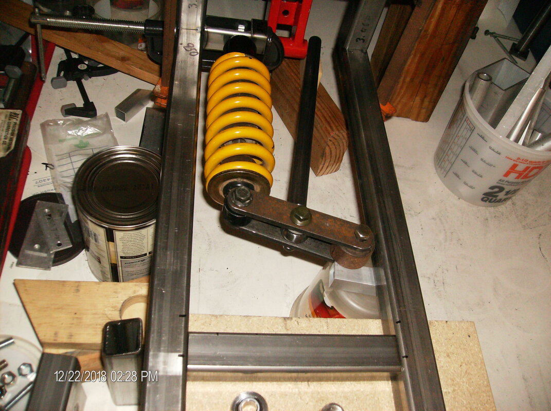

couple of considerations you may have already thought of.....make sure spring has side clearance to frame side....it will have a sideways rocking motion......maybe have spring cross member adjustable to fine tune ride height? or maybe your rear heim jointed link does that already?
RebelRouser

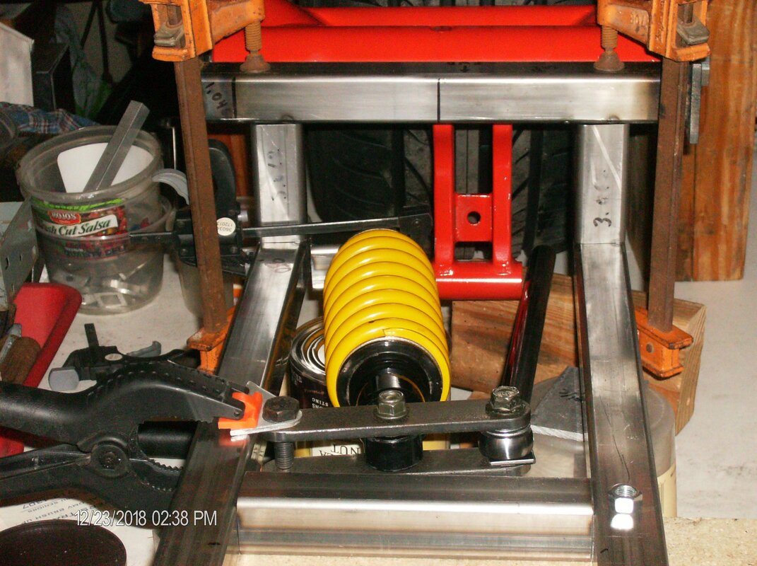

HPIM4127.JPGThis is going to take some time and maybe a rocker type end on the shock top for more clearance?
RebelRouser

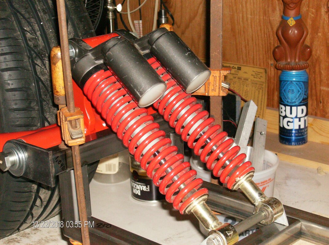

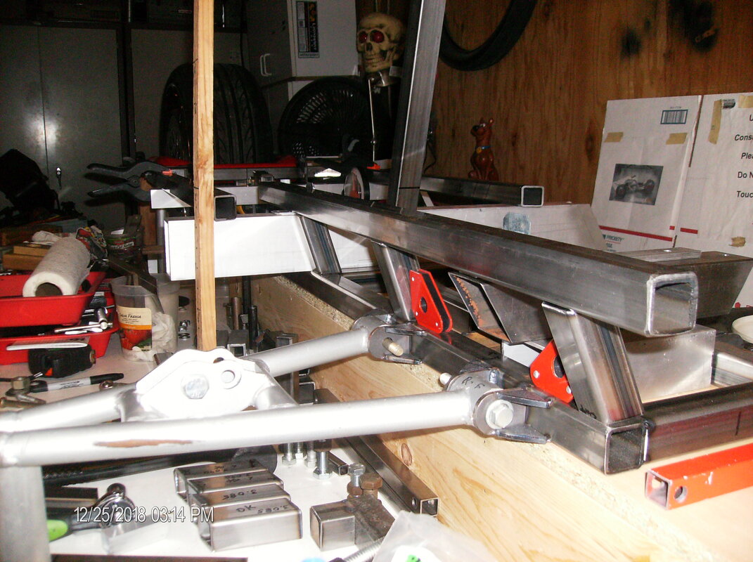

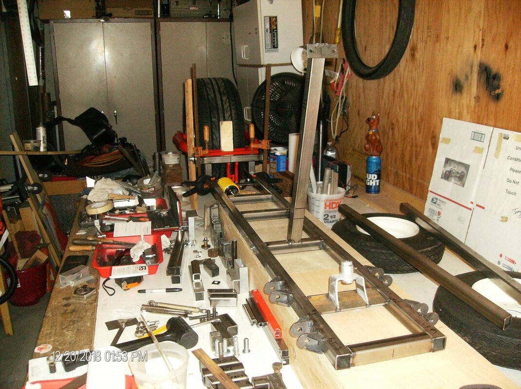

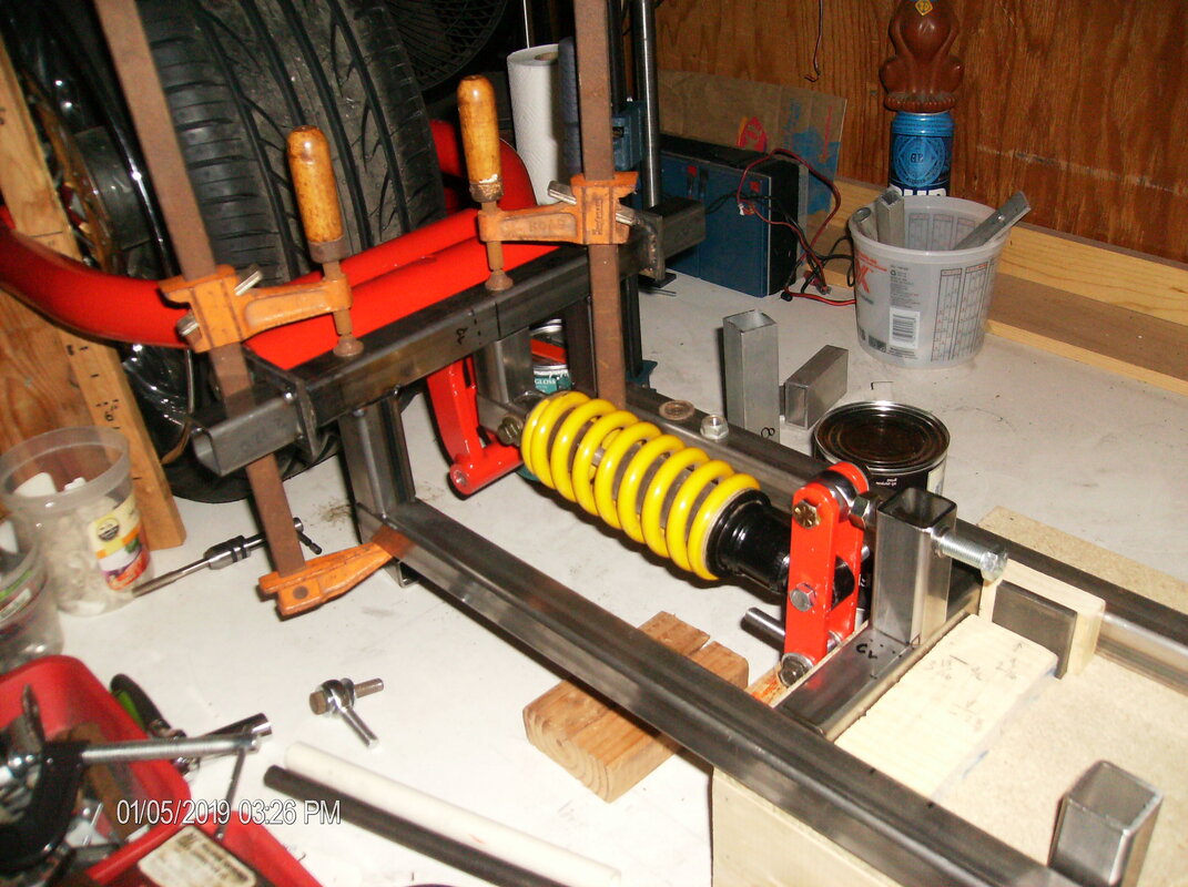

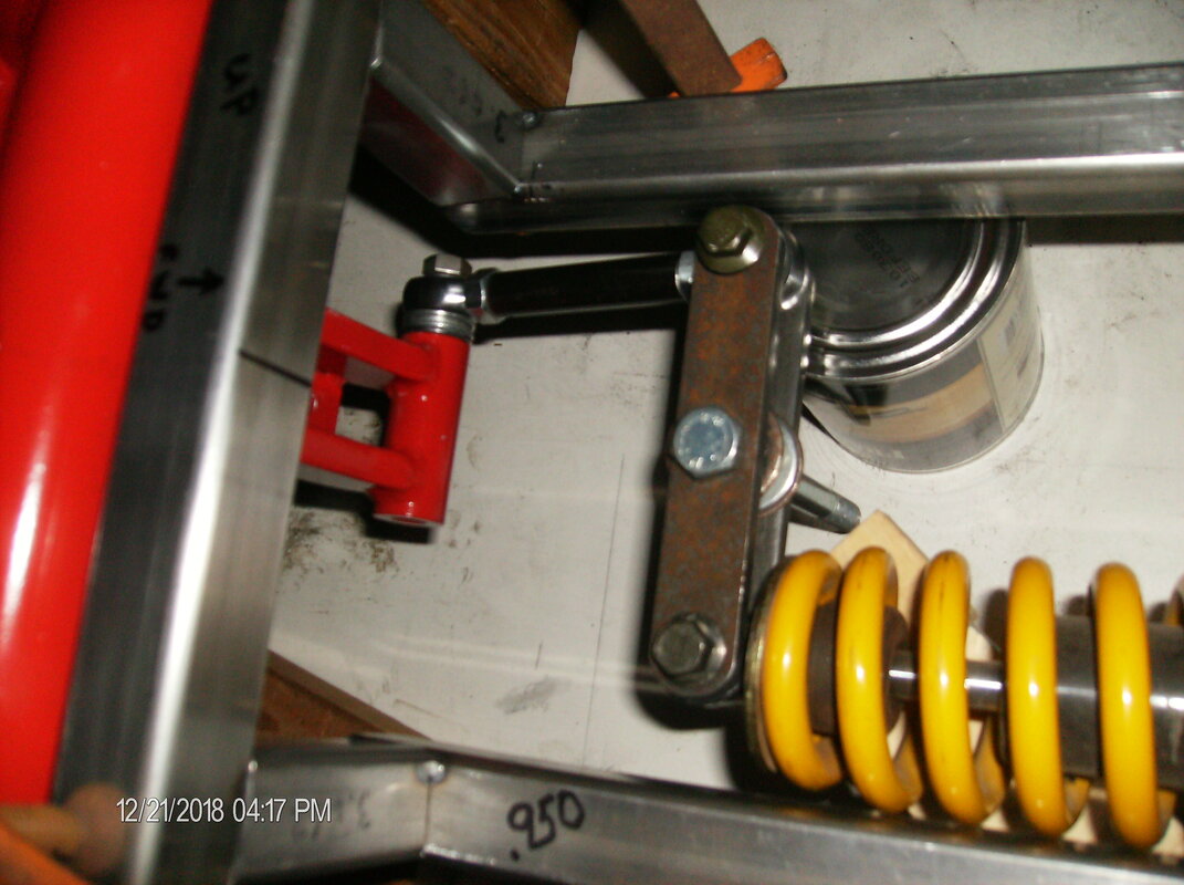

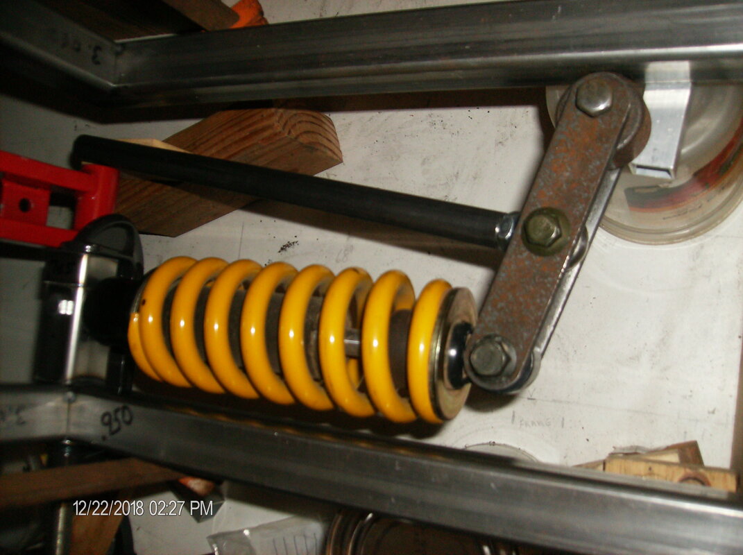

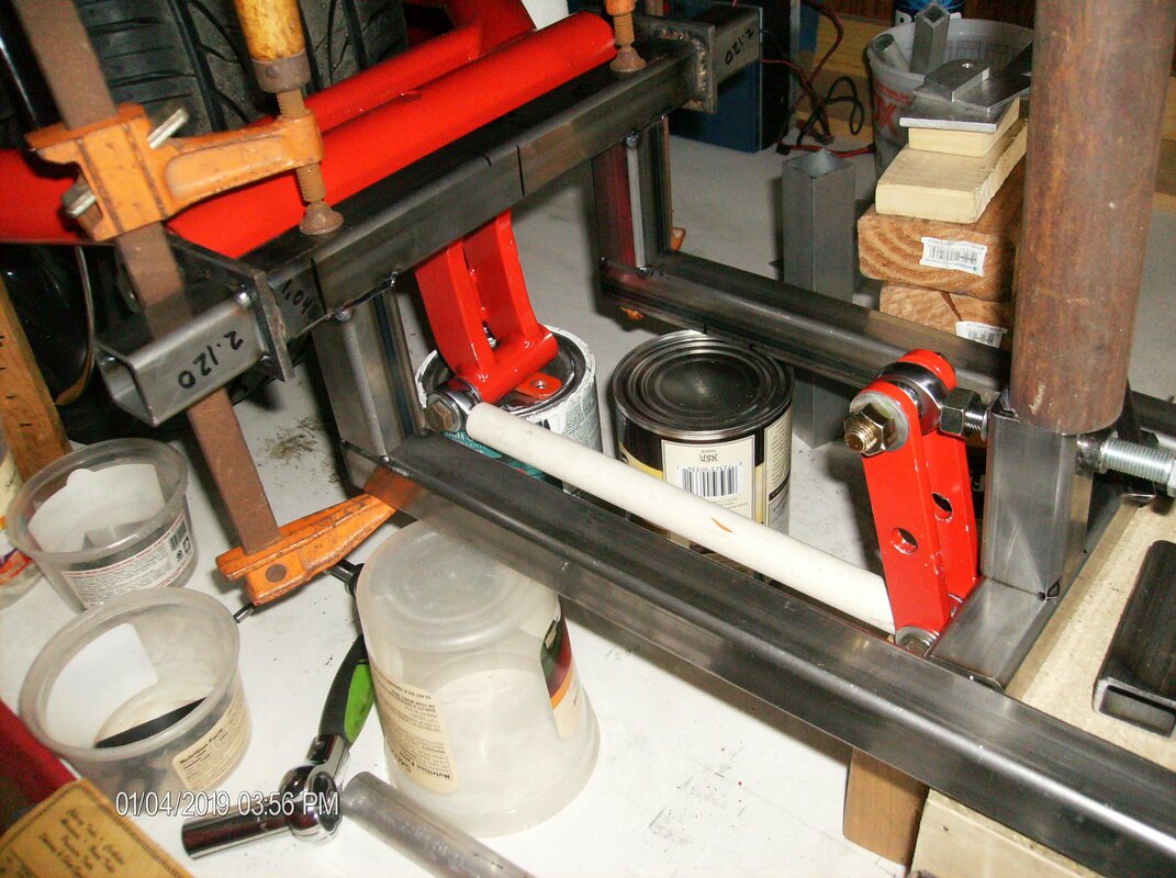

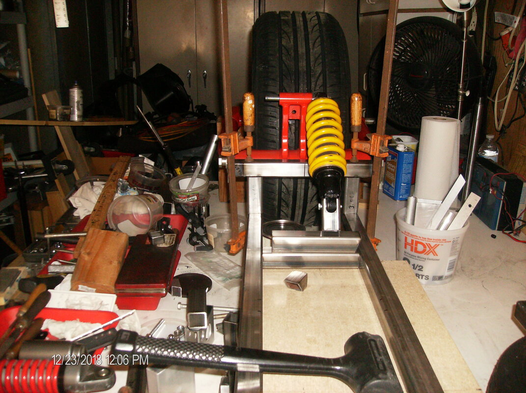

More mock up, Things to do this week...HPIM4128.JPGHPIM4129.JPGHPIM4133.jpgHPIM4135.jpgMaybe I should install the upper rails then the coil overs?

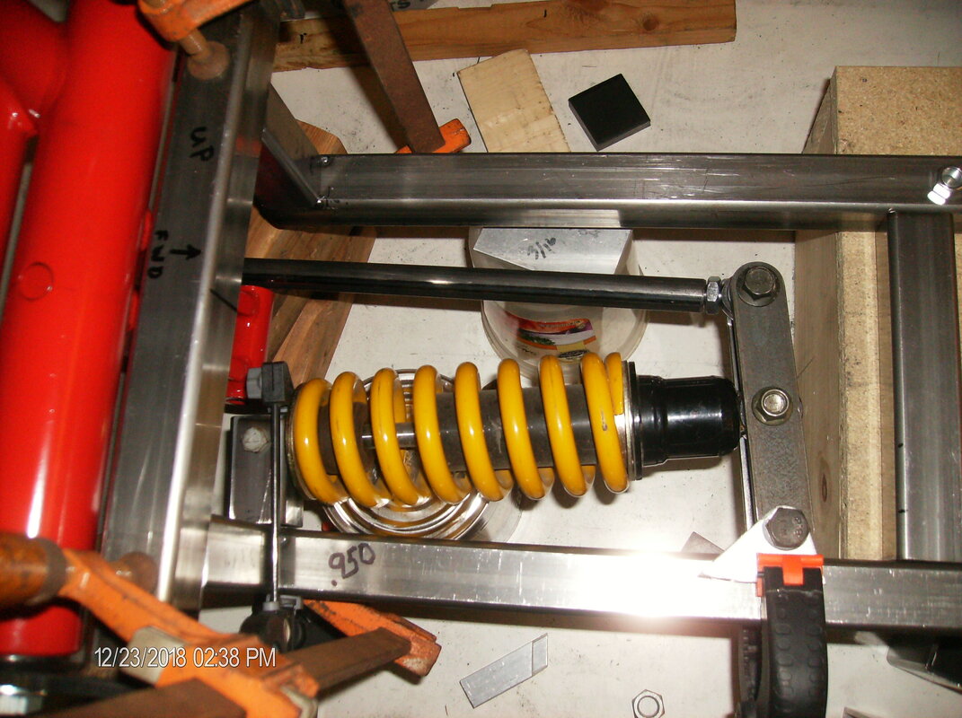

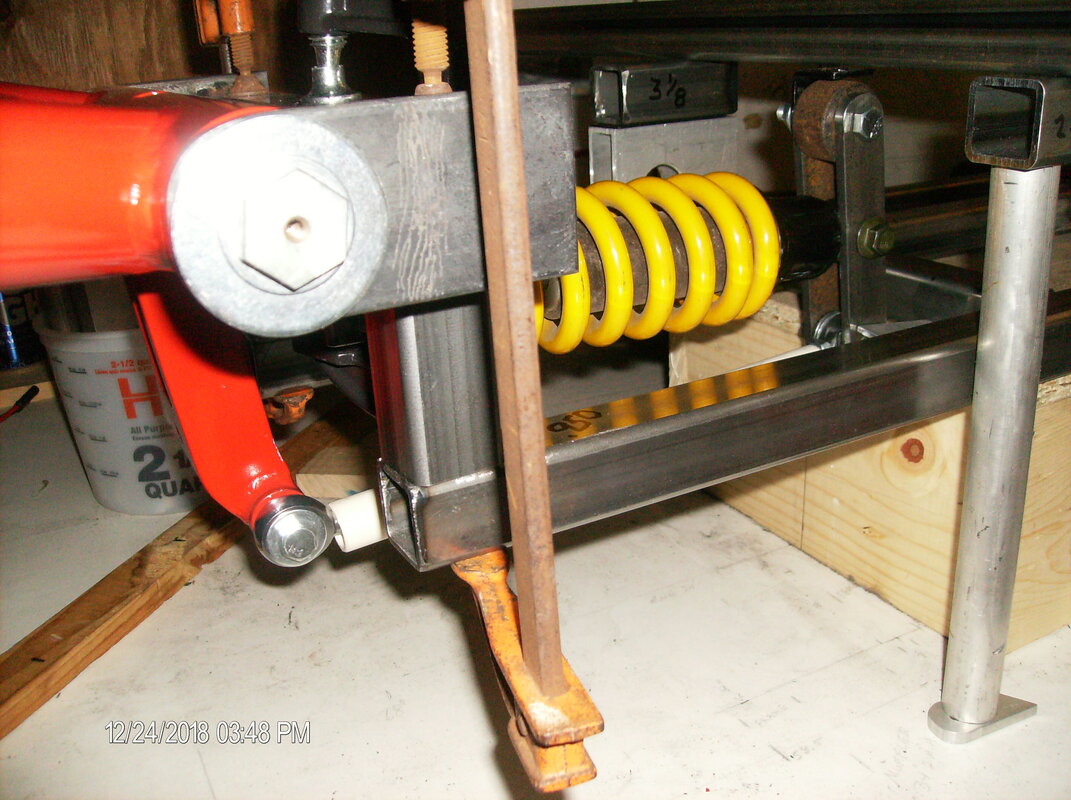

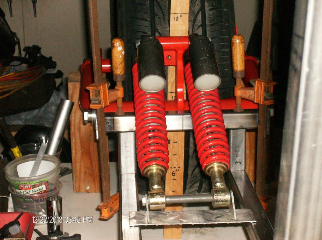

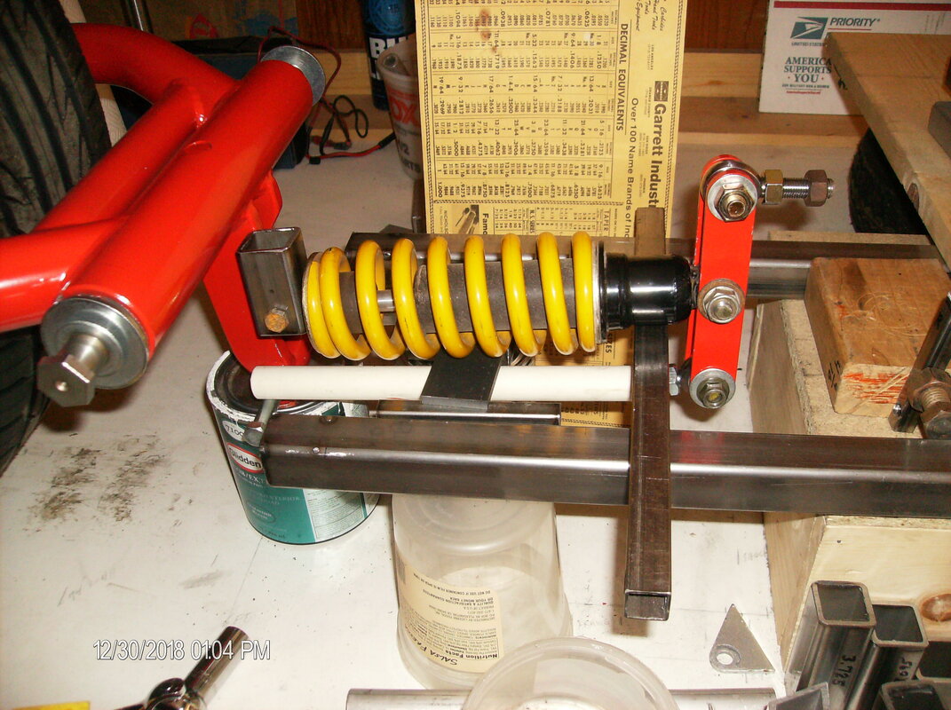

HPIM4139.JPGHPIM4138.JPGThis one is simple and much weight and height.HPIM4143.JPGHPIM4142.jpg This is lower and compact to the rear and the weight of the shock is also supported close to the frame, I think I will go with this one? Please feel free for input...

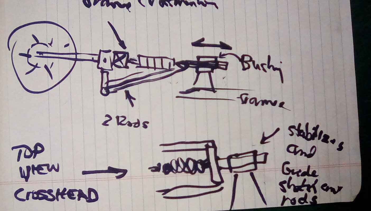

do agree w/staceyb about linkage ratios, thinking, for the long swingarm lever the 2 red coil overs looked as they had travel that matched the lever......another disadvantage with the rocker arm setup is 5 pivot points vs 2 with the red shocks.....true, will have higher cg and space taken up that may be needed by some other component. one idea... swing arm turned over with red lever pointed down..... yellow shock fastened to center of swing arm crossmember, shock angled forward and down......link rods fastened to red lever ( that is now hanging down) link rods travel forward and up to meet a pin that ties link rods to both sides of shock, a guiding tube or mechanism would control the tie bar, some what like a crosshead on a steam engine, as the shock pushing forward pulls the link rods forward,which pulls the red lever forward which pushes the rear wheel down, thus suspending the frame....:confused: LOL hoping this makes some sense?
...You just gave me a headache...
TommyJ......lol....I had a headache when I wrote that post, it got worse later!......very unconventional to say the least. but basically an >- with the shock on upper part of the > The strut rods on the bottom pulling the swing arm lever forward, and the - a stabilizing guide to keep the junction of the shock and rods from moving up/down or left and right, but only forward or backward. there would losses because of the angle of the shock to the rods, the guide mechanism would have side forces also......all things considered, this idea should perhaps be headed to the trash bin! :xzqxz::xzqxz:
PS I have not seen this idea used before, probably with good reason!
TommyJ......lol....I had a headache when I wrote that post, it got worse later!......very unconventional to say the least. but basically an >- with the shock on upper part of the > The strut rods on the bottom pulling the swing arm lever forward, and the - a stabilizing guide to keep the junction of the shock and rods from moving up/down or left and right, but only forward or backward. there would losses because of the angle of the shock to the rods, the guide mechanism would have side forces also......all things considered, this idea should perhaps be headed to the trash bin! :xzqxz::xzqxz: PS I have not seen this idea used before, probably with good reason!
I will be having another glass of wine or two, or as my wife says< Is it wineing time again...

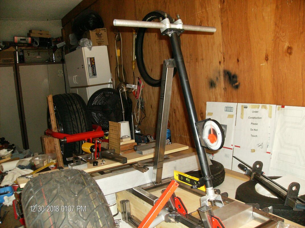

1-Merry TrikeN Christmas.jpgOK, OK, Ok... One more mock up, then the upper frame rails and upper control arm brackets, then mock again with steering, And will be on the ground at this point. Dec 30 is motorcycle swap meet, I'll be looking for twin shock and jack shaft sprockets, 3.5" and Harley 530 chain and Honda 520 chain AND...
To all of you my friends Thank You and Happy New Year... With all our trikes running in 2019
View attachment 65512OK, OK, Ok... One more mock up, then the upper frame rails and upper control arm brackets, then mock again with steering, And will be on the ground at this point. Dec 30 is motorcycle swap meet, I'll be looking for twin shock and jack shaft sprockets, 3.5" and Harley 530 chain and Honda 520 chain AND...

And the winning design is and the support will line up with the upper frame rails...:Santa:

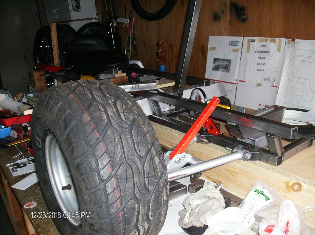

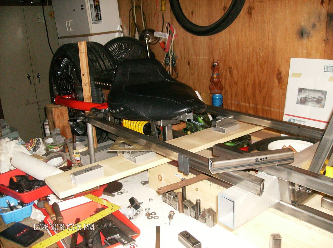

HPIM4166.JPGHPIM4165.JPGHPIM4160.jpg Upper rails will be next with upper control arm brackets and vertical 18 degree bracing...

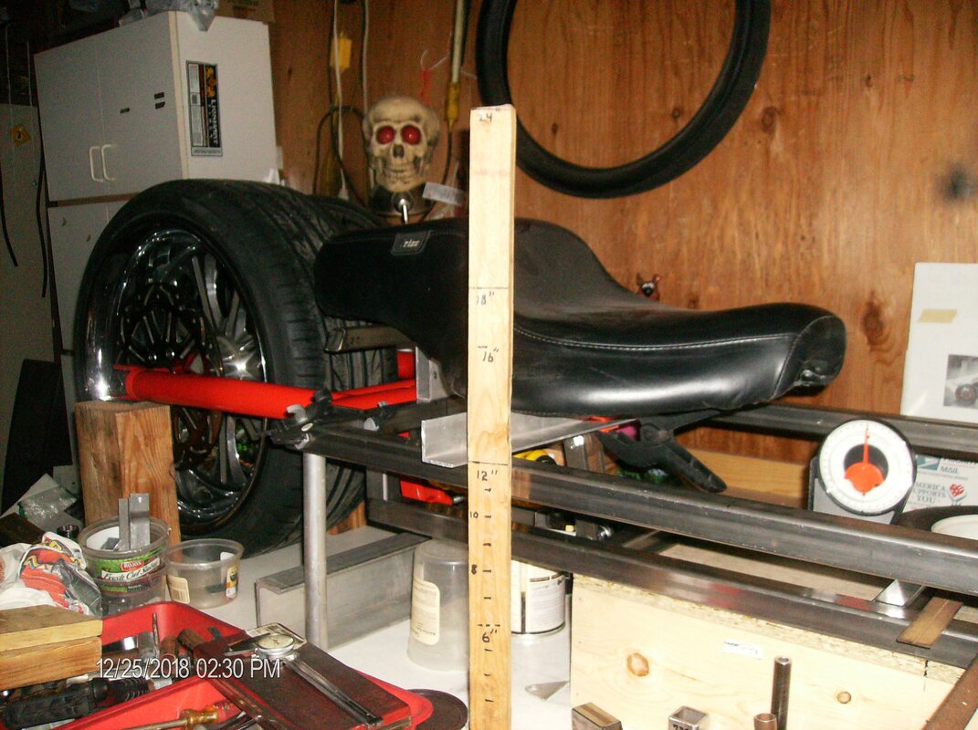

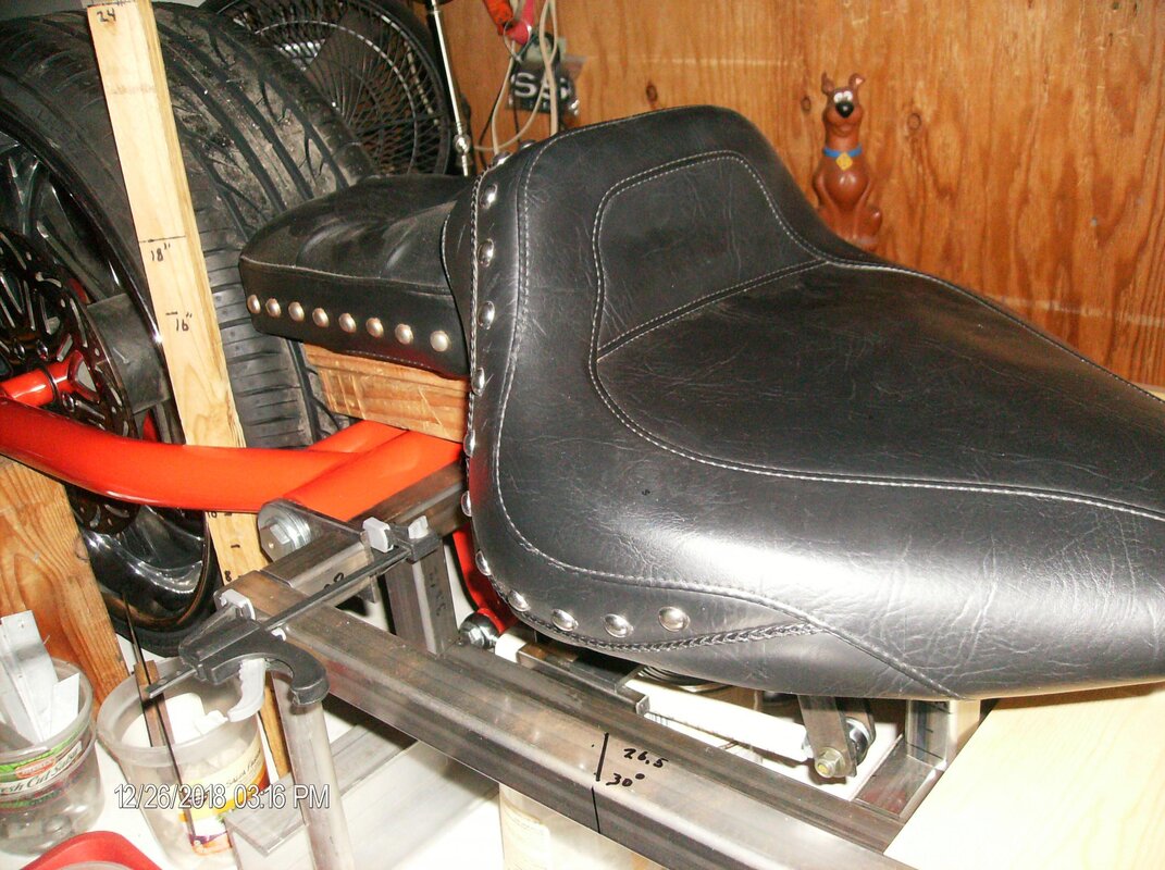

With seat? Maybe to low?
All motorcycles are invisible! Fact of life.
If you are sitting too low and riding to the right of a cage (especially soccer mom minivan/SUV), most of you will be below the window line and therefore even MORE INVISIBLE!! :xzqxz:
Just something to consider.

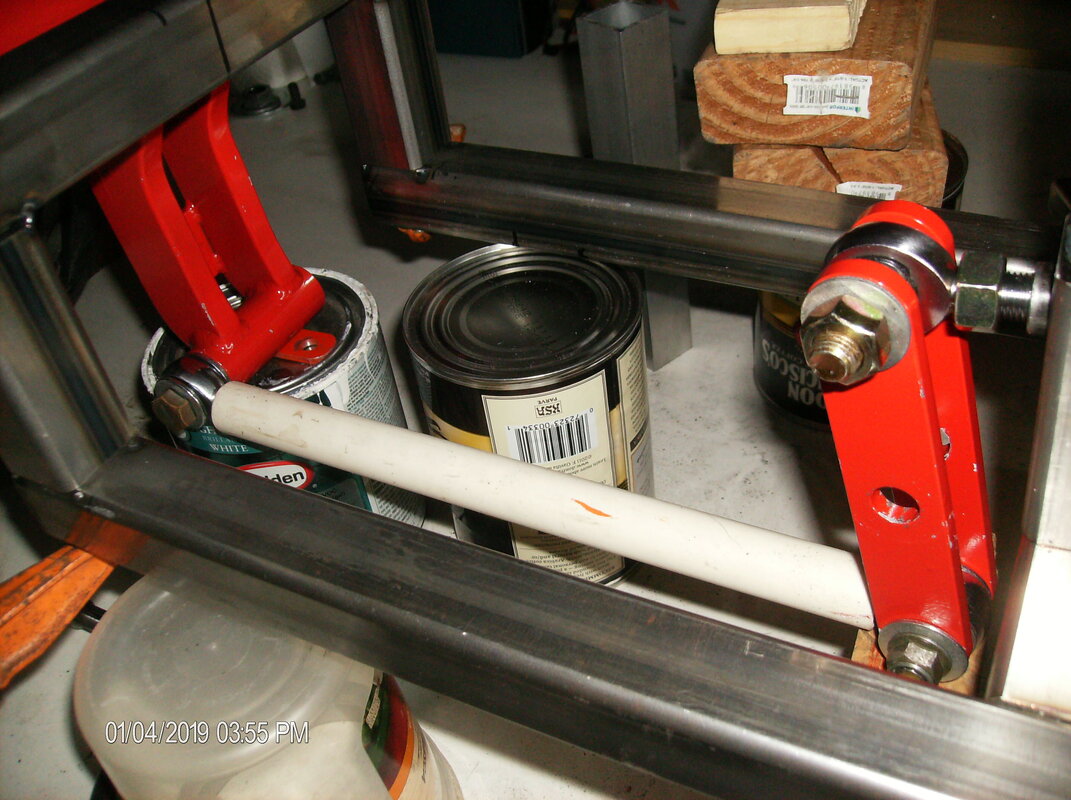

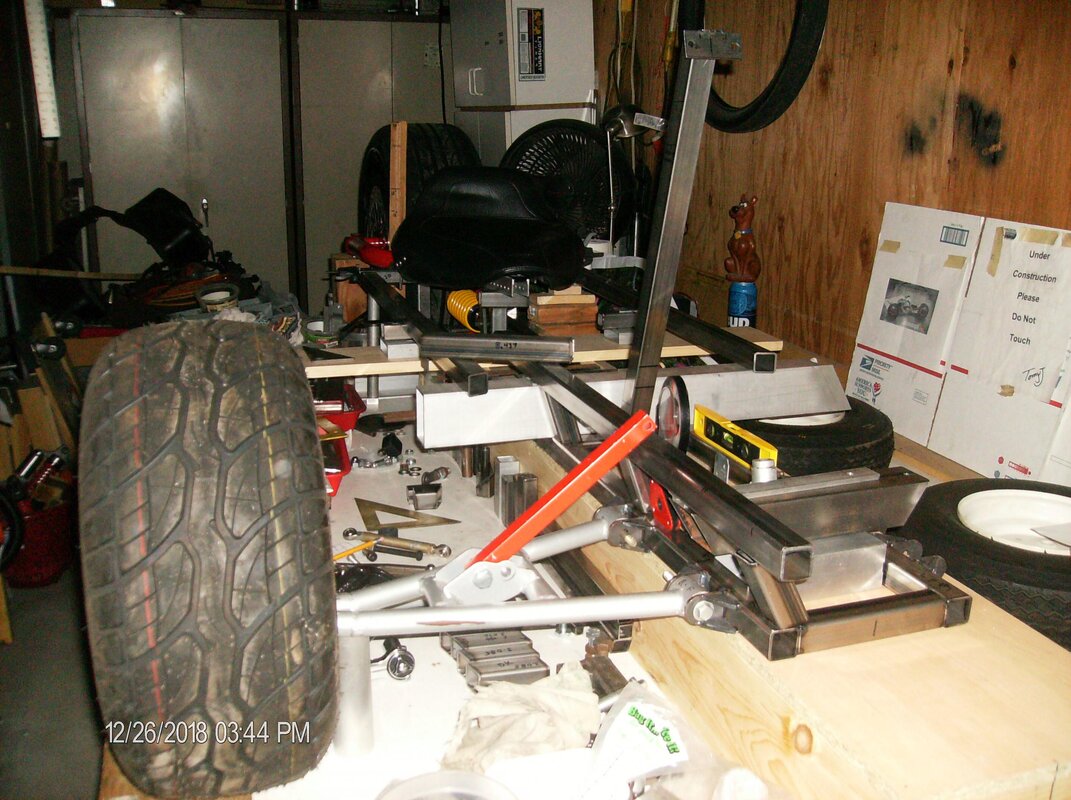

This is the way to go for my build, coil over and pull rod is just off center to the right and the swing arm brace left side will play host to the jack shaft mount, again guys this is still in mock up with all tack welding. Now notice the upper shock mount it was going to thick steel and brass bushing, Butt I decided a extra heim joint should do the job??? What do you guys think???
I think a heim would work! top rocker arm bracket will need to be strong, it will carry almost all of shock load if I am not mistaken.

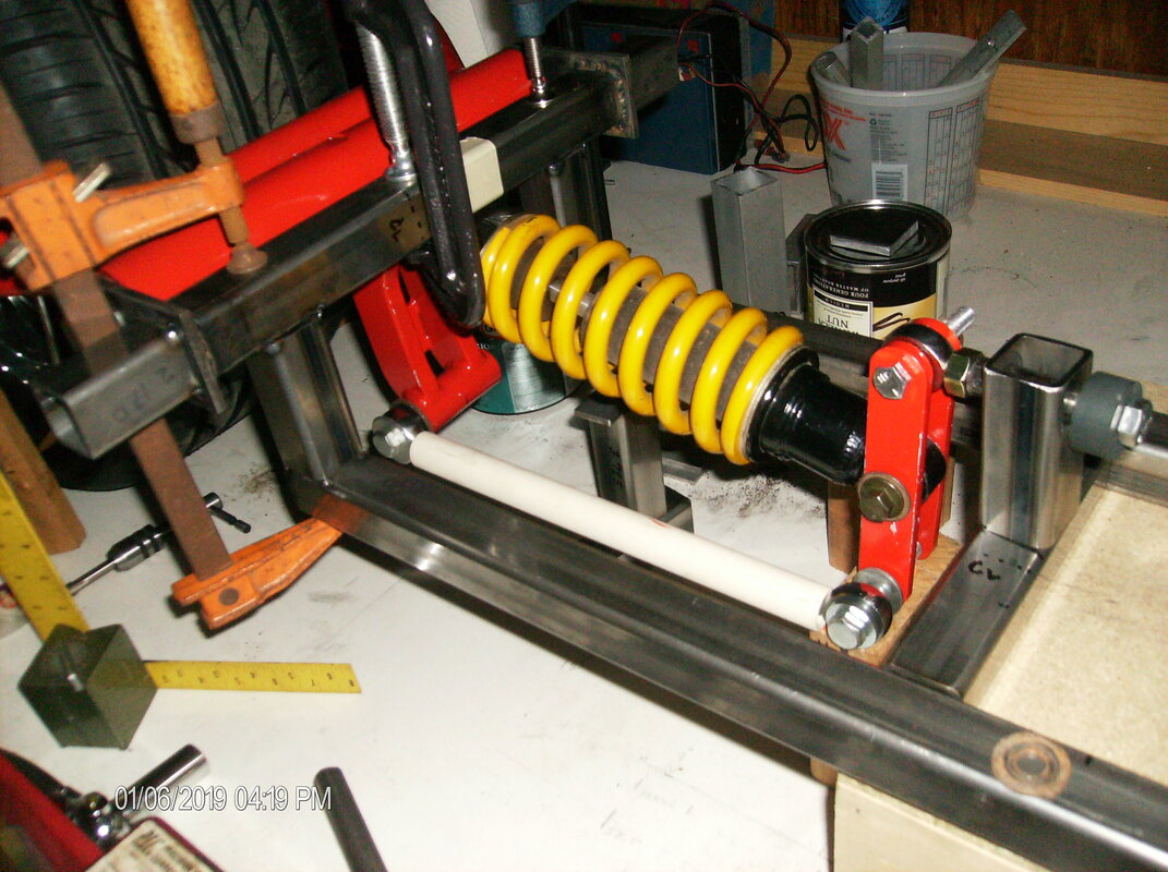

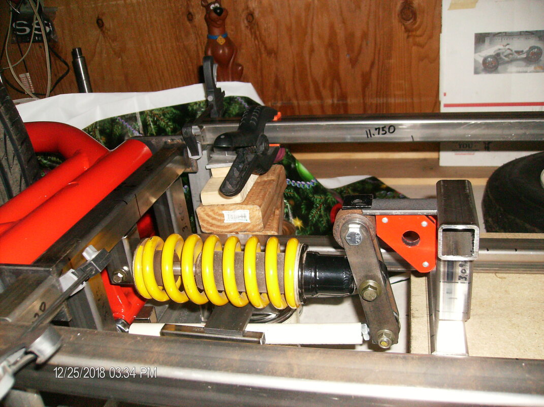

Damn, One step forward and two steps back, swing arm bracket wants to hit the shock bracket, so I'm going to center the shock to the swing arm bracket and higher mount and try dual pull rods??? And keeping an eye on the location of jack-shaft area...HPIM4171.jpgHPIM4172.JPG
RebelRouser
A little higher at the top of the shock and one push rod on the outside so I will add another...
RebelRouser

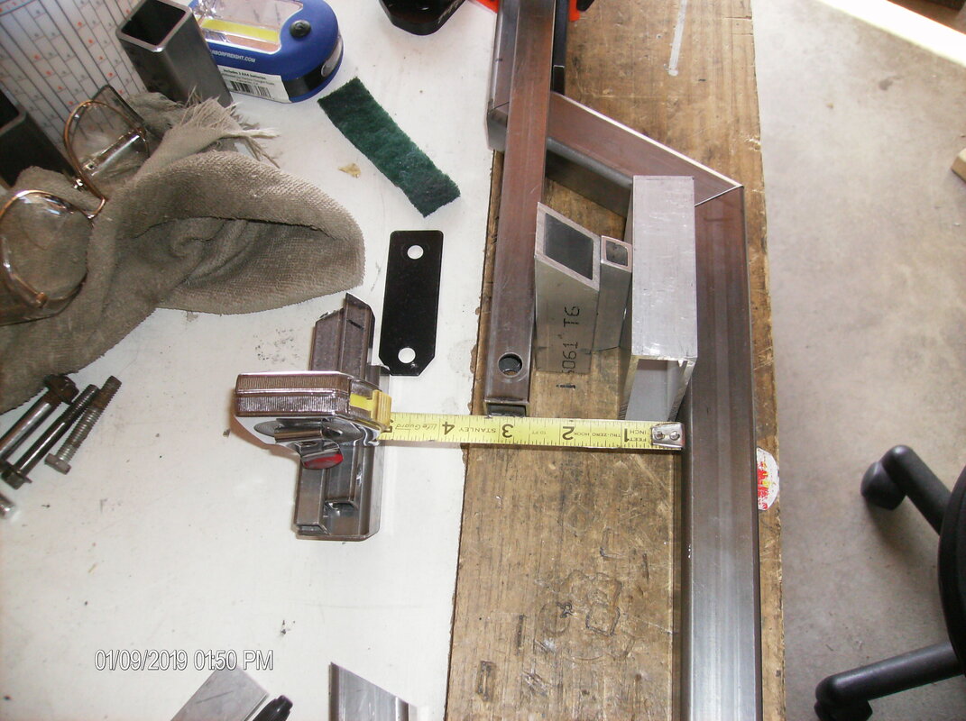

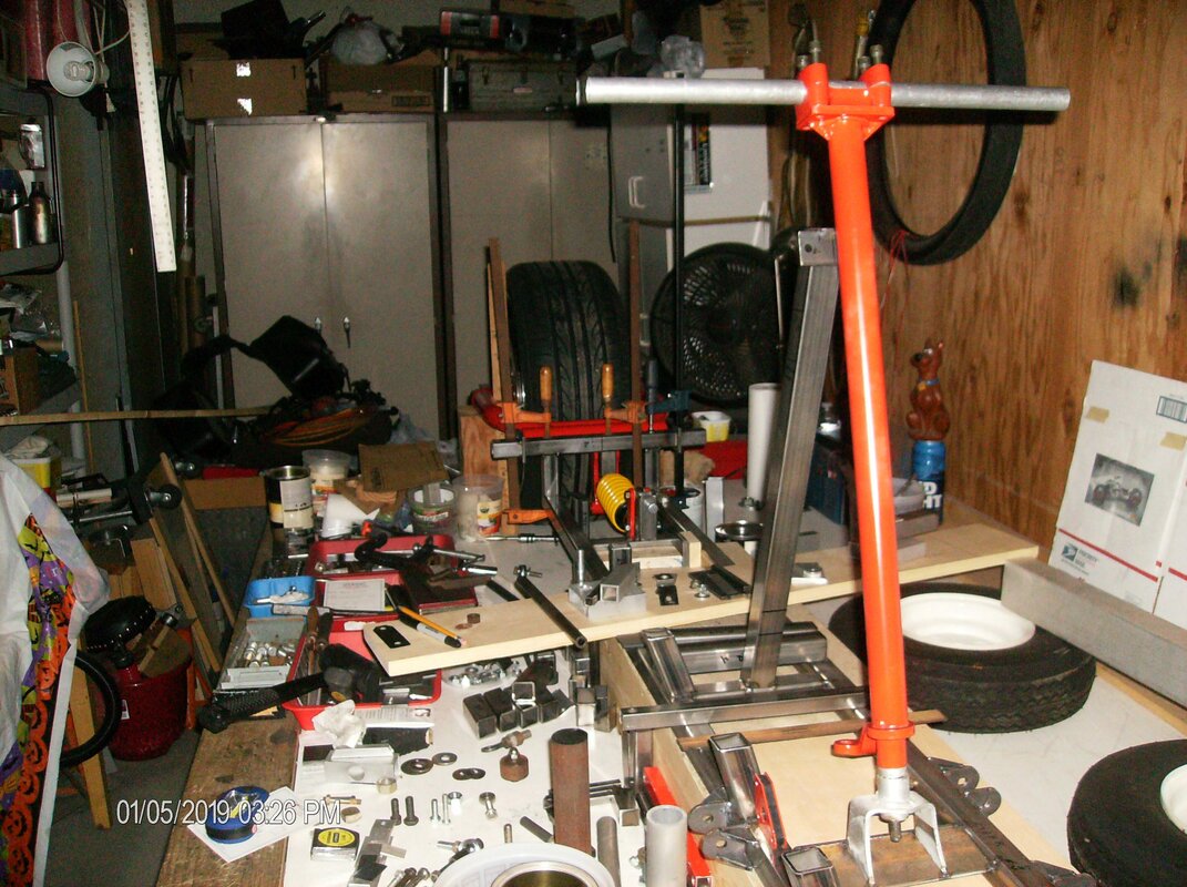

More higher and now to far out, this part of the build is giving me the FITS (pooop) I am working with the machinist this week for this bracket ( and order 2 more heim joints) and the upper frame rails with the 30 degree kick out to clear the engine...
While the machinist is making new brackets for the shock top, it will give 15-20 degree angle then I will rework the bottom mounts. Mean while I need 2.5 inch clearance for the angle for the upper rails so the front rails will be 8.5" wide and flare out for the engine clearance to 16.5" wide and tie in the swing arm brace, I hope, just about ready for the upper control arm brackets to be welded on, install the arms, brakes, steering, AND start fighting the front coil overs... :Shrug:

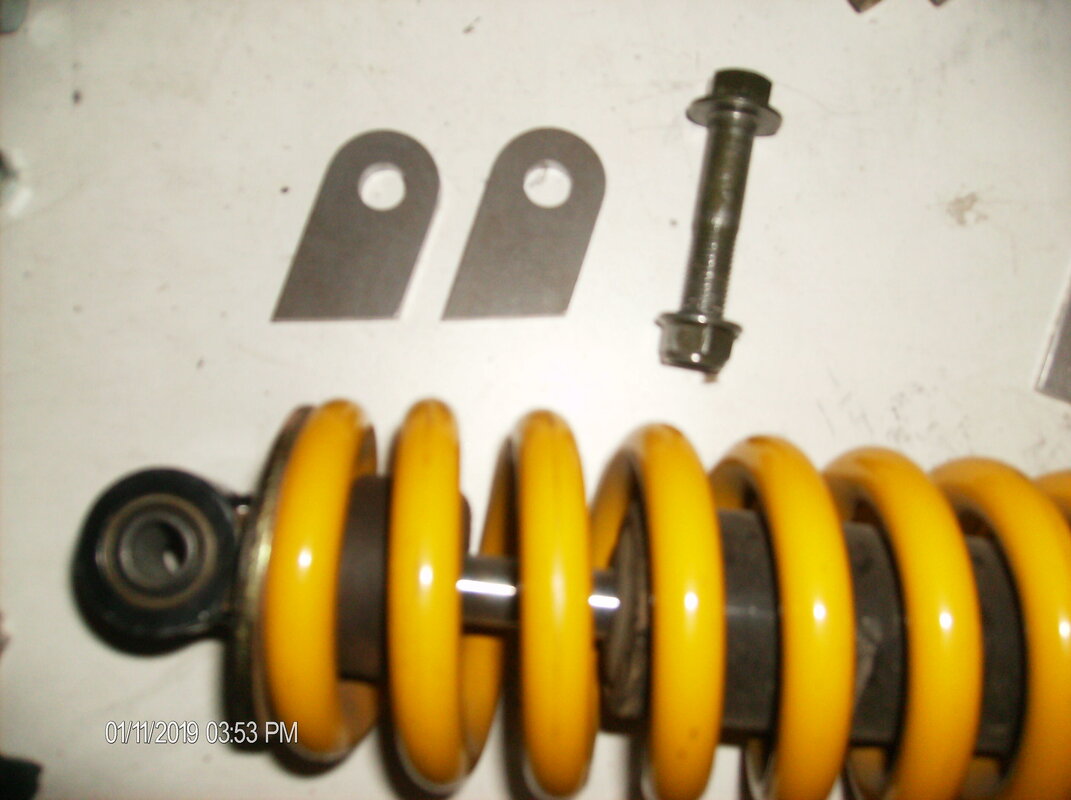

HPIM3157.JPGMachined upper shock brackets that will give me a 15-20 degree down sloop, then mock up, then double check lower shock brackets, all tack weld, then move back to upper frame and control arms.. YEA!:clapping: getting closer to a rolling chassis...:D
RebelRouser
Yea! That's me ready for the tack welding of the cross member that joins the swing arm , the lower frame and the upper shock brackets, and later the jack shaft...
