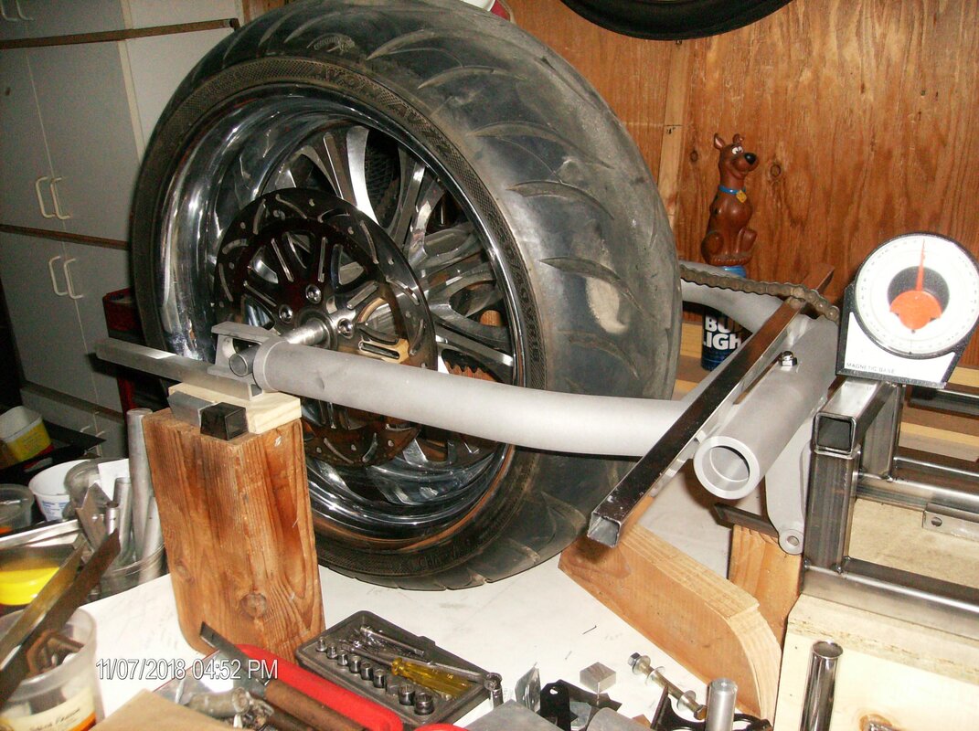

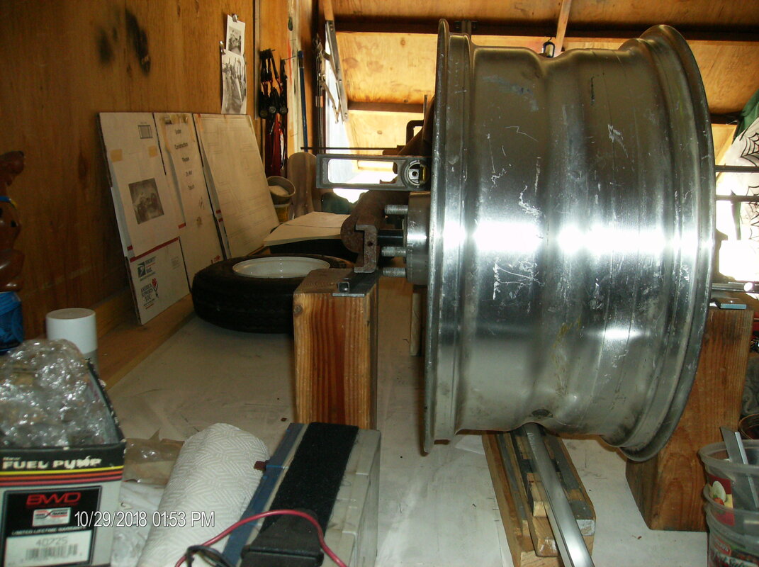

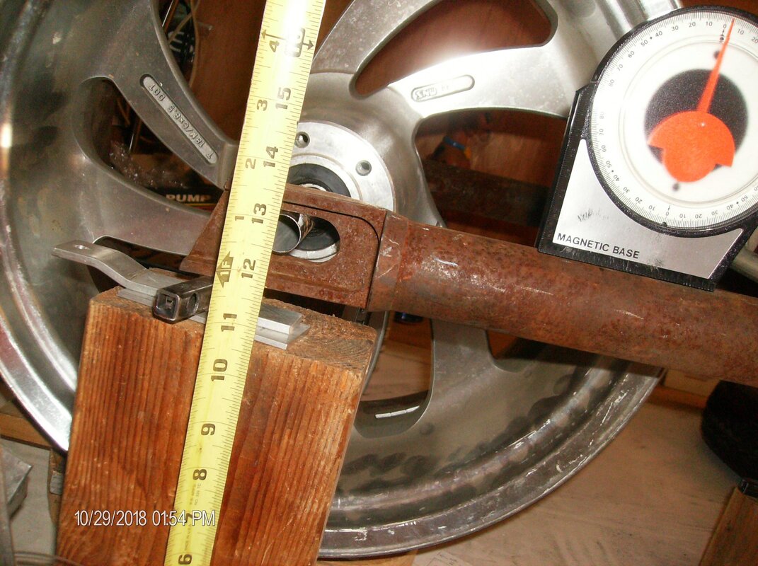

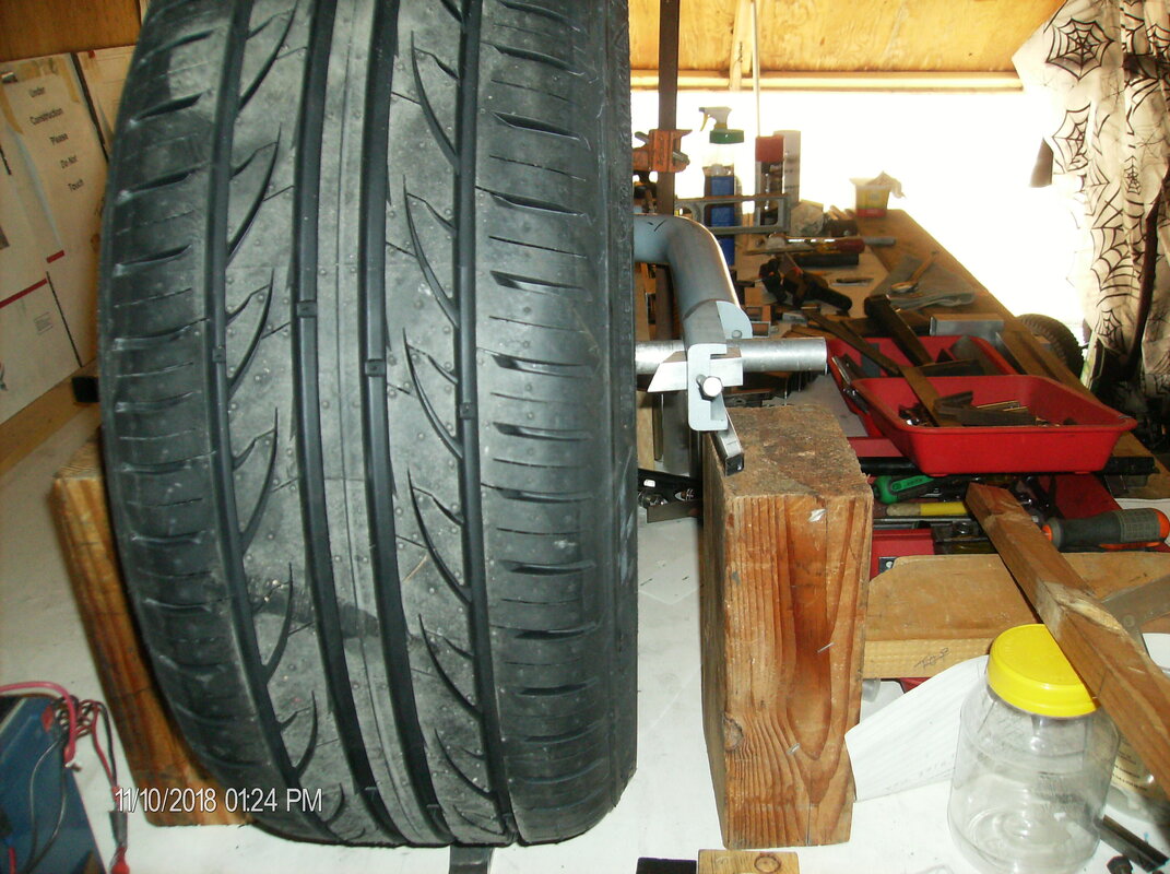

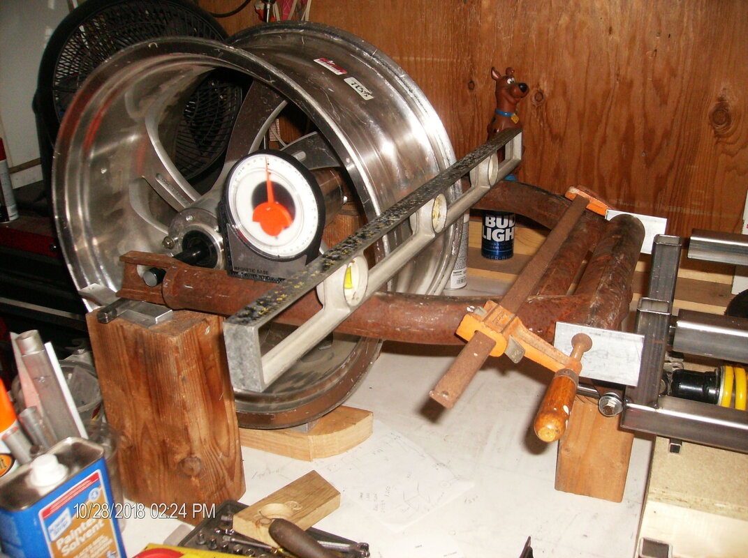

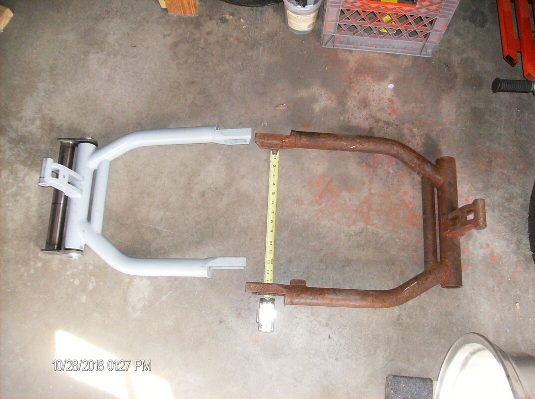

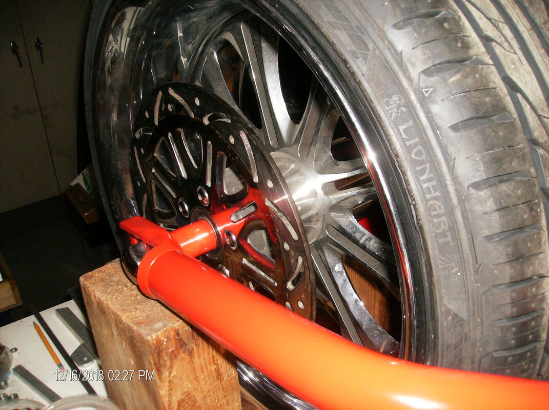

Scored at the motorcycle swap meet today, new swing arm is about 2" wider than the first one giving me more room for chain and disc brake, not to mention a fatter tire and taller...HPIM5789.JPGHPIM5790.JPGHPIM5791.JPG:D:clapping:

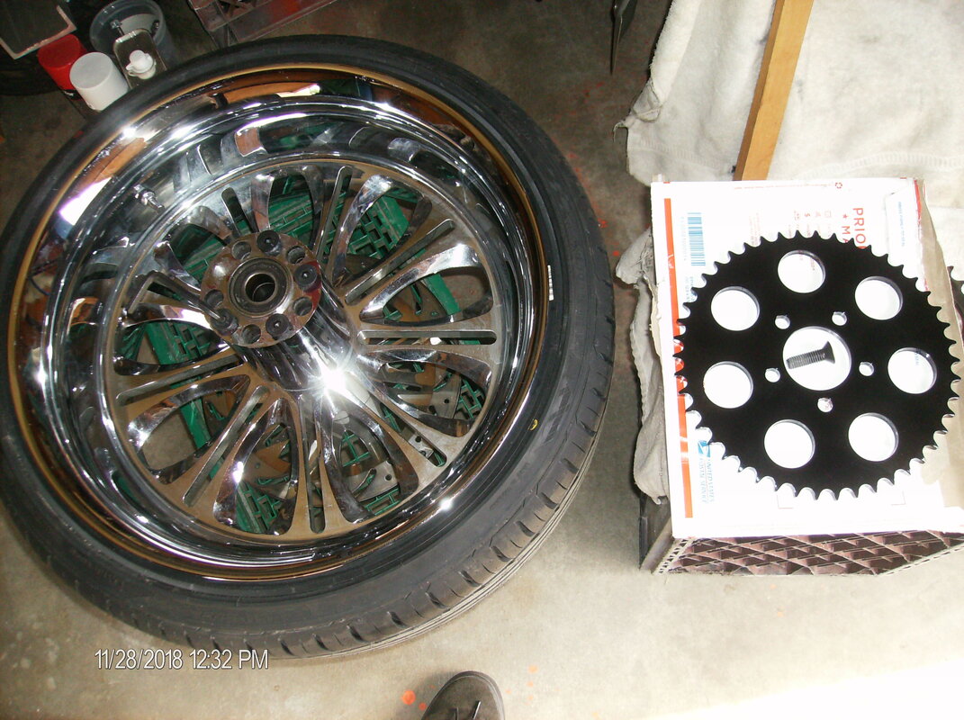

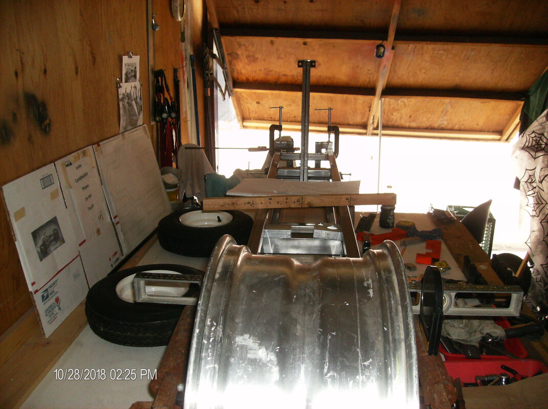

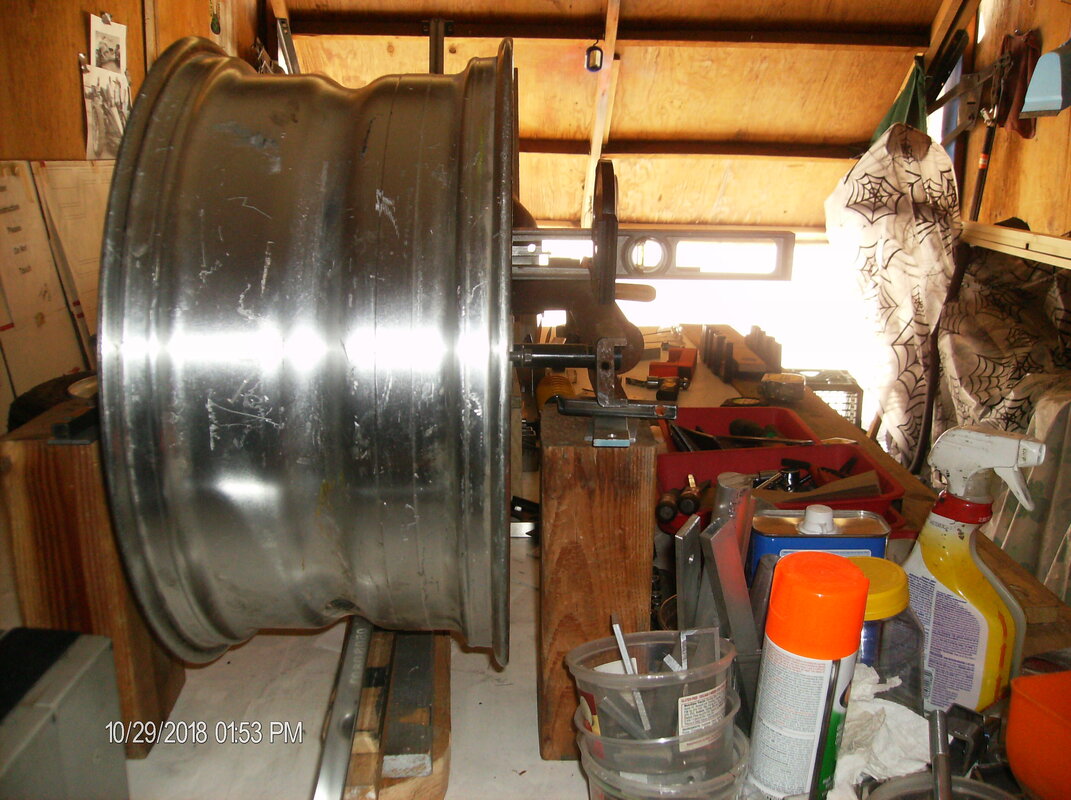

Having problems with the rim, sooooo! picked up this one on the cheap with sprocket and disc mounted, mock the chain and then change the tire...HPIM5838.jpgandHPIM5839.jpg:clapping:
RebelRouser

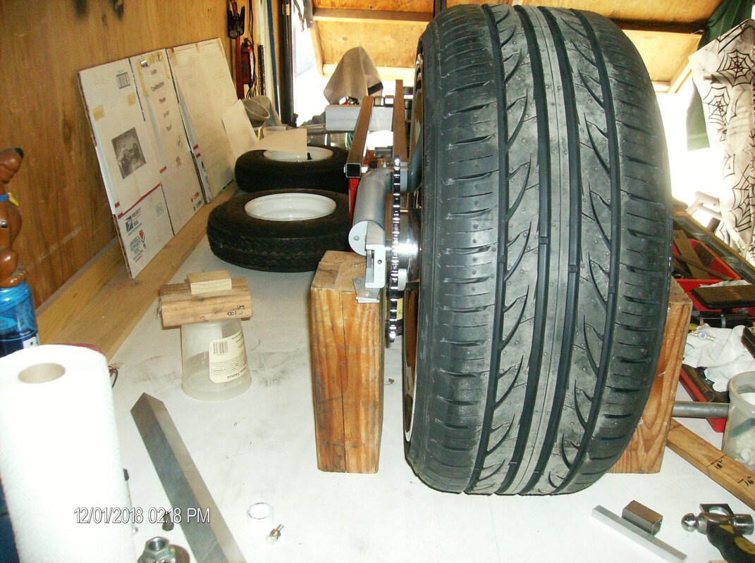

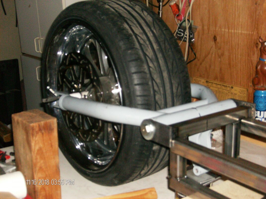

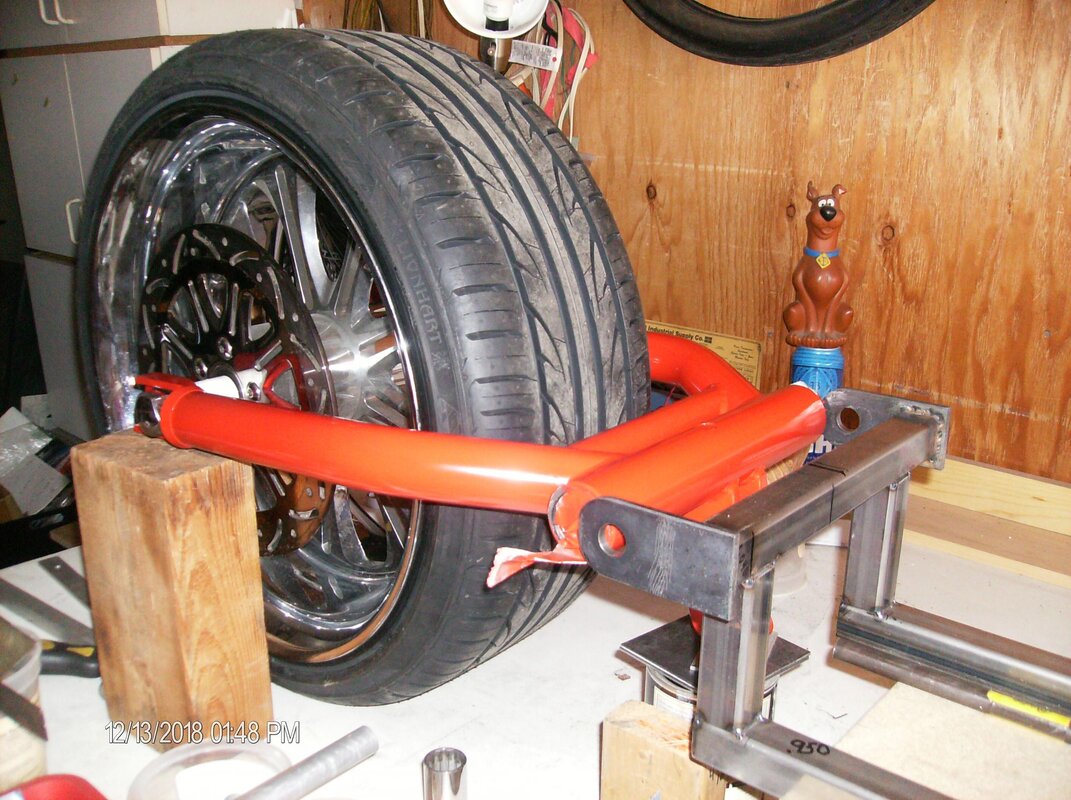

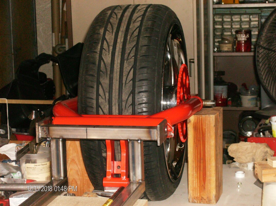

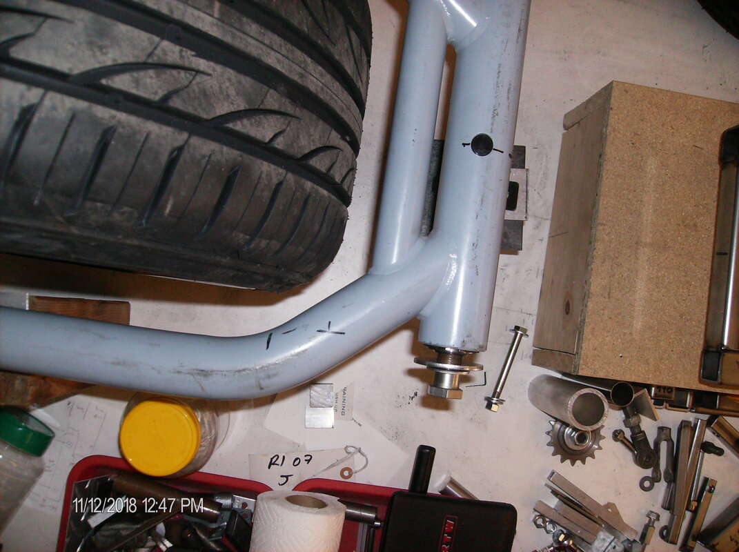

HPIM5843.jpgHPIM5844.JPGHPIM5845.JPGOK back to the drawing board, this tire (215-35-18) fits so good OMG! I will go with the first swing arm, set center then to tack weld with the lower control arms next:clapping:
RebelRouser

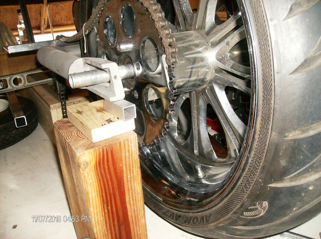

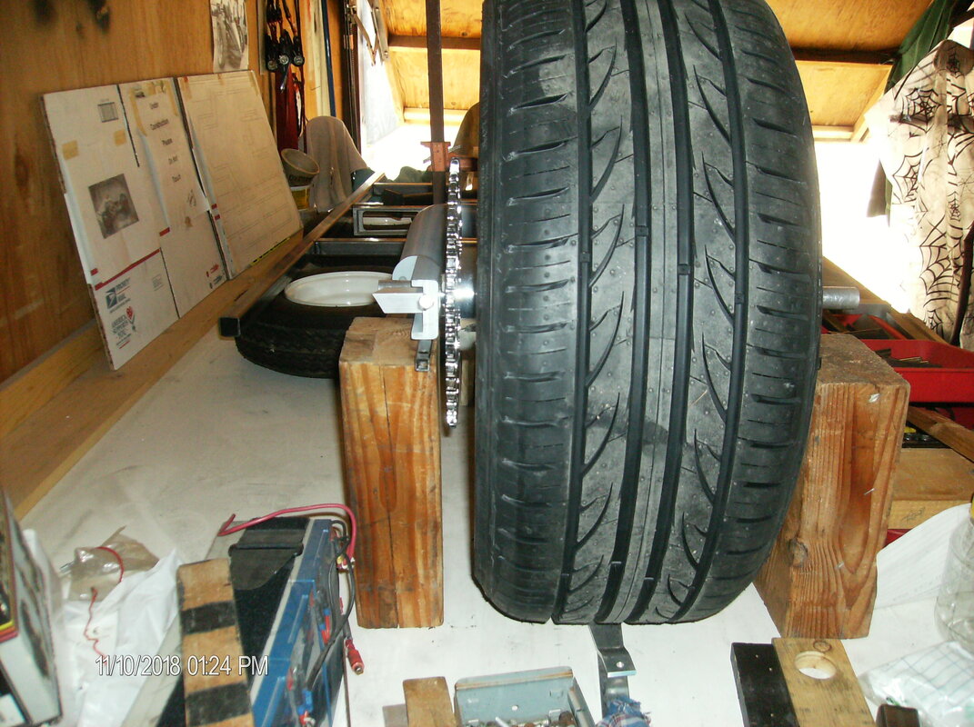

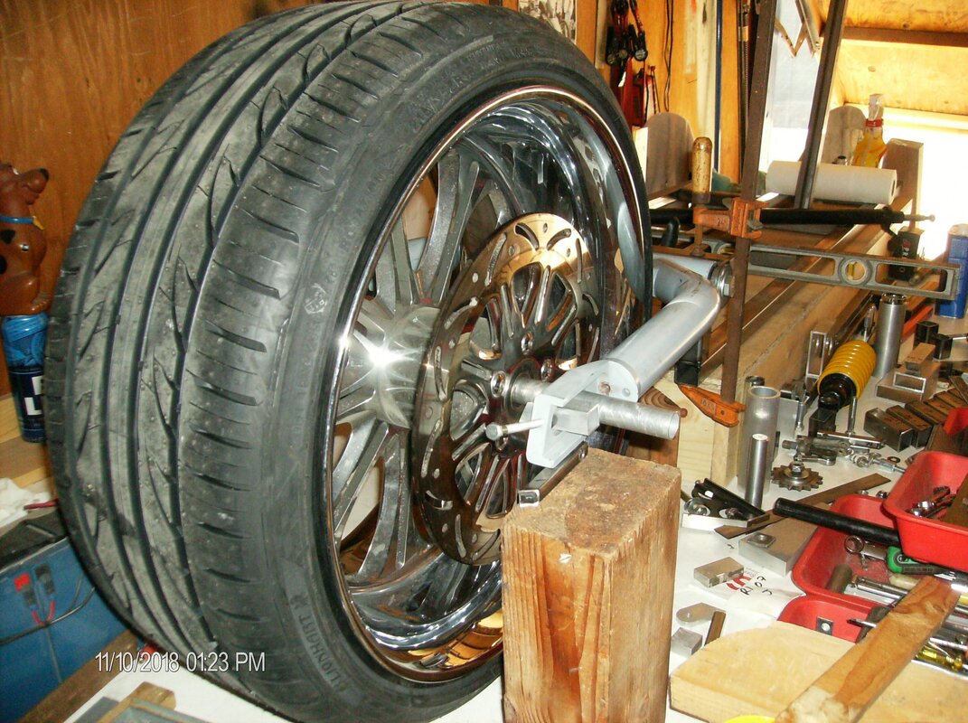

Tire fits close for chain install.HPIM5861.JPGDamn nice fit, HPIM5857.JPGThis is so square it reminds me of my brother, ready for the welding...

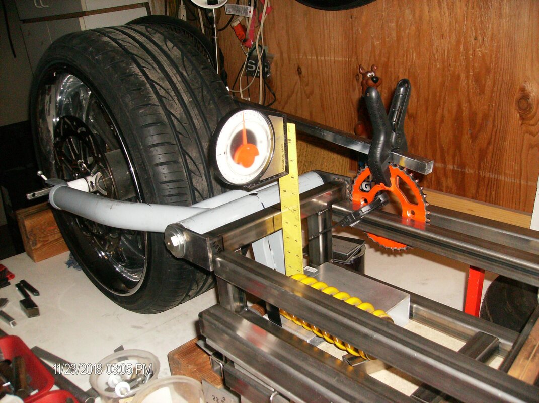

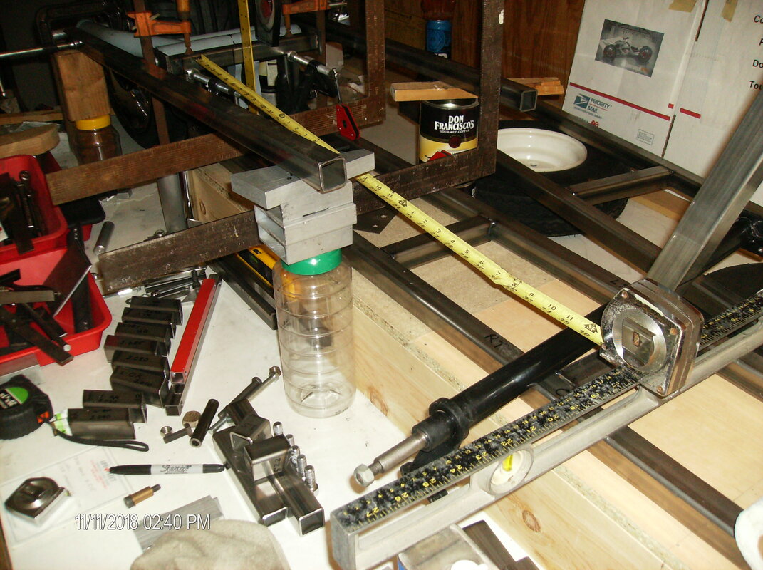

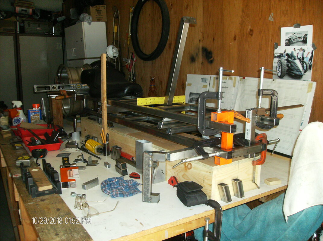

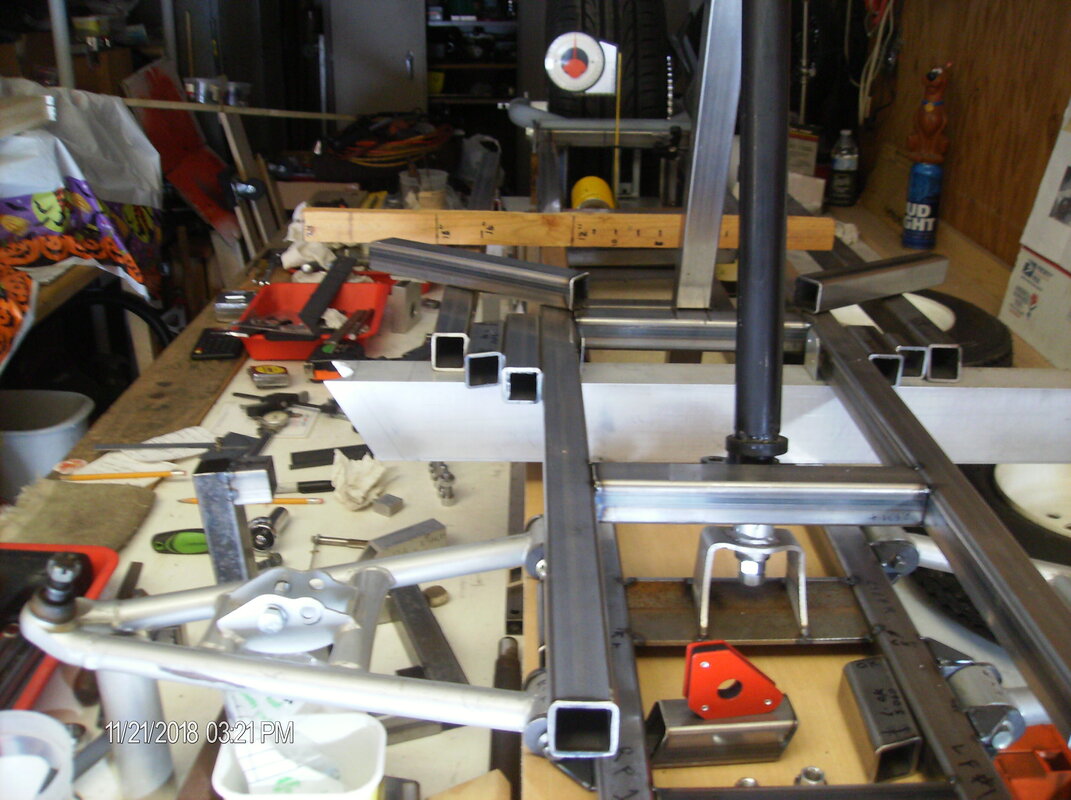

More mock up, tack welded swing arm brackets to frame and lower control arm brackets.
More mocking on the upper frame rails and control arm brackets and those 18 degree vertical braces...HPIM5872.jpgHPIM5873.jpg

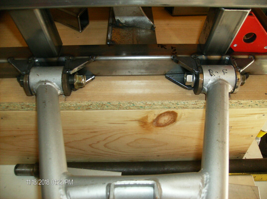

The control arm lower brackets, tabs and gussets are 3/16, I hope overkill? I should have made some fixture bushings .005-.010 over and bolted before welding, I will for the upper ones...RT Control Arm brackets.JPG
The control arm lower brackets, tabs and gussets are 3/16, I hope overkill? I should have made some fixture bushings .005-.010 over and bolted before welding, I will for the upper ones...View attachment 64040
what i do is put one or two pc of manila folder in there then u dont have to fart around w making bushings... with that setup i bet it will pull enough to get the a arm back in.... if it werent for the rubber i would weld it up solid as is yes a tad overkill.... my moto.... build it strong
u wont go wrong.... unless u are racing then u have to draw the line some place

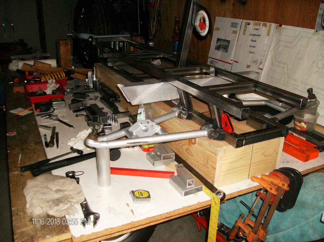

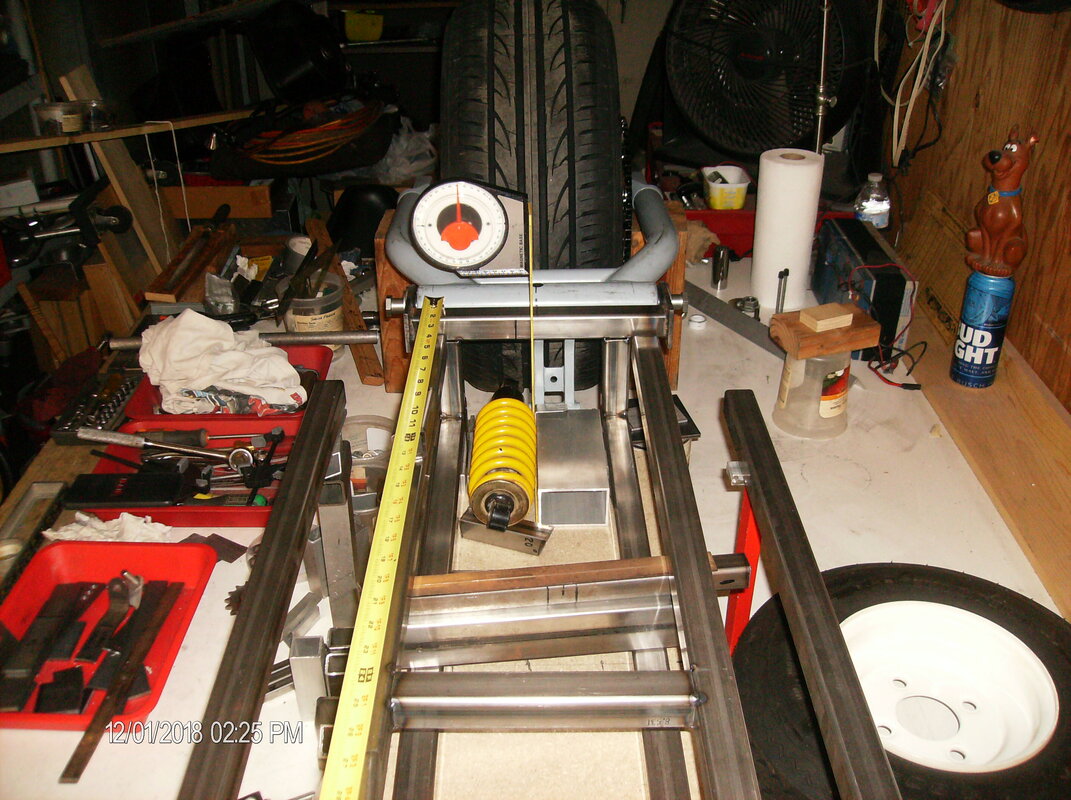

Upper frame rails are being dialed in for jack shaft and engine clearance...
This is going to take some time and many headaches? Back to flatness problems again with 60 degree bends or cuts? Ordered a flat 46T Harley painted sprocket, I will counter sink the mounting bolts for a closer fit to the swing arm. Tomorrow is Thanksgiving holiday weekend and wife is out of the country with relatives SOOOOOOO!!! Home alone and many drawings and glasses of red wine, HPIM4010.JPGHPIM4012.jpgHPIM4015.JPG1-Happy Thanksgiving.jpgME2
RebelRouser
Need to bend the upper frame rails out (left and right) so I'll have at least 16" on the inside, the engine is 15" wide, and again fittings of jack shaft and gear shift, exhaust mounting, so many things to consider. New sprocket and mounting bolts should be here soon...

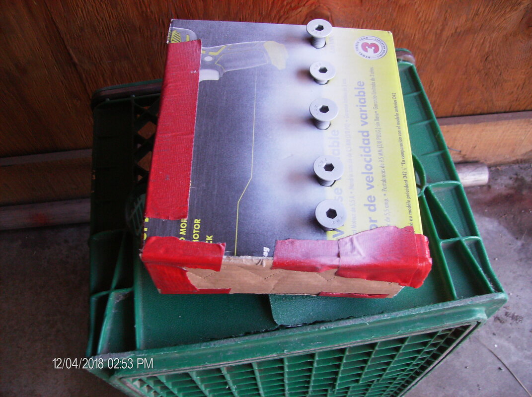

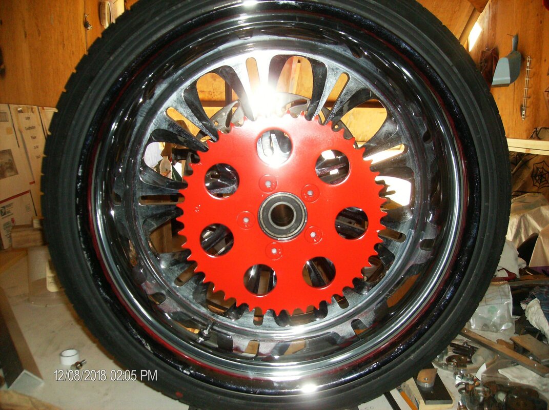

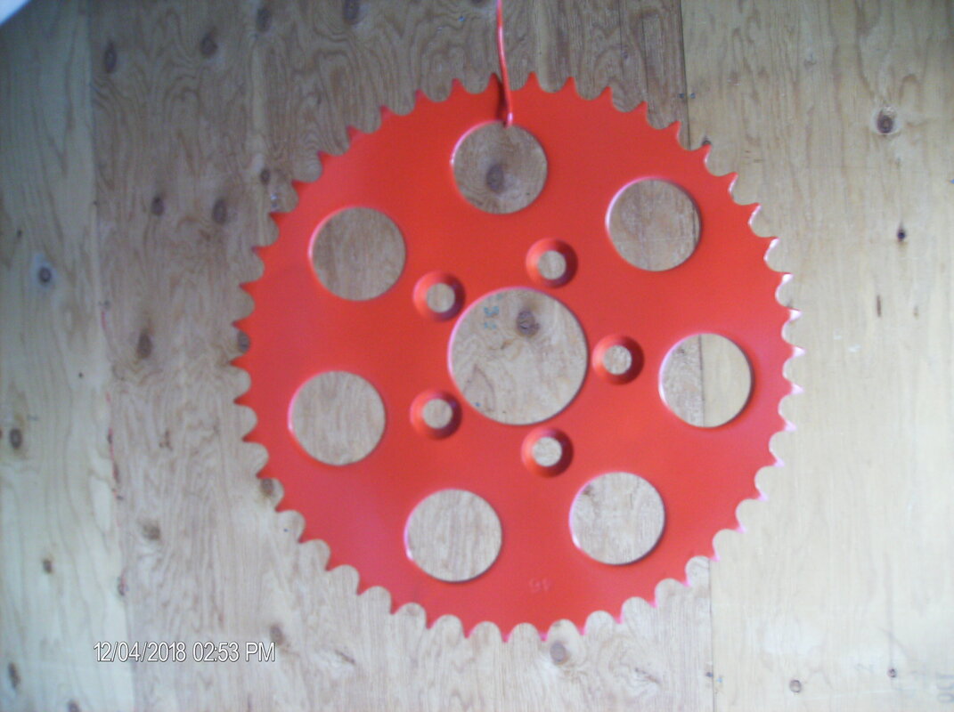

HPIM4046.JPGYeaaa! eBay's snail mail is here, one day late, Harley sprocket 46T and flat head bolts for recessing to get a little closer to the swing arm side.
Dropped off at the machine shop for countersinking, This is why I bought a painted sprocket, did not want to cut up the chrome, so I'll just paint it the trike color RED, should be finished tomorrow then set up the wheel to swing arm and then back to the upper frame rails...
RebelRouser
can't keep my eyes off that rear wheel!!! All, is looking good! :D
Yesss, I like it more and more, wait till I ask my wife if she wants to learn how to polish it? She'll be laughing at me for a week...
RebelRouser

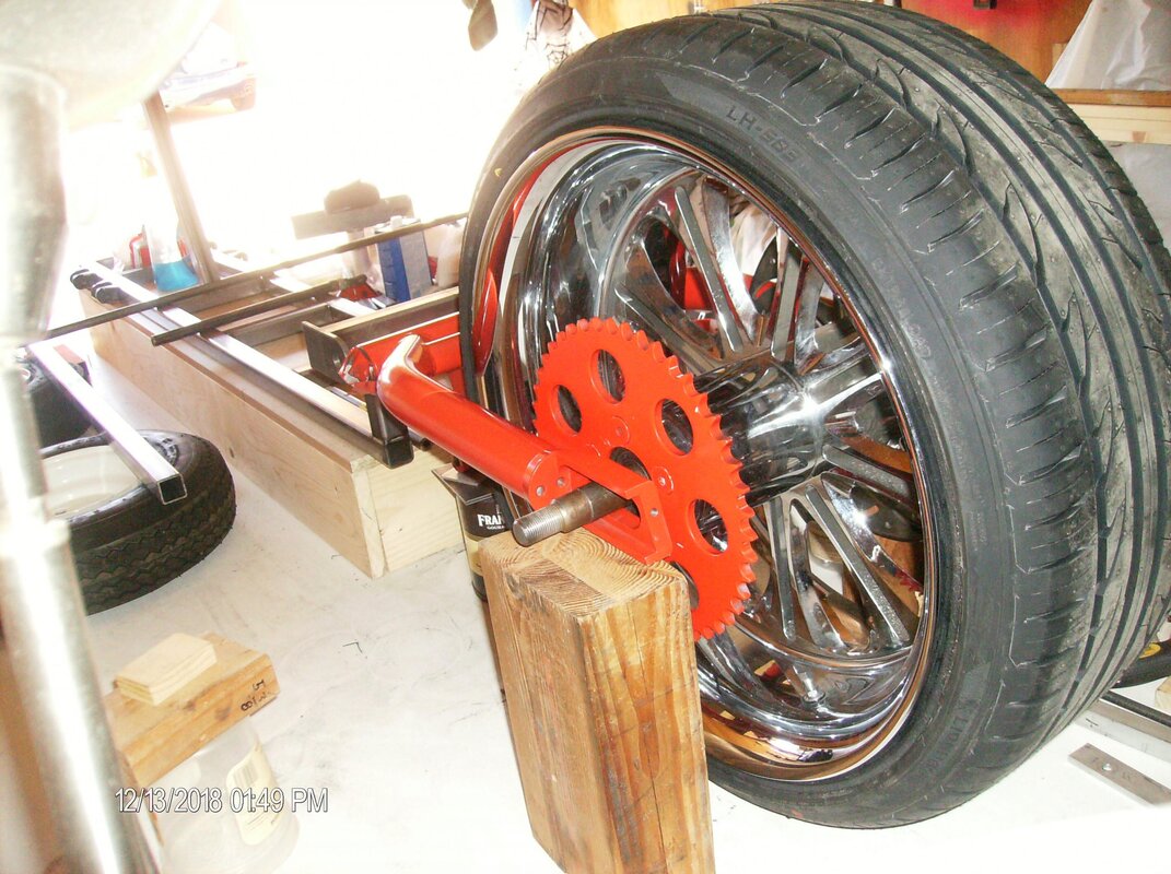

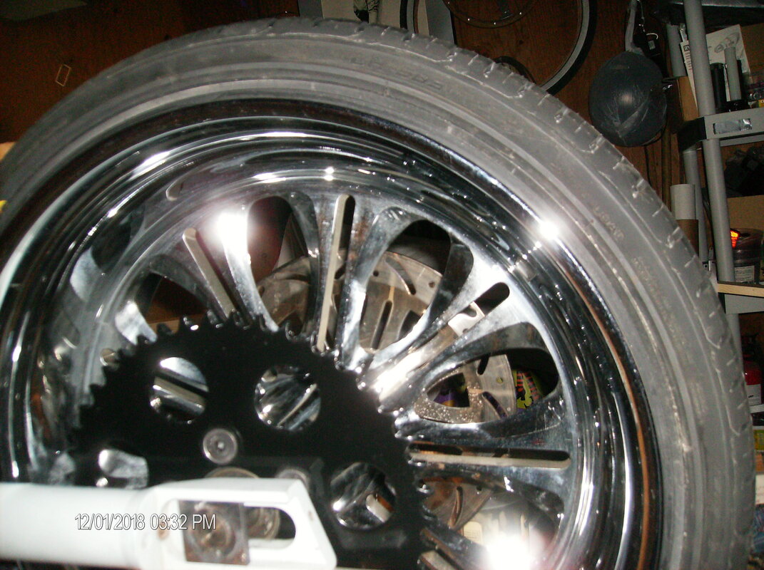

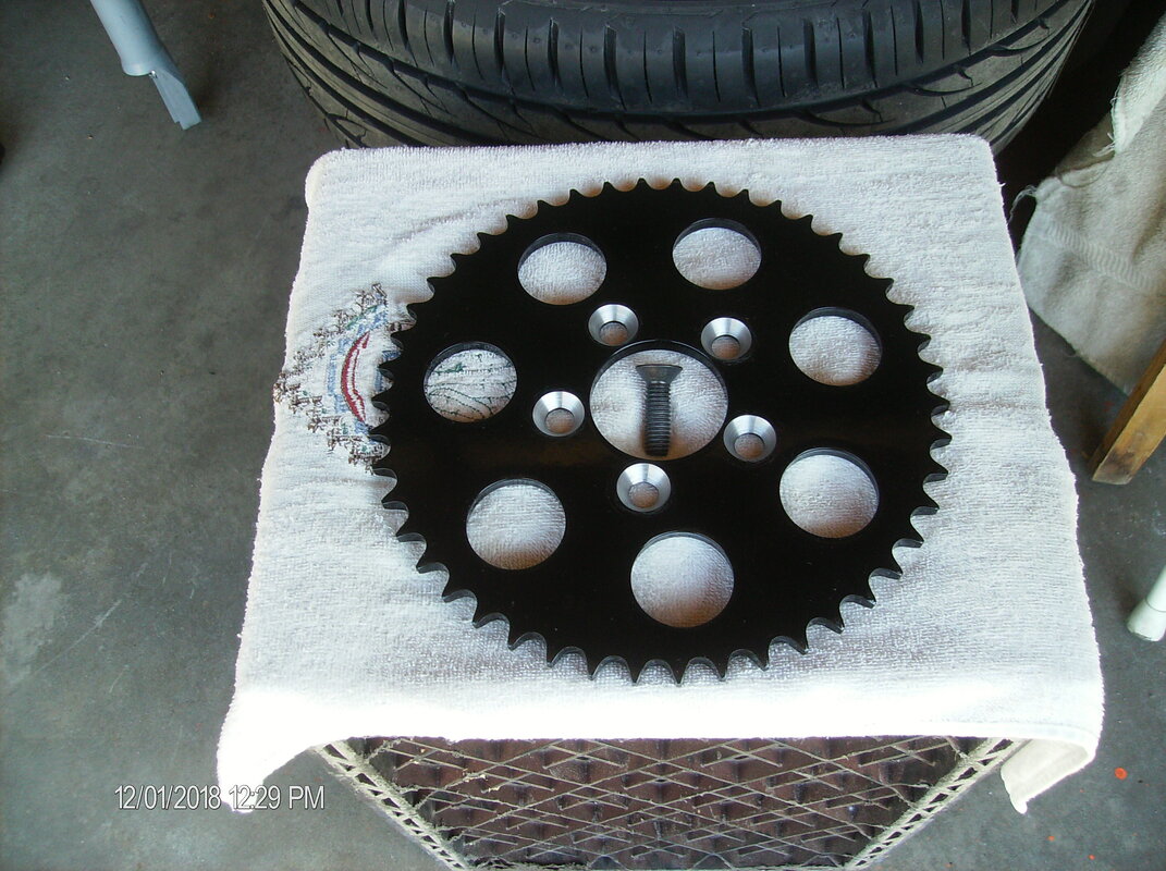

HPIM4050.JPGBack from the machine shop with the countersinking finished and trial fit,HPIM4054.JPGHPIM4051.jpgHPIM4053.JPGNow I have 3/8 (.375) side clearance form sprocket to swing arm plus 1/2 the sprocket is .150 so this gives me .525 for 1/2 the chain, which is about 1.000 wide total,:clapping: Measured the length for the axel spacers on each side, now to re-do the mounting bracket since the upper frame rail is going to be wider so that's next with the upper rails themselves widened, then to the jack shaft, more measurements tomorrow (Sunday) then off to my steel supplier for swing arm brackets 3/8 this time? and some tubing for the swing arm push rod and to figure the bell crank, :xzqxz:

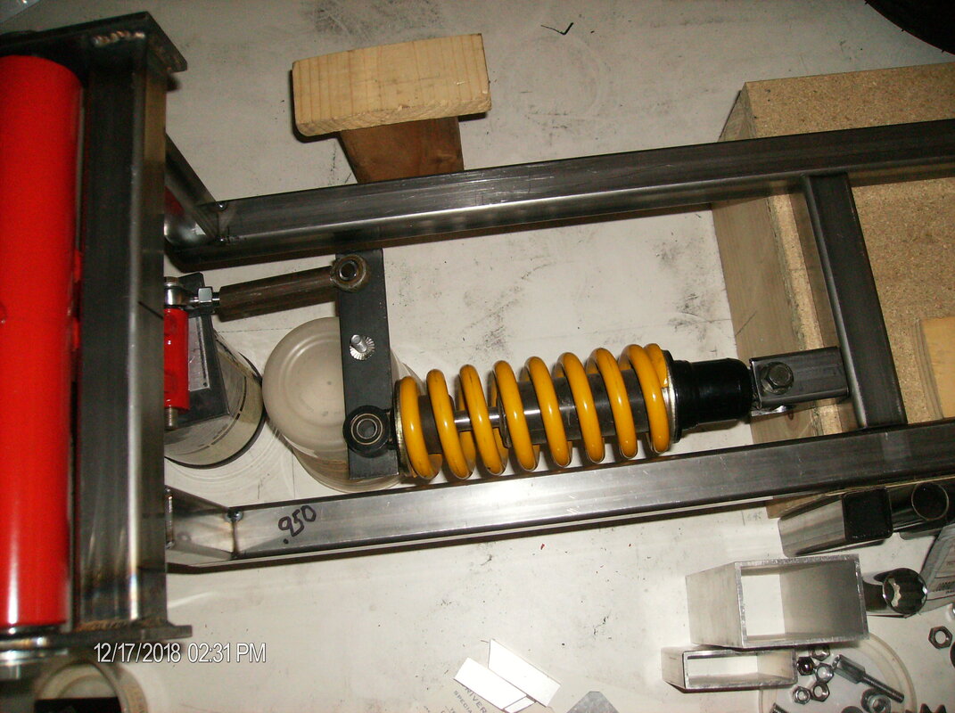

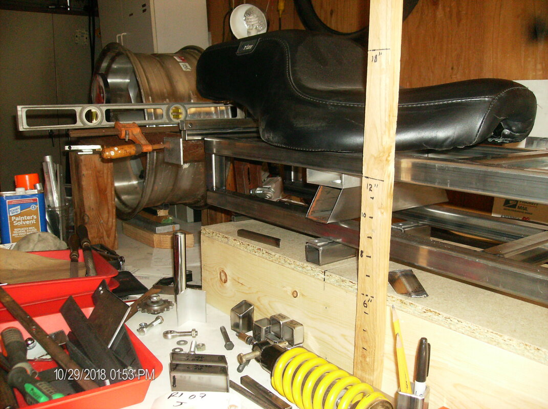

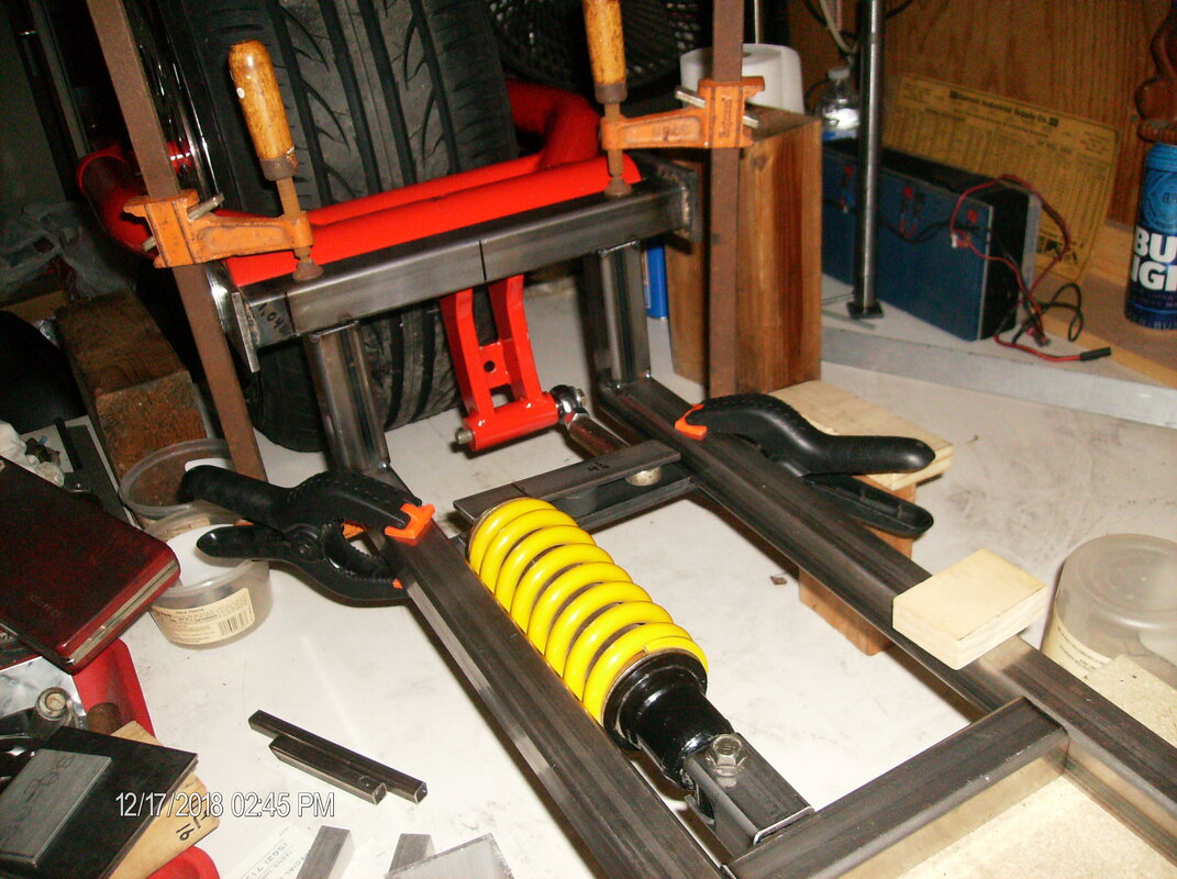

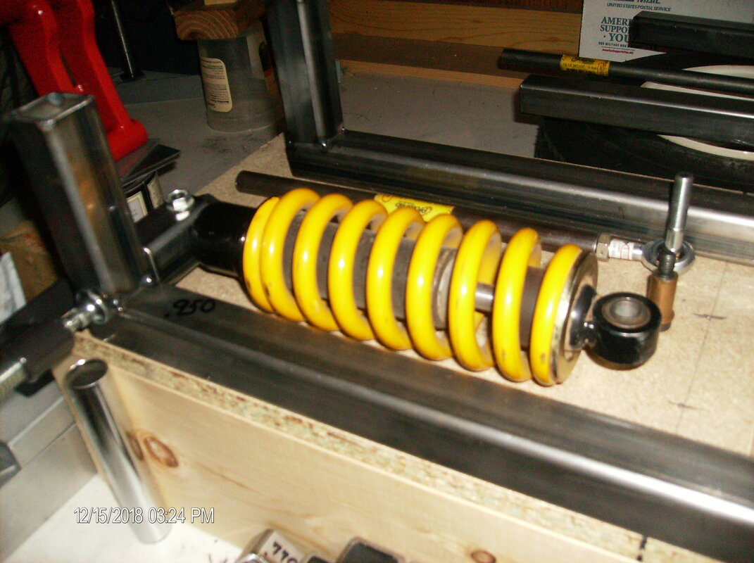

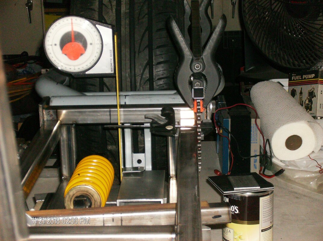

Machined the axle spacers and paint, HPIM4101.JPGNOT happy with the coil overs location...HPIM4104.jpgThe push rod is a pull rod? BACK TO THE DRAWING BOARD...
RebelRouser

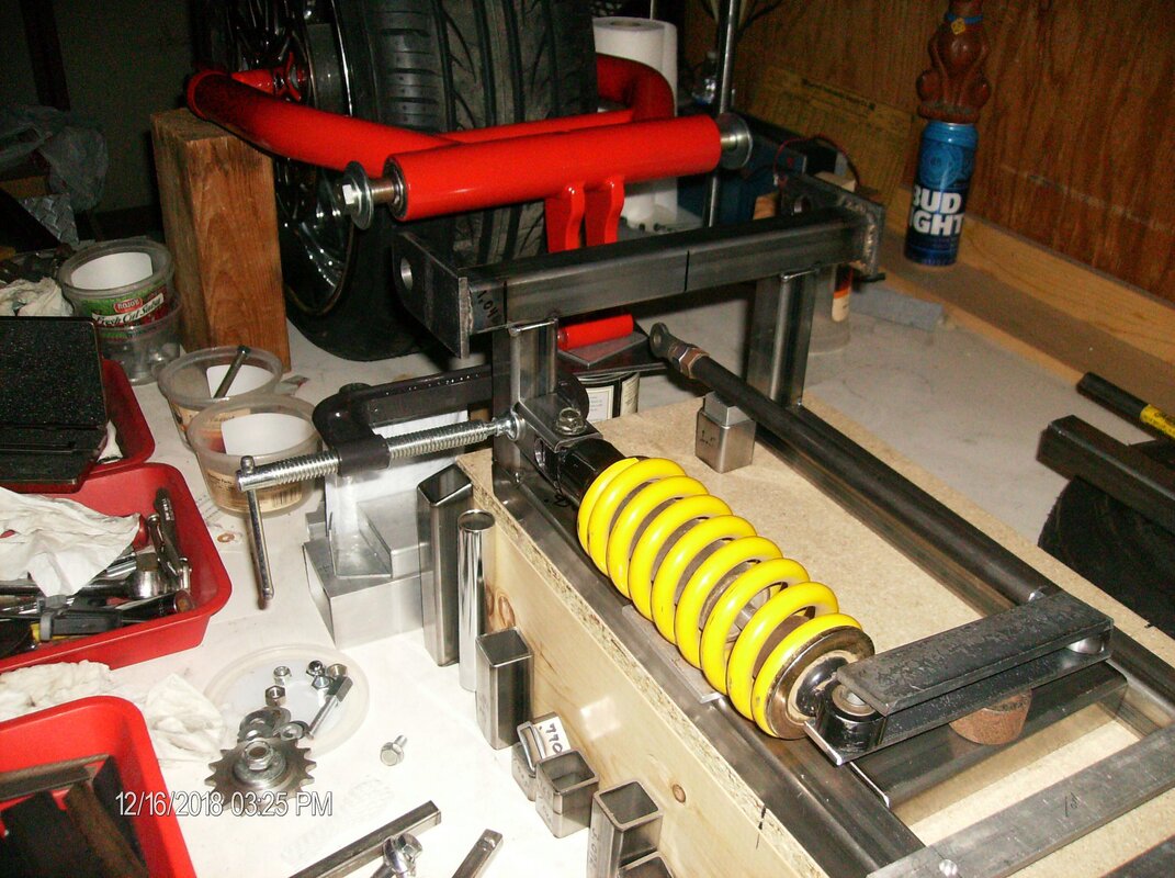

Damn I hate doing things wrong, That's what I get for NOT being an engineer, (re-work)HPIM4111.JPGThis should work?
Damn I hate doing things wrong, That's what I get for NOT being an engineer, (re-work)View attachment 65215This should work?
yup that is the right direction one problem i might see is the swing arm where the wheel is attached much longer than the arm where the shock is mounted you need a short through super strong spring...but being light you might be okay the other potential issue the short travel on the connecting rod is so short it will may change the realized spring rate hope that makes sense it would help if you rotate the arm clockwise by moving the pivot to the front an lengthening the tie rod
RebelRouser

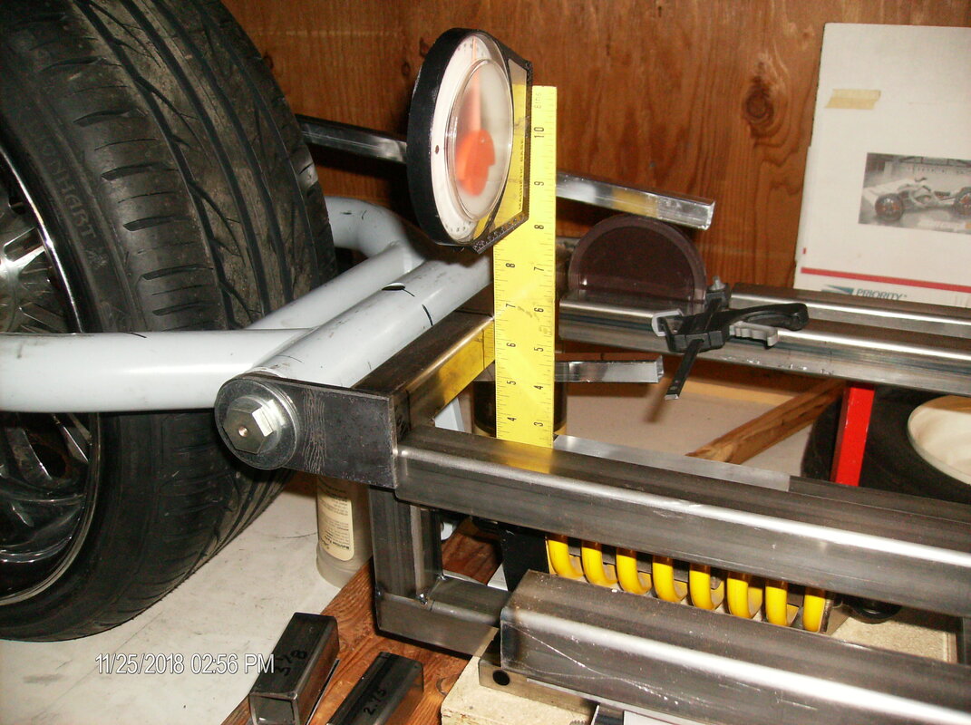

RT coil over shock mock up.JPGAnother view, OK drawings are made and tomorrow is time to buy material and visit the machine shop...
