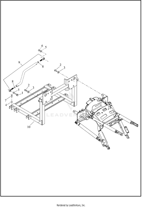

If you use a floor jack and a block of wood you can lift both wheels @ the same time jacking under the frame cross rail in the picture here, this is how I have jacked mine several times. I also use jack stands under the shock brackets just in case

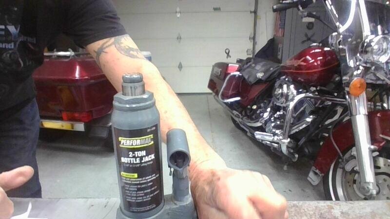

If you have a trailer hitch you can put a floor jack in the center of it and lift the bike. I do this then put a jack stand under each side of the hitch frame. This works very good for doing PM work like tire removal, driveshaft PM and other under the bike things.
