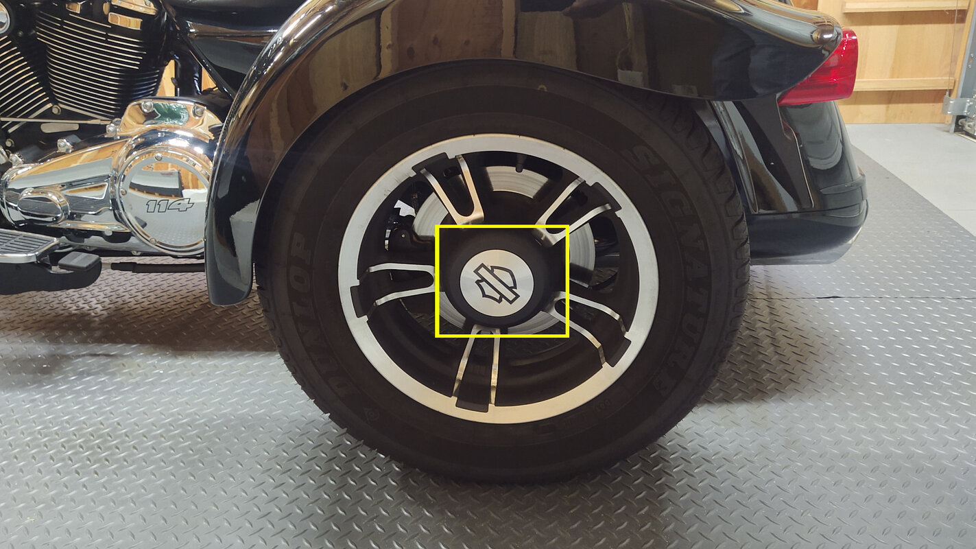

Sorry, should have specified this is a Harley Freewheeler. There's this note in the service manual: "FLRT: Carefully remove center hub cap." However, they give no sugestions as to how to go about "carefully removing the hub cap" which would have been nice.
I just grab it with my hands, rock it once and it pops off pretty easy, I check my lug nut torque at least once a week along with PSI in the tires, usually on a Sunday
No its my fault......I didn't realize ---Freewheeler......But Im thinking that the Tri-Glides lugs are the same lugs as the Freewheeler...
if you can't just pull it off, mine has a notch in it. i sometimes stick a screwdriver in the notch & pull towards me.

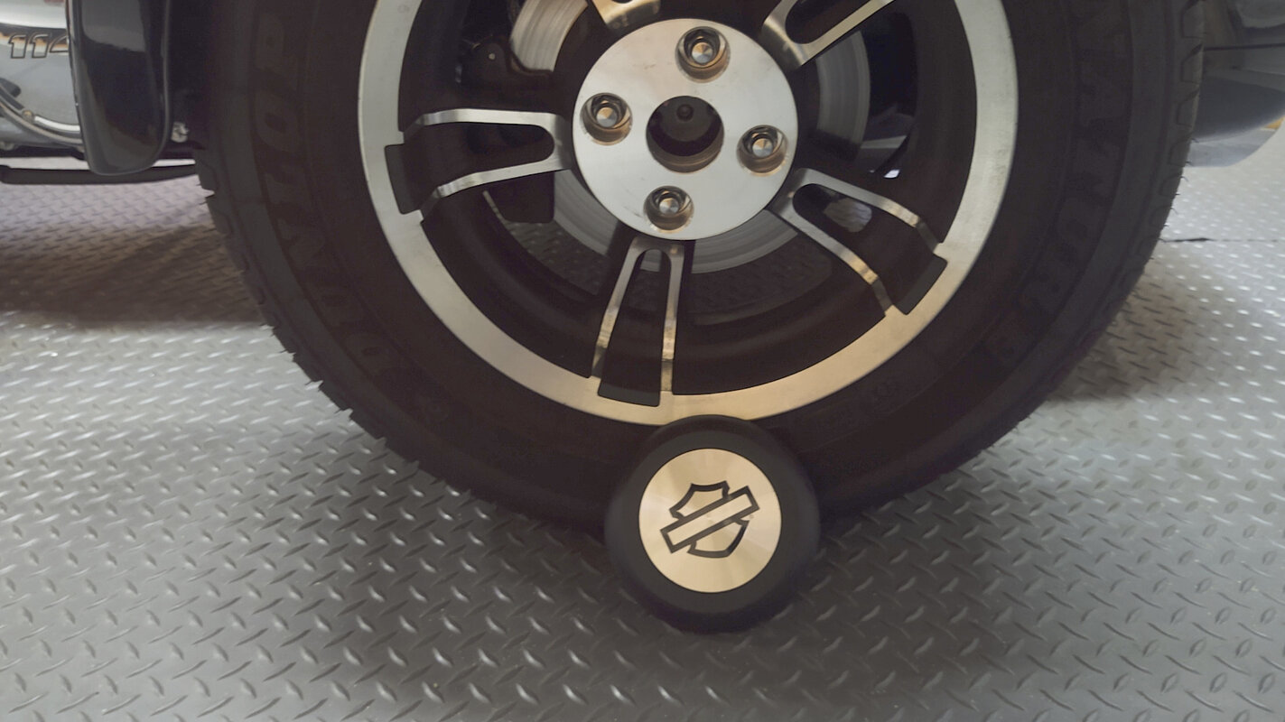

I must be brain dead today. I've been trying to figure out how to get that shinny HD Logo cover off. The entire black plastic hub is what gets removed. I saw that notch and the light bulb lit up. Popped right off. Going to be one of those days, I guess.

Note how tight the fingers on the cap are, on my 15 Freewheeler I lost one hub cap
Since then I check the hubcaps when I pull them off closely, I had to run some duct tape on 1 cap on my 17
So far the 21 is behaving, time will tell
This is another reason I chose to use my hands to remove the cap, I can tell right away if it is loosening up or not
On the TG the center hub is not big enough to cover the lug nuts. I like the way the cap on the FWs does that. I had never noticed it before.
