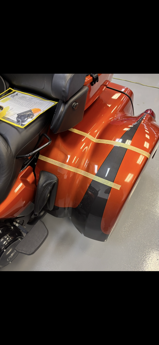

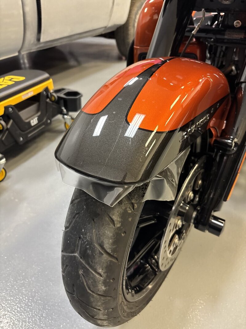

Earlier this year had Ceramic Pro PPF with 7 year warranty professionally installed by “It’s A Wrap Automotive” in Champaign IL.
They covered the entire front half of both rear fenders (the upper tape line in the pic), the front half of the front fender, and the entire front fairing for $900.

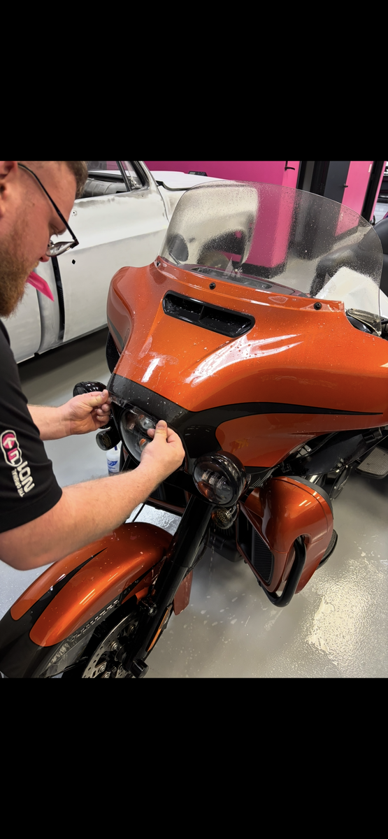

I’ve put it on a few cars in the past and thought putting it on my bike would be a snap. I bought some Xpel film, cut the first fender piece, got out the slip solution, scratched my head trying to figure out how to start, then said nah…this ain’t happening.
Took it to the shop and they said with the compound curves, they have to steam and stretch it to fit. The fairing was actually 3 pieces. I watched them for a few minutes on another bike and said call me when you are done.
Just a tip looking for a shop. Try calling some automotive vinyl wrap places to see if they do PPF. Vinyl wrap and PPF would seem about the same to install, but they are not. They use a steamer for PPF and a torch for vinyl. Ask if they have a steamer and if they do, they probably are trained and are good at installing PPF.
