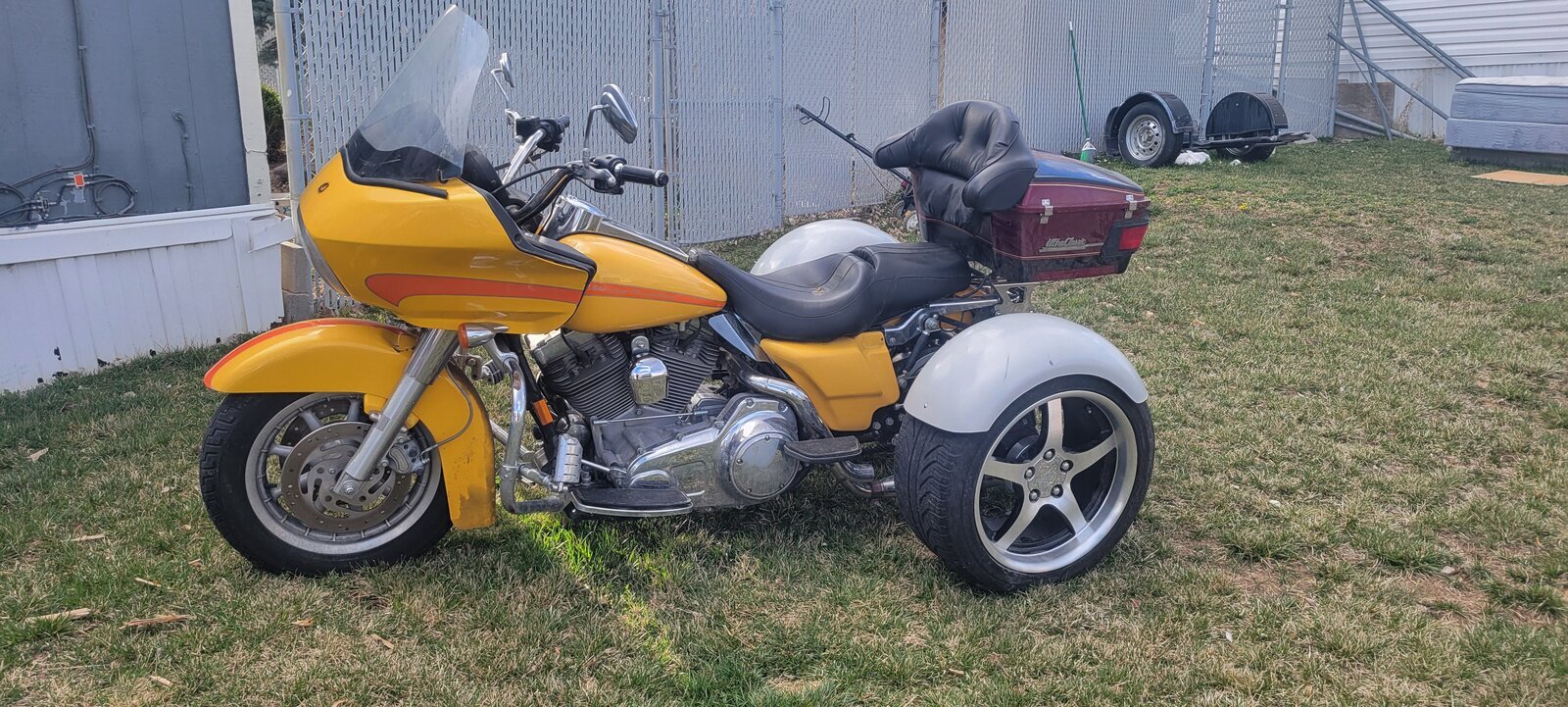

Good Afternoon! I have a question about wheel size! This is a Frankenstein Kit and was not put on by myself or husband. We recieved this trike for free, yes, free. The work was done by either the person who had the trike or whom he hired. He has passed, hence why I have the bike.

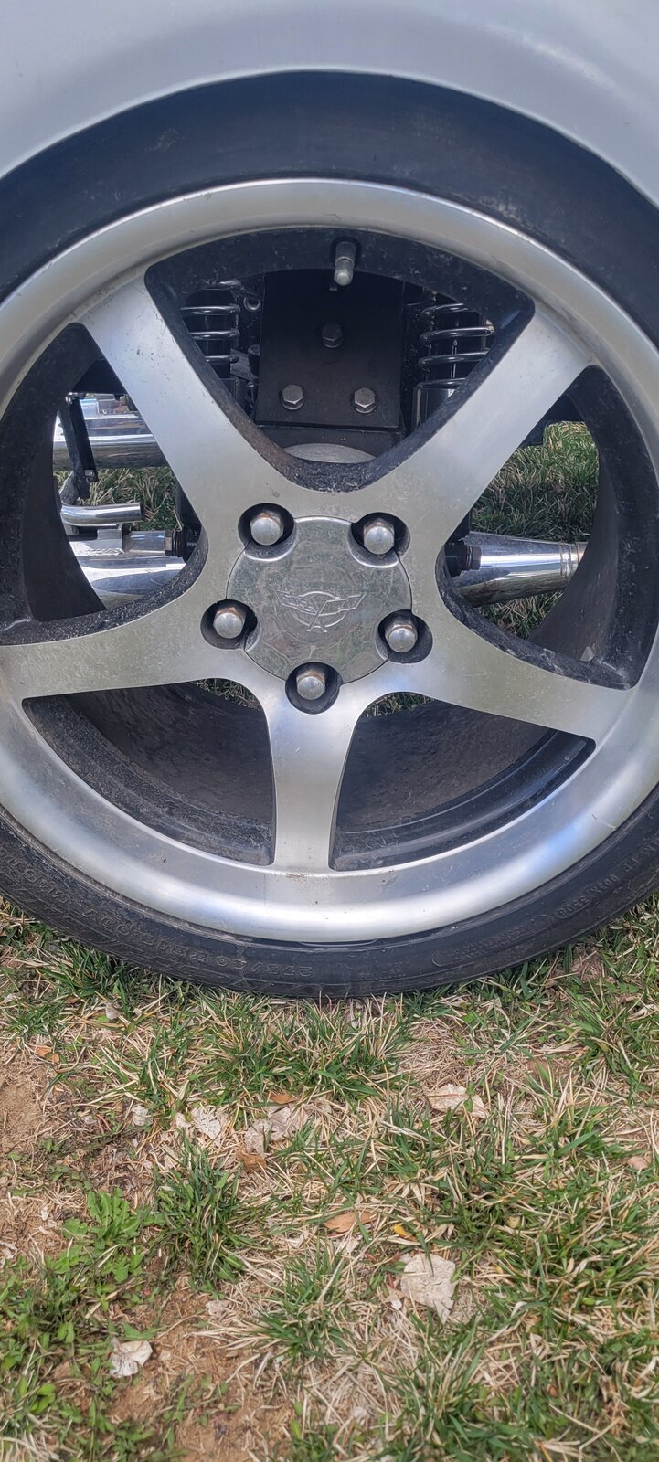

With that said, he had put 00-04 Corvette rims on it. While I am a Chevy Gal, I am in no way shape or form a Corvette or Camero fan. I want to change these rims, now that the need for the tires to be changed is happening.
I want to go down a size to a 16" rim, but don't know if that is possible. If possible, I would like to put the same size rim that Harley puts on the trikes. Would anyone know that size? Also if it possible to put that size on this conversion kit?

The rim size used by Frankenstein is 15x8.
15" x 8" ION, Style 171-5865P, Polished
5 on 4 1/2" bolt pattern, 3 1/2" back spacing, center caps, lug nuts, valve stems

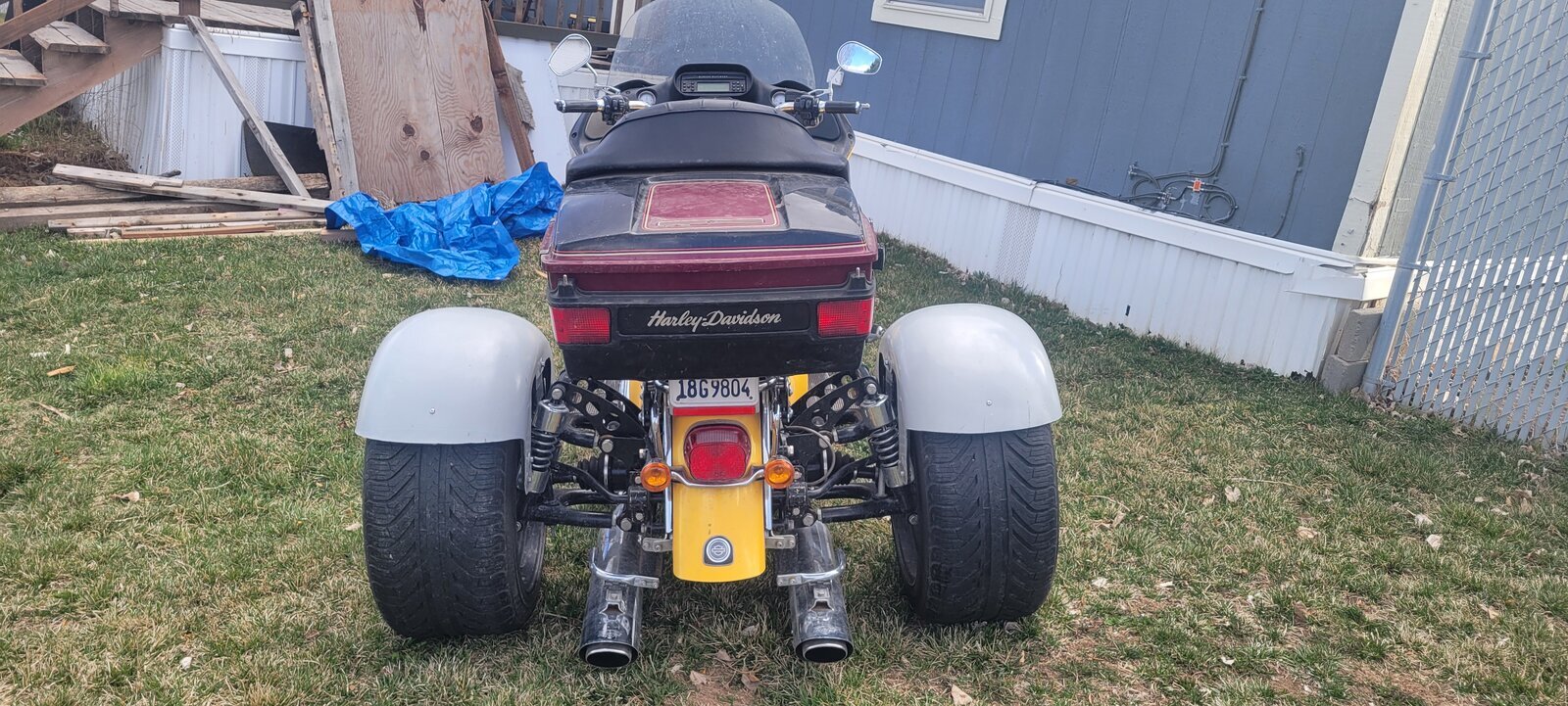

And I 100% want smaller ones. The fenders rattle and shake and sometimes scrape the tire. If there is a rock in the tread, it goes "scrape scrape scrape" and forget going over raild road tracks.
I just did a search of the company and the address came back as a 3 bedroom house on the market and a name change to www.extremetrike.com another nonfunctional site.
Sounds to me like they have gone out of business? So from what I have found, it looks like I can put 225/45/17 on it.

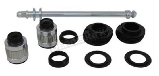

You'd have to dismantle the unit and pull the bearings and see who made them and what the number is on them and hopefully they are available.
I'm surprised they have no parts list in the installation manual.
It looks to have limited clearance between the tire and fender. You could probably go to a 16". Also check at the mounting point where the swing-arm connects to the frame. You may need a new set of these.
Screenshot 2024-06-25 at 14-52-46 V-Twin Manufacturing Swingarm Rebuild Kit - 44-2044 - Dennis...png
