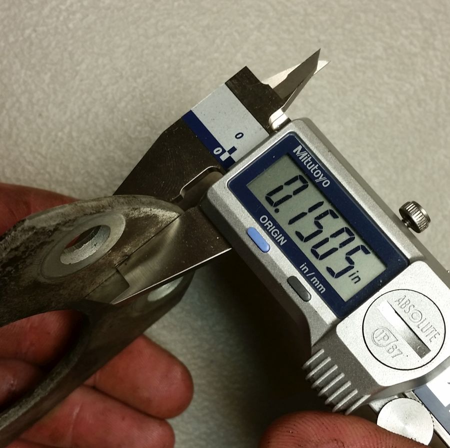

I am sorry for your experience. When I read your post I grabbed a micrometer and measured the OEM plate-

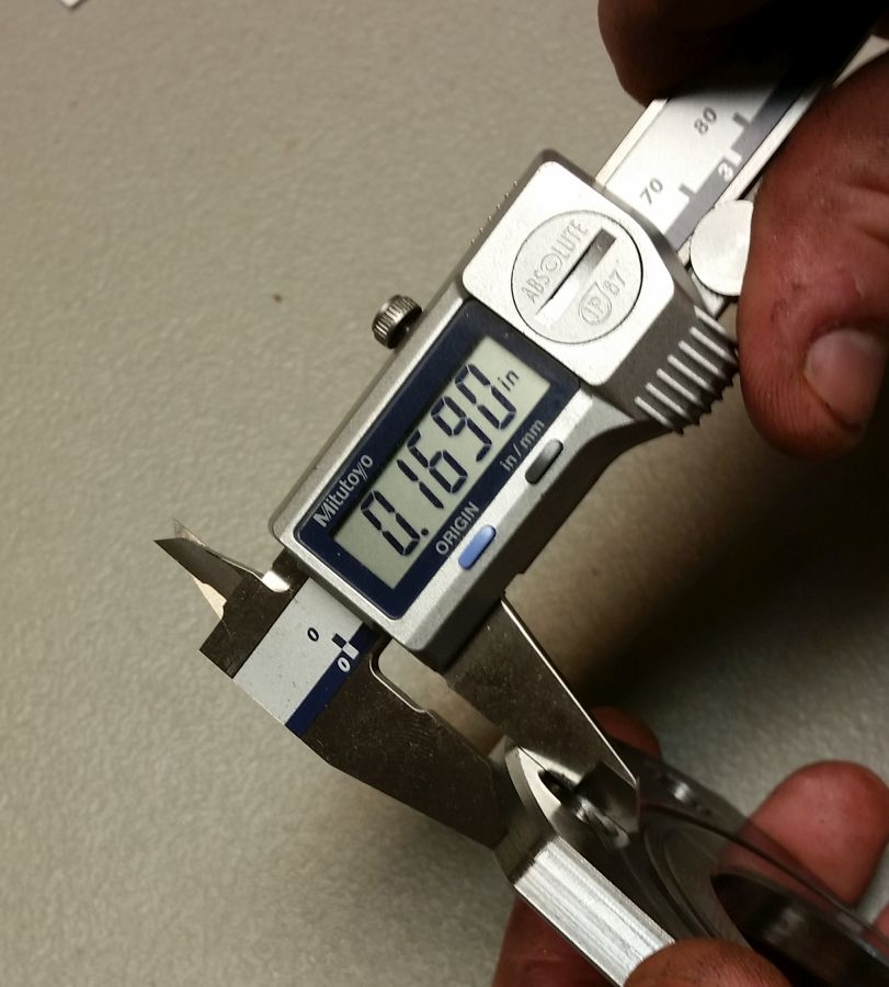

Then I measured our Heavy Duty Plate (at the nut seat)-
Here they are side by side-
Only 0.0185 of an inch difference, which is less than 1/3 of a thread. The Heavy Duty Plate was not yet painted, so with paint it may be 1/2 of one thread.

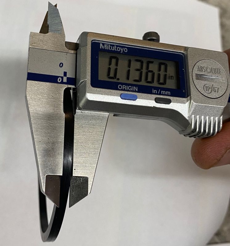

Because of supply chain issues we have alternated between sending round o-rings and square o-rings, so we thought that may be an issue.
We measured the o-rings (photo's below) and then we compressed the o-rings to see if one compressed more than the other.
They are the same size, uncompressed and compressed to the torque settings.
