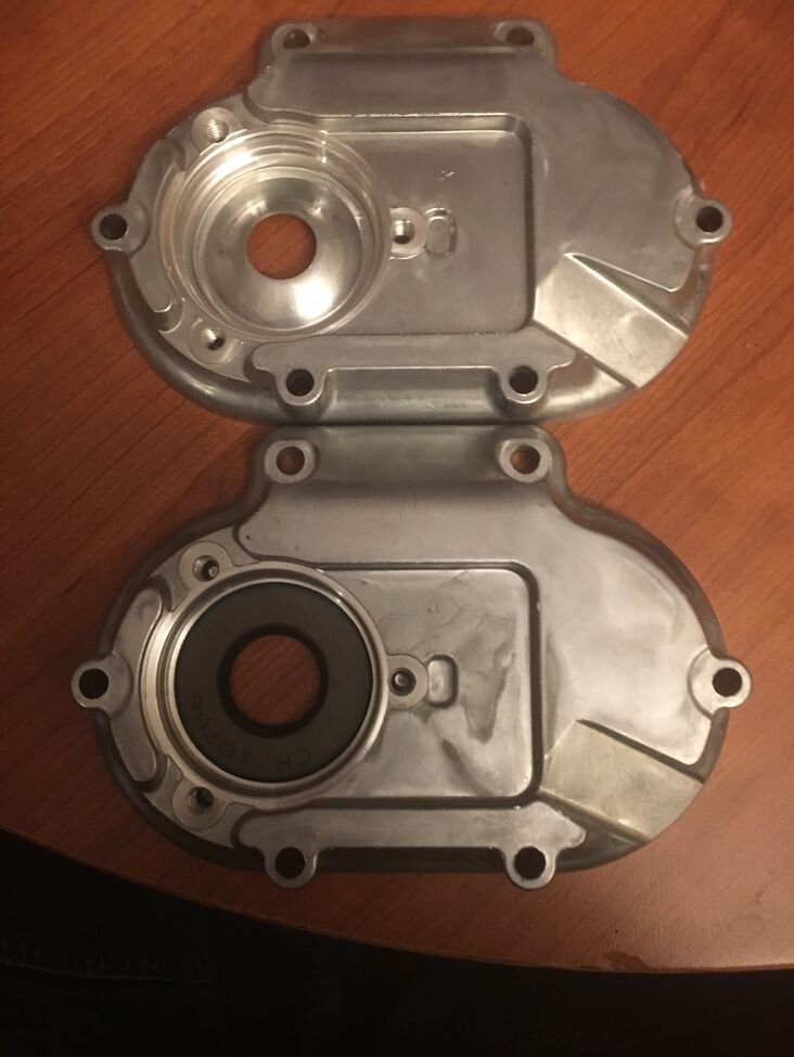

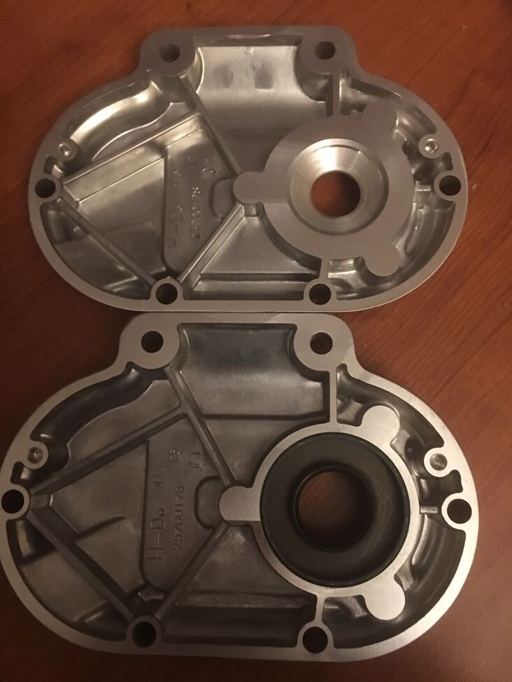

i just dropped my trike at the dealer after putting on the requested 1000 miles to test out the transmission oil. they all confirmed that the oil was low. I was expecting the run around about my problem but was told they would order the repair parts from Harley and would call when the repair was complete.
Good Luck Gary, please post what parts they are using on yours;)
