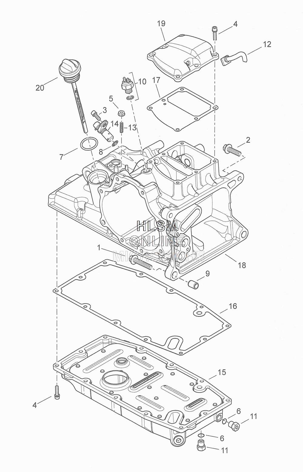

You are correct there are 3 drain plugs but i think the oil pan holds both the engine oil and trans oil.Maybe some one could find a drawing of one.
I tried downloading a breakdown of the M8 and it wouldn't let me,but the oil is above the trans fluid in the same pan.And they talk about a new gasket between the engine and the transmission/oil pan because the engine now breaths into that area.
Here is the break down of the oil pan
# 15 is the oil pan, the baffle on top of the pan is supposed to break up air bubbles to help speed up cooling
