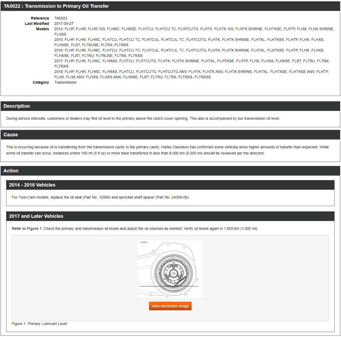

Keep an eye on the fluid, document every time you add to it
Your dealer for lack of a better term is not telling the truth
They have had eyes and hands on an internal memo leaked to the internet that has been removed Imagine that
This memo goes back to 2014 models so you decide who to believe
Ask him about this bulletin
Moderators, This bulletin should be a sticky
HD has seen fit to play dumb over this when it is clear they have this in hand

Gary, There isn't a fix....Harley is stonewalling the problem....Iv'e been back 3 times once Harley sent my dealer a kit to fix it...Didn't work...I have lodged a complaint [2] with Harley Tech service....That and 20 cents will get me a ride on the subway...
My Dealer says, And he's the only one that will say there is a problem.. that they have quite a few M8's with that problem, And suspect there are more out there but the owners don't know it yet..
The Complaint number is 1-414-343-4056...Give them a call..

Jack....Harley Tech Services said DONOT Add fluid to the trans if it is low, Bring it back and the dealer will level the fluids out, No charge..
