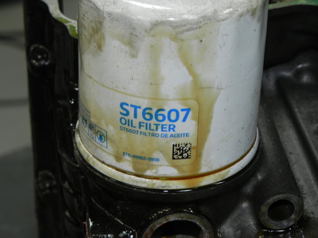

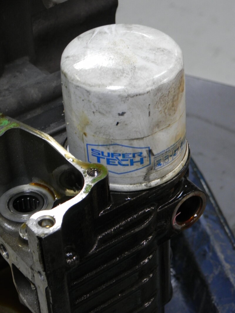

Oil filters for GL1800s
Quite a few years ago gold wings were having problems with oil filters. The cheapos were put together with hot melt glue. The glue would melt when the engine got hot. Then it would solidify in the oil passages over night. Ruined engine on start up.
Being in the GL1800 repair business, for me, I enjoy sharing my experiance of what to do and what not to do. But here's the best part. Because some have their own beleifs, and I'm fine with that, I also know that financially the rewards of "them" having such beleifs are in my favor :)
