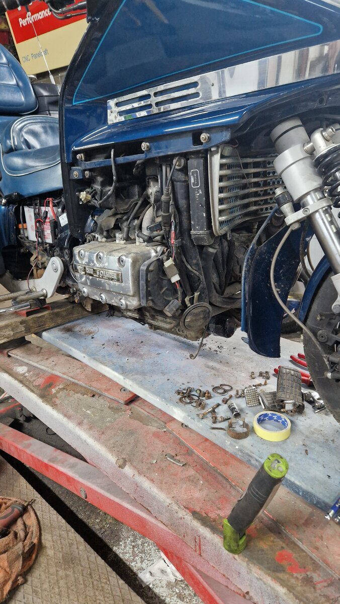

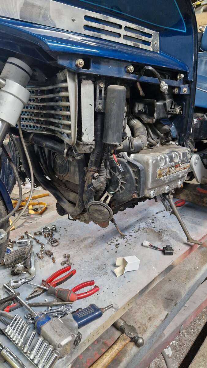

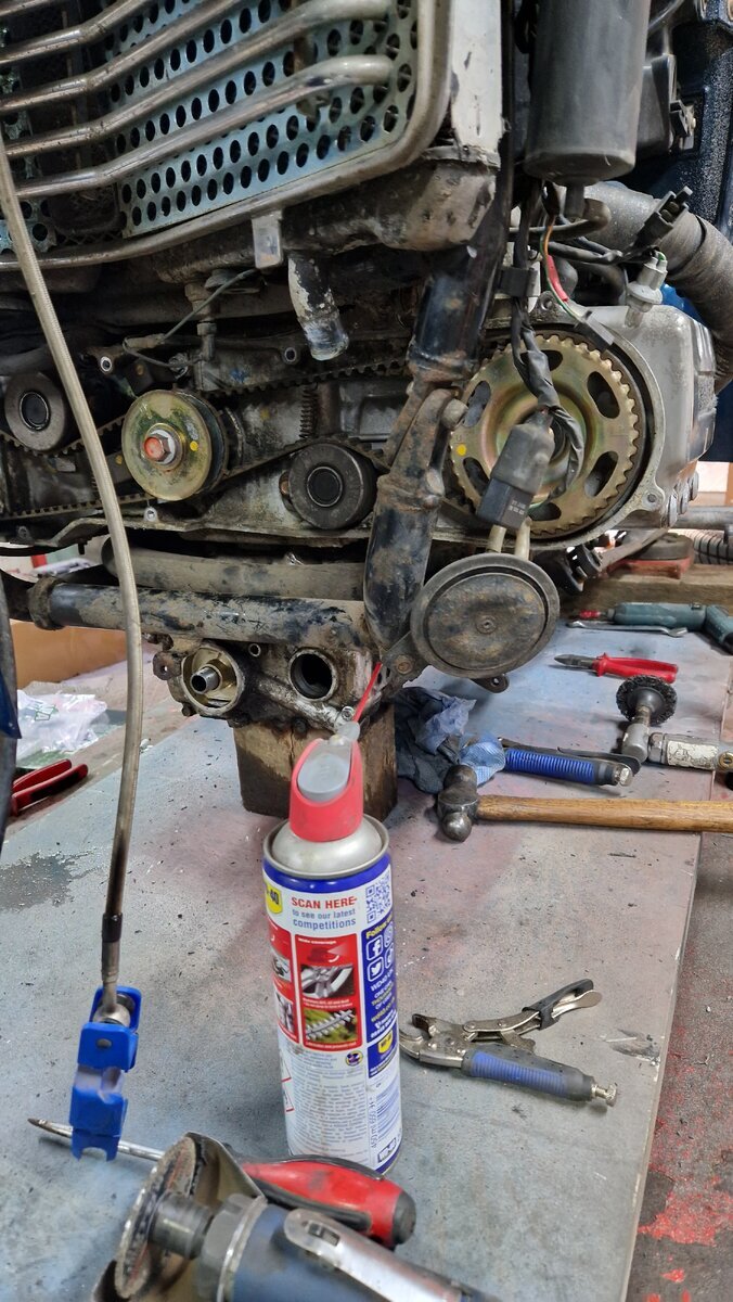

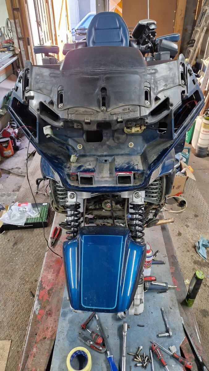

Started a teardown for winter getting ready for oil antifreeze brake fluid and new pads bulbs etc.Guess just looking to make it reliable for next year
And this is the best time of year to dive in there. You've got that torn down pretty good but the satisfaction you get from doing it yourself will be worth it.
More to come off
Front tyre is up for changing

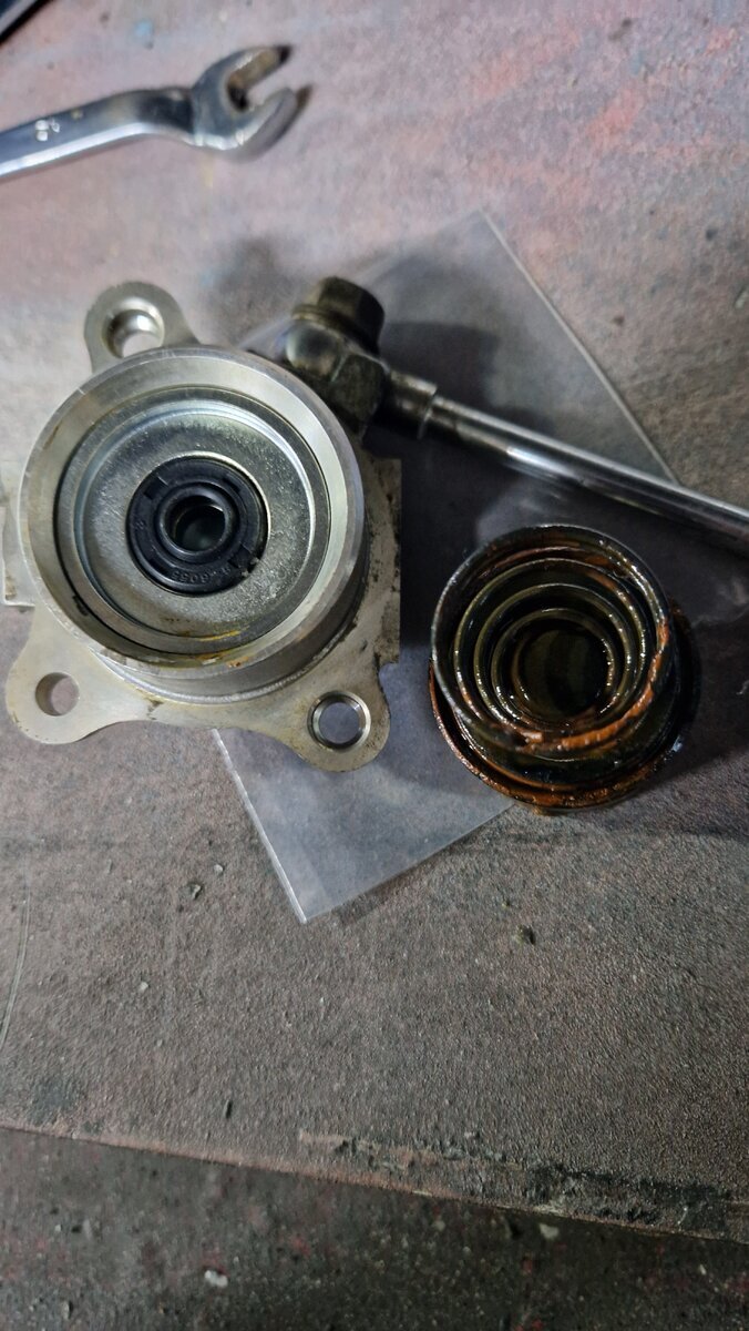

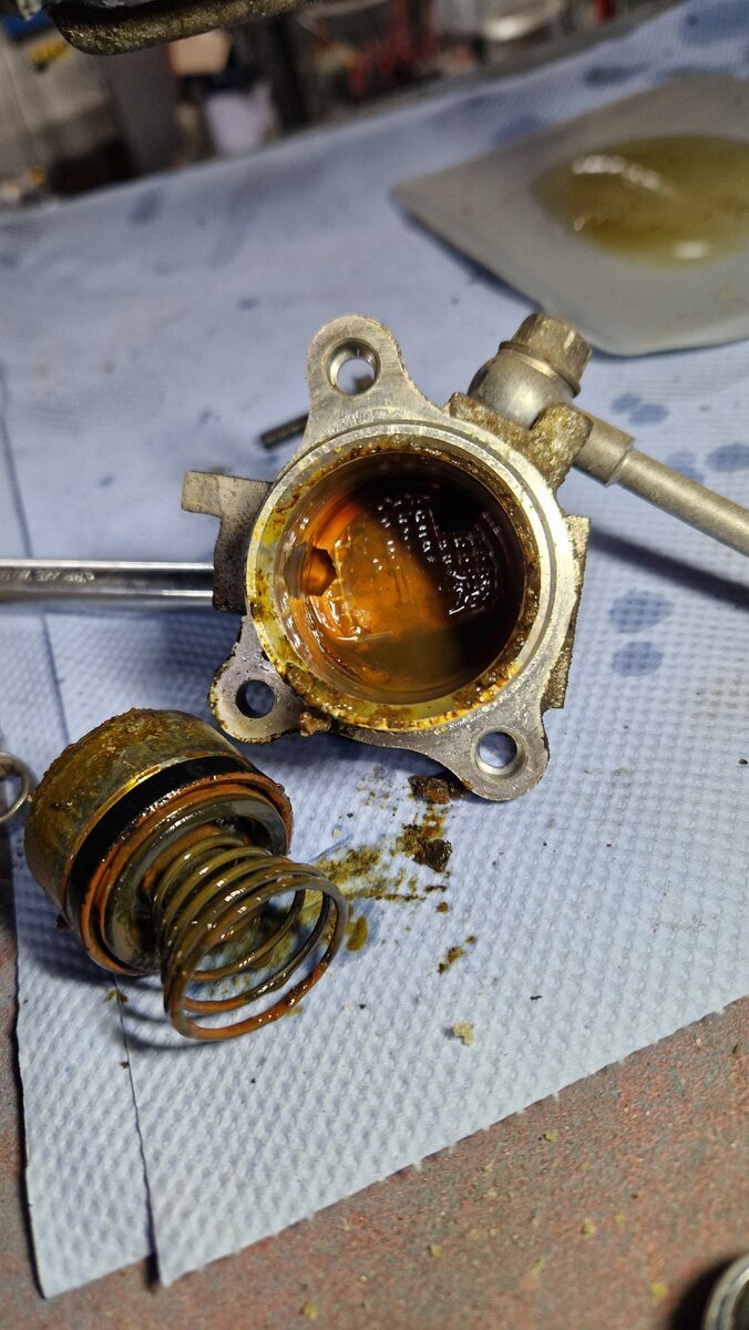

Pads are getting replaced and all pipes will be inspected
This is also a great time to install a new timing belt too if it's been over 10 years since it was done.
Both belts will be on the list

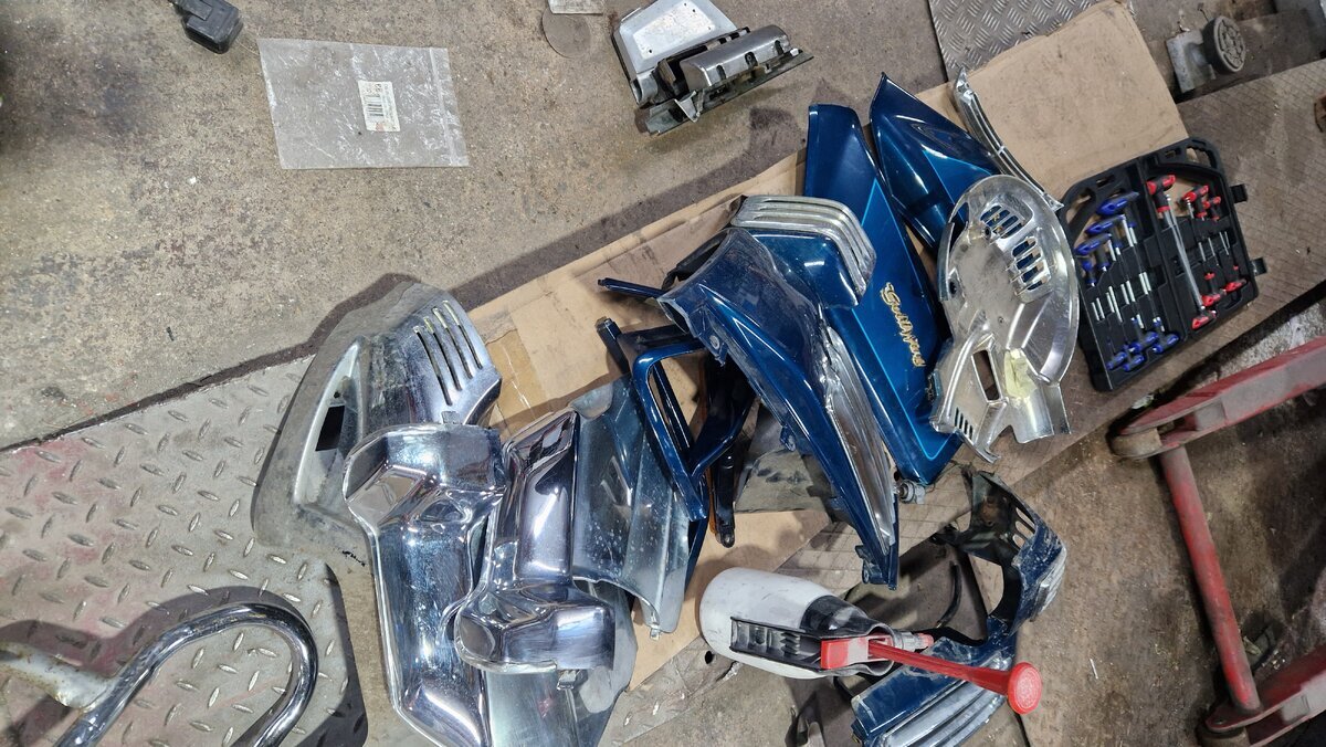

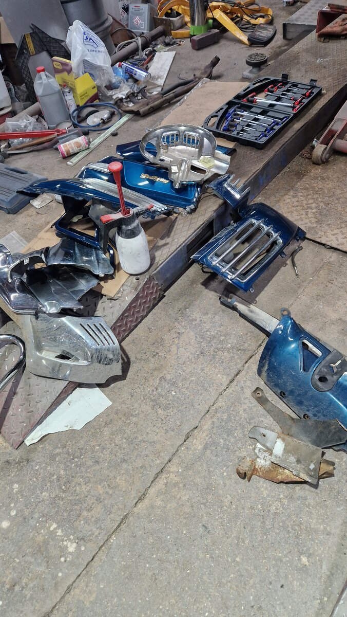

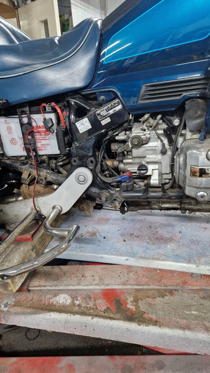

Dropped manifolds to renew seals.Will blast clean manifolds and heat shields then powder coat. Rear foot rests need some work on the rise and fall mechanism. Lower tin work will be blasted and painted in Atlantic blue to match
