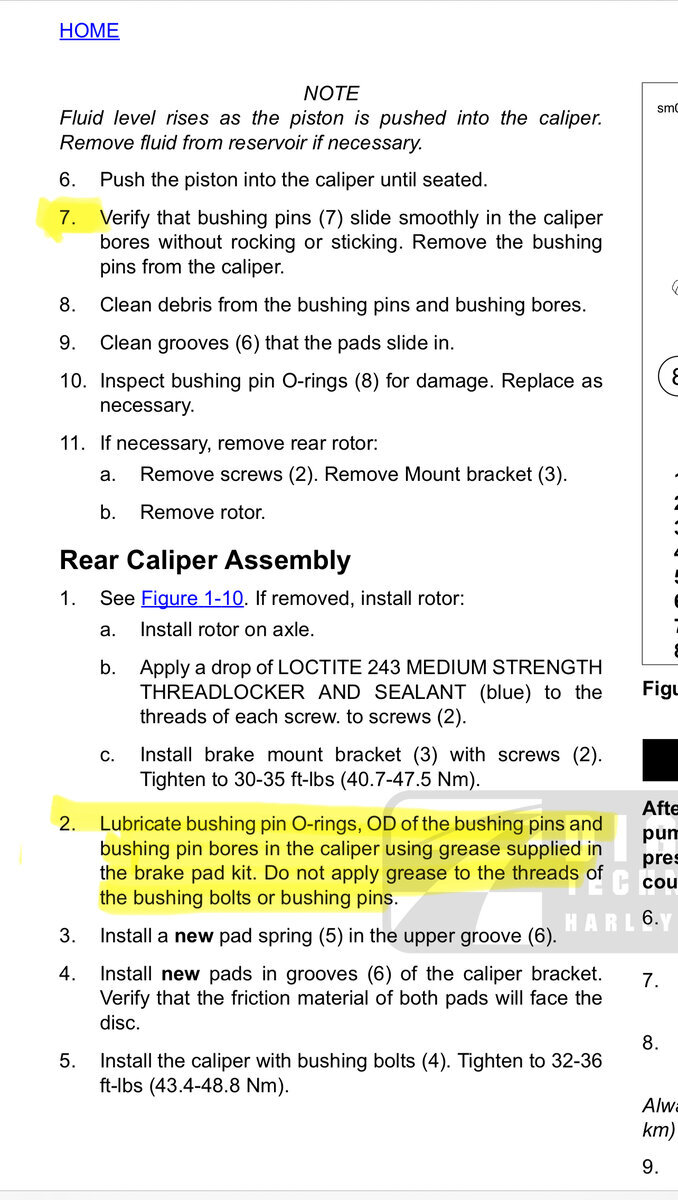

Apparently the mechanic cleaned up the caliper pins and lubed them so the pads could move better?? I did tell the service manager that he should have done this anyway with a standard brake job! He agreed.
I’ve been following your thread of your experience and will 100% agree that those caliper pins should be lubed and standard procedure during any brake job.

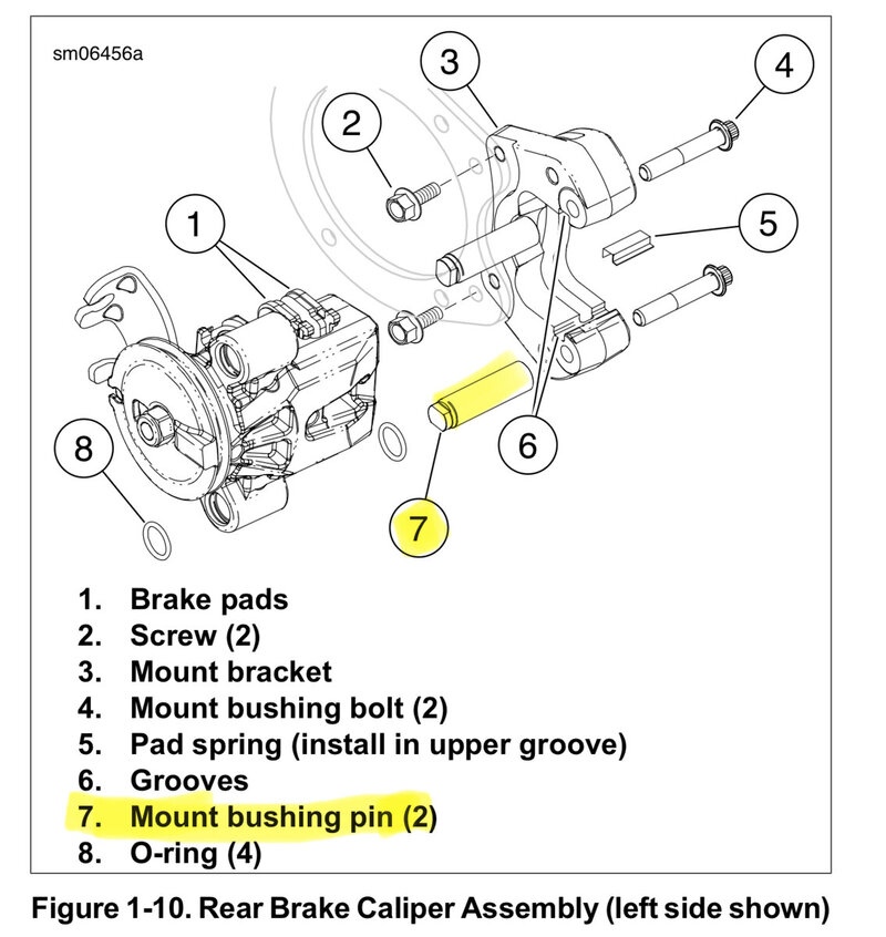

And as a matter of fact, they are smart enough to know the rotor runout (per service manual)…. But failed to follow protocol of not only checking these caliper pins (aka: “Mount bushing pins”)… but also failed to indeed lube them, per the service manual:

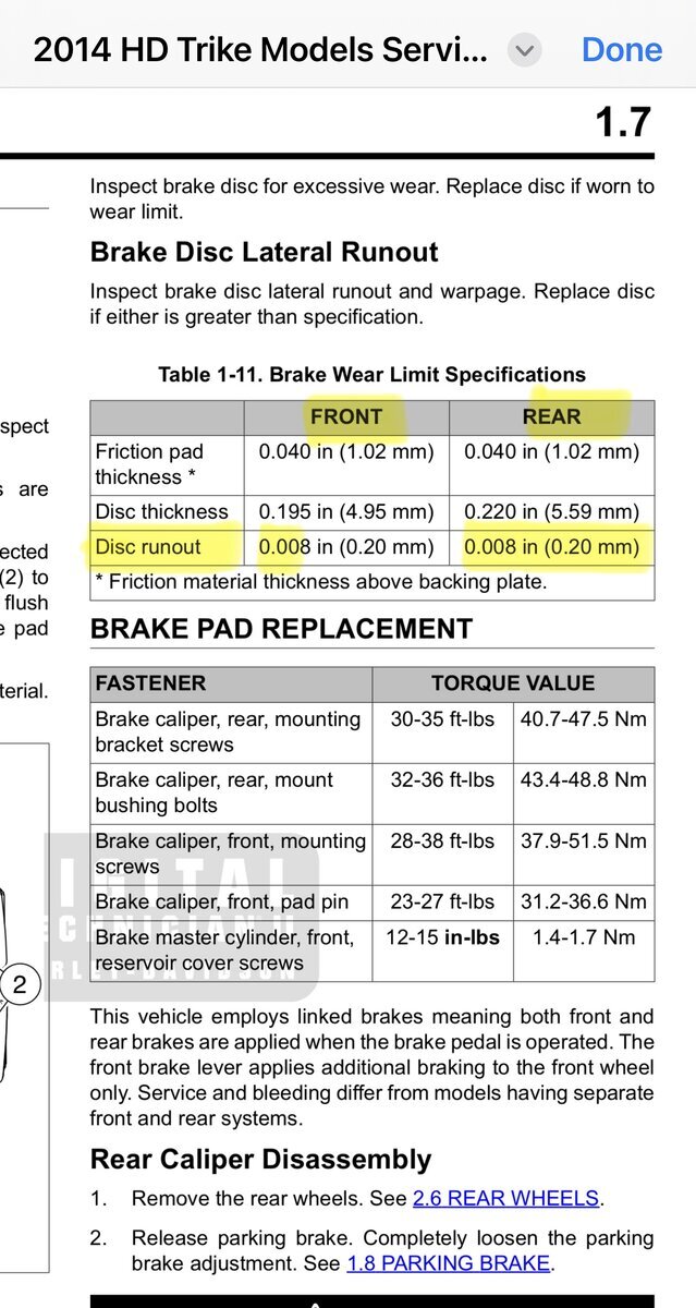

You asked previously about the runout & the service manual does indeed specify a .008 (8 thousandths) as maximum acceptance of both the front and indeed the rear rotors:

I don't think you can get rotors turned anymore; shops just replace them! It doesn't matter how big the rotor is, 8 thousand out is 8 thousand out. Are they both out or just one of them? The shop should make it right, but they aren't going to. If they were going to stand behind the work they wouldn't give it back to you and say it was better, better aint good enough, it is either fixed or it isn't!!! Bite the bullet and take it to the Harley dealer and have them fix it. If you make an appointment and can wait for it, they might be able to take care of it in a few hours.

Well thanks all you guys! And thanks for the info and specs on the rotors 14TG I may get another chance to ride a bit today, only rode about 3 miles yesterday it did seem better.
I may look for someone who can still turn rotors to just true them up abit.
I've never pulled rear calipers (on a Trike) can I just un-bolt them and pull the rotors or do I have to deal with the emergency brake linkage etc?
Not a problem @Arctic Fox !
The video I posted a few posts back is on my 2014 (which is non ABS) and I also have the “linked brake system” but I will assume it’s the same procedure including unadjusting the e-brake cable, then the readjustment after it’s all complete.
