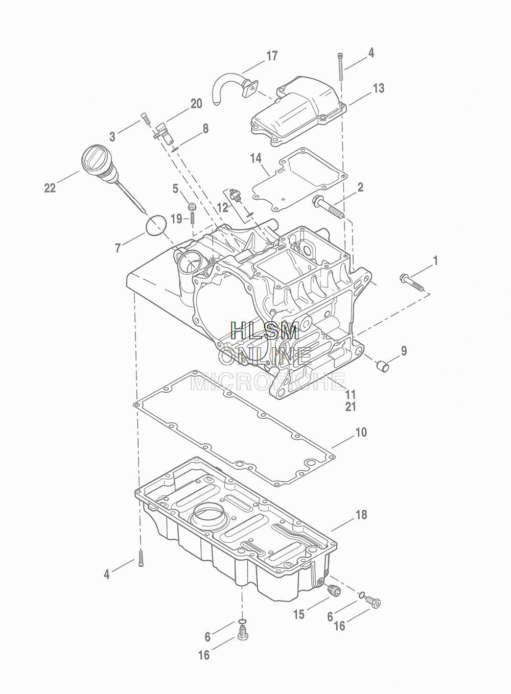

I thought neutral safety switch, but other than the one in the clutch grip, I cannot find one. Location? Have been all over the net.
# 12 , left rear of tranny
