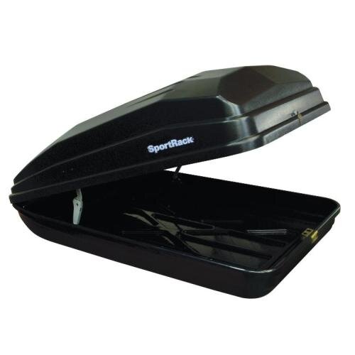

I didn't want weight so I built my own. First you need a Car Top Cargo Box like this: http://www.pepboys.com/product/deta...management/roof_top_carriers_bags/?quantity=1
It's at Pep Boys for 219.00 On Sale order online & Extra 25% Off with Free shipping or Shipped to a store near you. You'll notice it opens with two hinges that hold the top up for access & comes with a Lock & Keys. 18CF & weighs approx. 28#

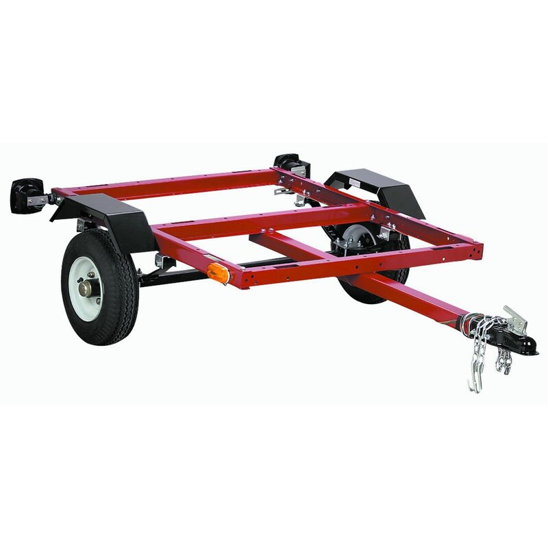

Next you'll need Trailer: http://www.harborfreight.com/automo...ailer-with-8-inch-wheels-and-tires-42708.html
This is at Harbor Fright, and comes as a kit unassembled, during assembly keep it square or it will fish tale, use red lock-tite. Once its together mount (3) 1"x10"x40" to mount the carrier to. approx. 125# Cost 179.99 + wood
I did up grade mine slightly by using 10" wheels & tires ( Northern Tool or Tractor Supply on sale)& mounted the spare tire on the front tongue, all has been good for 12 years.
Now just paint or power coat or not to suit your color and seal the wood and leave 2" gaps for water to drain off topper and wood.
It all works great 1 7/8" ball mount. Total 160# with tire on frt. 20# tongue wt.

Well forgot something to look at:
