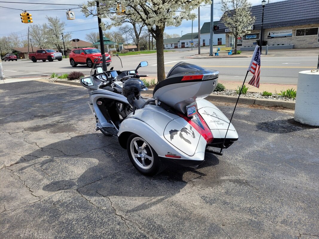

Anyone have information on Lehman Crossbow trike kits? I have some slop in the rear axel. This is right side belt drive. Service manual leaves a lot to be desired. No breakdown for the center section to see what is there. Are there any other Lehman kits that are similar to the Crossbow? The plan is after riding season is to just take it apart to see what is in there.
I believe the differential is 70's ford pinto maverick based differential. There was an updated one piece axle made for them. I am in the beginning of getting some new ones made
I'm making progress with the axles, the shop I'm in contact with is leary of the axle warping when they heat treat it, because of the small diameter spline. Going to try induction heat treatment on a test piece to see if it'll stay true...
