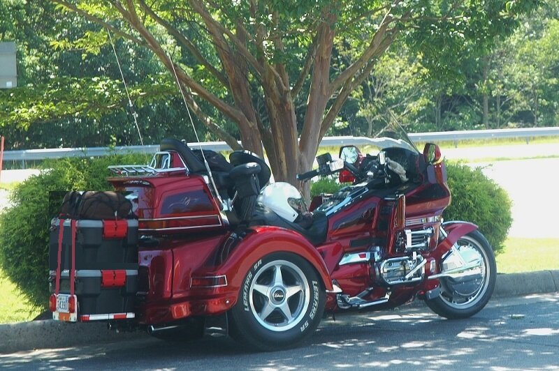

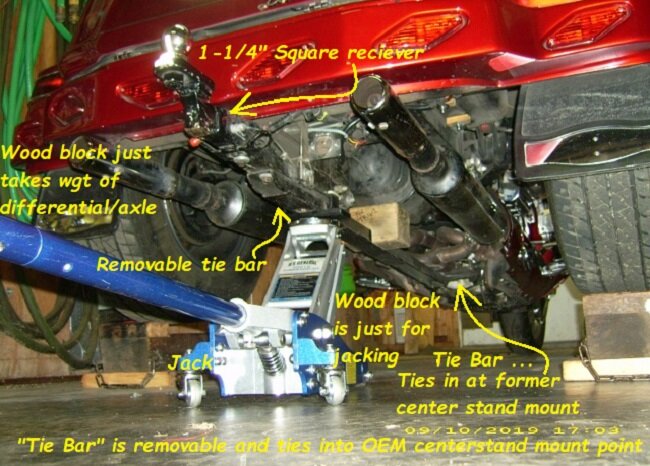

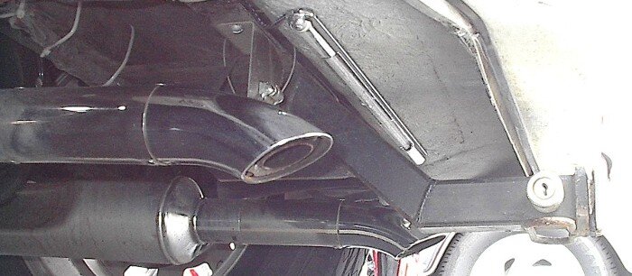

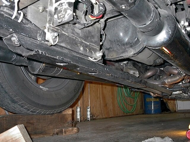

I had the Lehman hitch, but the short mounting across the two rear crossmembers and springy flat bar drawbar resulted in unwanted movement when using a hitch carrier, and I wanted a 1-1/4" square receiver style ... so keeping in mind that the center stand mount ahead of the axle was no longer in use ... I tied all three together. I left the rear most part of the Lehman mount, but removed the springy drawbar. I made my receptacle long enough to reach the center stand mount on the frame, I could go back. It worked very well, no cantilevered weight on two rear cross members so that stress was removed, plus it braced the rear frame of the trike. I could stand on the hitch carrier, no sag ... and a trailer fully loaded with tongue cooler was nothing. Last picture is not my trike, but just one I saw ... for thought.
