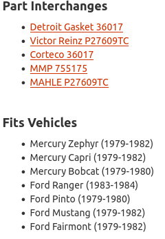

I hope as I'd need to know how old the conversion is, as is it from the early years of the Pinto, Ranger, Mustang or the Granada, Ranger, Mustang2? 1983 was the first year for the Ranger and 2011 was the last. My guess would place the axle from a 1983. This is just a SWAG estimate. However I did find information that will allow you to pinpoint what axle is on your trike. Ford Ranger Rear Axles (1983-2011) - The Ranger Station I do the research so you don't have to.

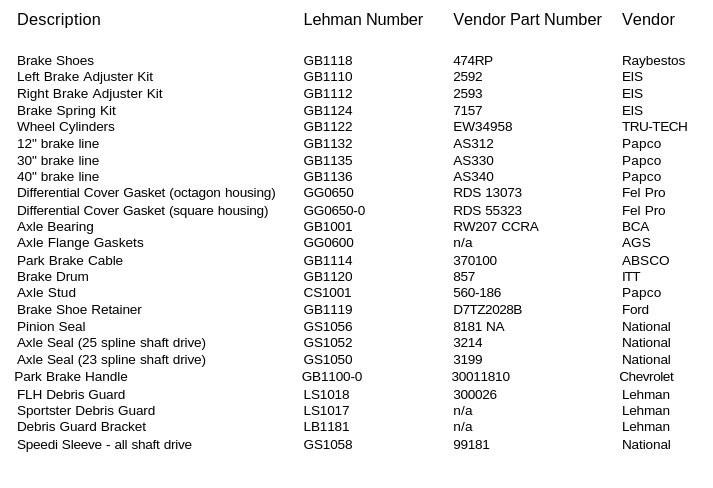

I just spent some time digging through the book marks in the computer and found something very important for you: Gl1500 LI1062 Mar14, 03 PARK BRAKE 25. Honda Goldwing GL1500 GTL - 14 Mar. 03 Lehman Trikes Inc. - 3-Instruction Part # LI1062 ... Honda Goldwing GL1500 GTL ... - [PDF Document] and it has the very important parts list. :)
I am also posting the part list for all to see.Screenshot 2024-06-22 at 14-54-57 Gl1500 LI1062 Mar14 03 PARK BRAKE 25. Honda Goldwing GL1500 ...png
Screenshot 2024-06-22 at 14-19-54 LEHMAN 3.081 DIFFERENTIAL ASSEMBLY COMPLETE BASED ON FORD 6....png
I hope as I'd need to know how old the conversion is, as is it from the early years of the Pinto, Ranger, Mustang or the Granada, Ranger, Mustang2? 1983 was the first year for the Ranger and 2011 was the last. My guess would place the axle from a 1983. This is just a SWAG estimate. However I did find information that will allow you to pinpoint what axle is on your trike. https://www.therangerstation.com/tech/ford-ranger-rear-axles/ I do the research so you don't have to.
I just spent some time digging through the book marks in the computer and found something very important for you: https://documents.pub/document/gl15...dwing-gl1500-gtl-14-mar-03-lehman.html?page=1 and it has the very important parts list. :)
I am also posting the part list for all to see.View attachment 126353

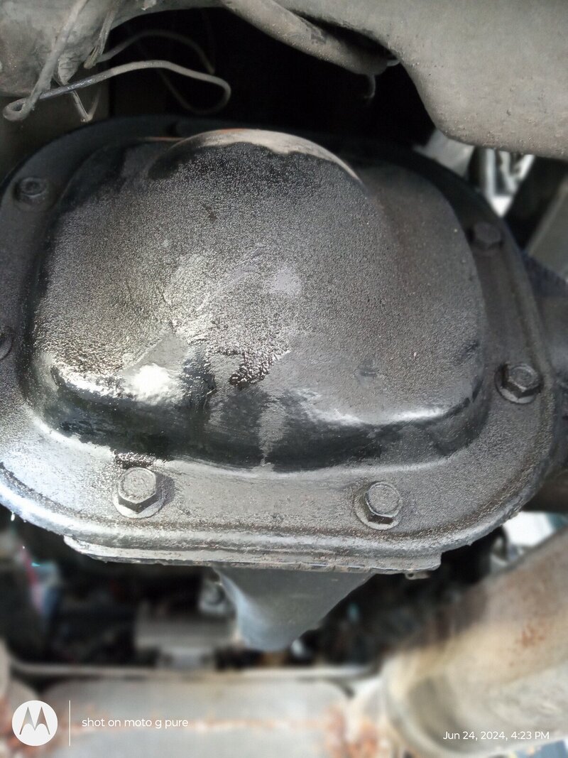

Lehman used Wildwood on their disc rears but mine has drum brakes, looks identical to that picture but with drum brakes. There is no information on these rears, like they never existed.
I couldn't find anything in my files on a parts breakdown for the rear axle.
Like anything else they may be off a Pinto.
