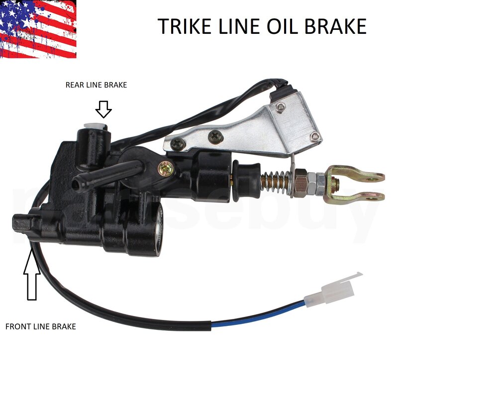

Hi, do you think the problem could be that the brake master cylinder has been changed by connecting it like the bike? Do I need to reverse the outputs from the front rear master cylinder?
The front bake line is most usually considered the primary line, ( top picture)
Are your lines reversed? Do you know the history of your trike?

I don't know the history of the tricycle,brakes poorly at the rear.
I was thinking of swapping the outputs from the oem master cylinder since it has a divider from 60% front to 40% rear
Keep in mind I think the line orientation is for linked brakes, if you swap the lines the linking may not work as designed
Are you brakes still linked?Some manufacturers delink them and others do not.I don't know about Lehman but Champion does and they plug the outlet at the rear of the master and strictly use the one on the side that originally went to the front.
